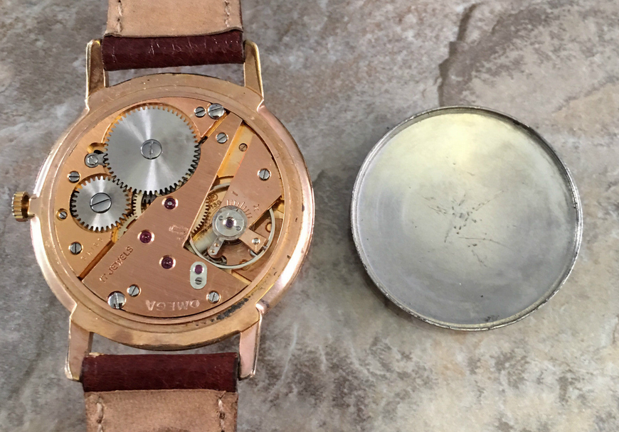

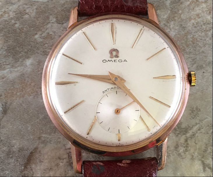

I almost get burned by this fake gold pie pan last December
omega3-mr-jpg.9567
omega2-mr-jpg.9568
188
53
looks so real, good you didnt buy it, i would have done it and be burned

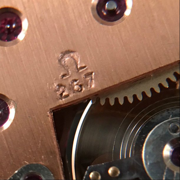

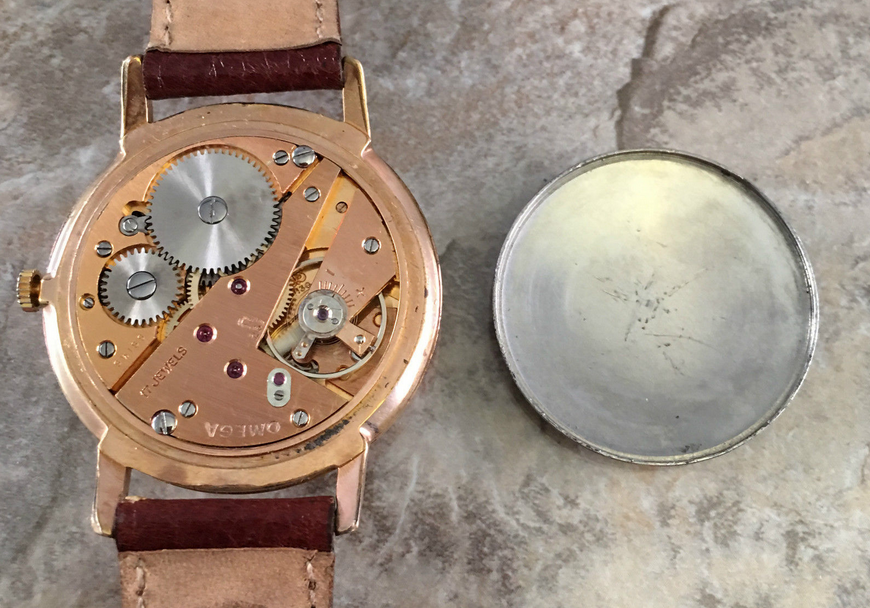

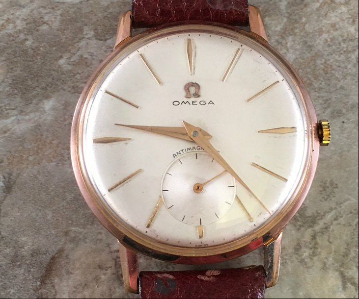

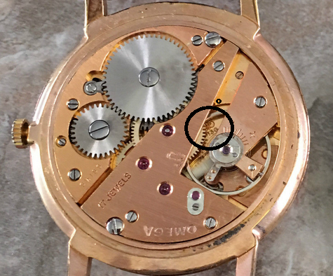

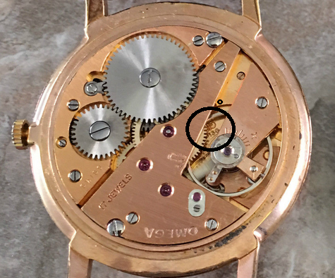

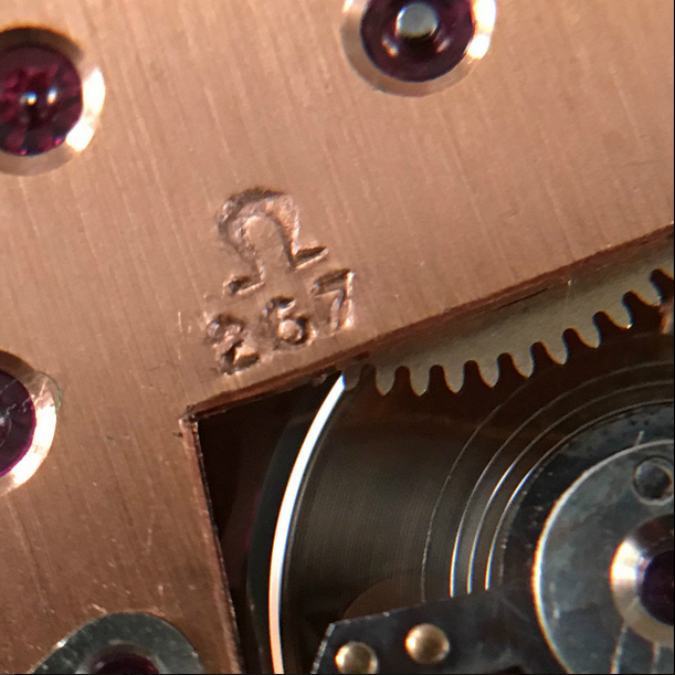

Hi Steve, few lines above members tried to explain that this not the right place to ask... please read before posting.
BTW seems to be legit but hardly polished.
