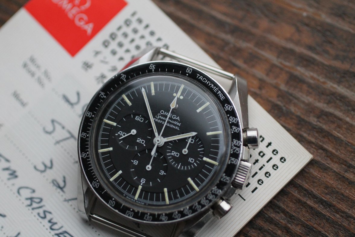

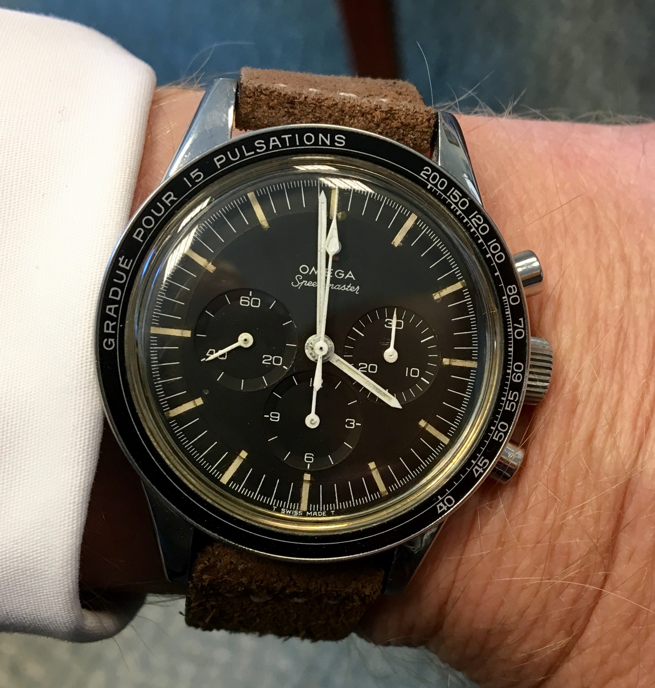

Here's a not very good photo of my 105.003-64 bought earlier this year - good watches and great bezels are still out there waiting to be found!

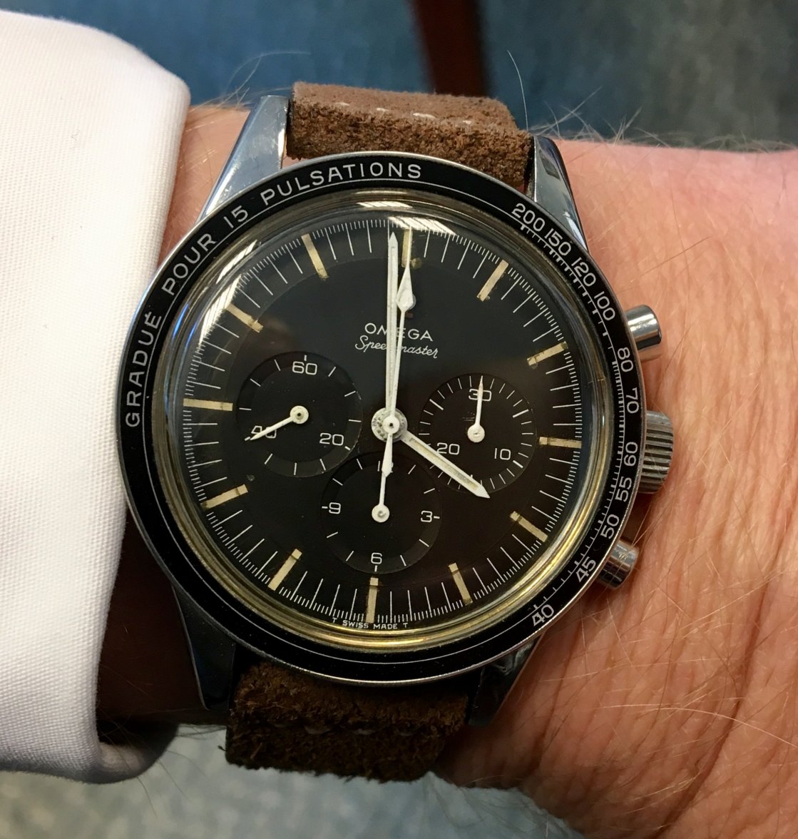

Can my 105.003 pulsations bezel stop by? Not a DON, but it’s in pretty good shape for its age!...

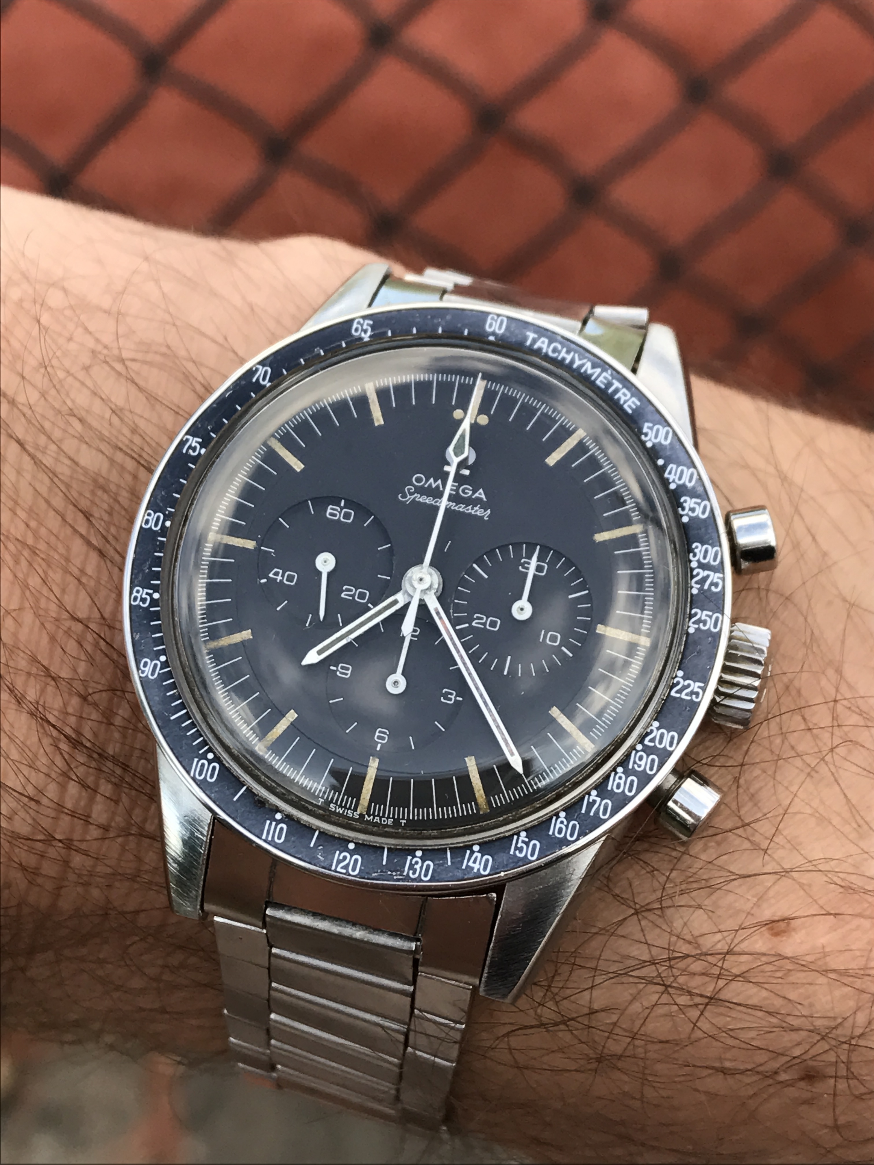

I like the honest look of the bezel on my 105.003-65. Seemingly has had the same life as the dial.

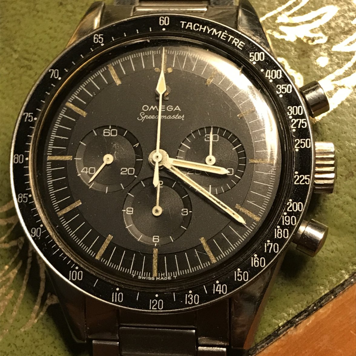

There are some great DONs out there still. This one on a 321 is on a 105.012 CB
Am sure there are many more.
But a very nice one indeed 105.003. Congrats 👍

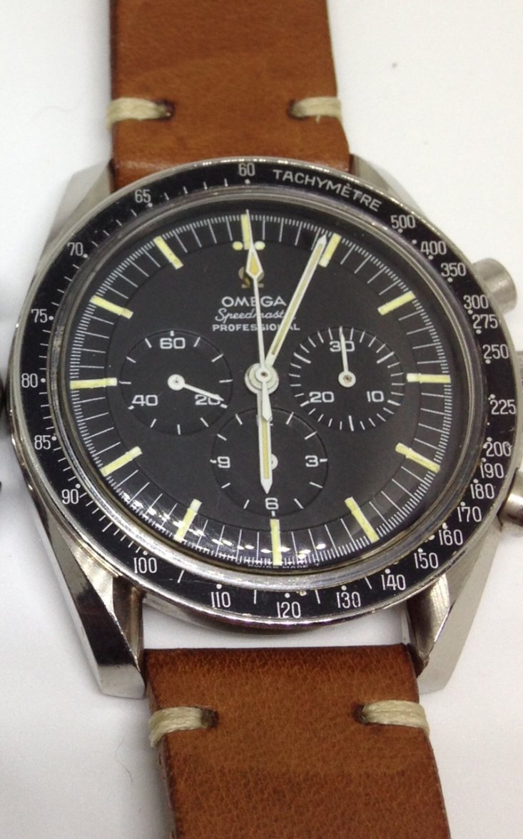

As nice as this Speedy may look it is not fully functional. It runs fine but the pushers are not functioning properly. The pusher at 2:00 doesn't stop the seconds hand when pushed but automatically returns the hand to 12:00. The pusher at 4:00 does not function. Where do you recommend that this watch be repaired? I live in San Francisco but I'll ship to the best location. FYI, I called LA Watchworks and they have a wait time of 3 months. Is it worth the wait?
100
24
It just occurred to me that the pusher at 2:00 is doing exactly what the pusher at 4:00 should be doing. And the pusher at 4:00 is nonfunctional.
This is a dysfunctional watch!

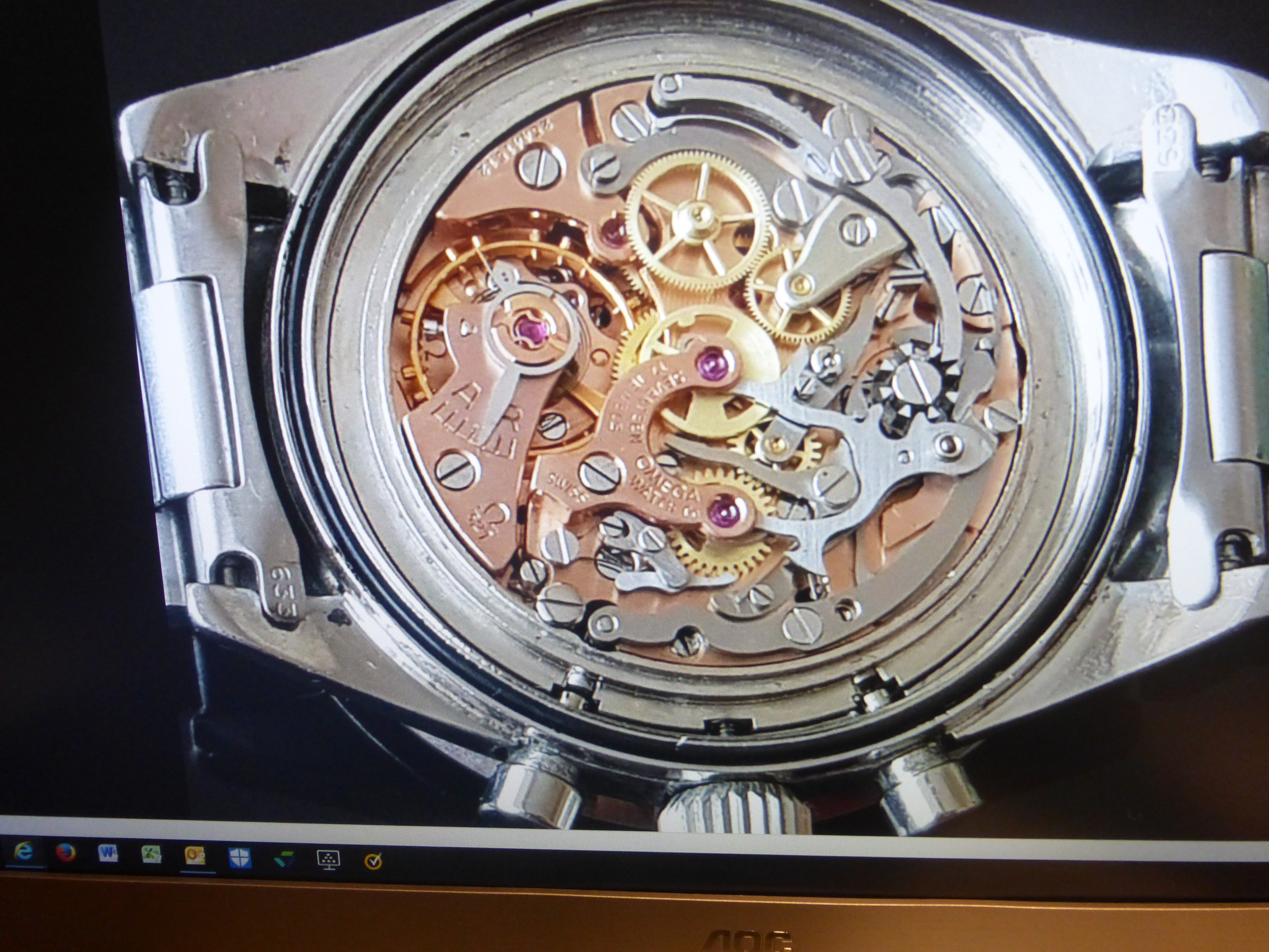

Take a picture of the movement. That may shed light on this issue.

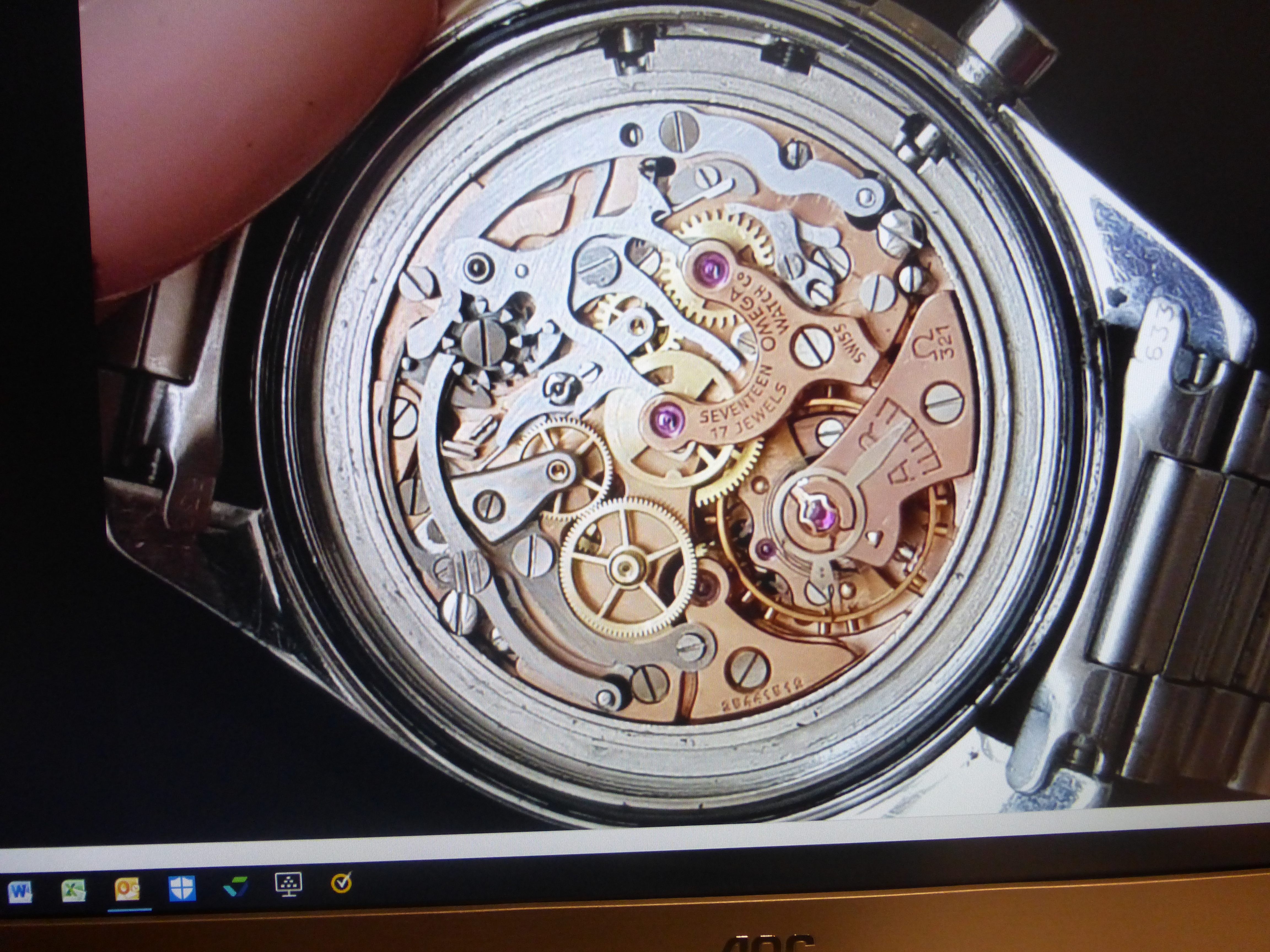

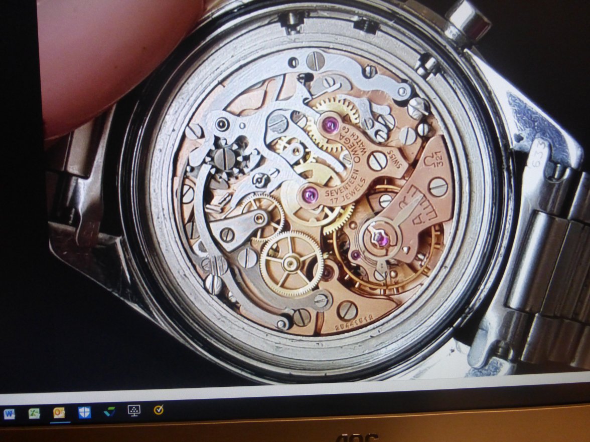

This is the movement:
Those are not current photos I suspect. The chronograph seconds and minutes resetting when you stop the chronograph indicates that the part called the "stem bolt for hammer" is missing or broken, but it's present in those photos. This video (of an 861 but it's the same principle) shows the start, stop, and reset when the stem bolt for hammer is in place, and what happens when it's missing:
The pusher at 4 is still required to reset the hour counter by the way, but you may not be letting it run long enough to even see the hour counter move.
Cheers, Al
