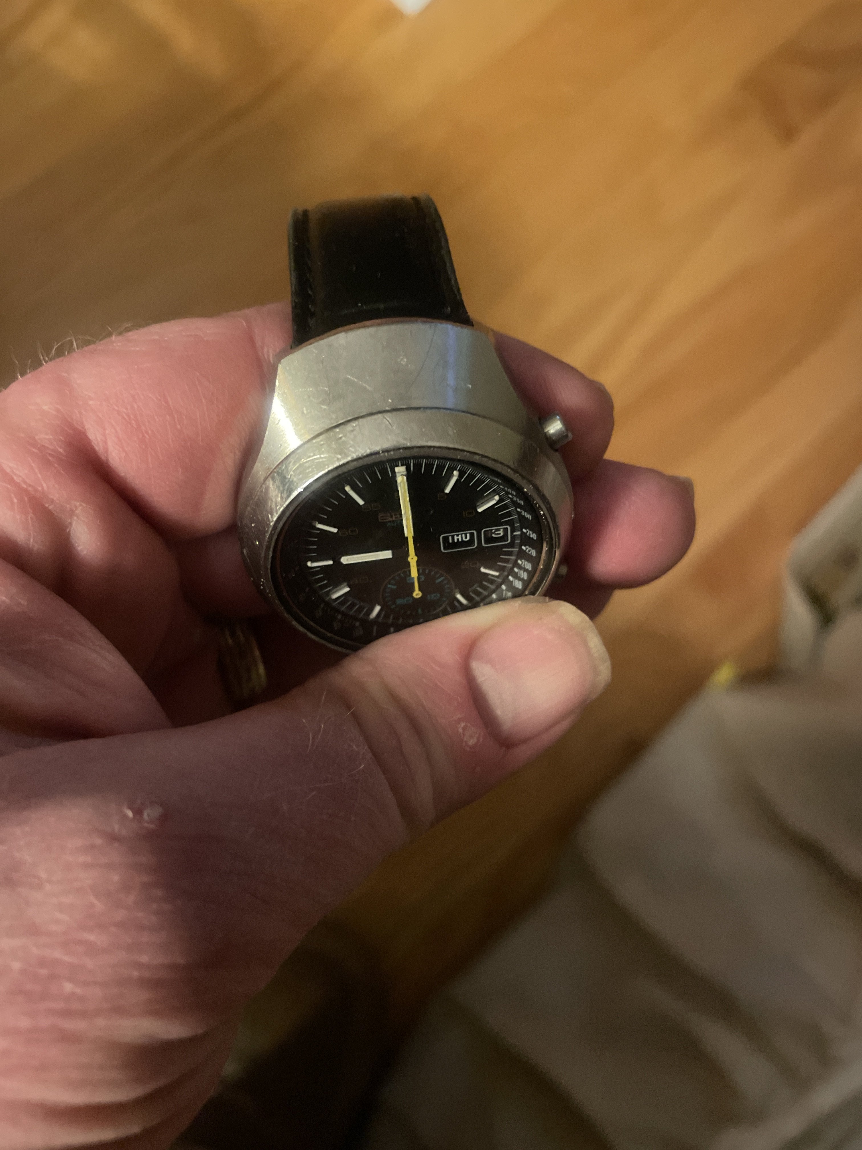

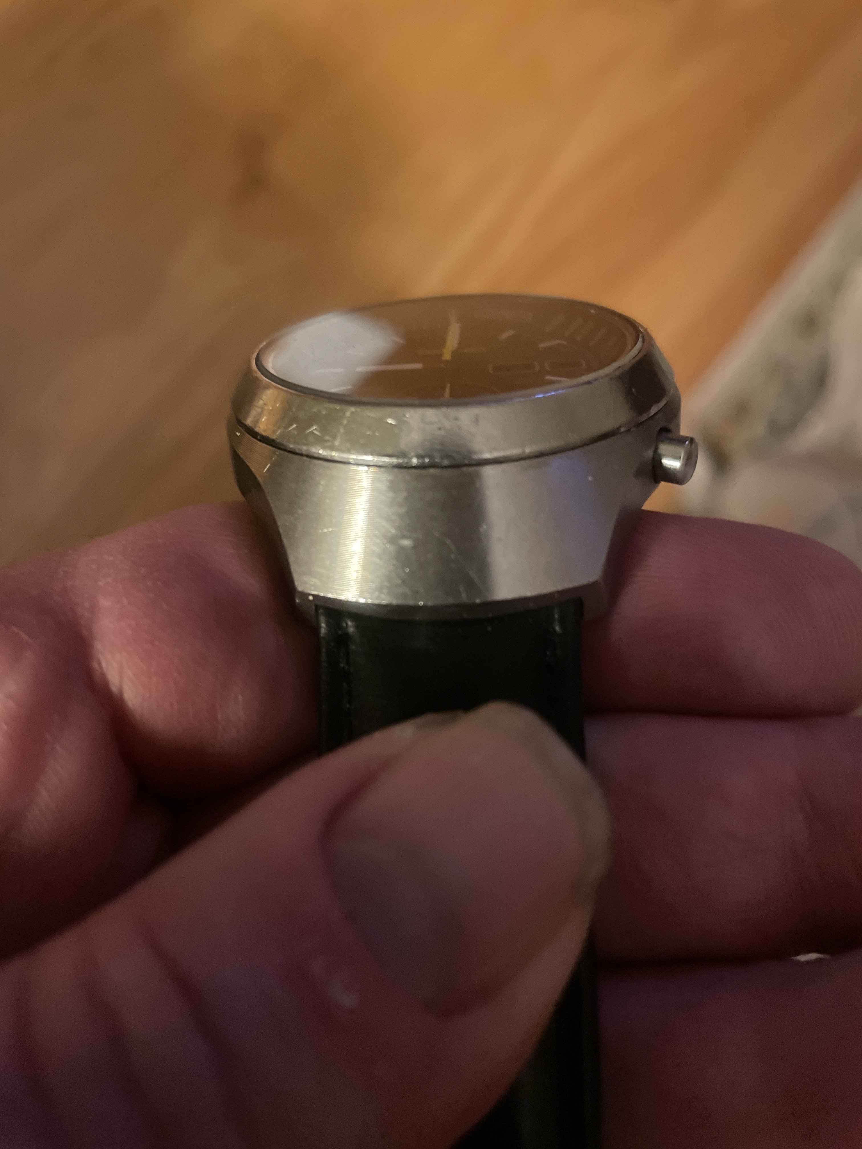

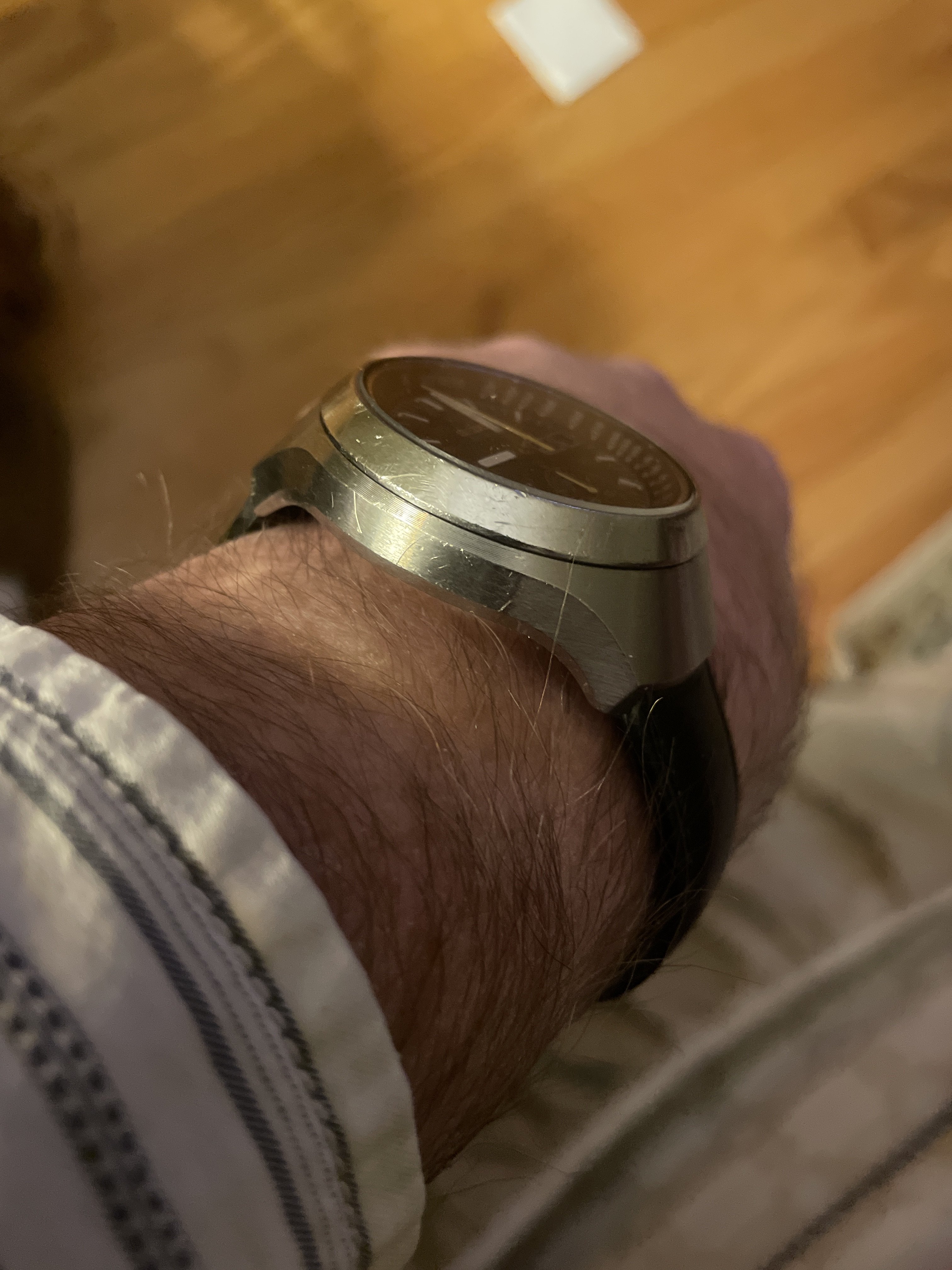

Thanks I’m in the US would it make sense to go that route? I’m not big into Instagram but I should probably get the app as apparently there is a lot of watch stuff. I was looking at some cases on eBay but it’s hard to tell the condition. I just like the hec out of this watch as it’s so odd I got like 50 bucks into it but the way it sits on the wrist is just so odd I love the darn thing with all its dings and marks. Plus a buddy knew I was looking for one and did me a solid by just sending it off to me. I could pick up a nicer example but I’d like to (if possible) clean this one up as it has some sentimental value now. TBH I can just wear it as is also it’s not like everything has to be perfect for me. Keeps excellent time, chrono and date change working fine and I get a laugh every time I wear it, it’s such a unique look. A couple pics but sun set long ago so they won’t be that good. I do have the original bracelet but I just through it on an extra leather strap I had laying around. So pics will give some idea of its rough life but just poor lighting right now. Thanks again for the name.

Guess it depends on whether you'd like to ship the watch overseas to get work done. I won't comment on prices as it would definitely vary based on individual cases. You could maybe try to drop him an email to get a rough quote on your watch. A quick google of "lapinist watch restoration" should return his email contact details. He gets alot of GS/KS jobs but there are also posts of him doing work on 6138/6139s as well. From what I recall, your watch should be a 6139-7100. It has a slightly more unique finishing in that the bezel has a more polished finish as opposed to the rest of the case which has more matte brushed finish, that I would guess requires more work to do(note that I have 0 experience in doing any casework).
On a side note, your model of watch should most likely have come on a fishbone bracelet (ref: Z050S). You should be able to note the ref number on the backside of the straight end links. The bracelet design is that of two fatter side links and a much thinner mid link, which I've always thought looked real nice with the hidden lugged case. Not sure if you've heard as well but there is a general recommendation to leave the chronograph running to minimize wear to the clutch. I would say a nice find for 50 bucks!
