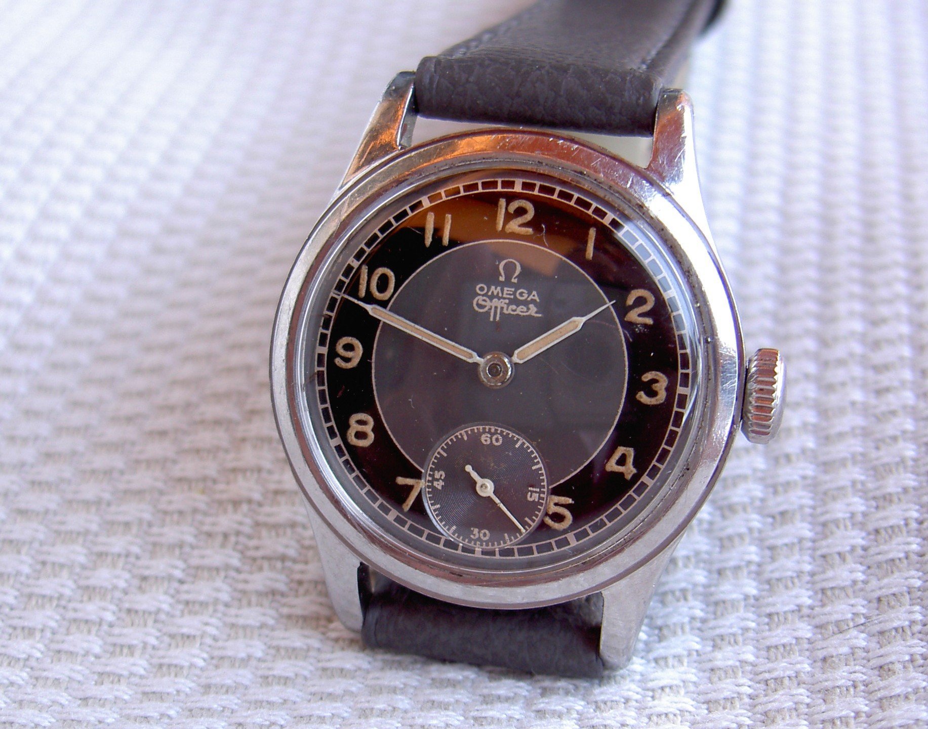

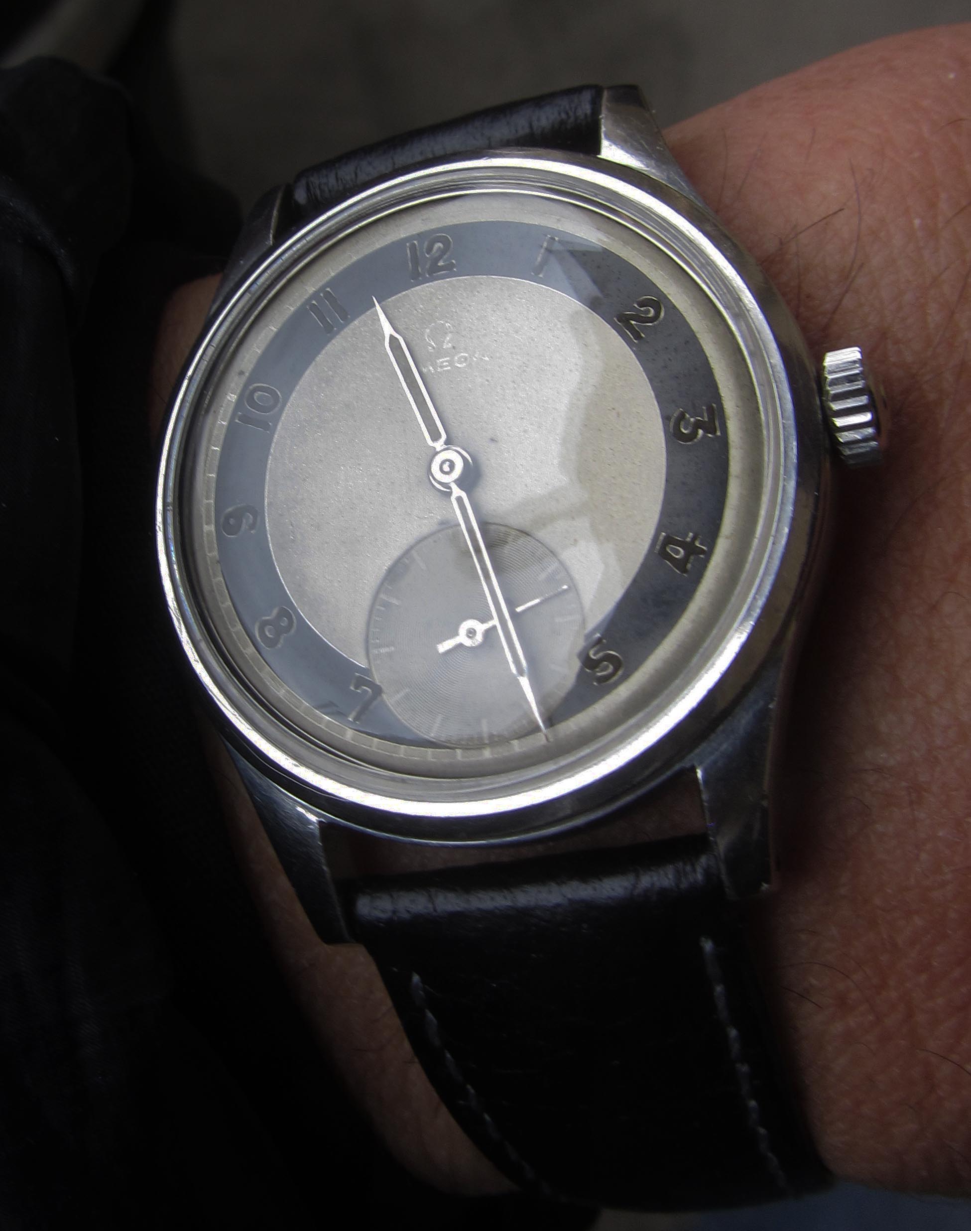

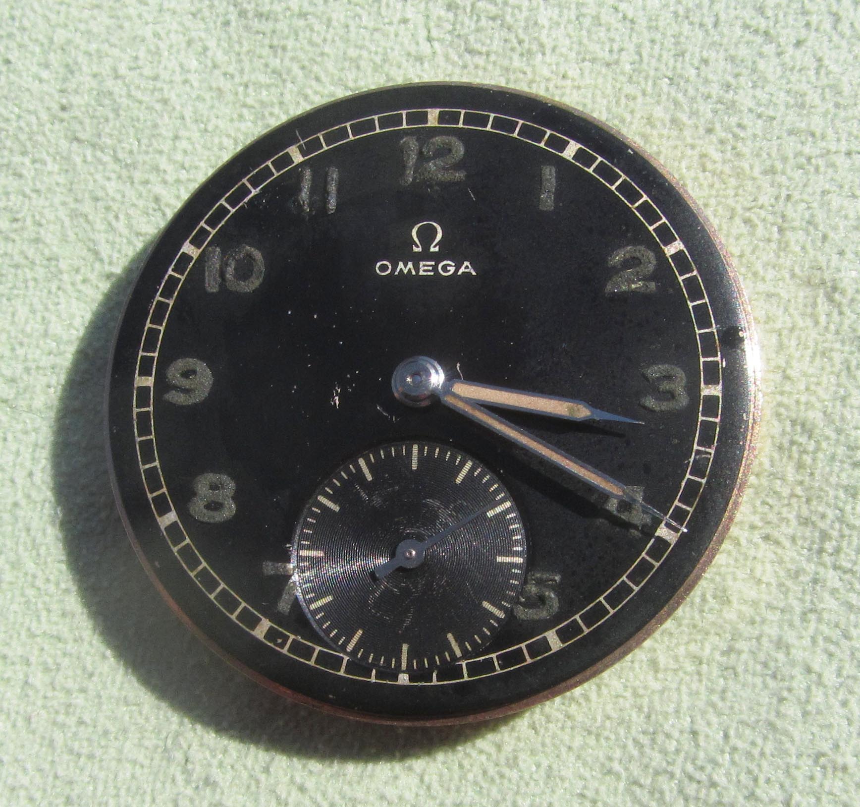

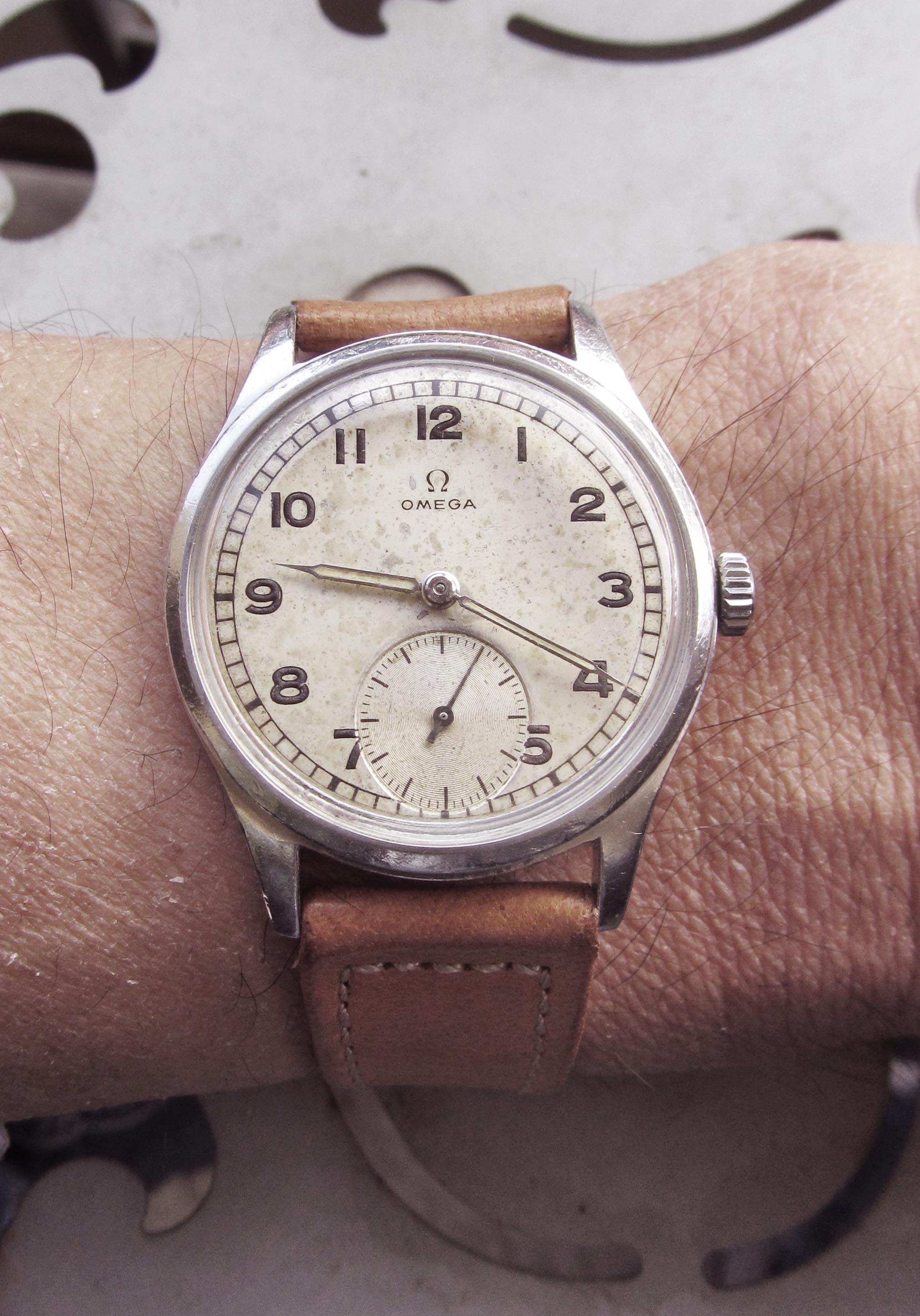

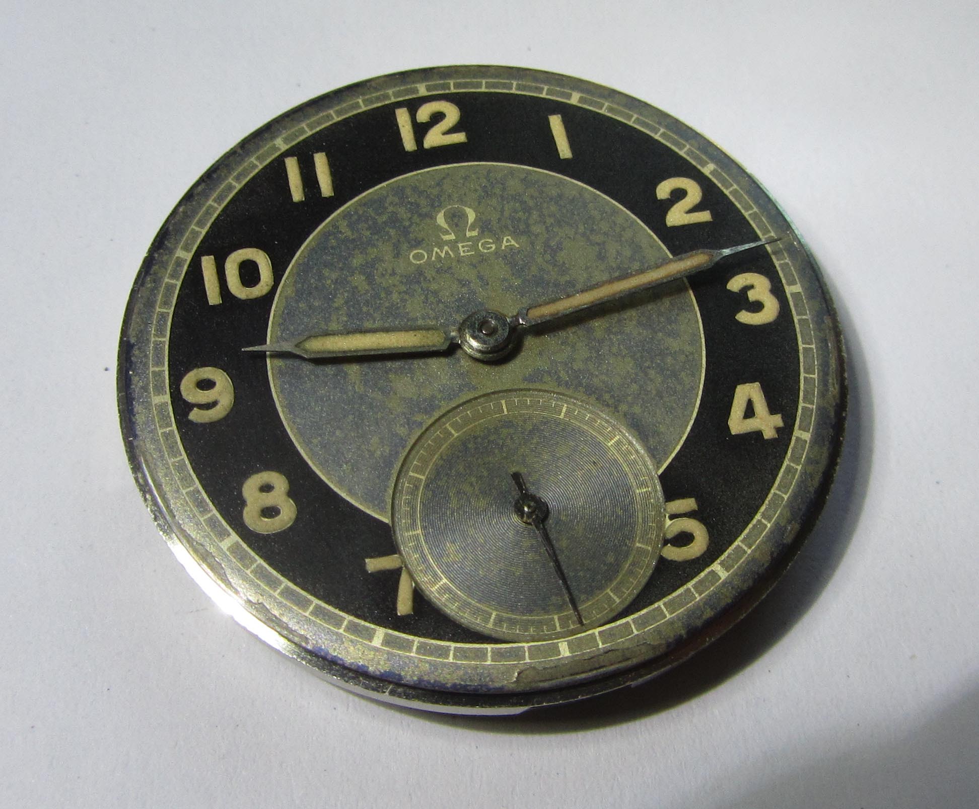

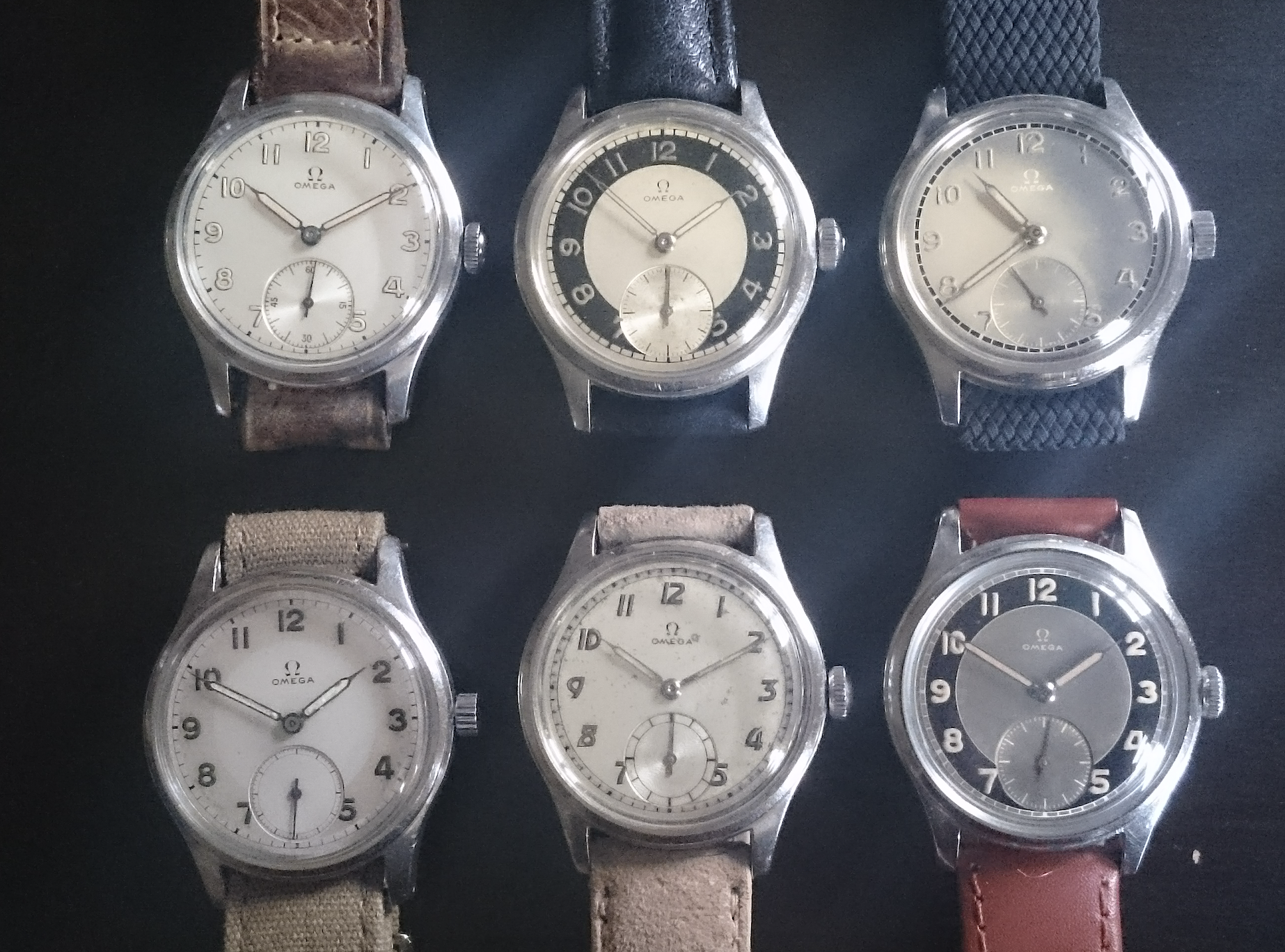

To add to the comparisons: here is another point or two for reference

@tapaptpat
yes I had read these topics before buying mine. it is a model that I find very elegant.
I've seen so many revamped ones that I doubt every time I see one nearly intact.
Anyway, however desirable it was, the price was too prohibitive for me. It was not made for me because I would have autopsied it to remove my doubts, and we would not have started our relationship on a good note.
I wanted to exercise my eyesight and learn as much as possible by talking to experienced members. There was no clear opinion, let's give her the benefit of the doubt because she is really very attractive.
congratulations on your collection which is varied and very beautiful 👍

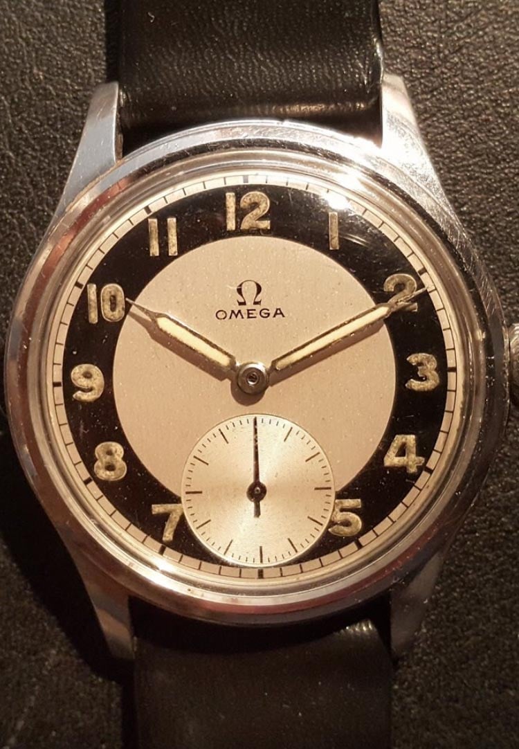

Here's mine - I think it's not redone:

I'd point out the flat A (in the Omega Signature)...
IMHO would phrase it like this:
"most or majority" of dials have serif on A,
some have flat top A's without serif
and some have pointy top A's without serif
