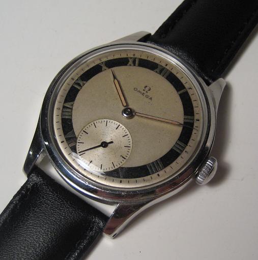

Here's another one. The seller says it's original, except for relume of the hands and indices.
Is he correct?
2,269
4,263
Total redial. Terribly polished case. Totally destroyed watch. So far from a collectors specimen you can get.
But if you're after something shiny and good looking to use as a daily beater, and to show current time pretty well, and you don't care if it's original or not, by all means go ahead and buy it

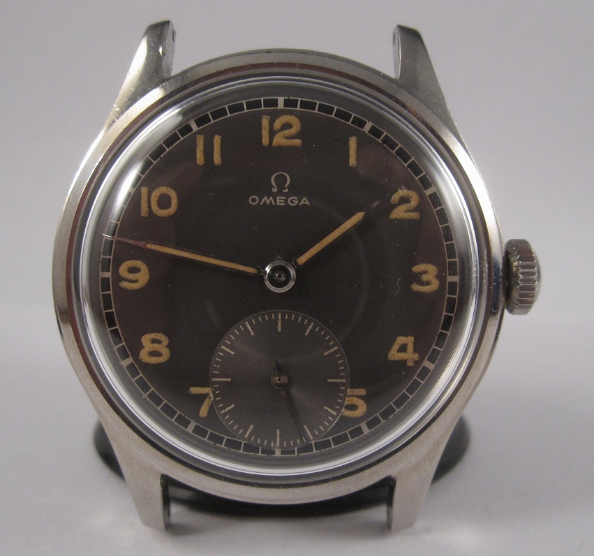

I thought at first it was the same watch as the first one I posted above, but they're two different watches, minute track different, hands different; maybe the same re-dialer, though!

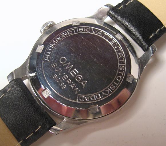

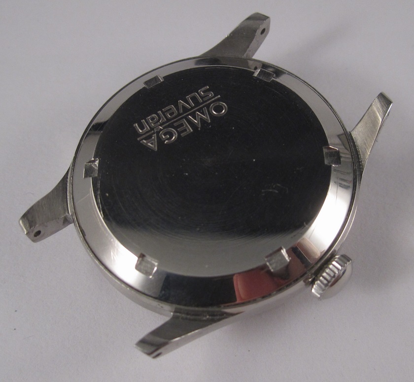

As a general rule, to recognise a genuin Suveran-dial, look out for the closed minute track around the dial. Like this one.
At least this goes for the 2400-5 and upwards, those marked back with the wording " Omega Suveran" only.
2400-5 being a transitional reference; they could also have a backed stamped like this (the older stamping):
When you see a caseback looking like that, I would say that it´s OK if the dial has an open minute track like this

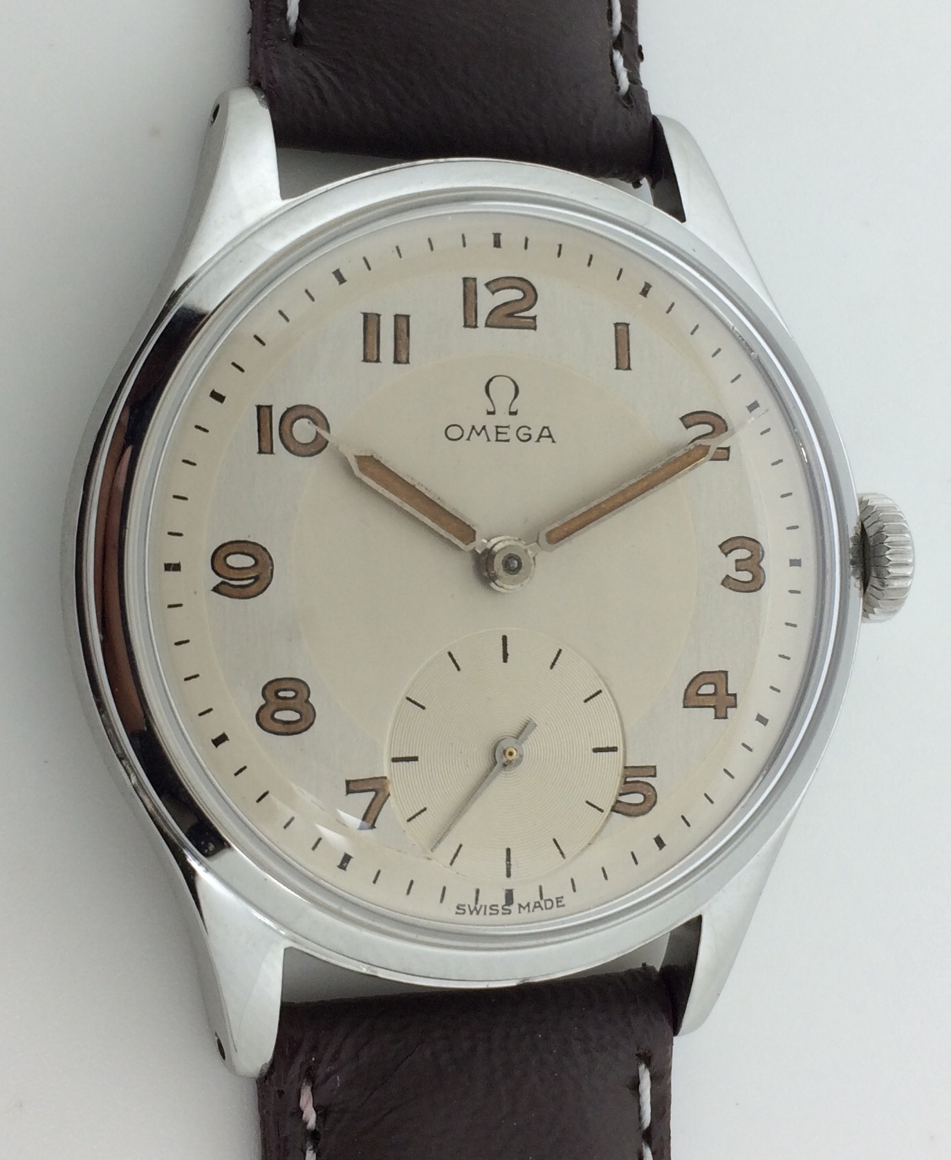

As a follow-up to Martin's nice explication of chapter rings and case backs on these, here is my earlier 2500-4 without chapter ring (and this has SWISS MADE -- I don't think there's a rhyme or reason to its presence or absence in the '40s, but I could be wrong!).

@adam78 I wouldn't expect to find swiss made in the bottom of a Suveran dial. I would be more comfortable in finding that dial on an early ref 2639 (1950)
So, having 'Swiss Made' on a Suveran might raise suspicions..😒
... but the one on yours, @adam78 , looks very well printed and 'factory-like'.
Perhaps yours is just exceptional in more than just its beauty!
3,850
27,371
I think Martin was suggesting that at some point a former owner may have switched out an original dial from a 2639 to this Suveran, not that the dial per se wasn't original.
