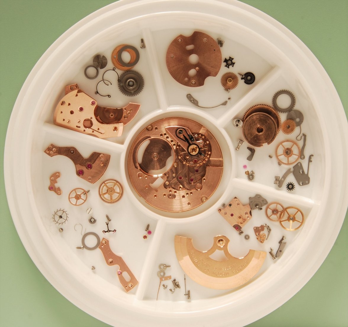

These are the parts in a 503 from one I sold on here a couple of years ago. I use this on my website so, even though it's a customer's watch now, I am happy to post it as they agreed. From the top gore (segment) and going clockwise, the parts are (more or less):
Calendar parts.
Keyless works, barrel and crown wheel. The barrel lid needed a further clean by the looks of it.
Auto system and central seconds pinion/spring.
Train and bridges.
Automatic ratchet wheel and bridges.
@JimInOz - those parts are in the calendar system and you can see them in the top segment. One looks like a Maltese cross and that is its name "Maltese cross for date". The other is the "Date finger" and you can see the gear on the underside that meshes with the hour wheel. When it turns, the finger eventually rotates the Maltese cross and the date advances.
Cheers, Chris
Thank you for posting picture of disassembled 503. The people on this website go above and beyond.
That's no problem as I have a lot of photos like this. I hope you find someone who you're happy with that can look after you.
Regards, Chris
