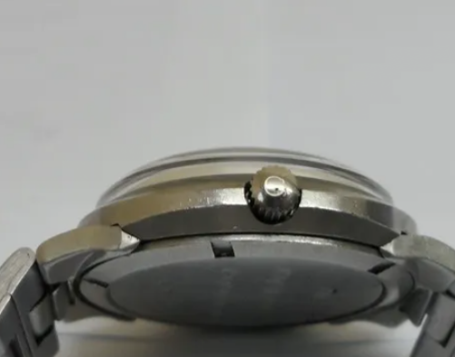

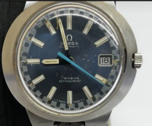

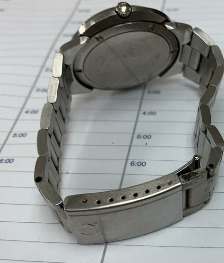

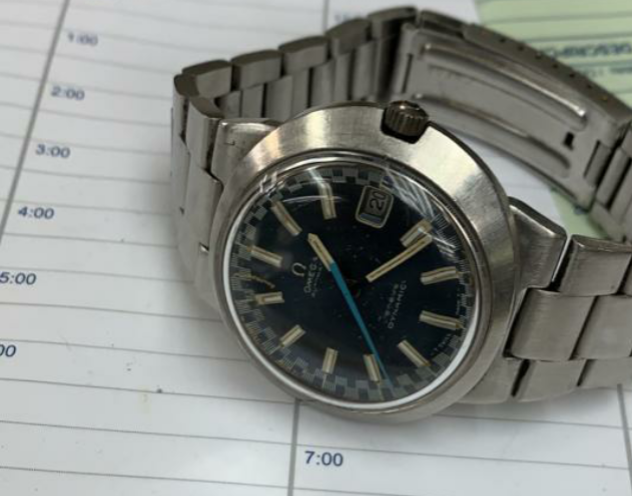

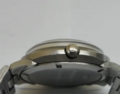

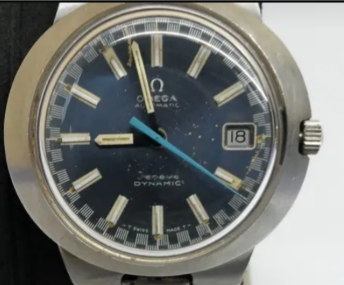

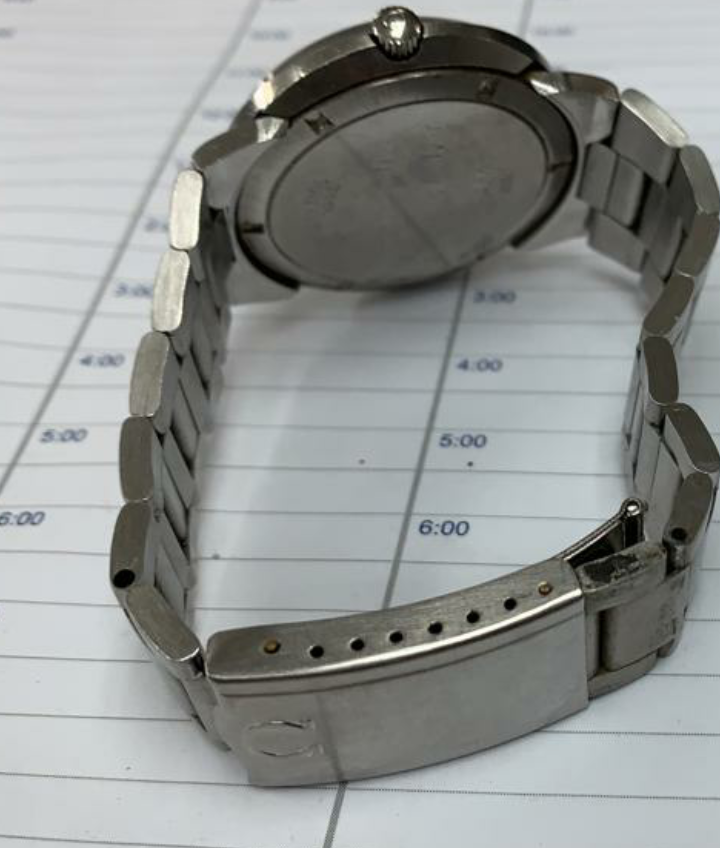

hi, I made this purchase. the bracelet I own an original one. for the dial I have to work. do reprint or better not. the crown according to you. is it original? I see many different crowns.
792
845
The crown looks okay, but I'm not sure if it is "correct". Too bad about the dial though, because it seems like that dial in good shape can be pretty desirable. You would be much better off trying to find an original dial in better shape on eBay. The "bullseye" style does come up pretty often.

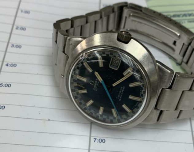

I like the green color of the bull's eye dial, I prefer the racing dial. I have noticed that many leave the original dial without fixing it.
912
4,429
Crown looks good to me from that photo. I’m wearing my Mk I today and my WM swapped out an incorrect, narrower crown for a proper one. Looks like yours.
1,372
2,001
Unfortunately, there's not anything you can do to "fix" the dial other than wait for a better looking one to come along to swap in. Crown looks fine though.

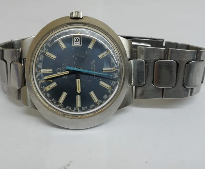

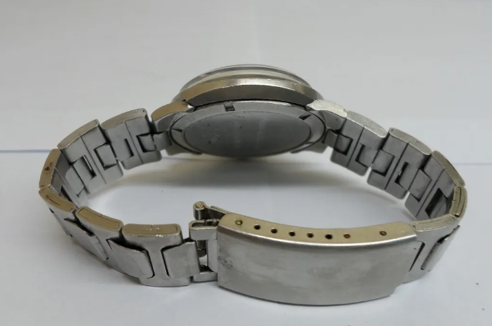

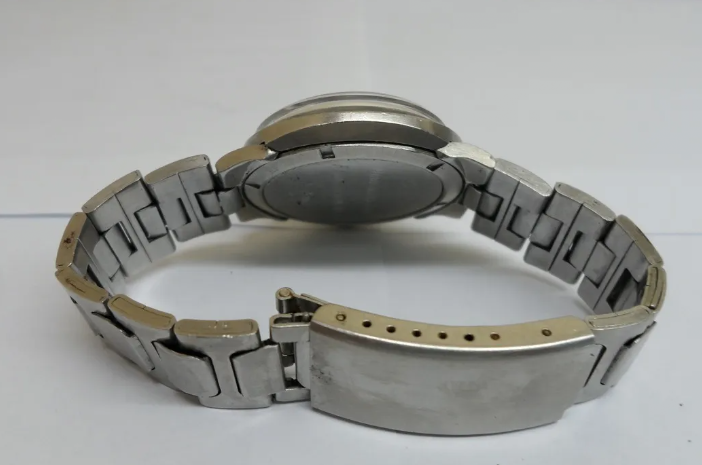

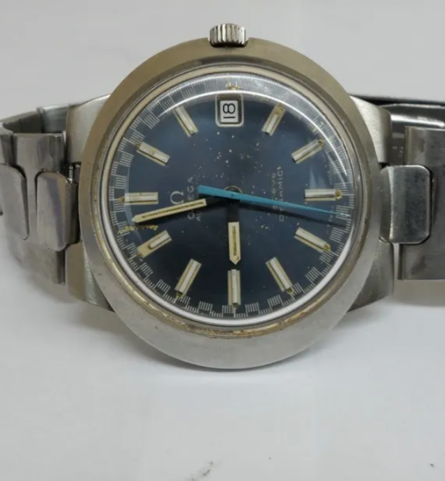

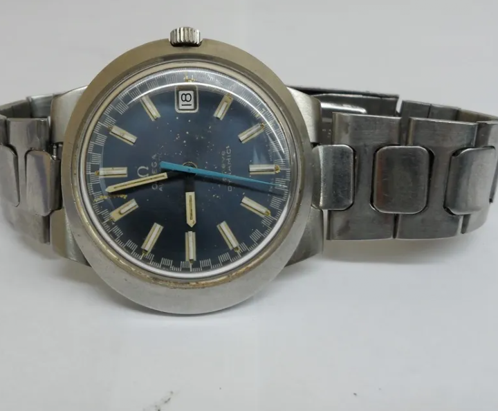

finding an original dial in good condition is very difficult, including a vintage blue or green omega in the collection is also difficult. look at the bracelet it is very worn but it confirmed to me that it is original and very worn. I own the classic.
792
845

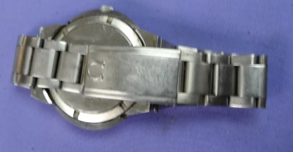

The bracelet definitely isn't original. I have a few originals and none of them look like this. There were alot of aftermarket bracelets made for and put on these watches. Additionally, I'm fairly certain that by the late 60's and early 70's none of Omega's bracelets have the cheap folded side links. If anything, this reminds me of the seiko H link bracelets.

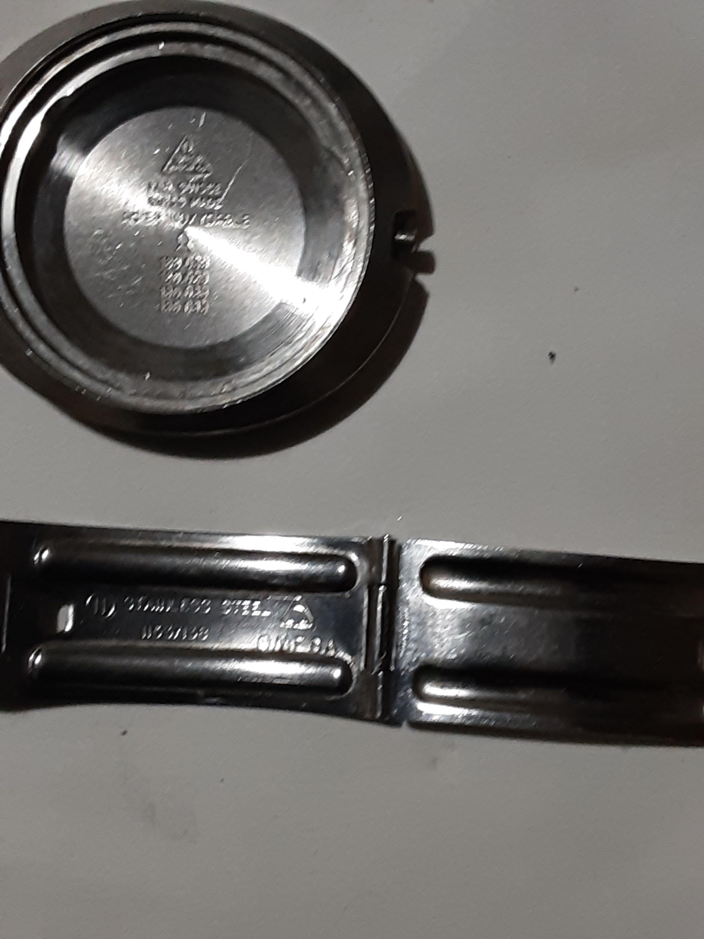

really great help, I have this bracelet look the omega logo is different from others, tomorrow I'll take the references of the bracelet.
156
41
it seems strange to you. I am trying to recover parts that I no longer use.
792
845

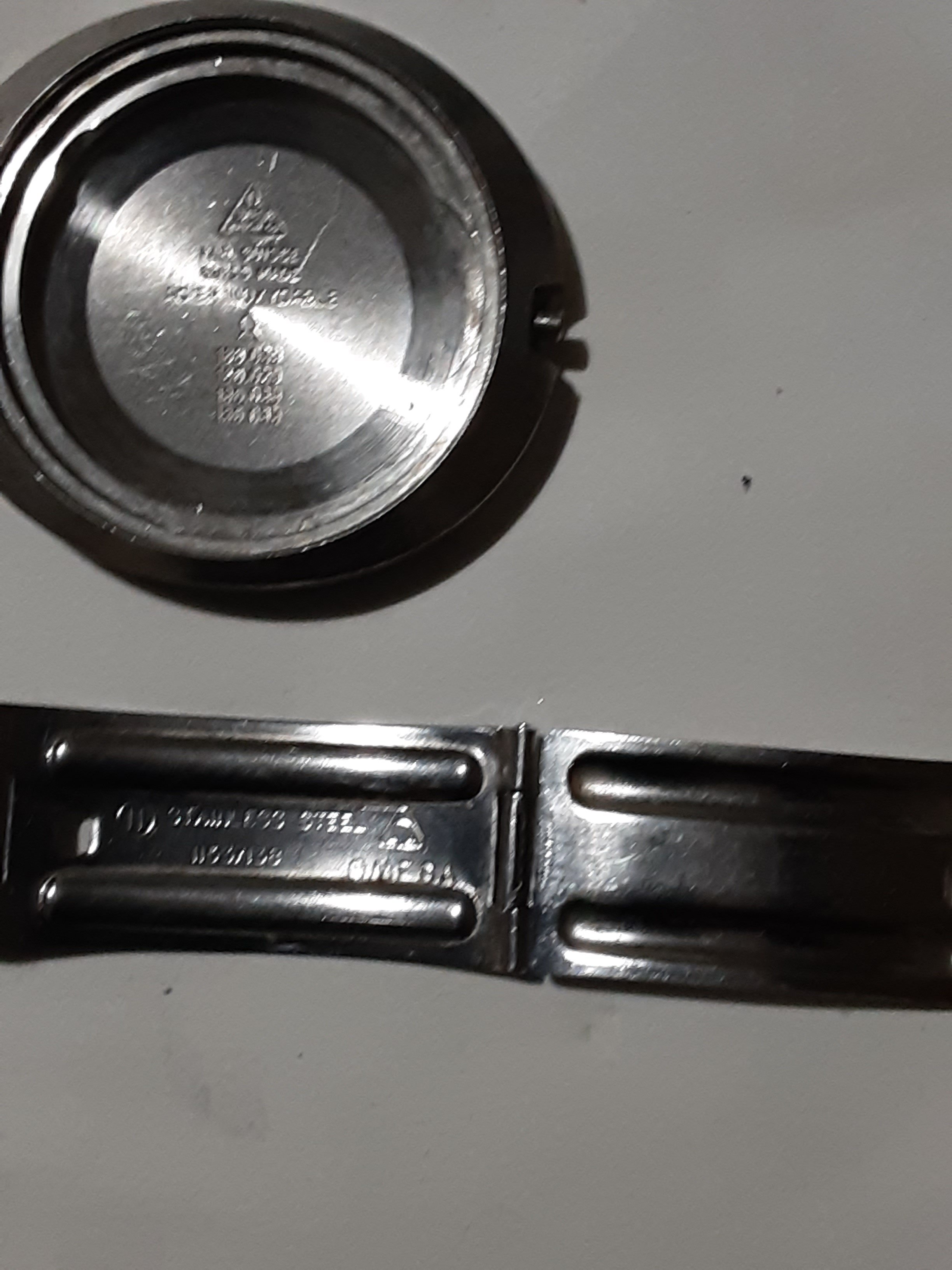

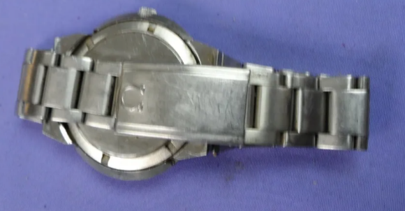

That bracelet looks correct. They do make fakes that look just like it, but the stamping on the clasp would verify authenticity. I personally have that style clasp and the later style with the boxed Omega symbol. They're nice bracelets.

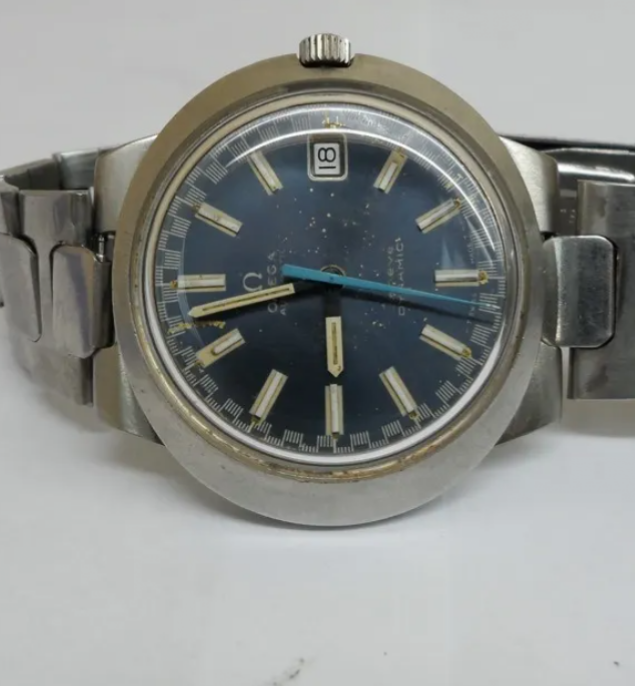

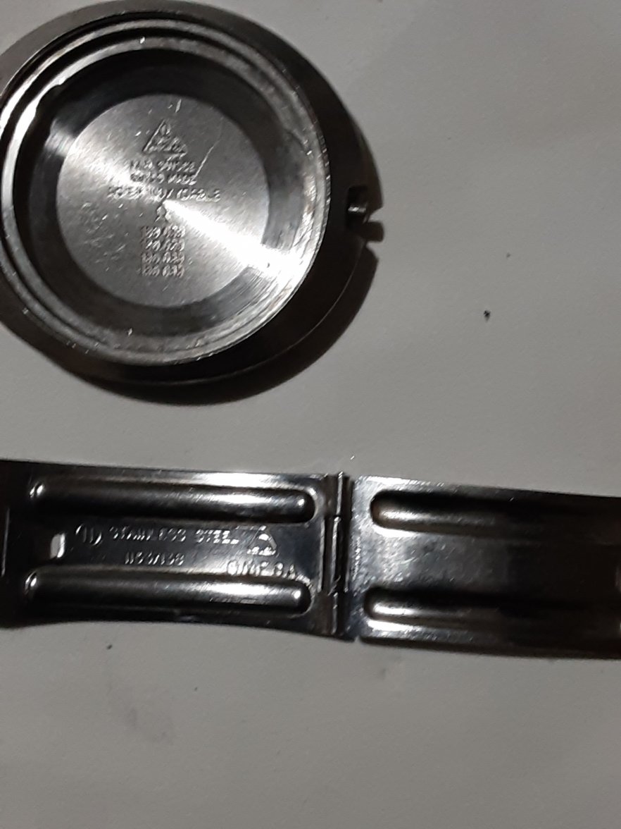

this is the bracelet i have. now a nice wash that I think hasn't been washed for 50 years. Are the indicators 11 and 4 normal?

the date ago in the dynamic makes the vintage. this the bracelet is very good almost non-existent signs, the dial has aged worn writing and the scratch at 11 o'clock. is in working order. making a reprint and riveting the indicators would not cost a lot. I tried it on my wrist the problem for me is too light, comfortable but I like to feel the watch on my wrist. i think i sell it.

wedding rings photo of the number holder back is original or made at a later time. I can't upload photos 27204 top tool 107 waterproof
