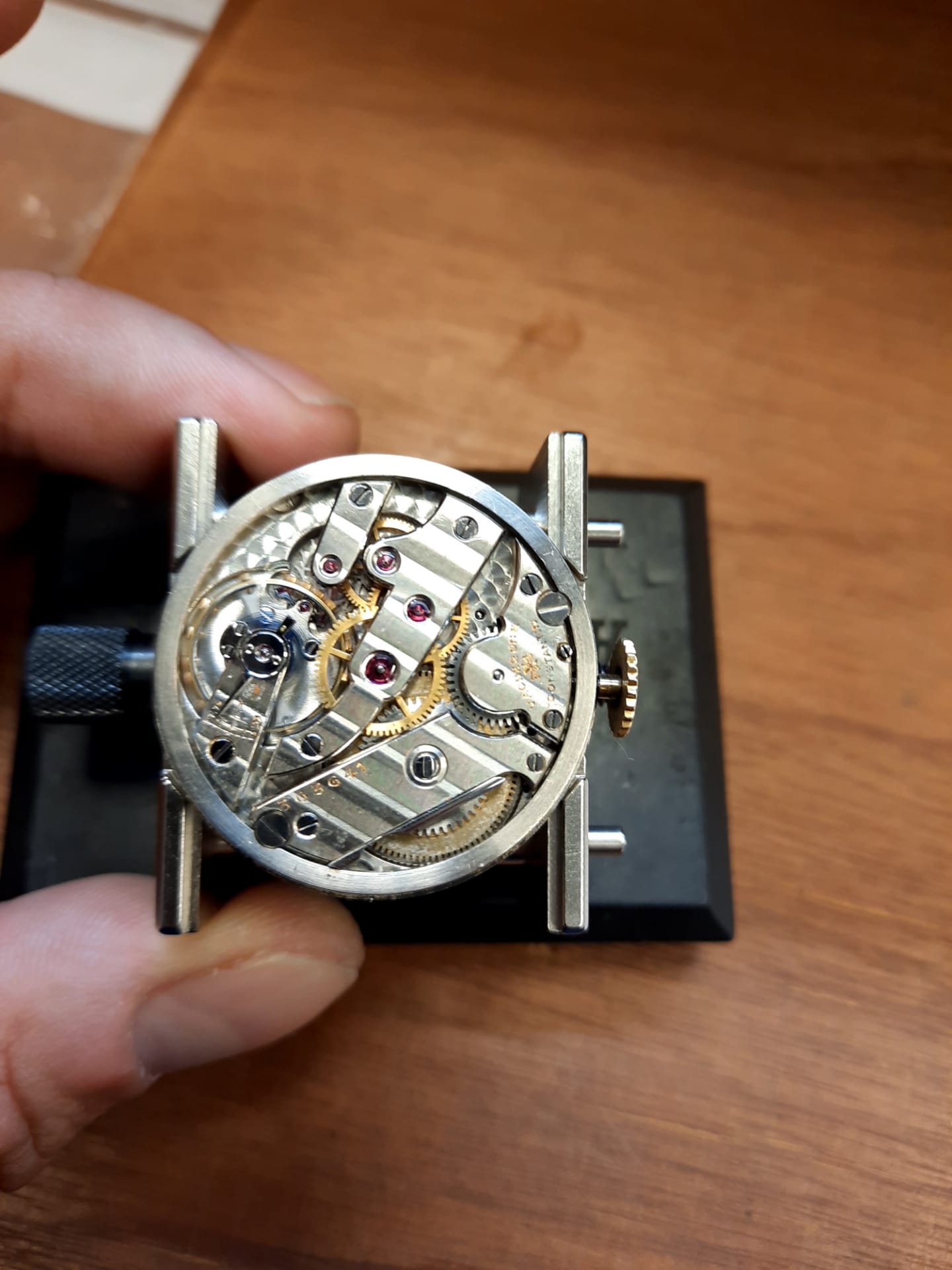

Does anyone know this caliber? (Vintage VC)
Hello everyone.
I would like to ask for everyone's wisdom.
The caliber of the watch I bought,
I can't find the same one on the internet.
Is it a fake or a real one?
If you know anything about this, please let me know!
2,829
4,948

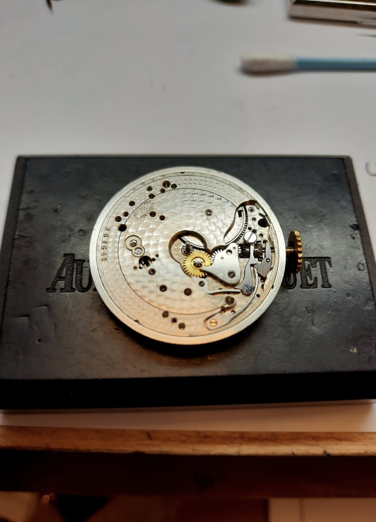

I am not well-versed in vintage V&C but I think that the movement is likely authentic. However, the serial number seems to suggest that the movement dates to pre-1925, which seems too early for the design of the case and dial. Additionally, my intuition is that the movement looks quite large for a wristwatch caliber. Do you know the diameter of the movement? Also, do you have a photo of the inside of the case-back?
Thank you very much.
I will upload pictures of the case back later.
This is the only photo I have now.
8,294
29,372
I agree with @DirtyDozen12 that it is likely a re-cased pocket watch movement.
The dial was produced much later than the other components of the watch.

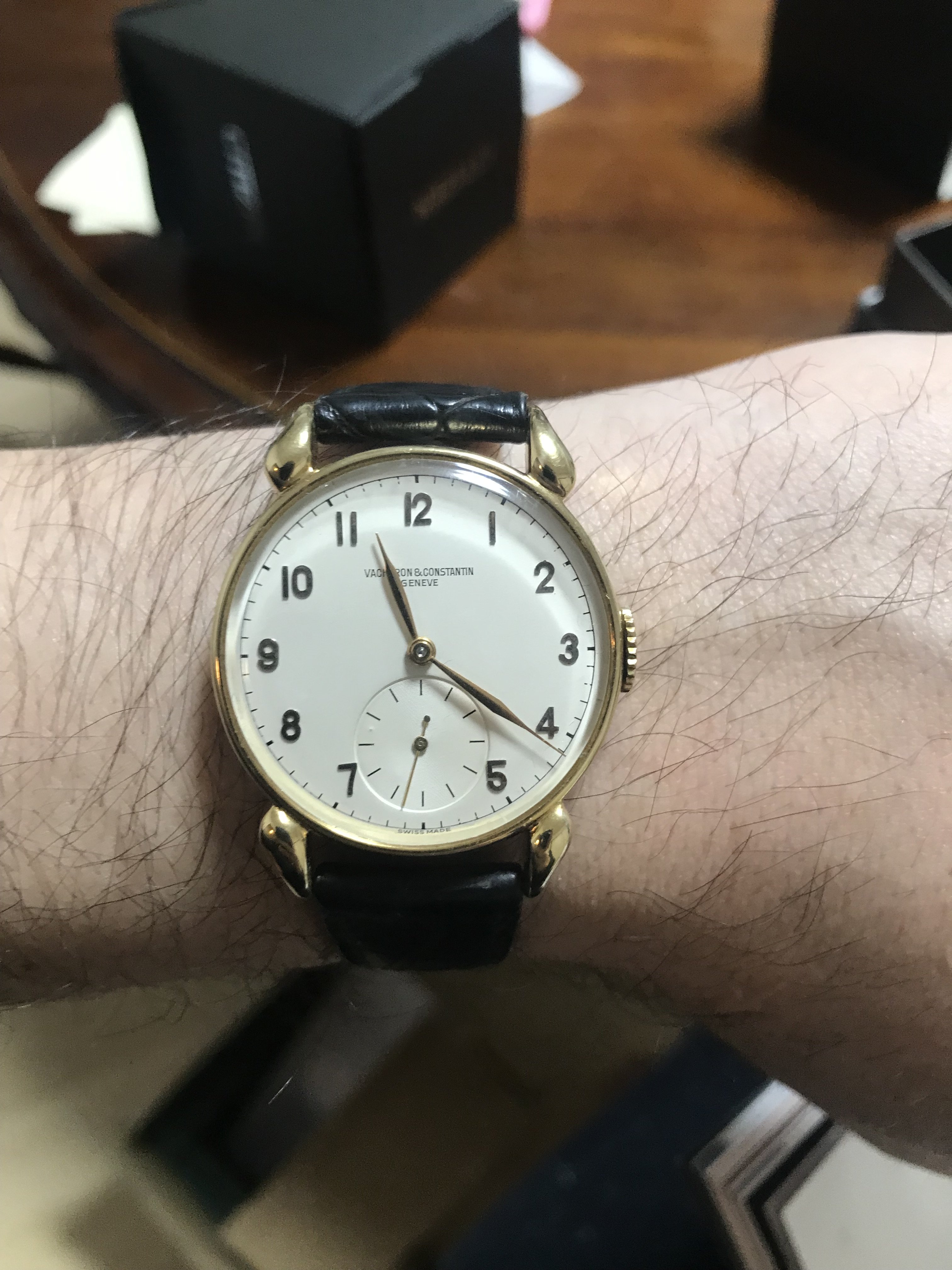

Dial appears to be from 40’s and I believe should be powered by the cal. 453 which this is not.
35
230
hands and crown both not original.
dial at least refinished.
could you share case size without crown ?
