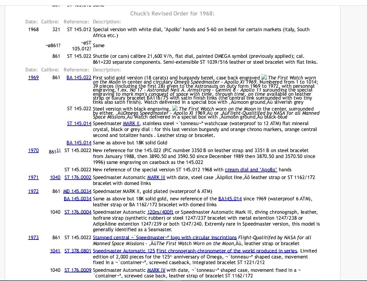

good plan ! I had a look at the info Chuck Maddox published wayback regarding all the different models to see if he had mentioned this, and he does not mention it as limited production but as a variation on the 145.022.
Listed in 1969, st 145.022 in black ;

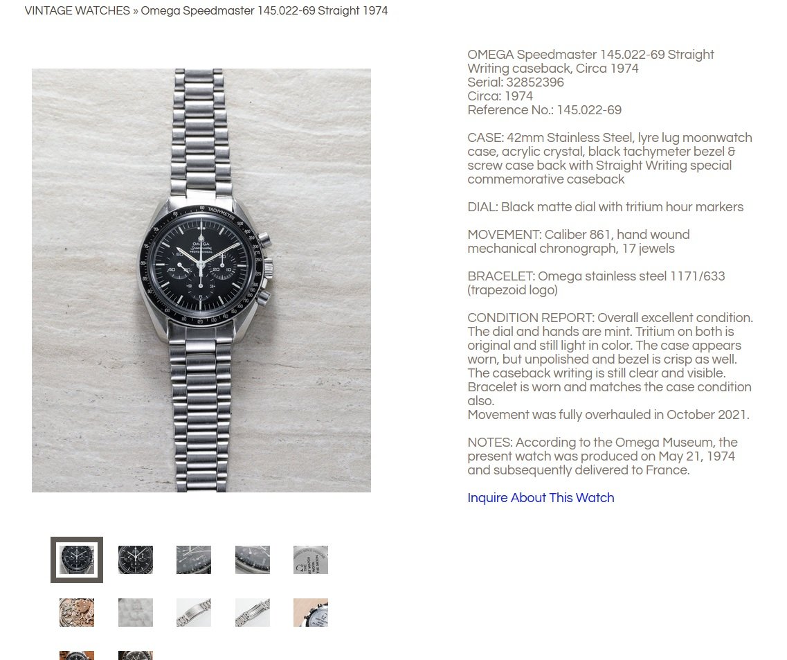

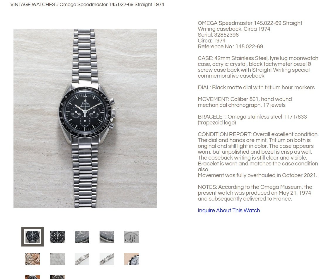

The latest straight writing caseback Speedmaster I have on file: May 1974 ( but a caseback can be very easily swapped )
Screenshot DB1983

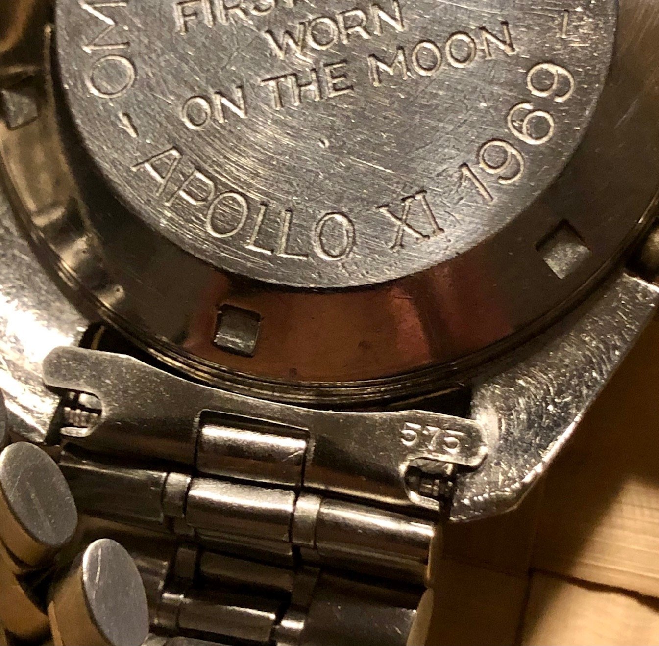

Wonderful thread and appreciate all the info you all have shared. As I have a one owner SW FQ incoming with Box and Papers this thread has been very helpful to understand more of the nuances of the SW references. Serial on the watch starts 31.XXX.XXX but I can't remember the rest so I'll post when arrives but I do recall that it the purchase date mid to late 1973.

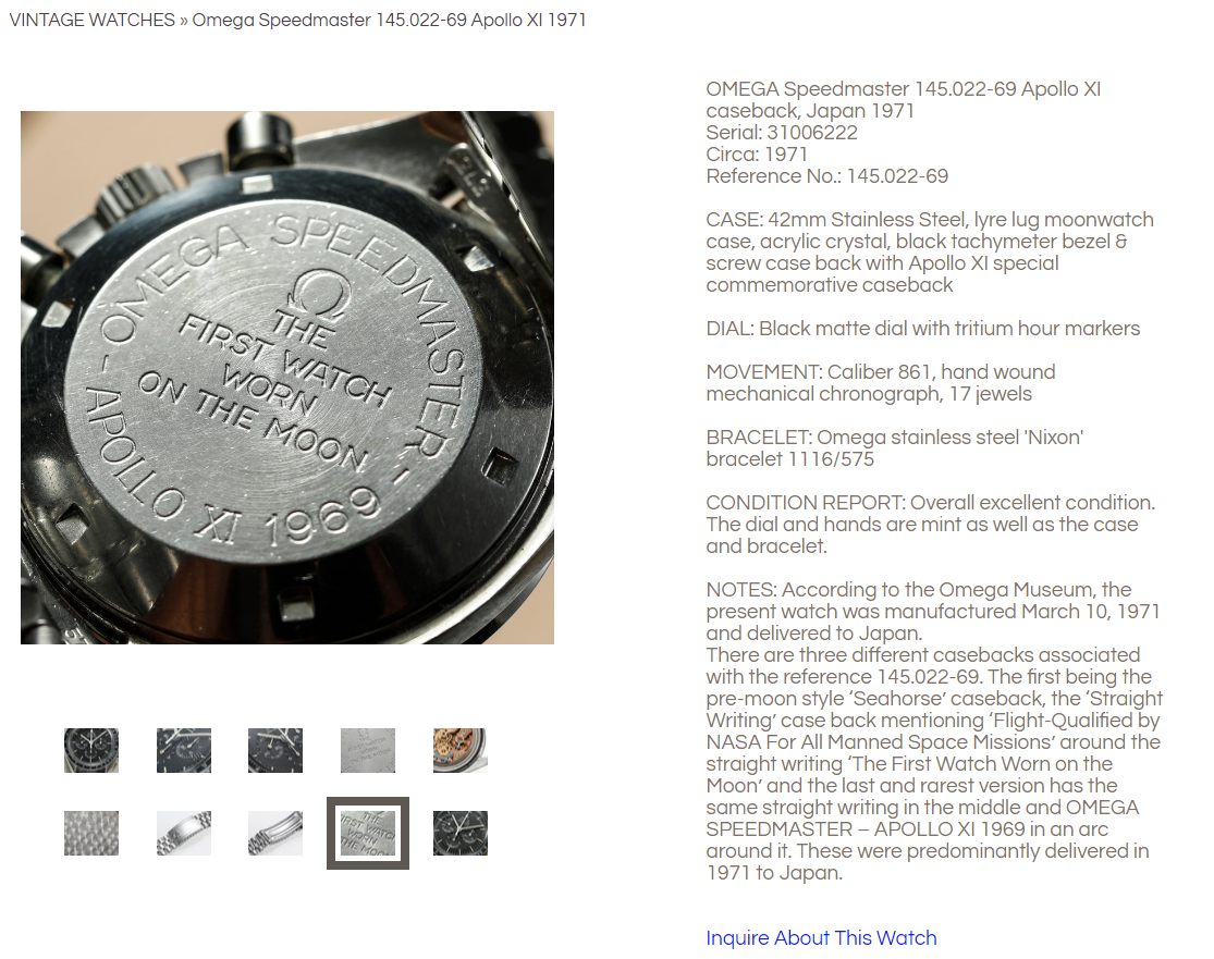

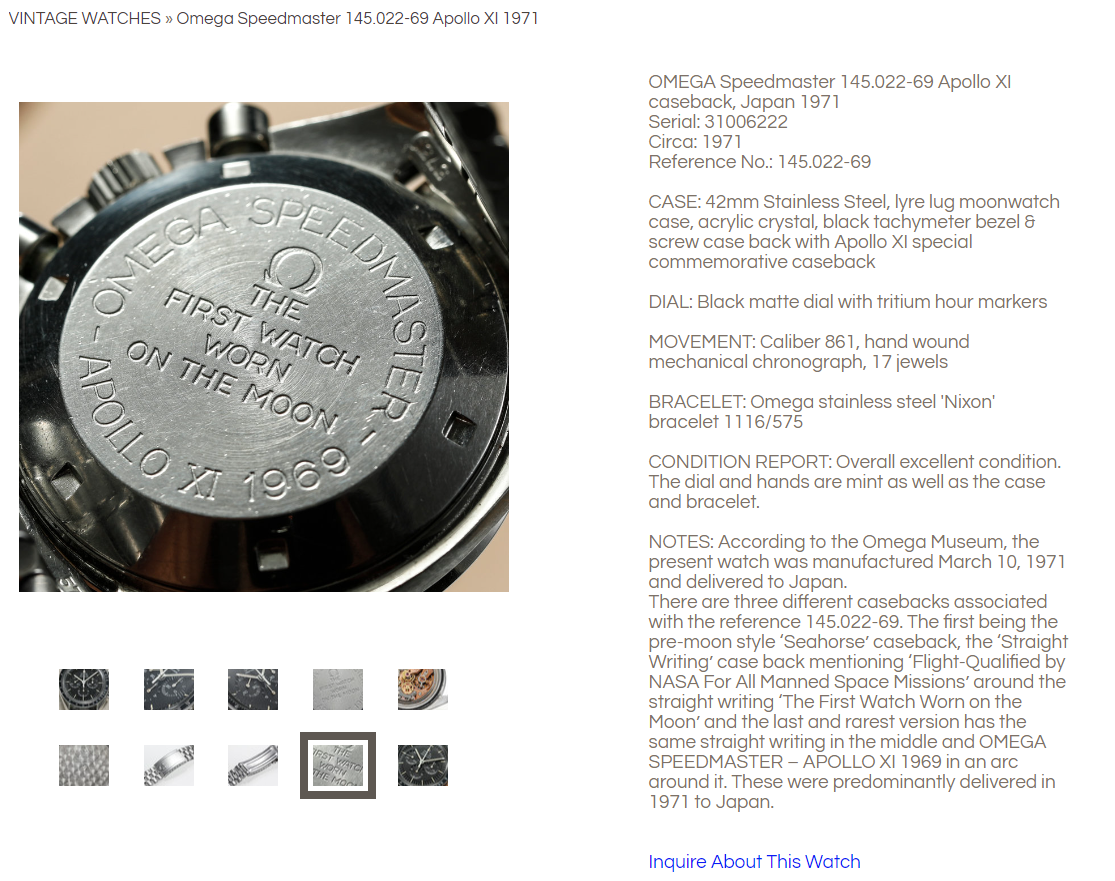

Coincidentally, I went to the Menta / Davidoff Brothers Pop-Up here in Los Angeles this past weekend and the Davidoff Brothers had brought the SW FQ that @SpeedyPhill posted for sale along with the SW A-11 (screengrab db1983) above. With my SW watch incoming I started to ask them some questions about the SW examples the had and what they'd be willing to share. Here's is what I learned from them, that they in turn had said they learned from the Omega Museum. A lot of it also coincides with the info you all have previously written before.
SW A-11:

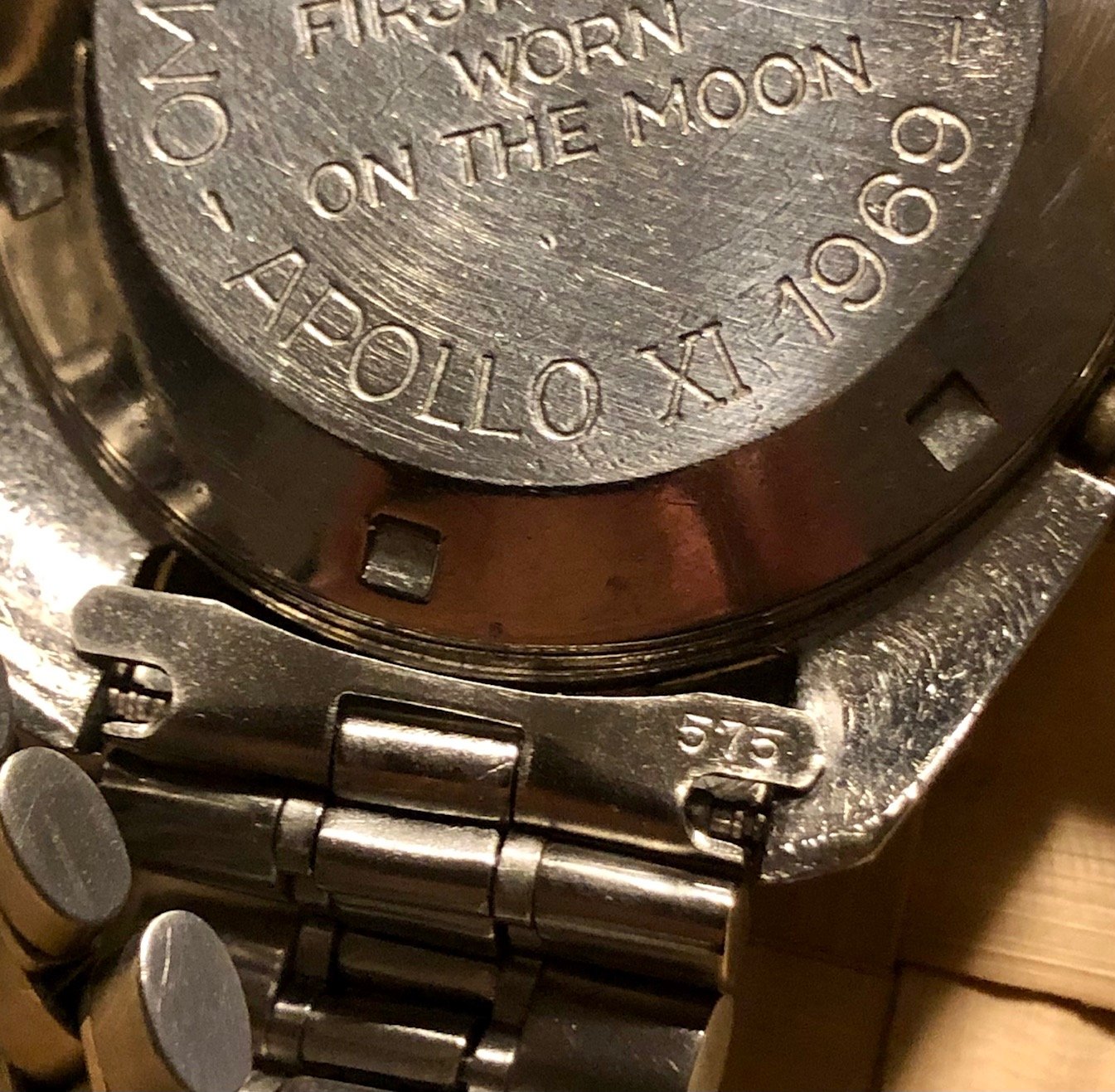

- Predominantly (If not only) delivered to Japan.
- Should have all been fitted with an 1116 / 575 bracelet and end link combo as the Japanese Distributors wanted a stainless steel version that looked as close as possible BA 145.022-69
- Most EoA's for these they have seen have a production date in 1971
- Their contact at the Omega Museum stated that there were around 100 SW A-11 examples produced.
SW FQ
- Delivered to all over the world
- Bracelet end link combo was not regularized, they've seen many from; 1039/516, 1175/47, 1116/575, 1171/633
- EoA's with production dates as late as 1976 (it could have been 1978) but we were talking about dial designs as well so I may have mixed up the year. For sure it was 1976 or 1978. (Sorry about the ambiguity)
- No confirmed number of these is known by them currently.
