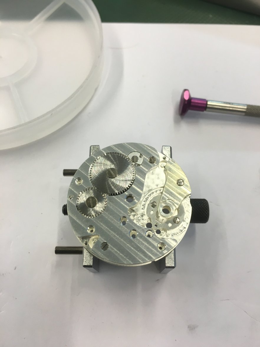

    Doing some tests for the Côtes de Genève finish. Normally you would need a high precision partly automatic machine with a sanding disk designed for the purpose. I had hoped that such equipment was at hand, but it was not. Instead I used this excellent German Shaublin cutter with a mill end cutter.
    Just setting up the damn thing for tests was a pain in the a$$..
    Setup time: 6 hours, execution: 20 minutes!
    Quite happy with the result, although calling them
    Côtes de Genève
    would be blasphemy...
    Adding some snail-like-finish to the crown and ratchet wheel. Subject and cutter spinning opposite directions.
    Polishing the sink of the bushings with a wooden stick and some diamond paste. Took some time to get the curvature of the stick just right for each sink.
    Gilding with gold and silver. First you add a gold layer to the subject. The reason for this is that silver will not attach as well to brass compared to gold. A bid sad after the gilding because something went wrong and next day a layer of dirt appeared on the surface. And it is impossible to get off... I called a goldsmith for advice, but she simply told me that they ship everything out the house for gilding, as it is a difficult process and the outcome very hard to control...
    A little preview of the movement. Still missing some screws, wheels, jewels, a balance, etc.
    You might notice that the balance bridge is slightly more yellow. To get the color right, the bridge went through another gilding process...
