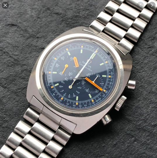

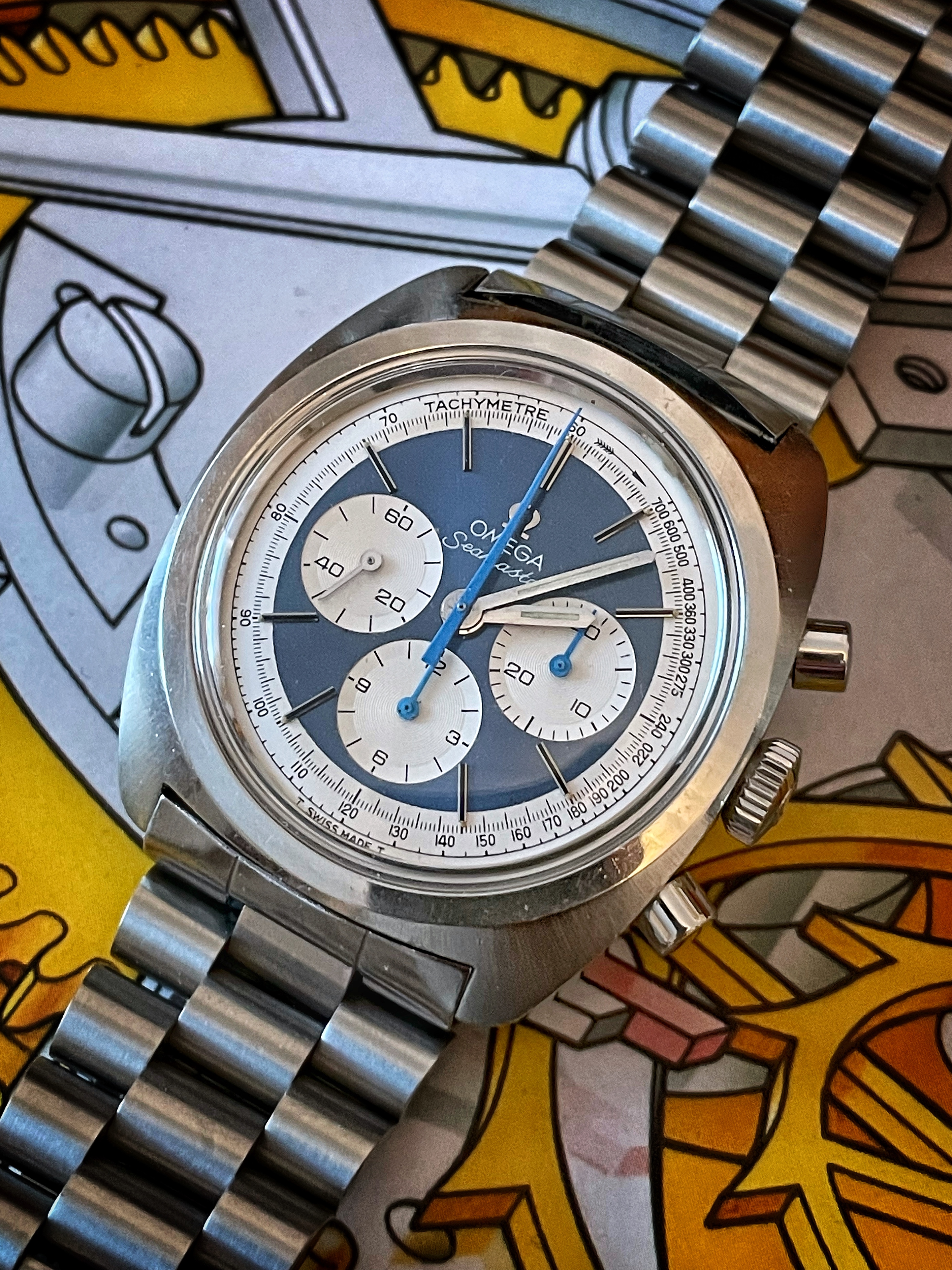

The coming 145029 (without the bracelet) :

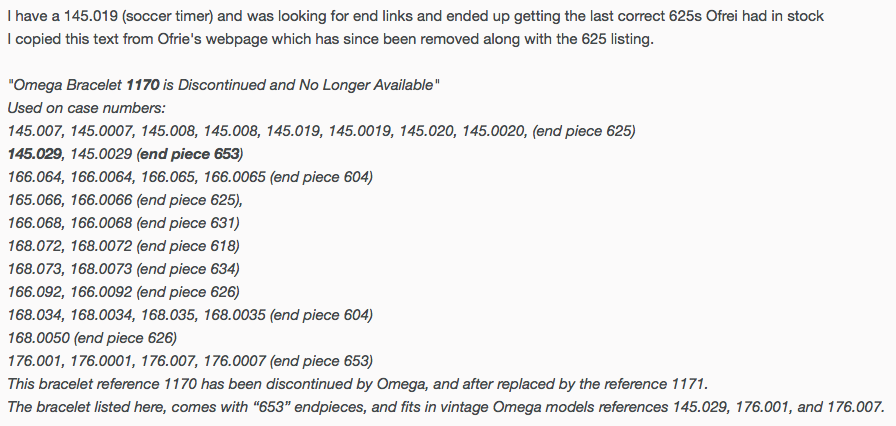

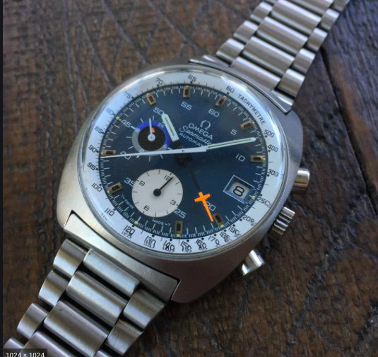

The same watch with the 1170 bracelet + 653 end links

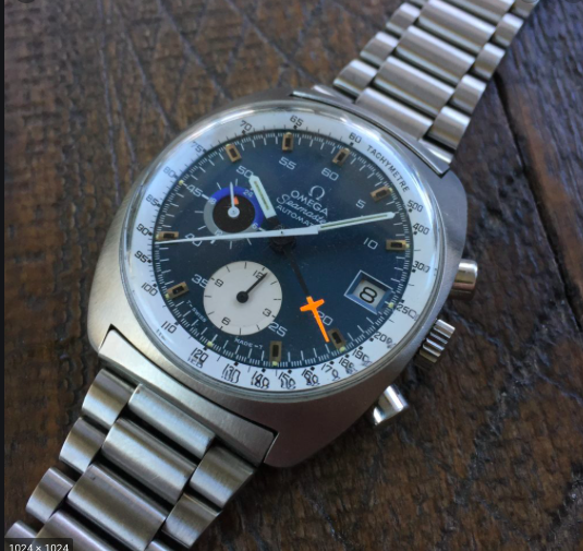

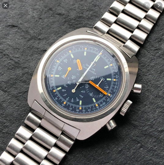

and finally the 176.007 with the same bracelet

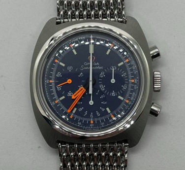

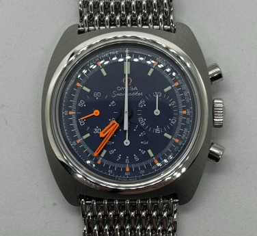

and here is the picture from UncleSeiko bracelet on a 176007

I tried it... and failed.
Close but not close enough !
The endlinks prepared by Uncleseiko to fit a 176.007 don't fit in the 145.029. Hence it should not be exact same case between the 2 models.

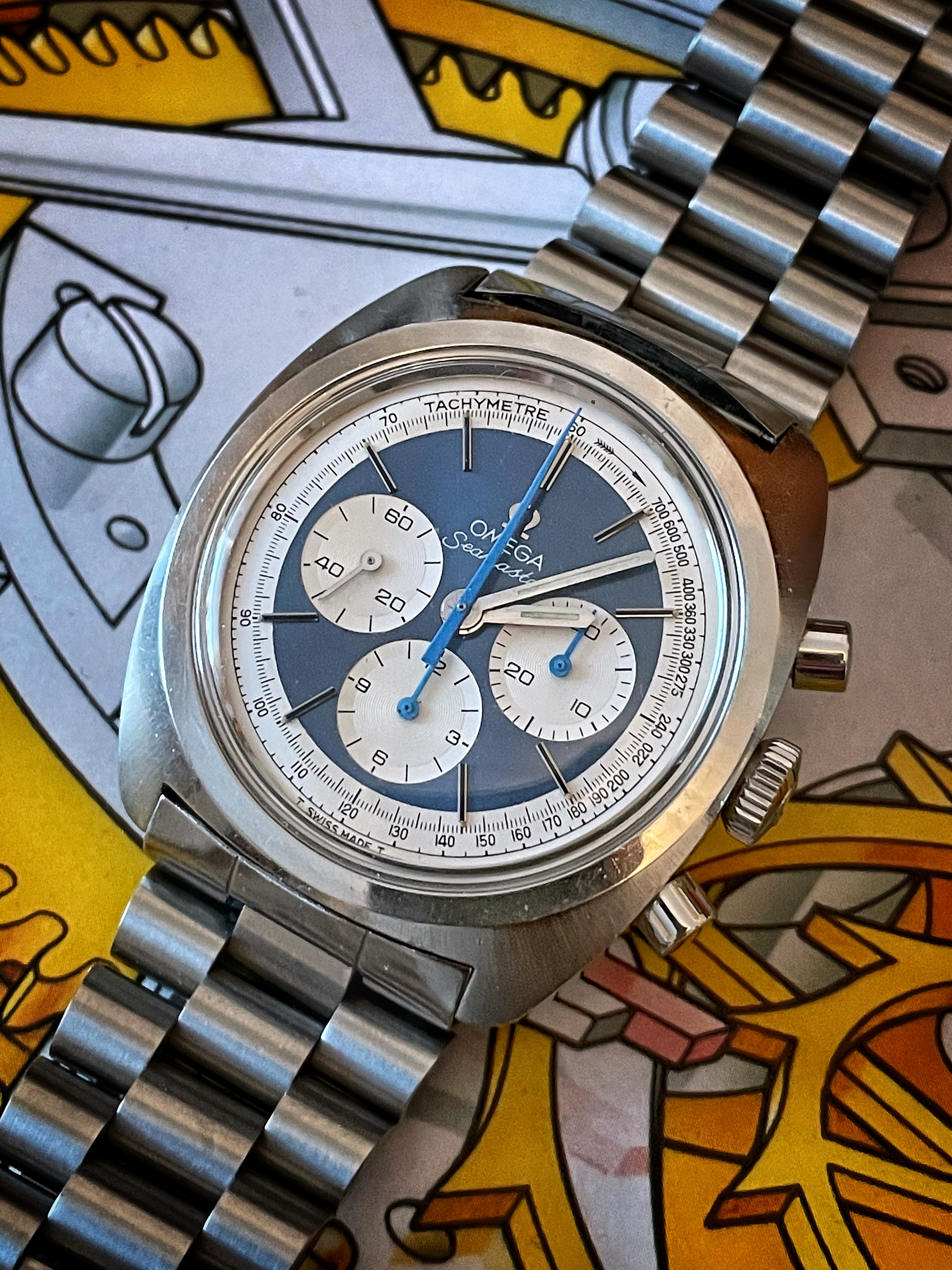

Attached a pic of my watch with 653 and UC bracelet, you can see that the middle part of the bracelet is too narrow. In original 1170 it's wider.

Thanks! It's my favorite too at the moment, the dial is really clean and I love cushion/tonneau cases. I have an original 1170 bracelet on the way to me, so maybe soon the watch can have the bracelet it was meant to have.
