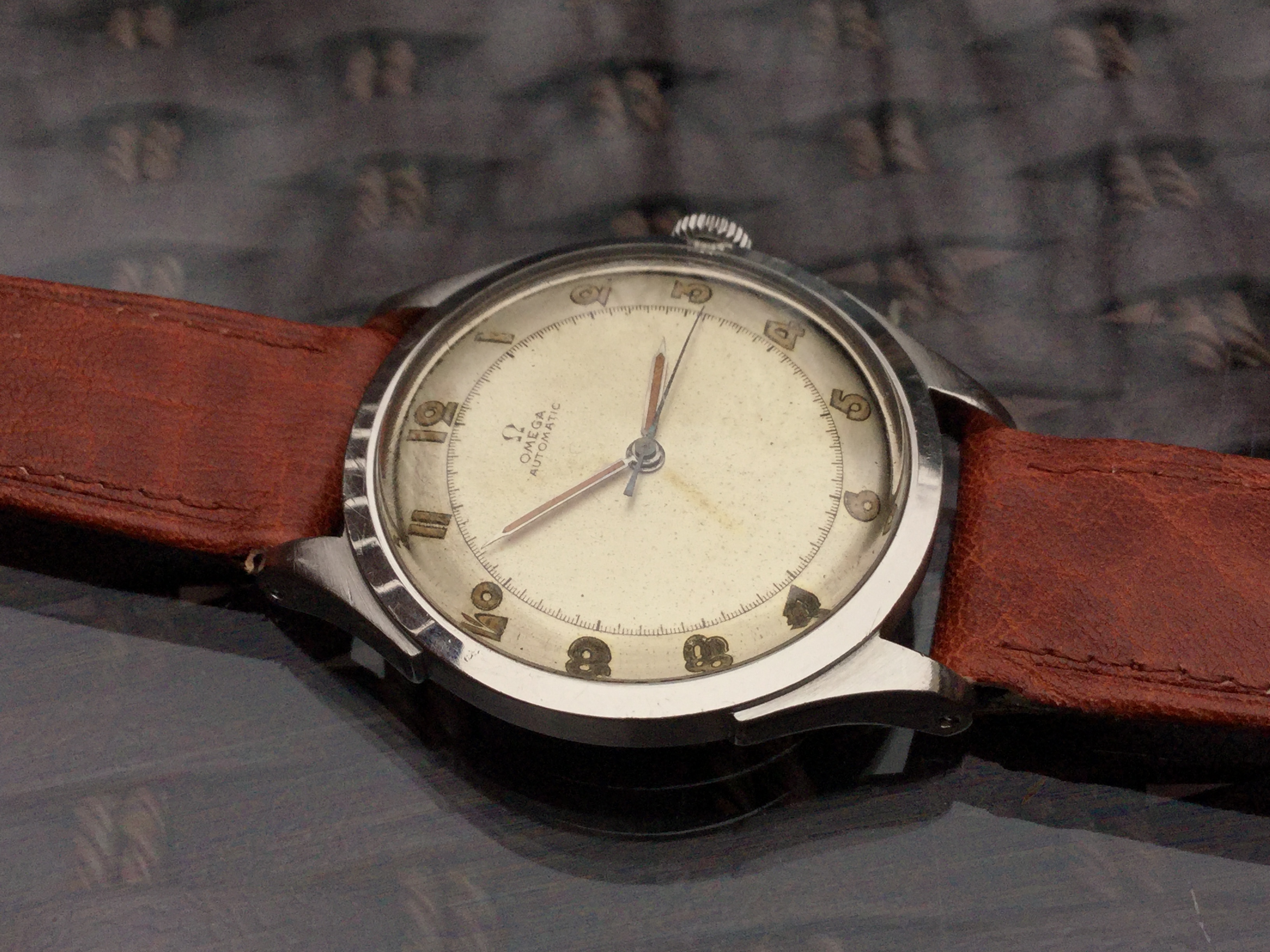

Mine is a 2421-2. No logo on the crystal so I wonder if it's original.

I would not expect a logo on an original 1940's dress watch. And I would not really expect to find an 1940's , still with the factory crystal , after 75 years.....

Is there a way to determine if the crystal is the "correct" one for this model? Or even determine if it's an Omega?
No.
If it fits well and has the correct profile it could be original, or it could be a replacement, there's no way of knowing.
However, with the age of the watch, if the crystal was original, I'd expect to see a lot of structural degradation, e.g. micro cracks in the plastic.

No.
That"s a good point; there is little or no crazing to be seen, which indicates it is probably a replacement.
