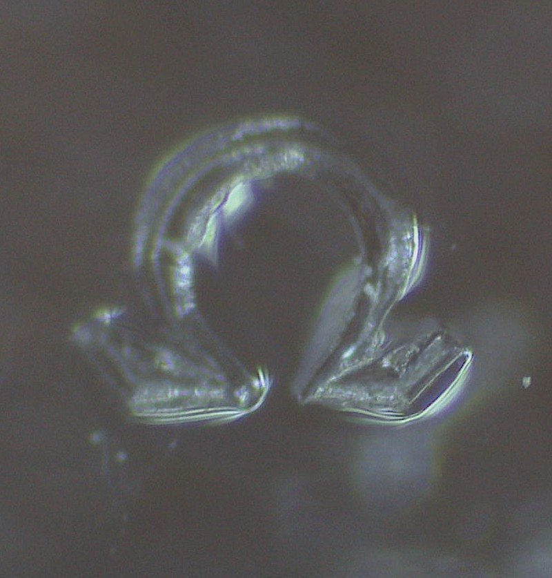

Mravk, btw: the logo is "stamped" inside the glass.
Most vintage Omega crystals I've seen have the symbol in raised profile on the underside of the crystal.
That is, the 惟 is stamped in the face of the die used to form the crystal.
(Thankyou Captain Pedantic 馃槈).

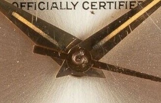

Here's a pic I took just now. It's hard to see but you can just make out the raised logo.
It's also easier to stamp/engrave into the die, than to create a raised 惟 on the surface.

As the hesalite is made of 3 layers to improve the durability, I`d say the symbol is stamped in the middle layer, as nothing can be felt on the surface in/out. But just my opinion. The orientation as said above is just a matter of focusing on detail, there are also some variations of the Omega symbol font during the course of history.

3 layers? Where does this information come from?
BTW it's stamped on the inside, and can clearly be felt there...

I read it somewhere in a talk about vintage hesalites, and the fact is, that on vintage crystal I can`t feel anything using the nail.
But may be also because the vintage symbol are much more subtle compared to todays service ones.

Vintage are more faint, but they can be felt typically. If you take a piece of peg wood, sharped in, and move it across the logo, you can feel it catch.

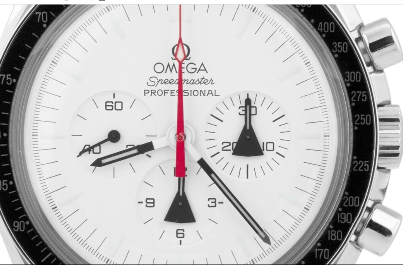

I notice plexiglasses were used in modern Omega watches as well, such as the Alaska Project. Its surprised to see they dont aligned properly.
