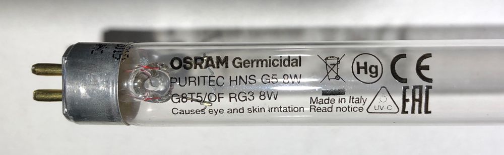

You really need short wavelength UV (sometimes called UV-C) to effectively disinfect. So you want to check that the UV bulb you purchased emits in that range. Typical black light bulbs filter out UV-C. Obviously the effectiveness also depends on intensity and time of exposure.

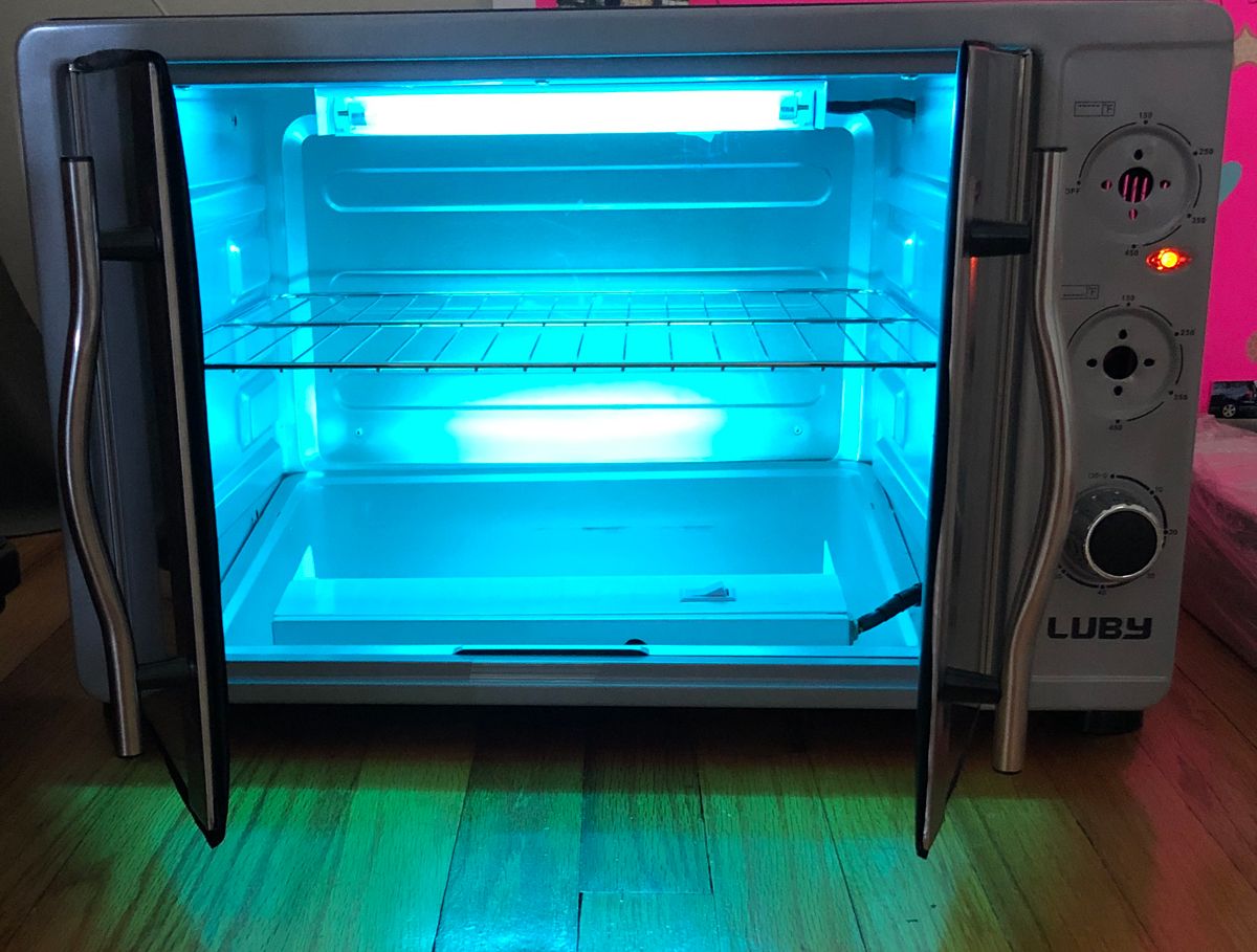

With that out of the way, I built my own UV-C sanitizer which is similar to what nail salons use to sanitize intruments, though I use two 8-watt UV-C tubes instead of the typical single tube.
An inexpensive system can consist of a simple under-the-counter 8-watt fluorescent light fixture, the correct germicidal lamp and a cardboard box - which is what I used while I was waiting to put together version 2.0
I bought a desktop oven with essential specifications that it must have an inner cavity at least 12 inches wide and with a mechanical timer that ran for at least 30 minutes. My intention was to remove the heating elements and install two fixtures, one top and one bottom.
UV-C light can be damaging to the eyes so no light should leak from the cardboard box or housing while in use. The doors of the oven were clear glass, so I laminated black polyethylene to the inside doors.
This is the tube I used:

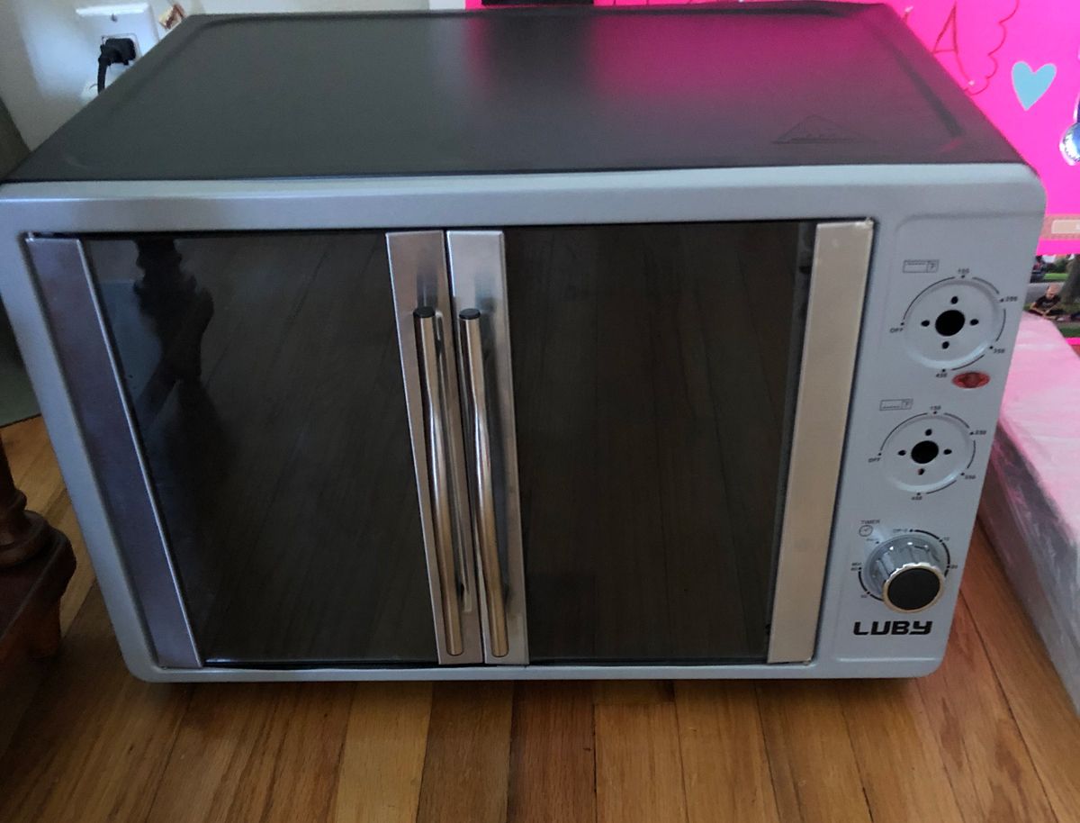

And this is what the completed sanitizer looks like:
Watch, wallet, credit cards used, gloves, mask, car keys and afterward, the shoes that I wore go in there for about 25 minutes.

Very impressive @Joe_A! I love that DIY project. 👍
Now you need to partner up with a microbiologist to test it. 😀
The UV will be hard on the polyethylene, so you should keep an eye on it and replace it as needed. Or replace with some sheet metal.

The polyethylene is a heavy conductive film I purchased from McMaster-Carr:
"Carbon-Filled Slippery UHMW Polyethylene Film Electrically Conductive, 25" Wide, 0.01" thickness"
I selected it based on it being 10 mil thickness and suitable for cutting to shape - and because it was available. 😉

For the above identified reason, I have a germicidal tube placed both top and bottom. I do not have to rotate the object. The light must shine directly on the object and the inverse square law applies. The distance between the light source and the object should be short, order of magnitude, 6" if you want a reasonable result in 25 minutes.
Hospitals are converting BSCs to add UV-C light, but the bio-safety cabinets are so large that, when you put a surgical mask in at the bottom, it can take many hours of exposure to achieve the desired effect.
The approach I have taken is not original. Google "nail salon UV sanitizer" and you will see similar appliances. However; these nail salon products typically use only one 8-watt tube placed at the top.
If this crisis goes on much longer, I will add two more tubes, making it a 32-watt system. 😉
