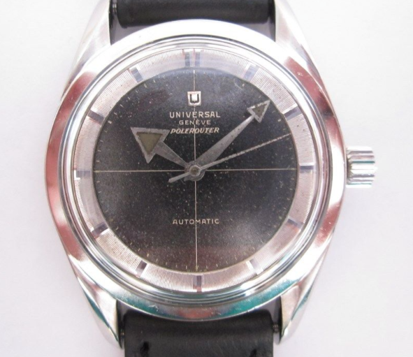

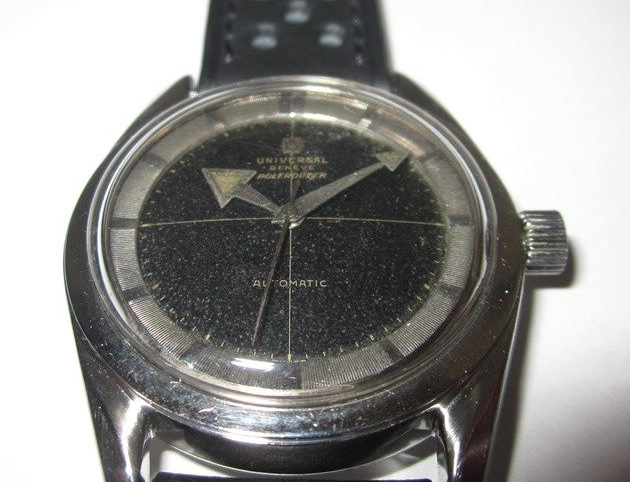

Here's another dial without Polerouter Sub written on it, sorry for the first pic it's on my old computer I can't remember where I got it...

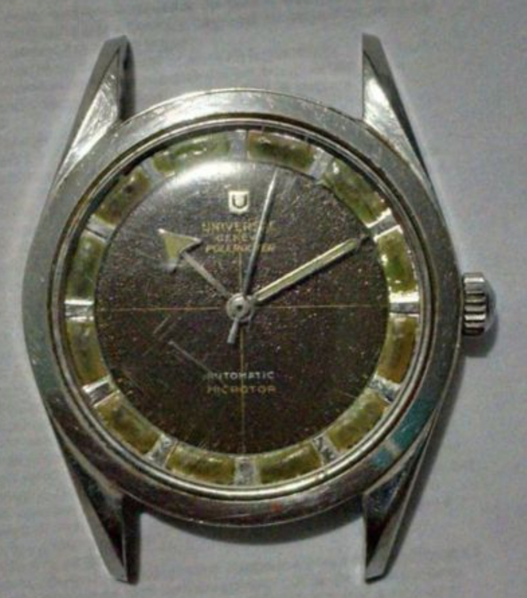

The new one on Ebay has at the very least had a refinished dial.
2,959
6,317
Look at the minute indices. More than half of them are missing/severely faded. 😉
70
31
Yes, it has a lot of wear, the ad says "Original cross-hair Black Dial with signs of aging and some light scratches,
never repainted".
Looks original (and over 50 years old) to me?
2,959
6,317
I don't believe those indices just disappear with age. It's also important to consider that the fading is not consistent over the dial. Some indices are far more visible than others.
It's more likely that the redialer coated the dial too heavily (and unevenly).
70
31
If you are talking about the round hour dots/marker they aren't on the versions (with the Flèche hands) that I have seen. There is only a plain outer minute tick.
Some of them appear to be faded/gone but these photos are poor and black dials are notoriously hard to photograph.
Maybe somebody can find some versions that have them, I just haven't seen one.
The dial looks legit to me.

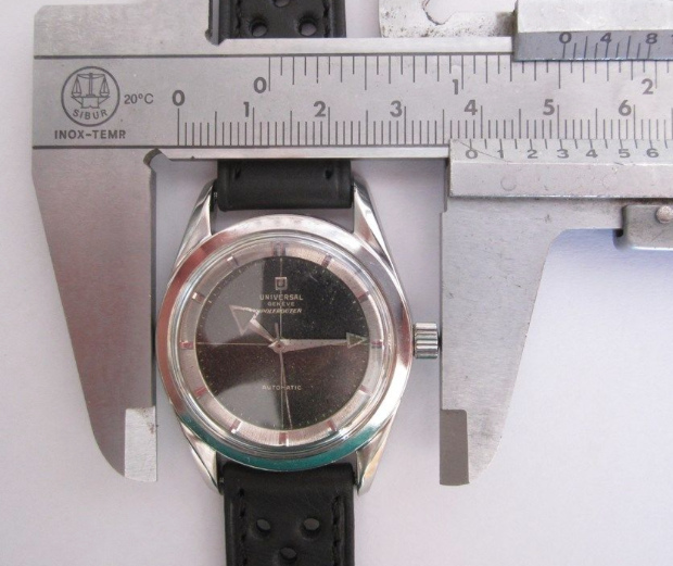

128
260
Could someone help me out and tell me what's the correct crown design for the bumper broad arrow models? Also diameter measurements would be really handy 😀

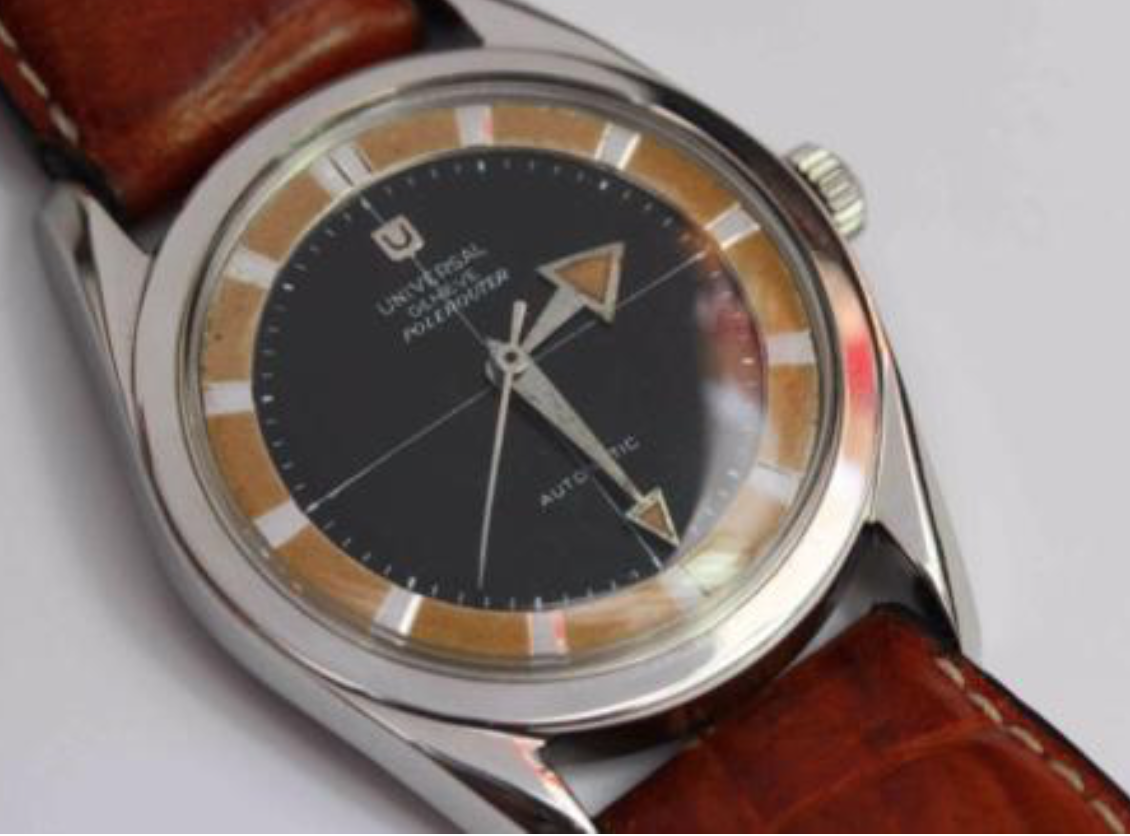

2,451
9,934
Here's 2 of the last 3 to sell on Ebay.
One with fake hands and probably falsely lumed chapter ring and the second one a redial.
The text doesn't look gilt and the applied logo is too high above Universal.

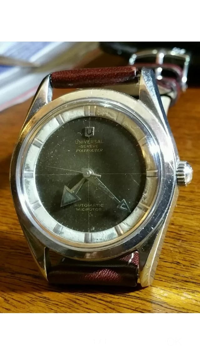

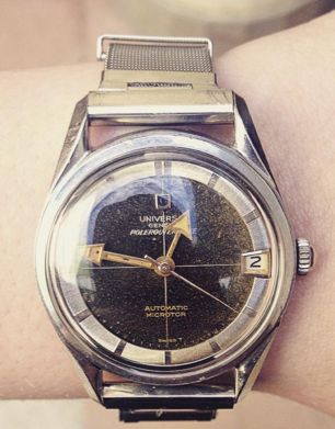

1,560
4,420
Hello peeps. Sorry for the reply 1 year afterwards, but I was wondering if the hands on this stunner could be original or not ?
I have seen some microrotor Polerouters with arrow hands, but I've never seen a polerouter date with these hands... Any thoughts ?
Thnaks in advance !
2,959
6,317
The hour and minute hands are not original. The constant seconds hand is probably original.
1,560
4,420
Thanks for your quick reply. What makes you think the arrow hands are not correct ? I'm asking in order to best understand the reference 😉
