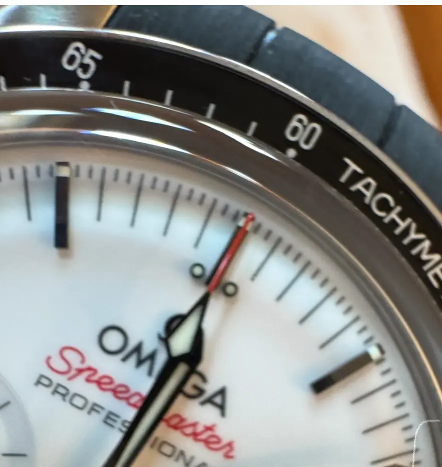

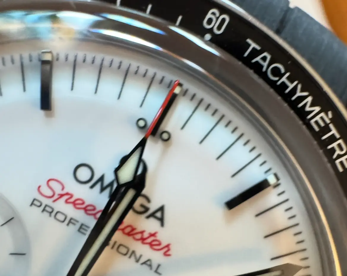

Disappointed with Omega QC and Swatch Group Support - Misaligned Hand Brushed Off

Does Omega have a specified tolerance for chrono hand alignment @Archer?
I know the OP is getting pelters for this but I have to say, if it were mine, I wouldn’t be satisfied with it and I would be seeking to get it adjusted.
2,453
7,058
Very unlikely that it moved once it weas installed. They are put on very tightly, so unless this was some form of defective hand, I doubt that is what happened.
Is the "misalignment" of hands within Omega's specifications (as the OP said Omega claimed in the original post)?
Edit: @Davidt beat me to it!
29,820
77,175
Yes, there is a tolerance. Simply put, if you draw a line down the exact center of the 12 marker, the chronograph hand can be off either side of that line by the width of the very tip of the hand.
So if for example the hand is off to the left of the centerline, as long as the right edge of that hand's very tip is touching that line, it's considered within tolerance.
To put that into a concrete number, I just used a micrometer to measure the very tip of a typical Speedmaster Pro hand, and it is 18/100ths of a mm wide, which is about the same as the thickness of the hand as well. So the tolerance is a little les than +/- 1/5th off a mm.
Note that this check would be done with the movement outside of the case to eliminate error from the crystal.

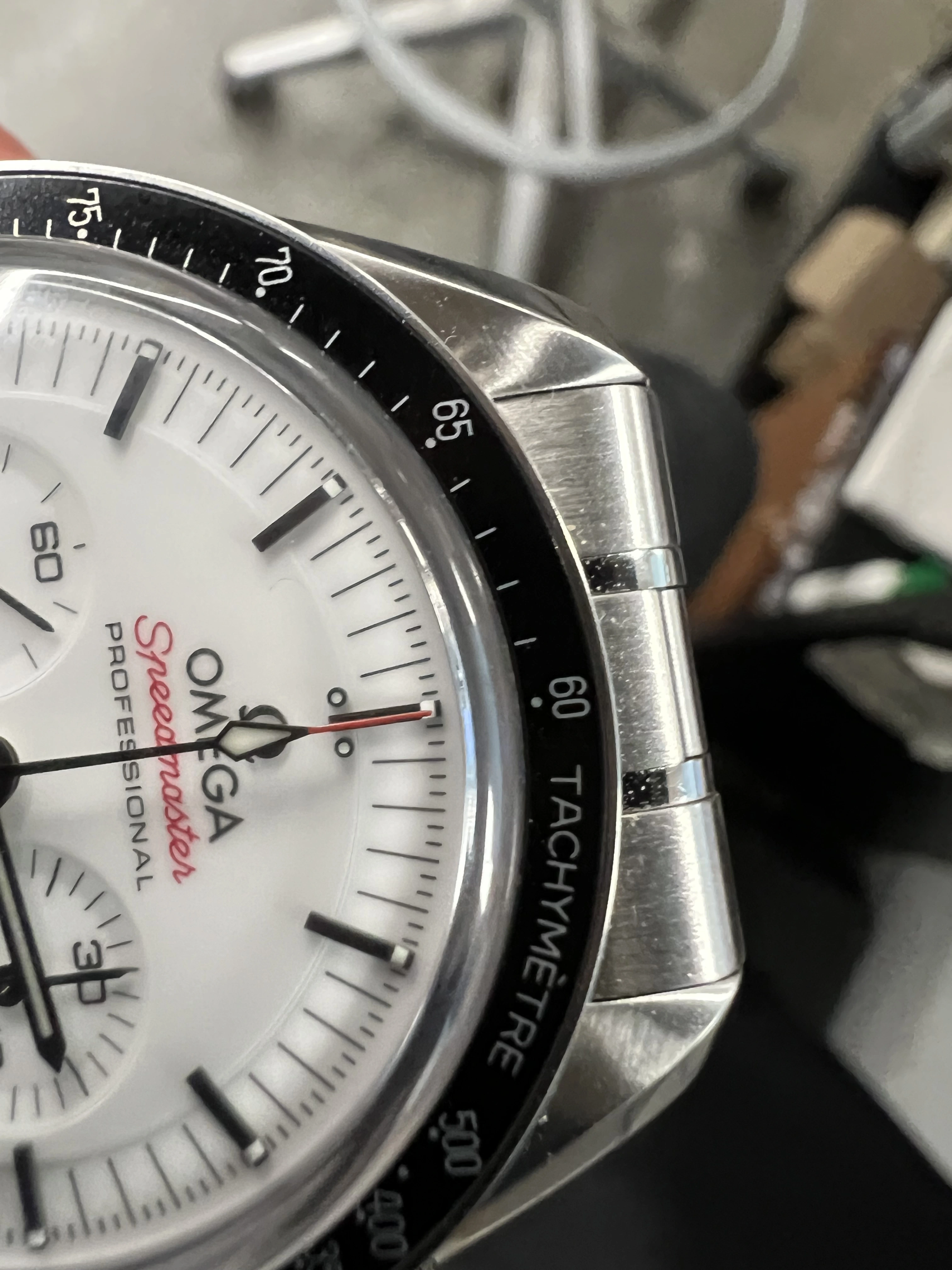

Thanks Al. With all the hearsay and opinions it’s good to understand what Omega considers acceptable.
35
9

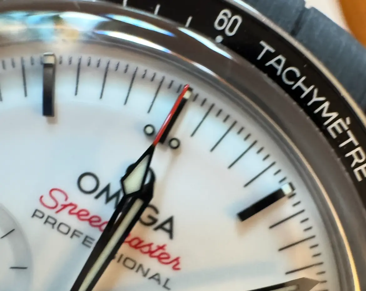

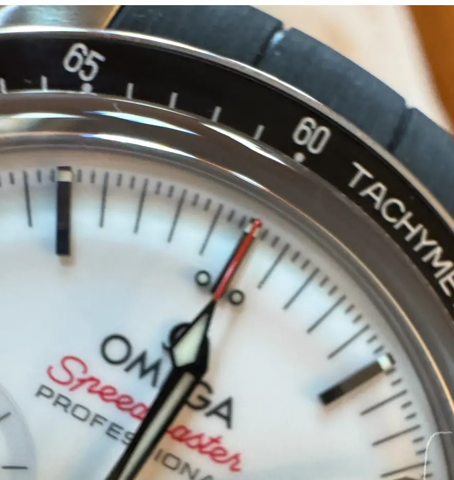

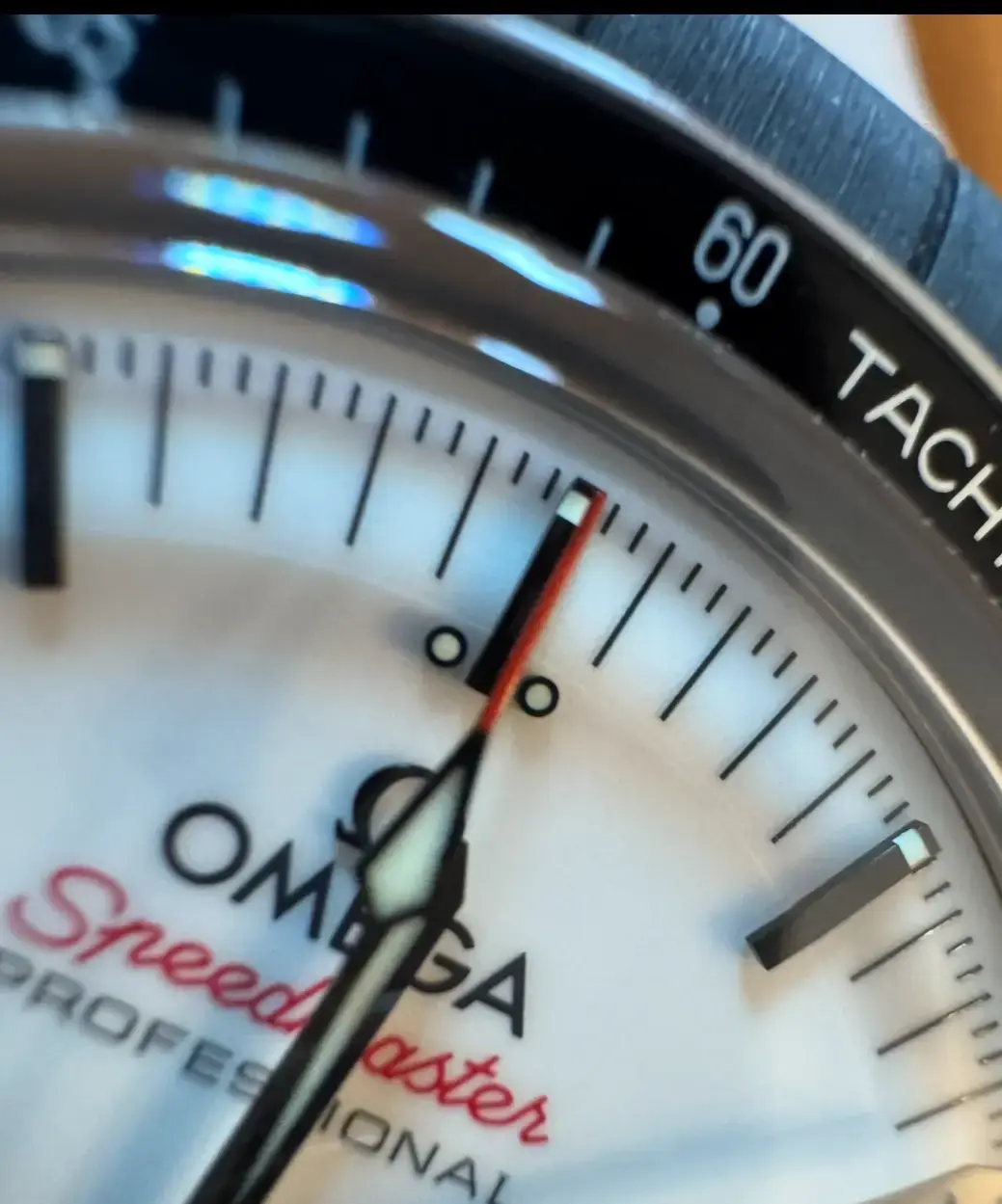

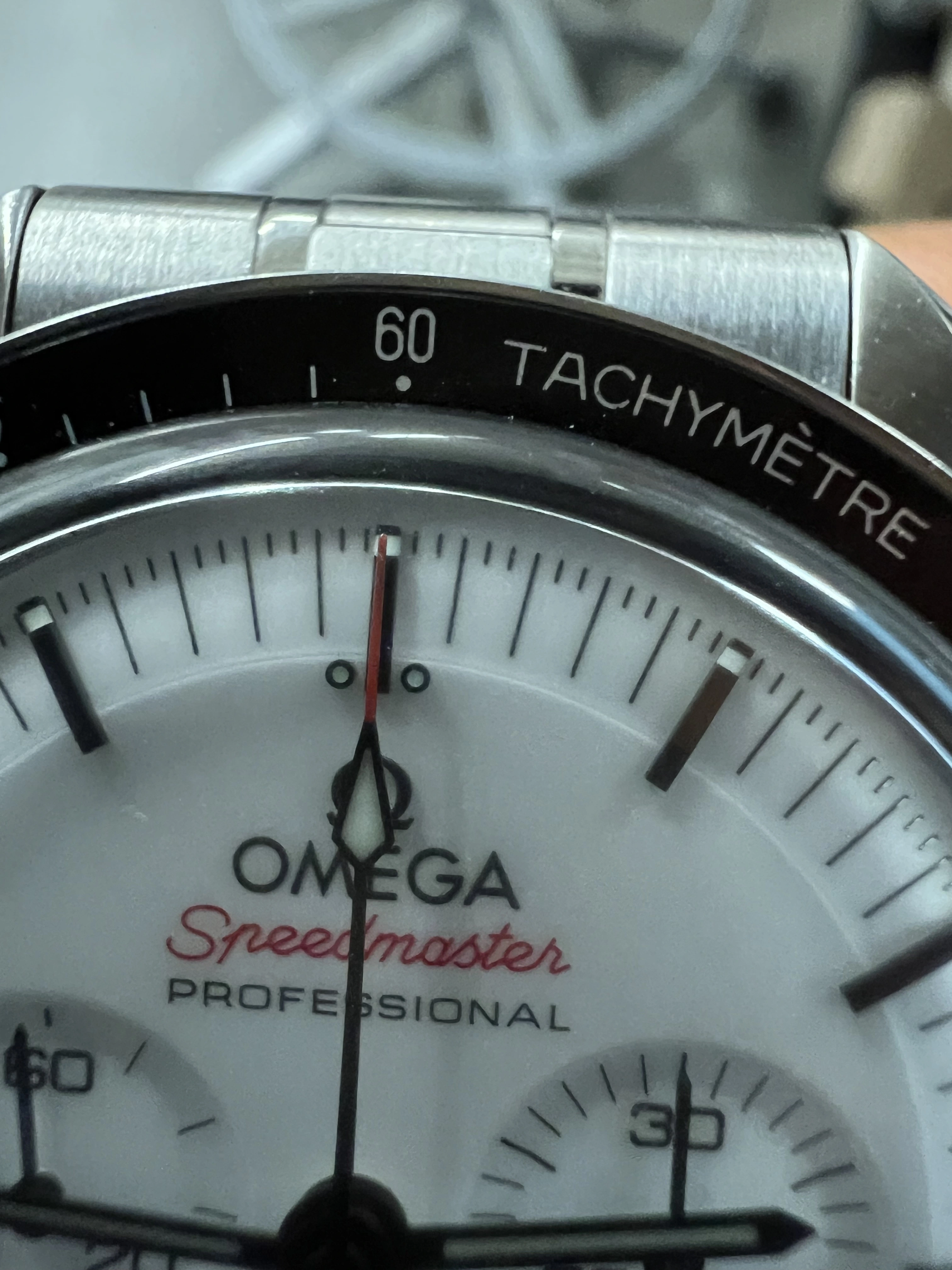

My 2 week old Speedy.
Which is the truly accurate photo?
It’s no wonder to me why Omega suggests it may be parallax. But then again they offered to resolve your complaint via warranty.

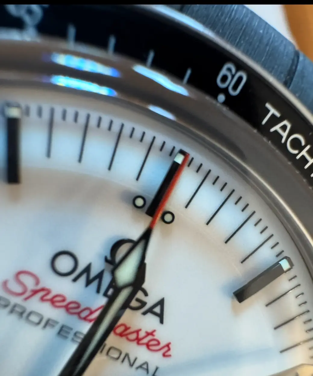

This is why the check is done with the movement out of the case. When the watch is fully assembled, I find it is better to look down the length of the hand from the bottom (6 o'clock side) and sort of sight down the hand to get a better idea of the alignment.
I've serviced hundreds of these, and there are occasionally times when I look at a hand that I swore I put spot on, and it looks off to one side depending on how I hold the completed watch in my hand.
35
9
