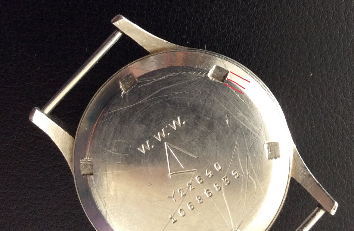

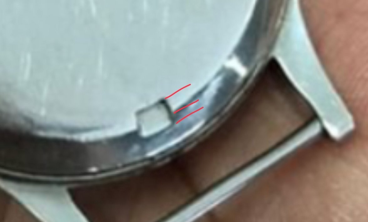

@davy26 how do the slots look on the outside of the CB ?
That's a very good point you've made there w154 - you should adopt a pic of Sherlock Holmes for your avatar! The slots on mine are more like 50/50, certainly not with the marked difference evident in the second of pics you've posted.

Have you got a way to accurately weigh it, or measure the thickness of the caseback. That way we could check if it鈥檚 been skimmed as I have one that we could compare against.
Edit. The slots indicate it could have been skimmed. The majority of my slot is on the sloping part of the CB, whereas the majority of your slot is on the flat part. That suggests material has been removed from the flat part of the CB.
Yes, I think that would make sense. Anyway thanks for the observation

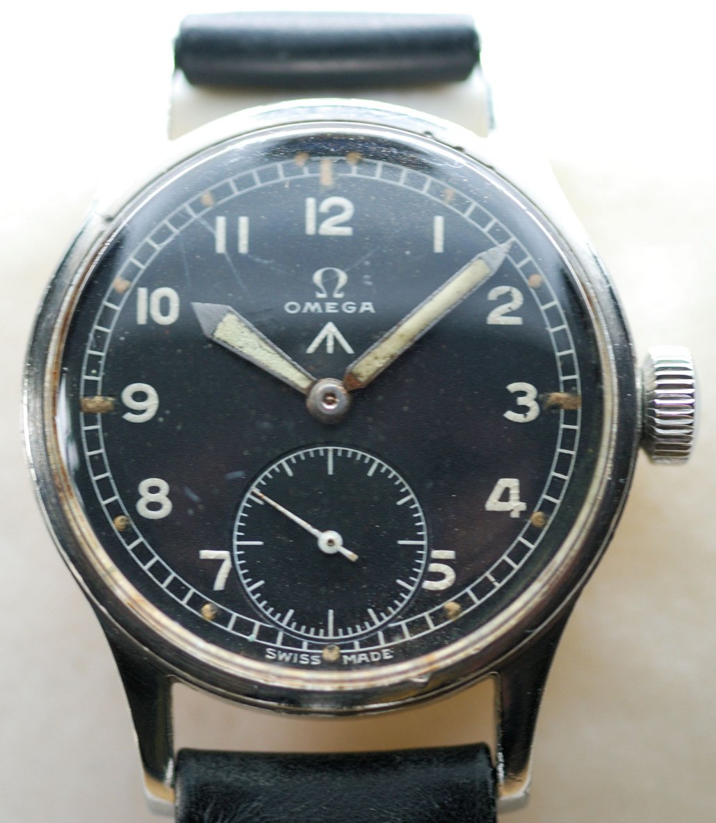

aka - I just noticed, looking at our respective pics of movements, that yours appears to have (but it could be the angle at which the pic was taken) a different crown from mine, which is slightly domed - just for your information, no big deal.
Agreed, could be the angle, but no big deal though.. How long is the power reserve should be if fully wounded?
