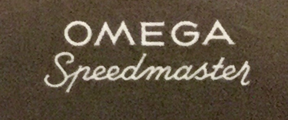

Different versions of 105.003 dials ?
649
839
So, does this change the way one would evaluate originality? Are certain dials expected on specific subreferences within the 105.003 family?
It seems difficult to state this, unless clustering in 2 groups is obvious...
405
2,020
I don't know, we need to examine more 105.003's. I'm not sure there is a logic, but who knows...
405
2,020

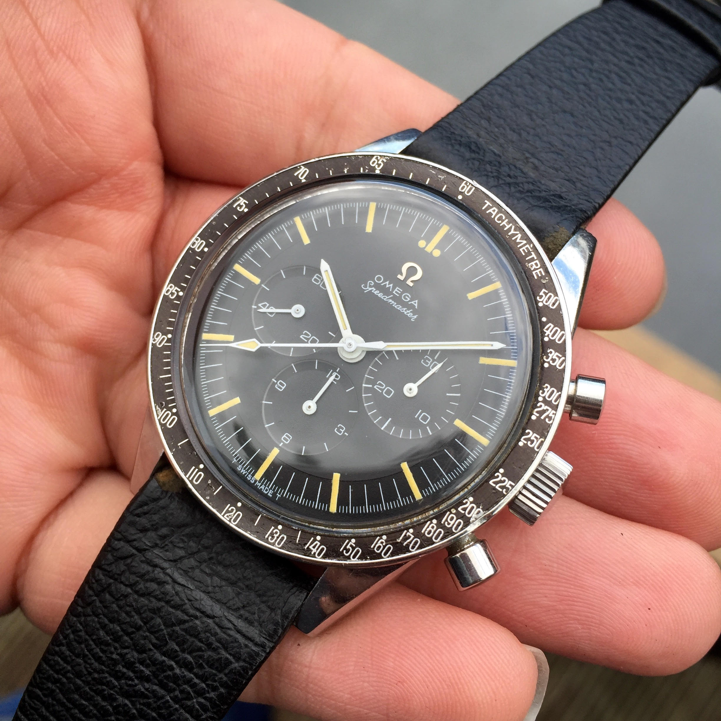

I think people need to post which reference year comes with which mark dial so we can establish a trend.
Yes it's a good idea. The serial numbers are also important.
More information about mine :
Mark 1 : 105.003-63, I need to check the serial but it's around 22 million
Mark 2 : 105.003-65, serial 24.013.xxx
Mark 1 : 105.003-65, serial 24.536.xxx
187
200
Really great thread. Here's my 105.003-65, with a serial 24.002.xxx.
According to what I'm seeing above, looks like a Mark 1?
576
858
Obviously no correlation of serial number range and type of dial.
With the few examples we have here we already have:
Mk 1: 22.xxx - 24.536
Mk 2: 22.6xx - 25.499
2 suppliers?
2 cliches used in parallel?
