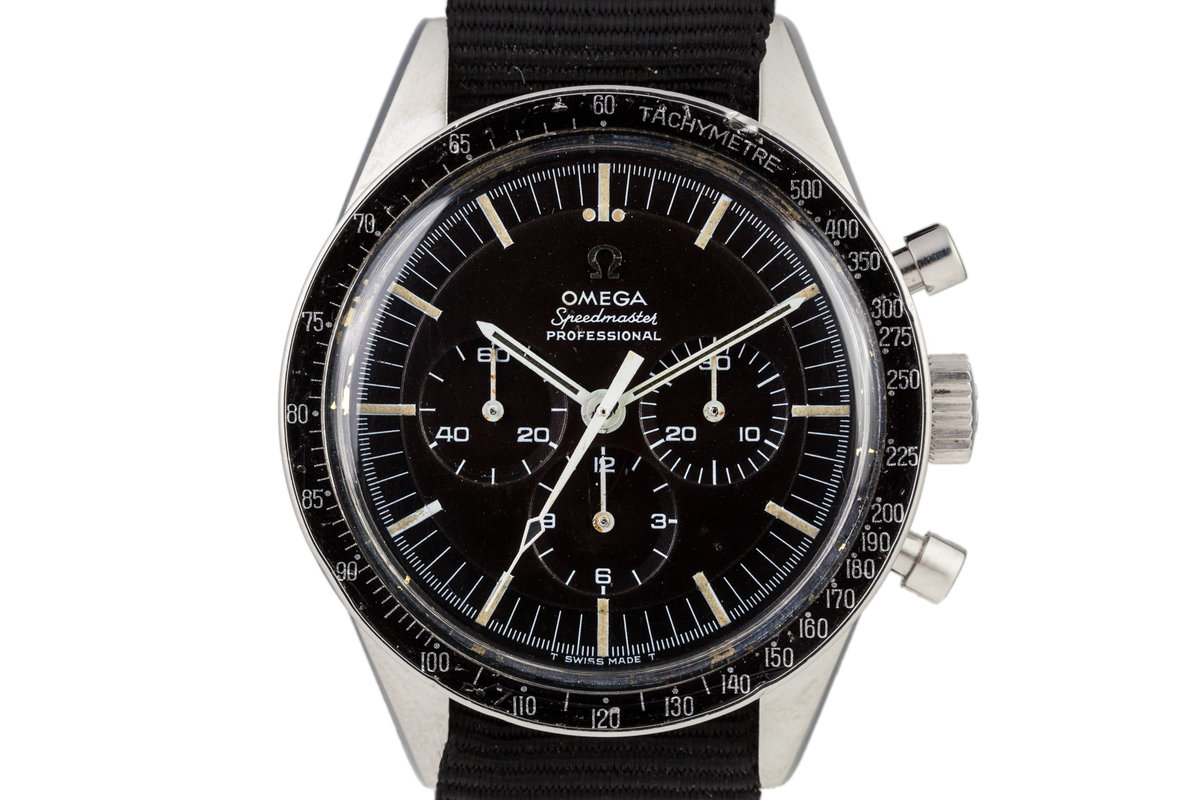

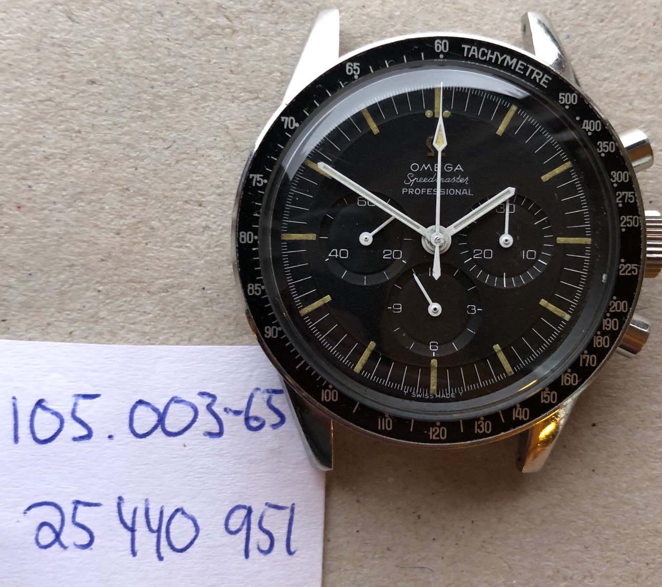

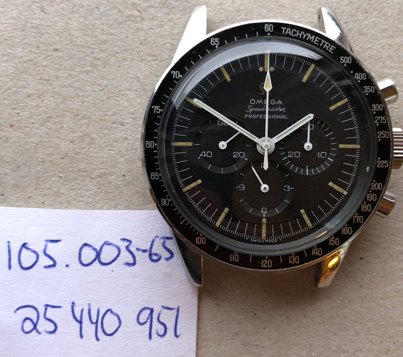

Is it possible that some of these watches were fitted with a "Professional" dial?

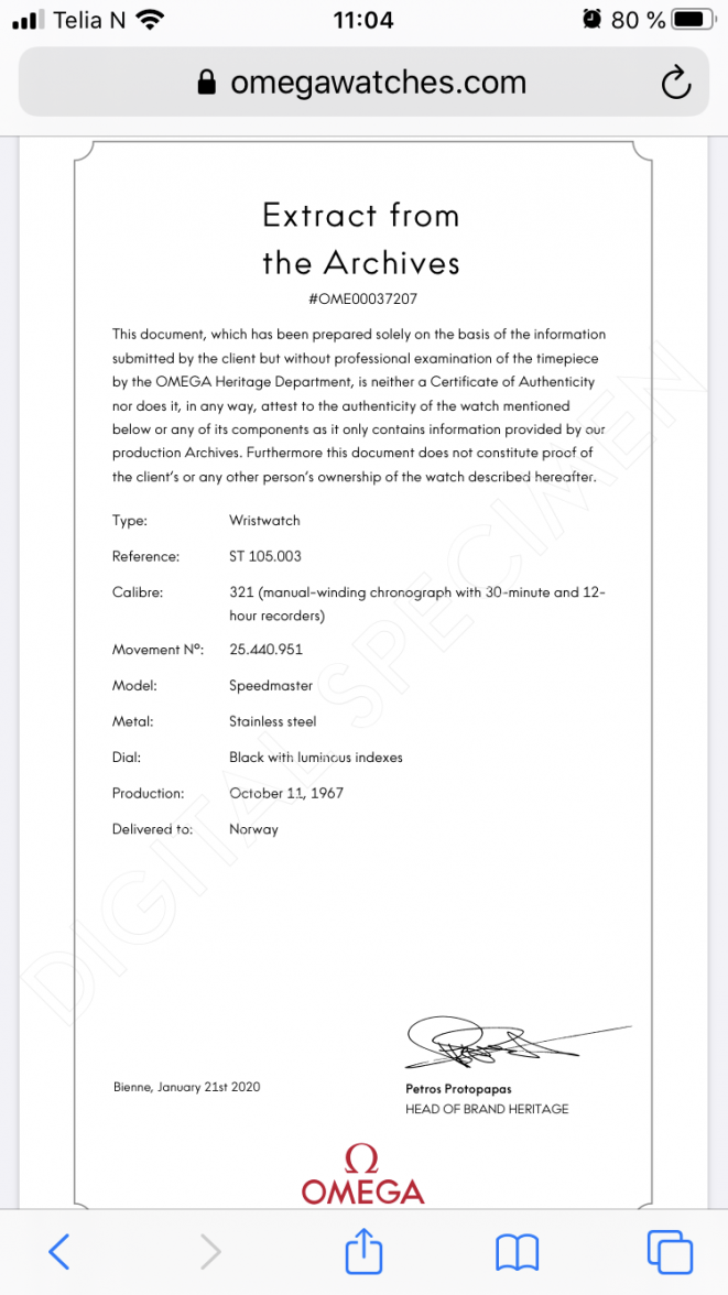

I have one, see pictures below. The first owner was quite certain that the dial never had been changed/ replaced. Hands and bezel are. I just got the EOA, confirming serialnumber to the reference, and production late 1967.
If the watch was serviced in the 70's - why would an older dial be fitted?

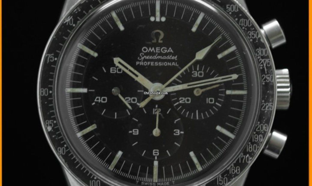

Could they simply have ran out of "non-pro" dials ? By searching the net, I easily find similar ones:

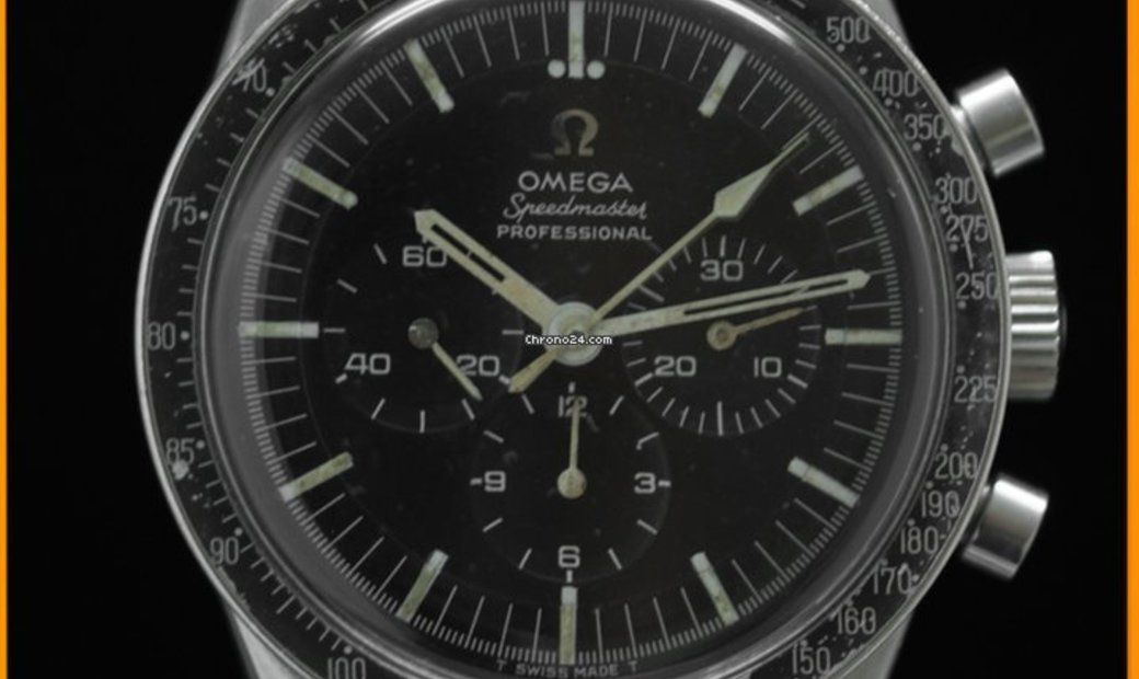

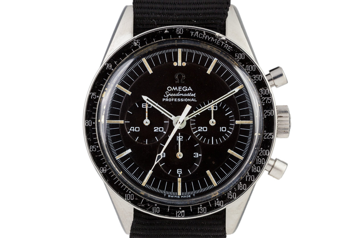

HQ Milton, 105.003 - serial 26,5 mill:
Hushhush; 105.003, 24,9 mill
There is also one pictured here:

Here is mine, also the extract.
Interested in your opinions 😀

I used to have a September 1967 105.003 and dial without Professional. So I believe dial also replaced at some point.
5,162
16,013
General consensus is 'no'. General consensus is also that professional cased watches did not come with non-professional dials.
Like with the 'watchmaker servicing several similar watches simultaneously and not really caring to keep each watches parts separate' case-back swap theory, perhaps the same happened for dials.
Regarding yours : its a lovely dial, and I would simply enjoy the watch for that, but the H/M hands are wrong...you may want to hunt down the correct one.

The Racing dials and Soleil dials are often in the ‘wrong’ cases.
It is hard to be absolutely definitive because Omega and most of the Swiss watch industry were often quite loose about the consistency of these minor details.
Your watch does not help develop the case for pro dials in straight lug watches. Too much service action!

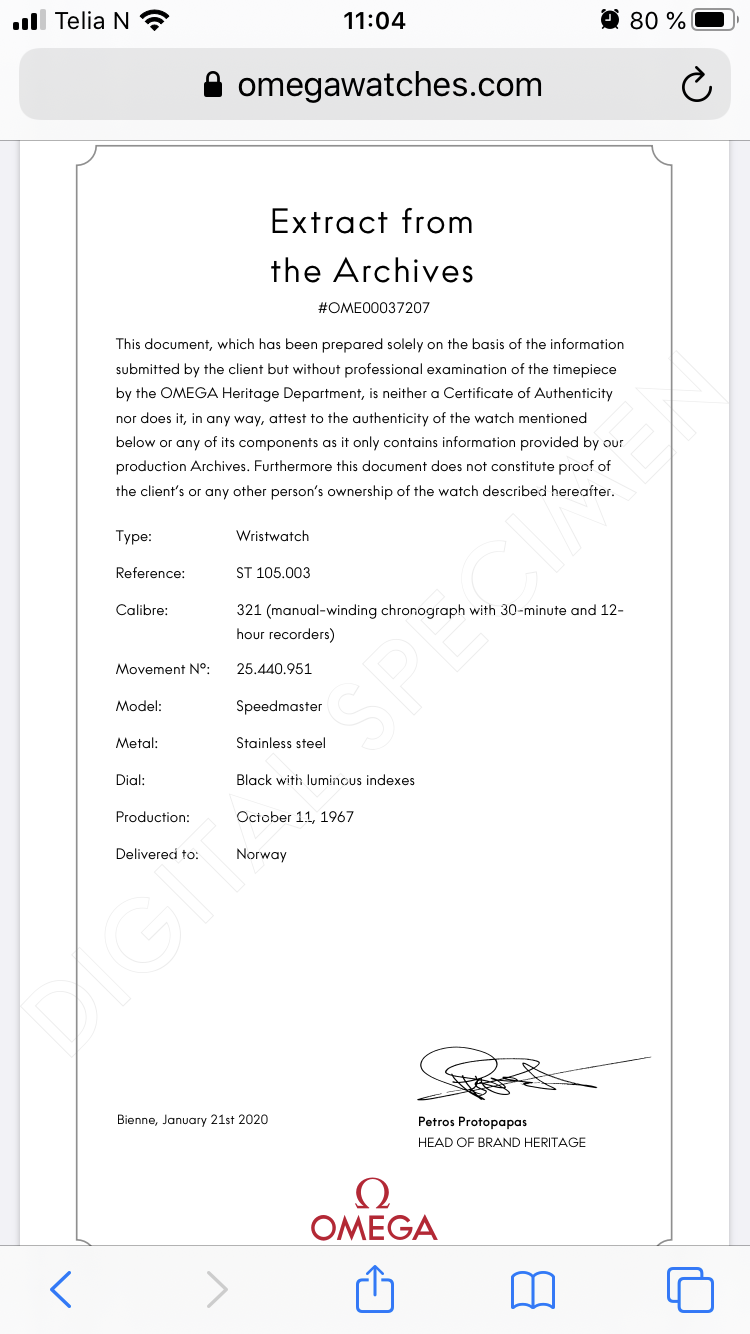

Best regards
