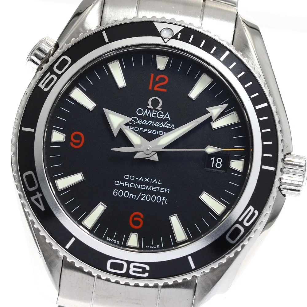

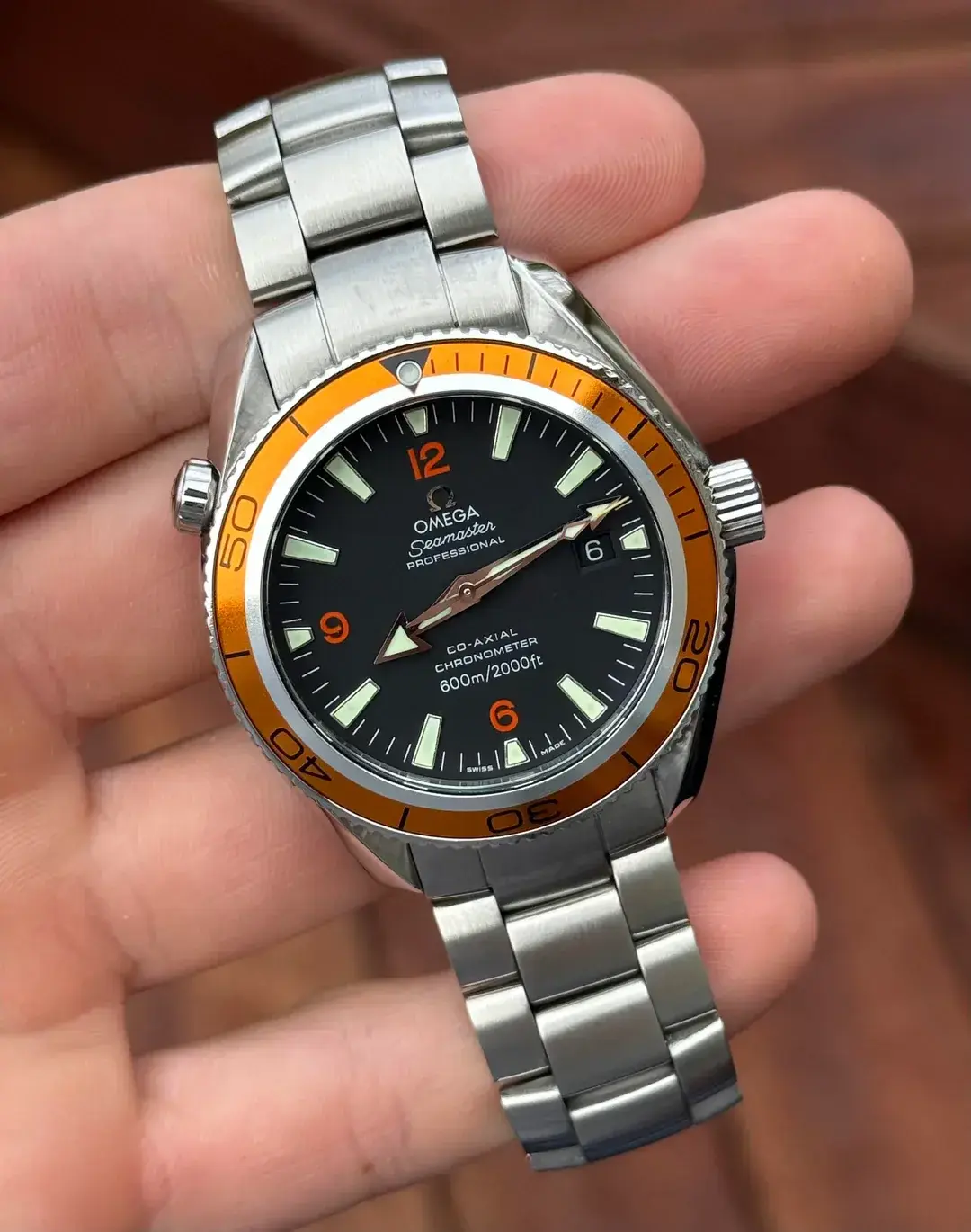

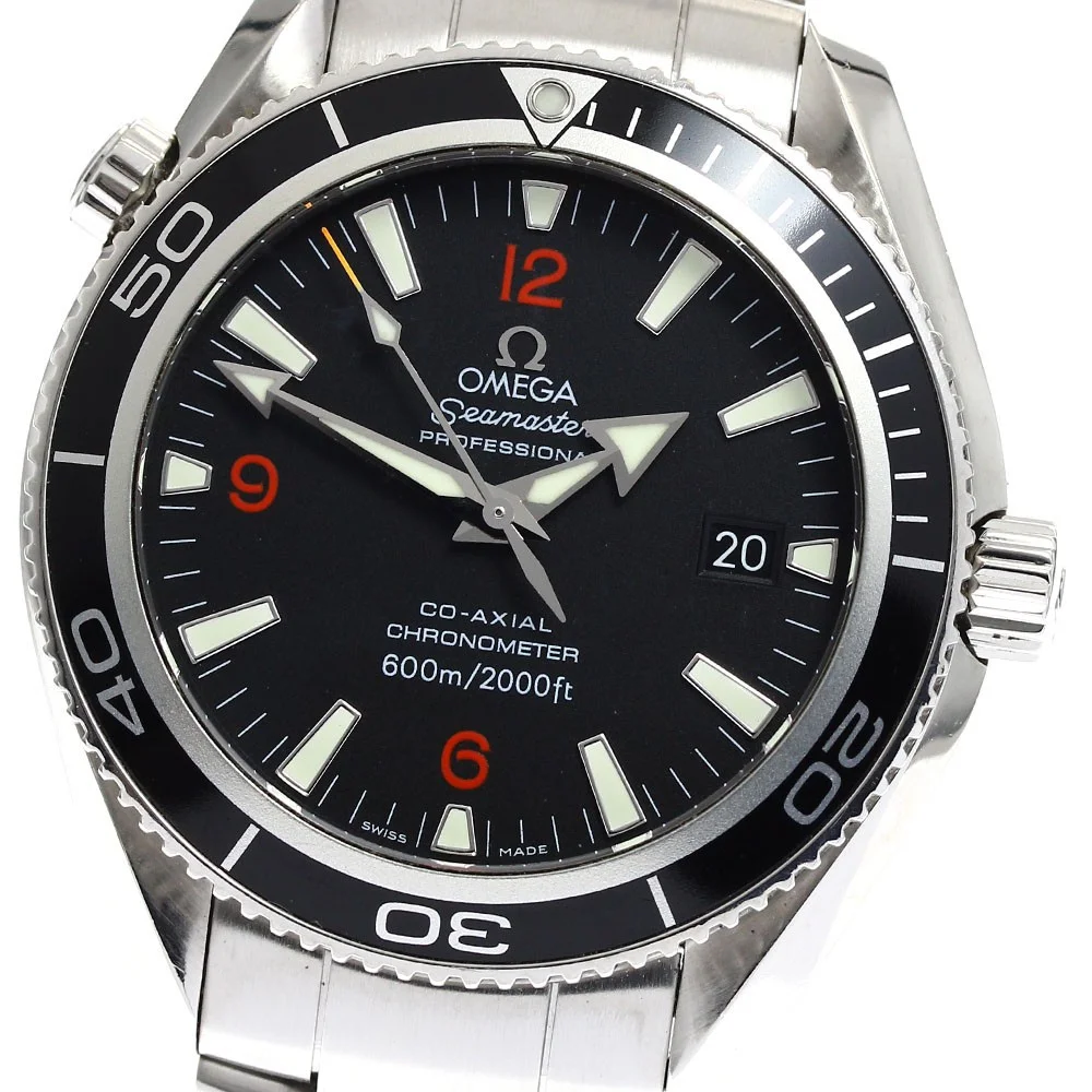

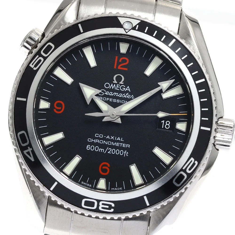

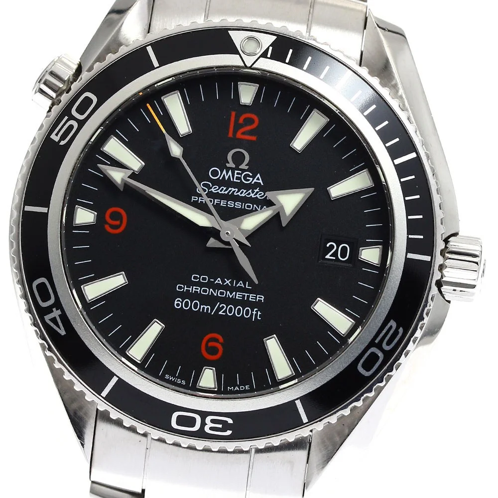

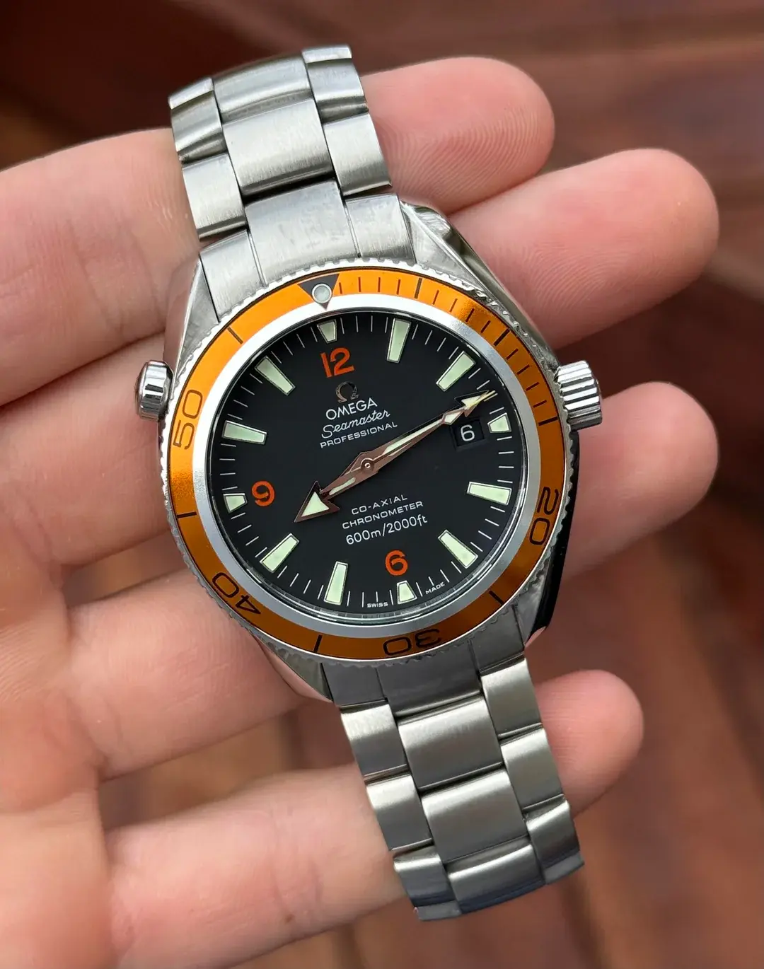

I've been looking at the 22xx Planet Oceans for some time now and I noticed the pip location differs on some inserts. The Omega website shows it placed right in the middle but some show up where they are located more towards the bottom. Are these original? Service insert? What happened?
I got these from ebay from a well known watch seller so I assume everything is legit.

The font on the bezel is also slightly off (compare the gap on the 5 and the 2 between the two bezels). My guess would be aftermarket.
889
903
I think the second watch shown has an aftermarket bezel. The pip should be centered in the triangle. I own the 2201.50 and the pip is centered. Although it's possible it's really terrible QC. But my money is on it being aftermarket.
