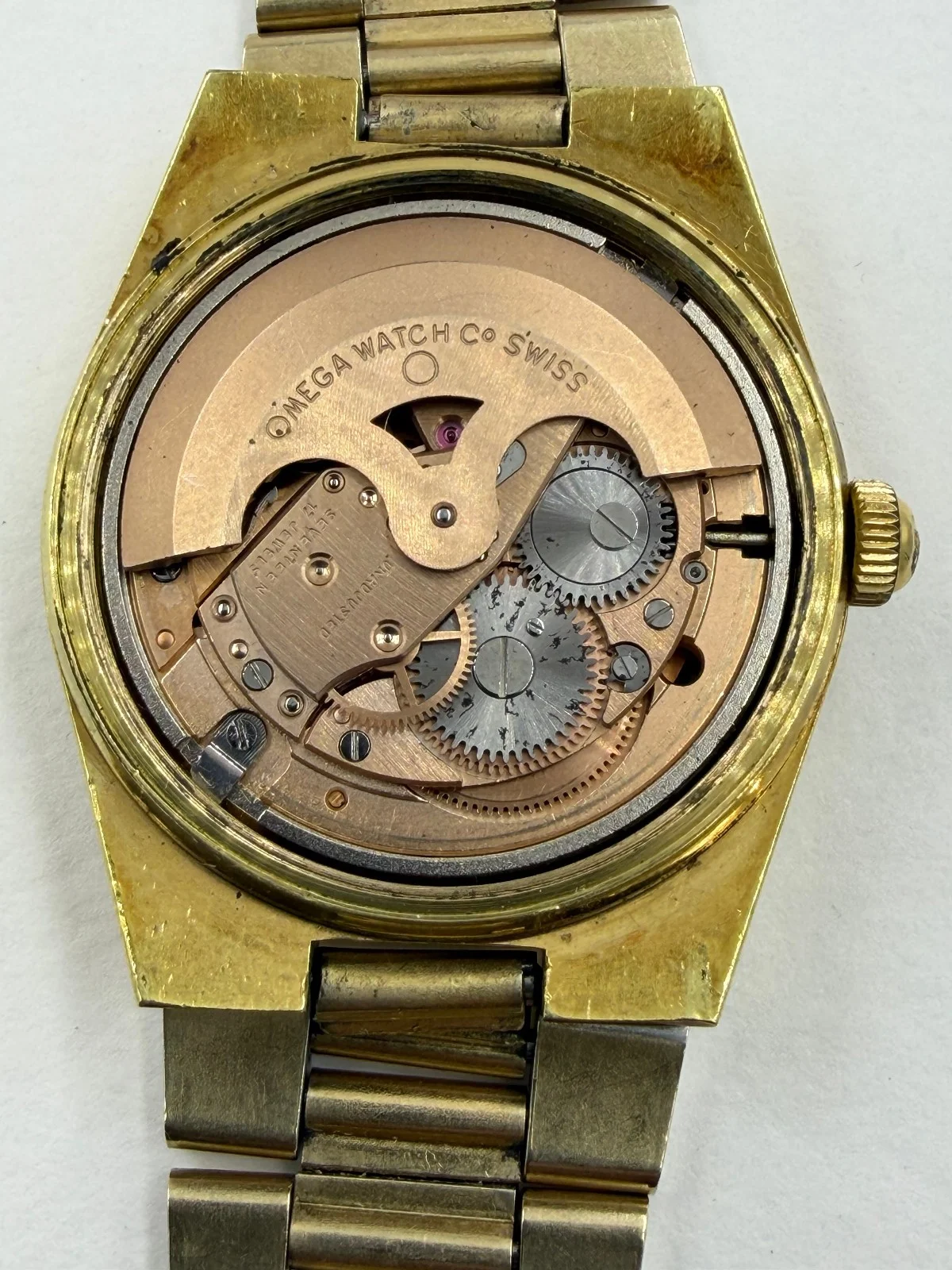

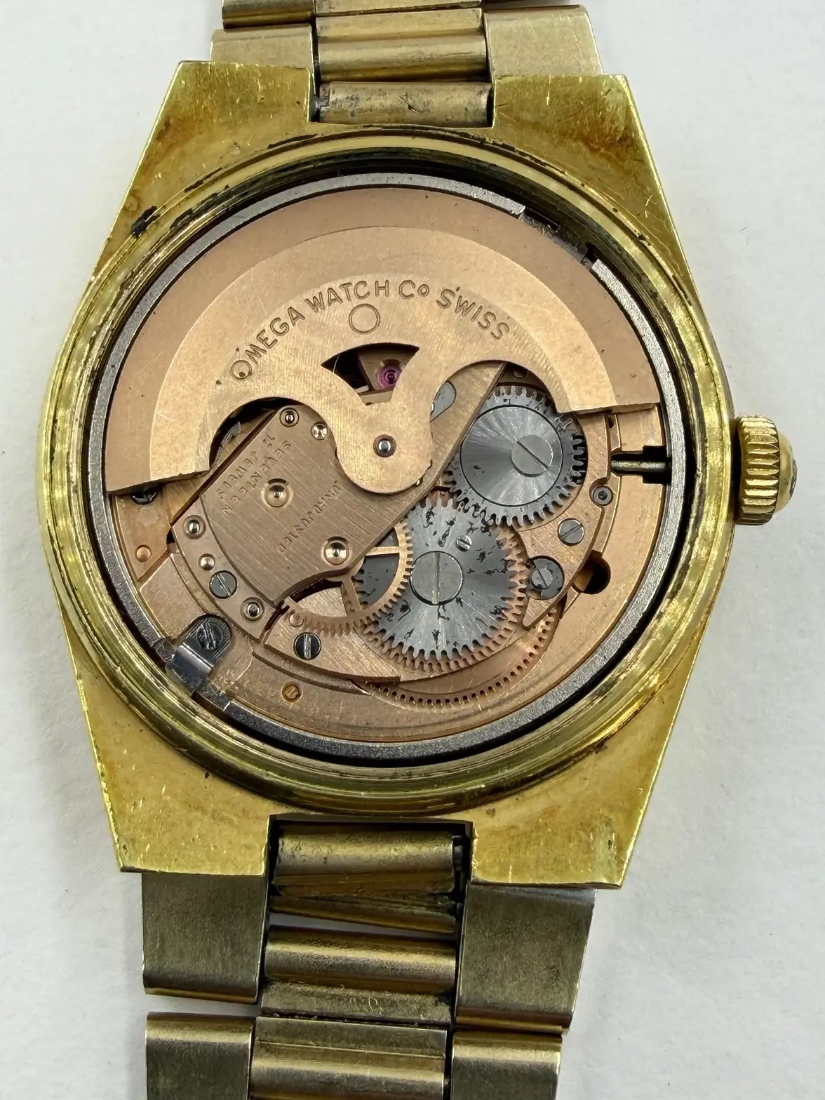

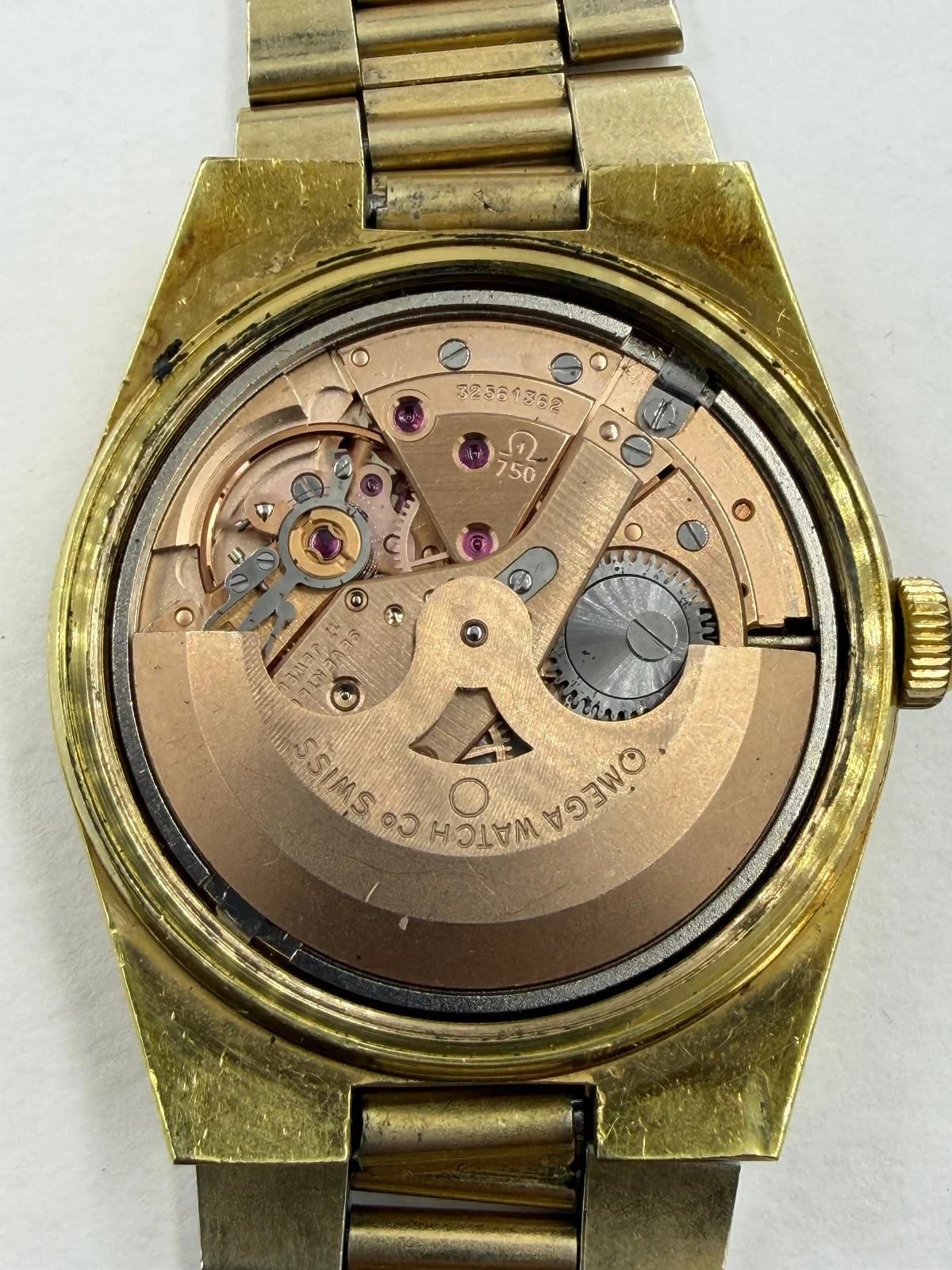

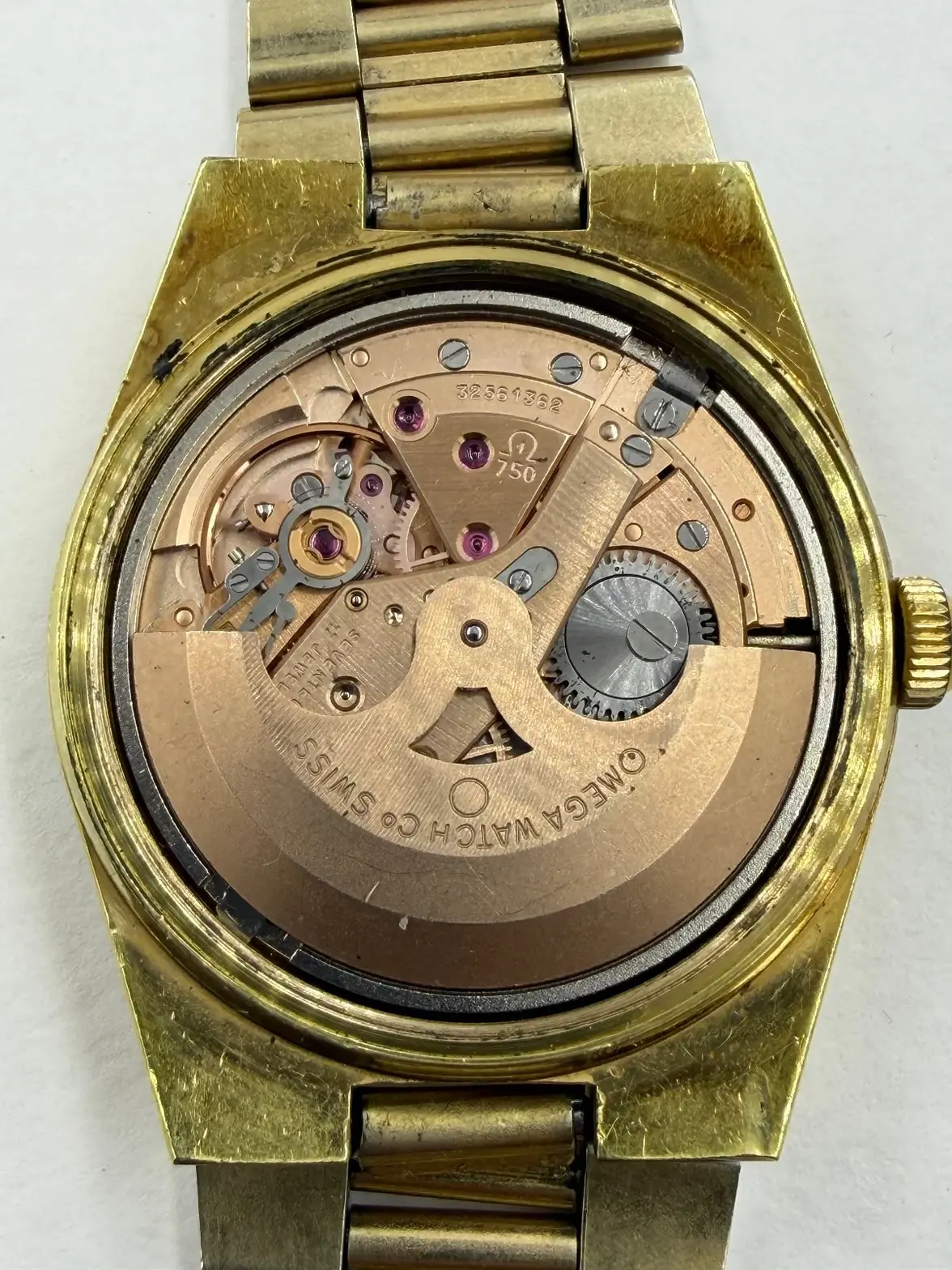

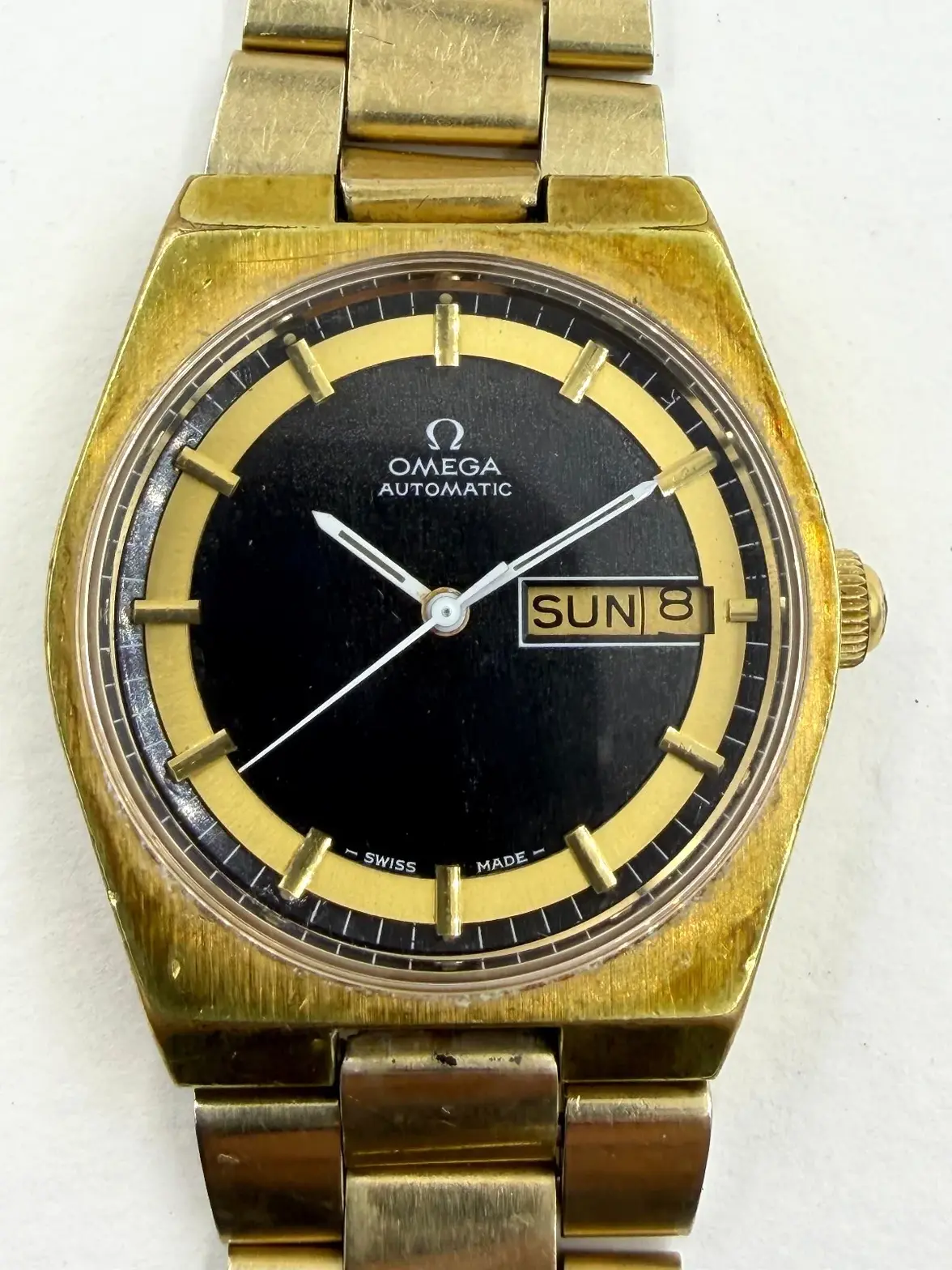

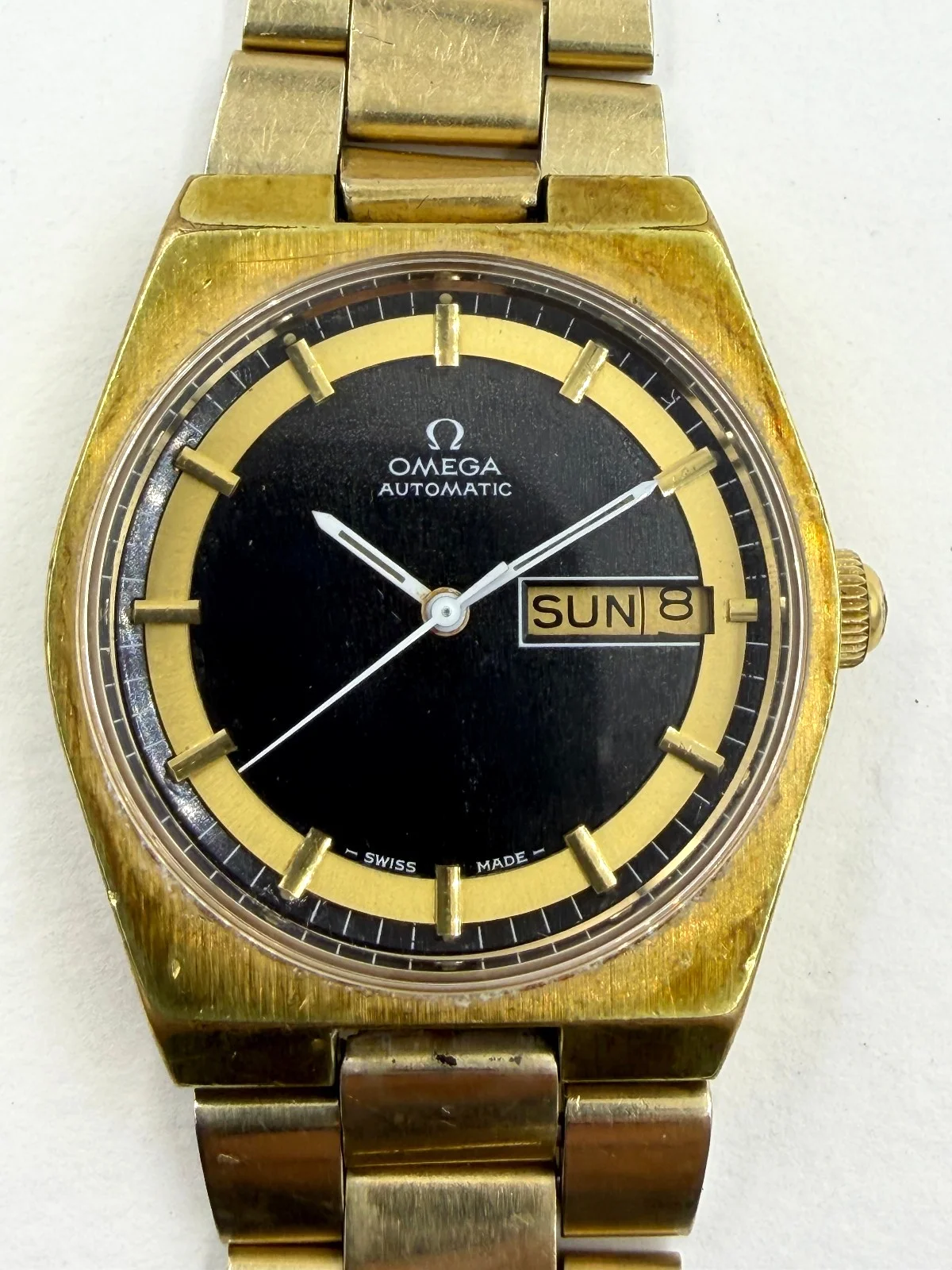

I found this 166.0142 on auction. The dial looks insanely fresh, suspiciously so? it's hard to find other reference images, but from what I can tell it looks genuine. What do you think? Do you think it's worth $650? If not how much? Also, are the corrosion (?) marks on some of the gears in pic 3 a concern?

The dial looks fine and is in reasonable shape. I don't see anything particularly concerning on the movement. That case however is a dog's breakfast, and I would have a tough time justifying $3-400 on that myself, AND I'm someone who would do the needed movement service myself.
