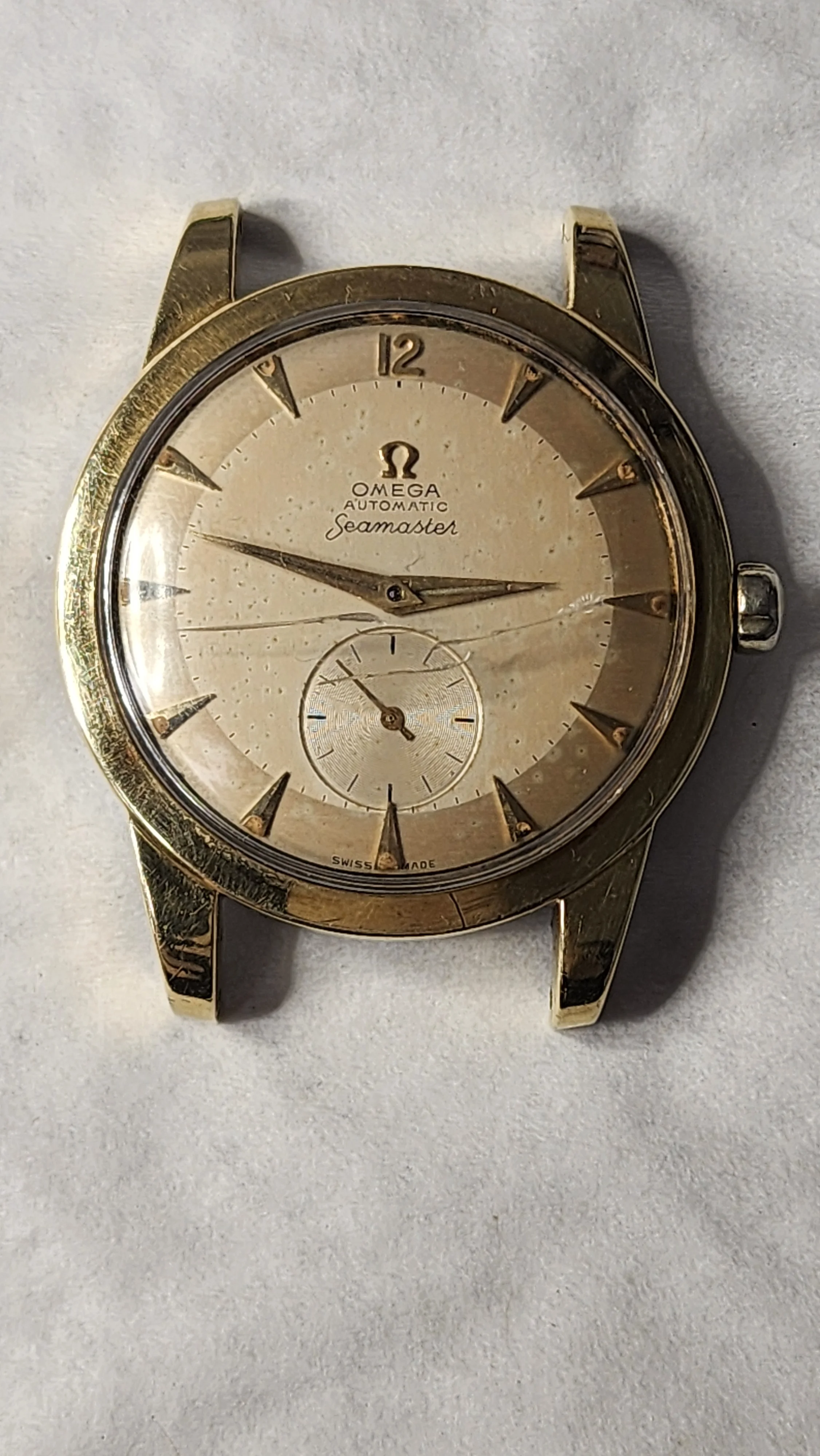

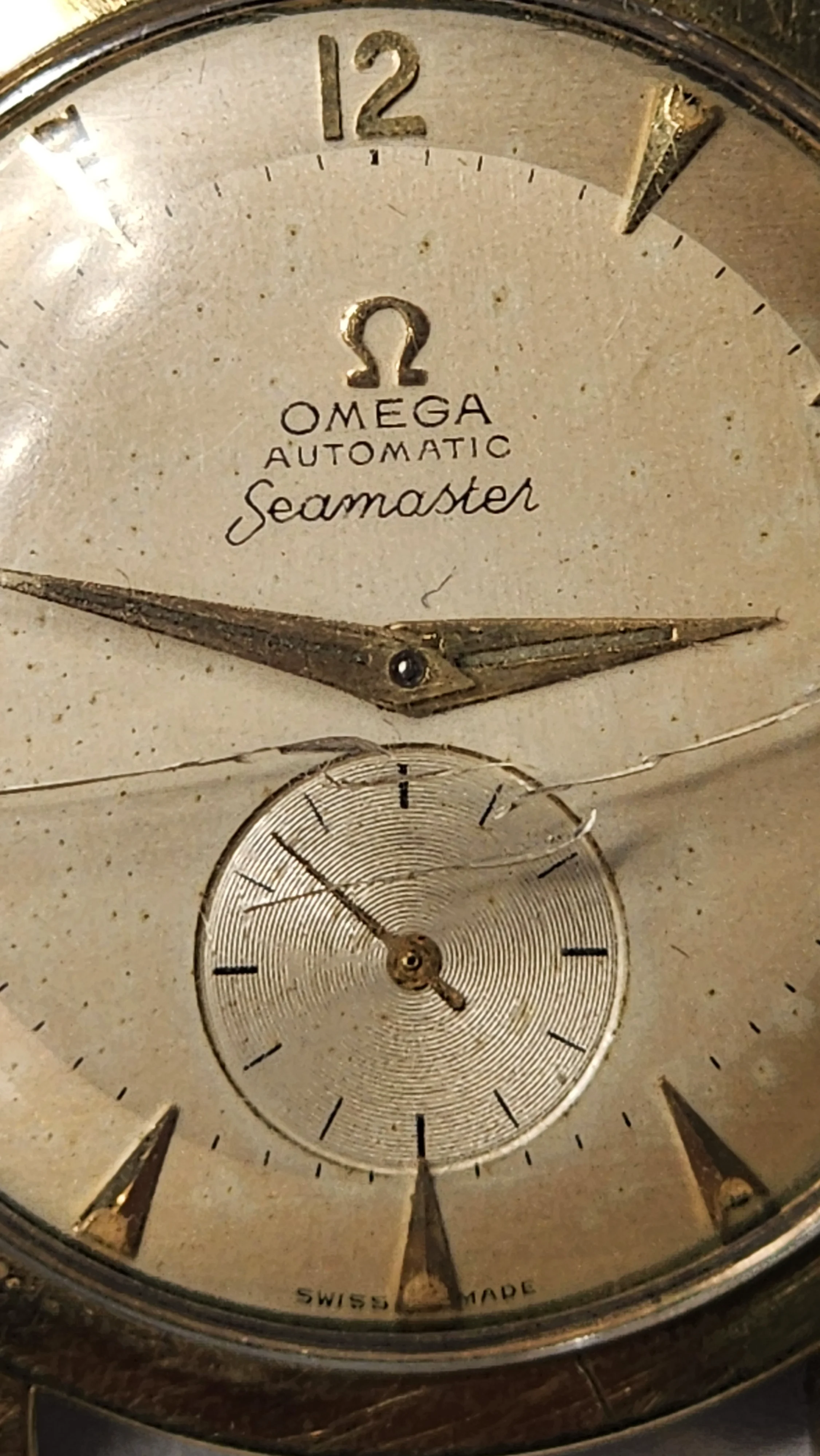

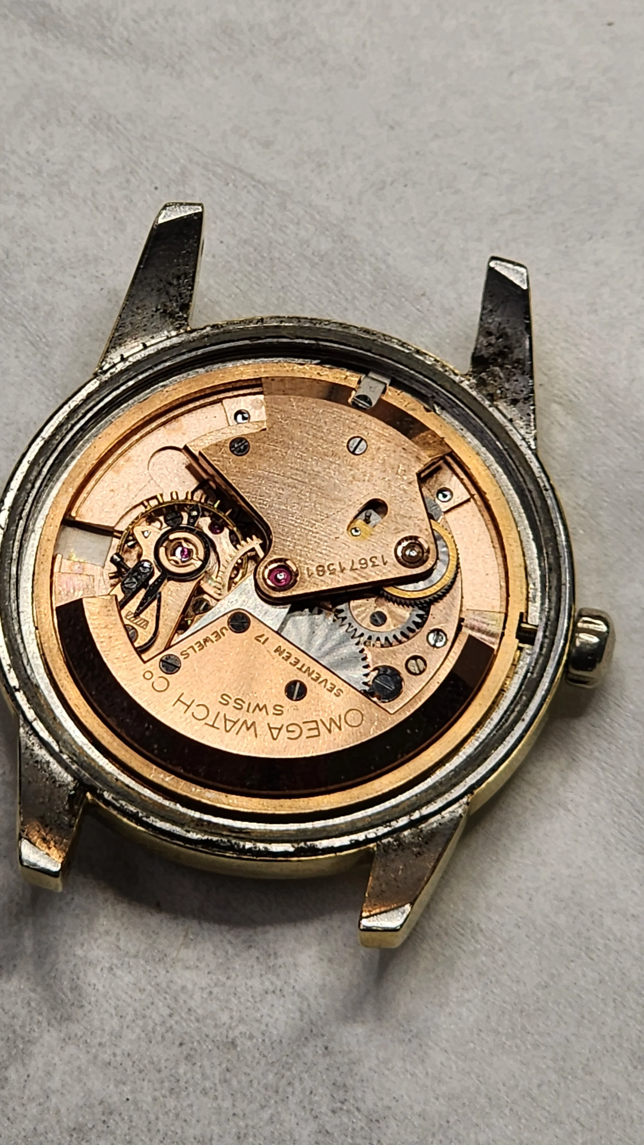

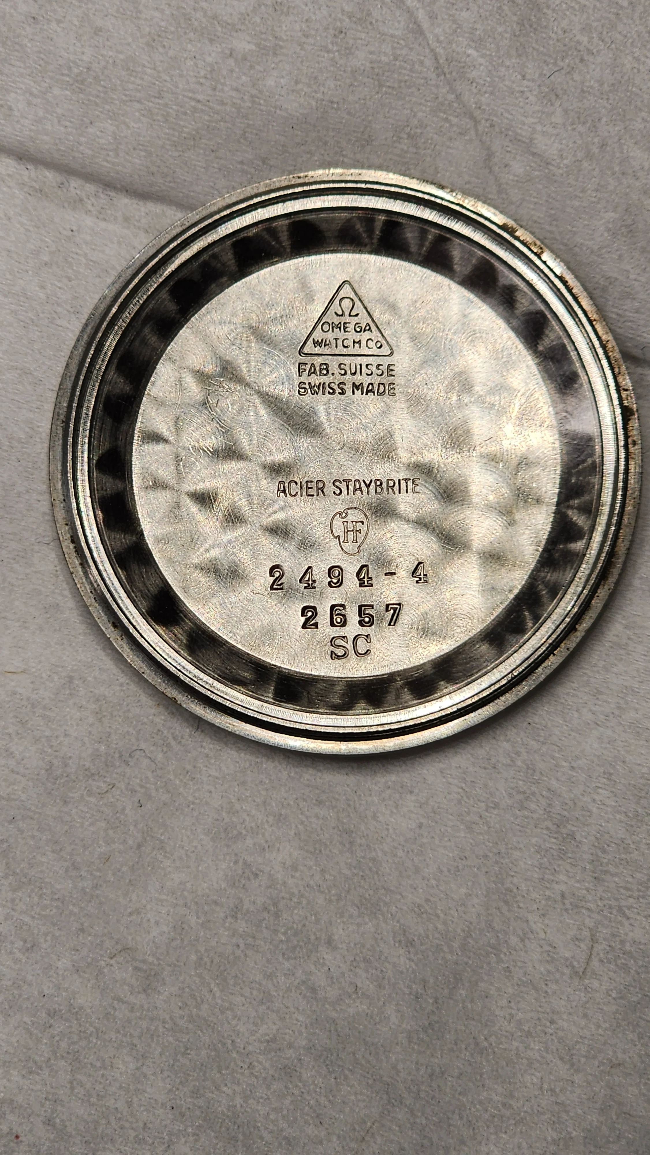

I bought this one over a year ago. I believe the dial to be original but want to make sure.

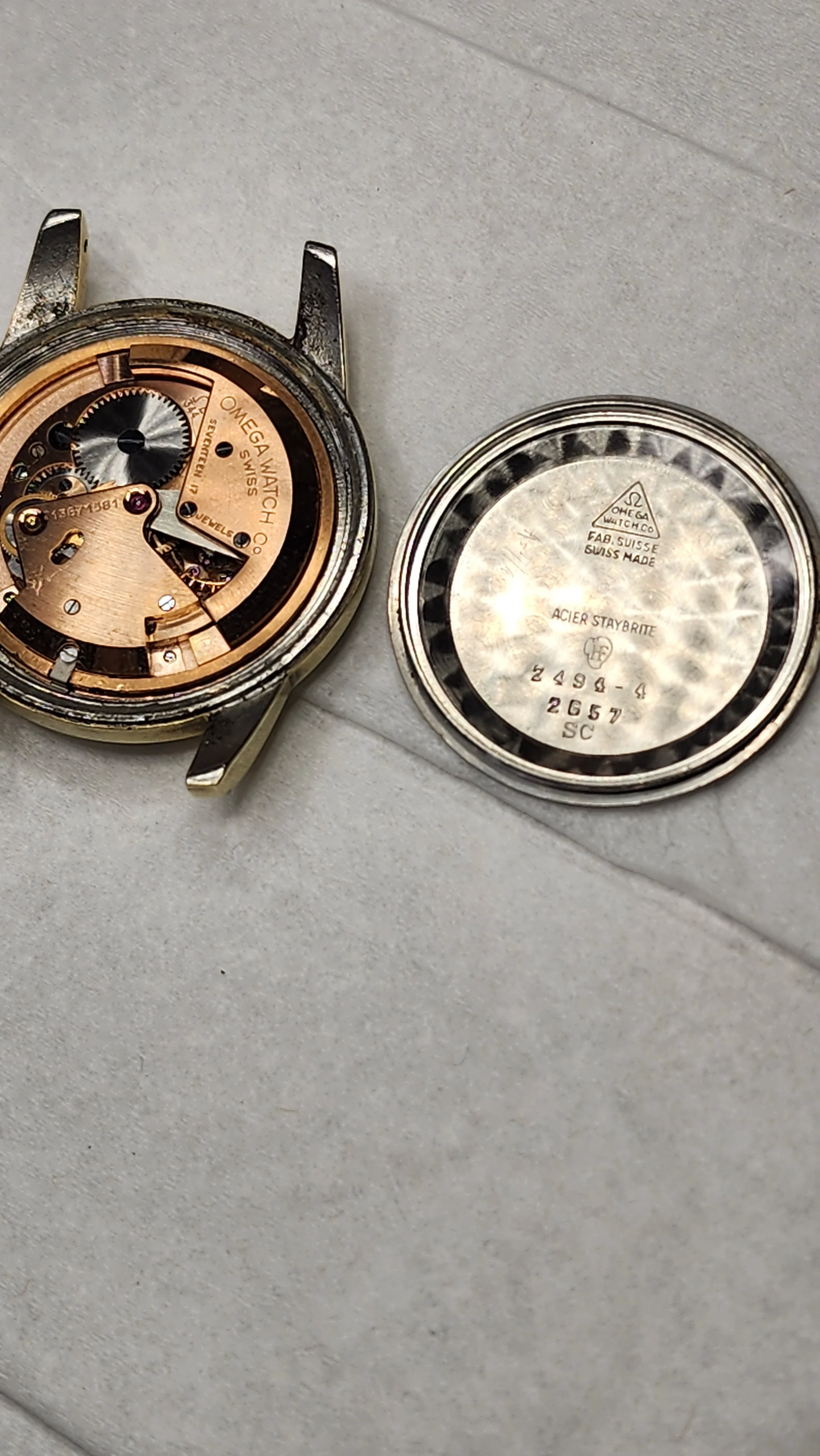

The watch does not work but before I send it out for service, I want to get some opinions. Is the watch original? This case has 2 different reference numbers 2494-4 & 2657 SC. This watch would be 2657 SC

This would be the non-SC reference or 2494.
2494s are the center second version - 2657 the sub-second. The way it鈥檚 engraved into the case back is misleading.
