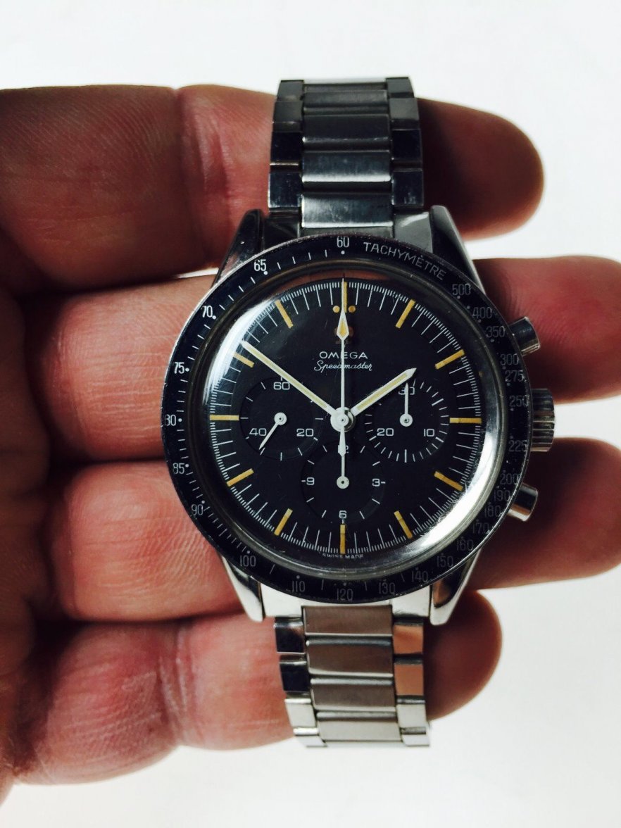

I think all points of vue are interesting.
Some people will never buy a watch that has been relumed, and others don't care.
If the dial of a Speedmaster is in bad condition, I think that the watch will be more desirable with a good relume.
For example, look at this Ed White : does somebody here think it would be a sacrilege to relume it ?
