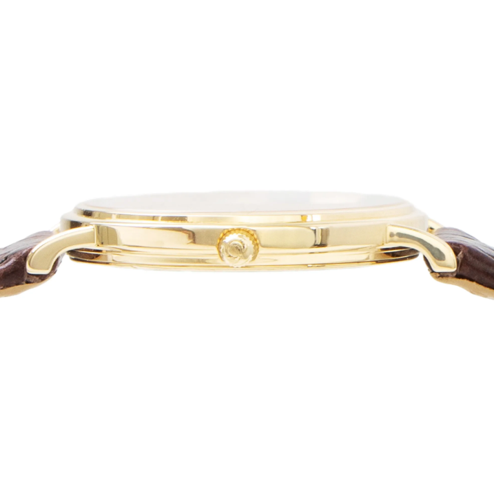

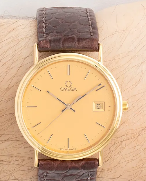

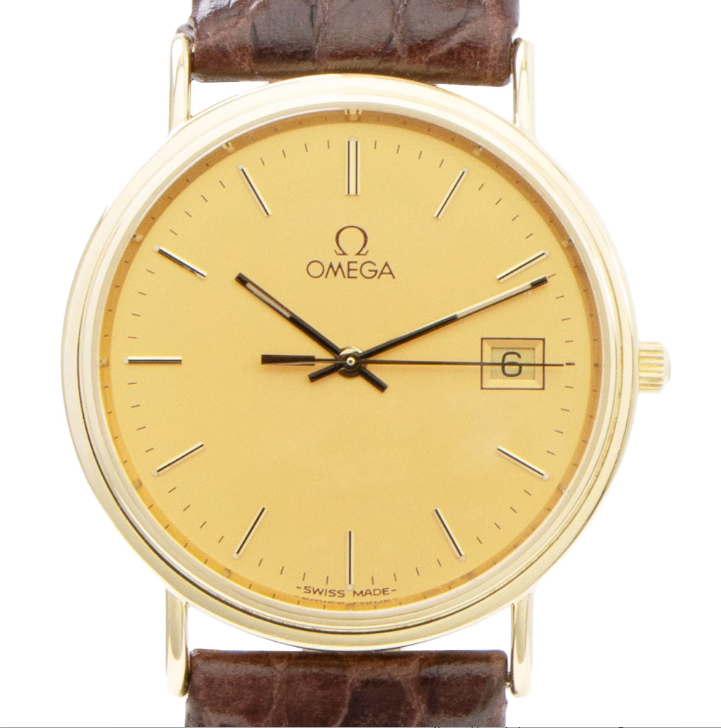

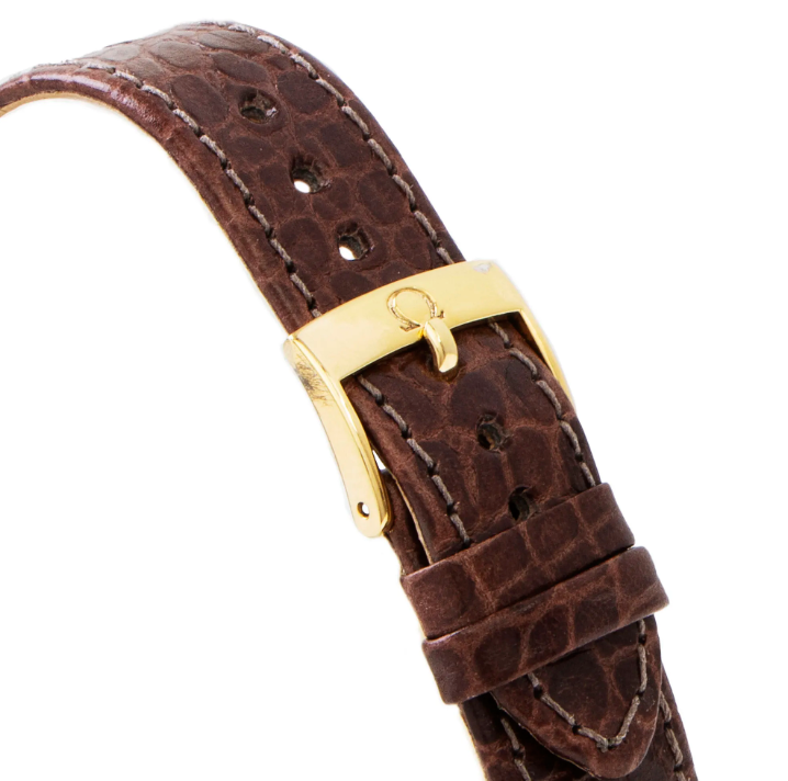

Have a chance to get my hands on this 18k gold Omega Deville, thinking its around the late 80s
Anything that stands out as a fake? Looks legit to me, but want to hear more opinions
(Pictures are real, again, the dealer that I go always take high-quality photos)

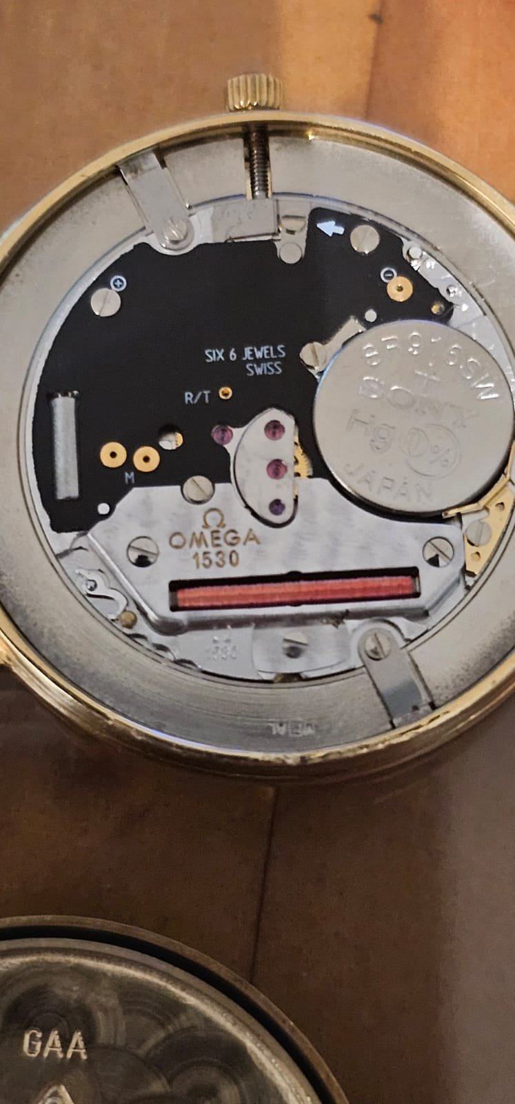

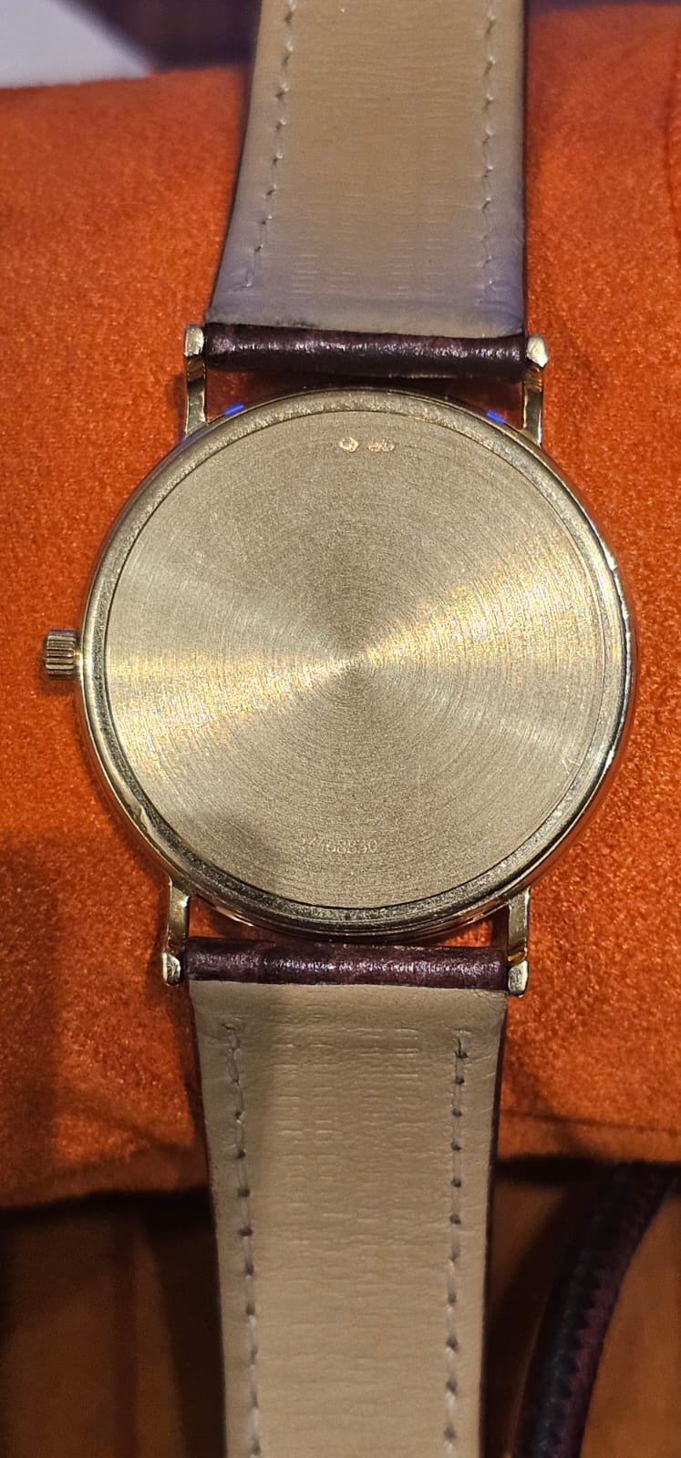

You left out one of the most important photos, the back and even better the insides.
25

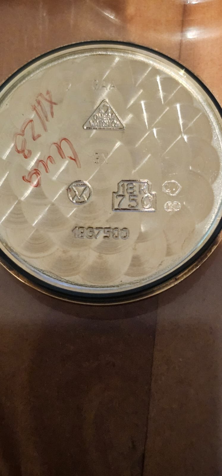

Here you go. Seems like legit to me, but not a 80s one, more a 90s one

Looks all ok to me.
The St. Bernard's dog hallmark was only introduced in 1995 so that means it has to have been manufactured after. So not late 80s.

If you Google the case reference number 196.7500, you’ll find the following information from Omega:
https://www.omegawatches.com/en-us/watch-omega-seamaster-jubilee-ba-196-750-mz
The listing shows the movement as caliber 1430, not 1530. Not sure what the difference are.
However, there are sales listings showing this watch with the cal. 1530 movement.
https://e-v-w.com/products/omega-18k-solid-gold-ref-1967500-date-quartz-fully-serviced
Hope this helps,
gatorcpa
25
Hope this helps,
gatorcpa
This is a 196.7500, not a 196.750 (which is the seamaster jubilee). This is listed as a Omega Deville from the 90s, so the watch seems okay, but only the information that is from the 80s that is mislead
Thanks, I double checked the serial number engraved and it must been from 98.
