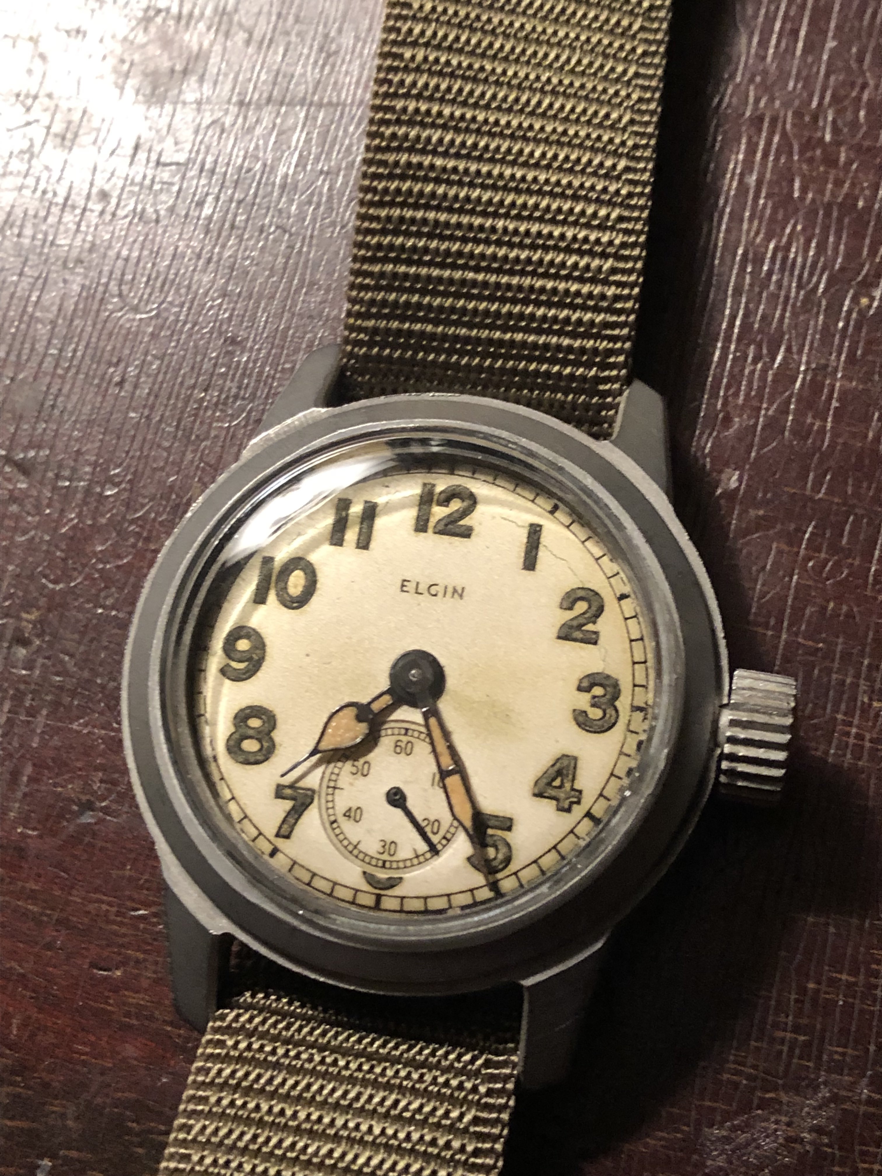

So I have read about watches getting magnetized. I spoke about it with my watchmaker not long ago and he said a large percentage of newer watches he gets in for service have been magnitized by all the electronic items we use (laptops, chargers, monitors), and sometimes just a quick zap on this little demagnetizer plate thing he has gets them running perfectly again.

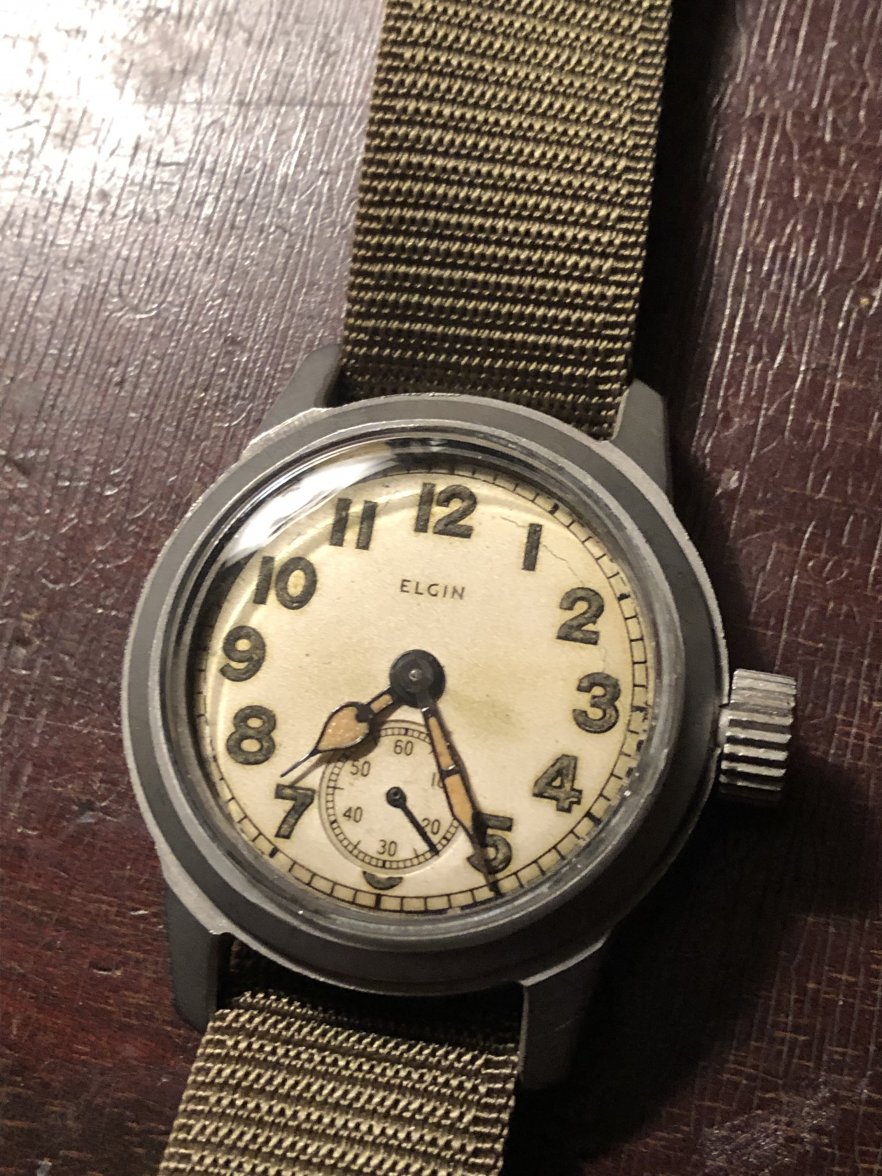

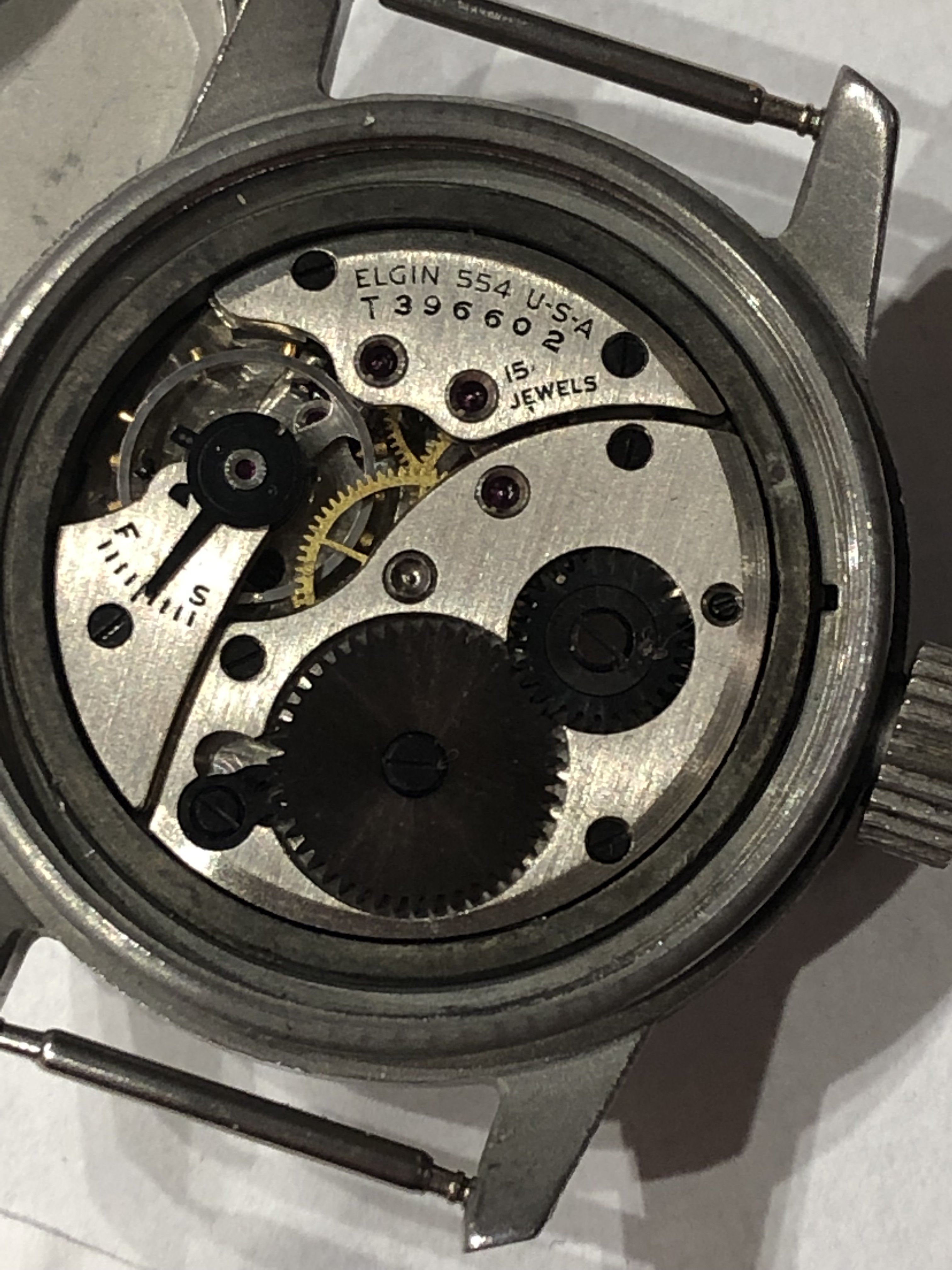

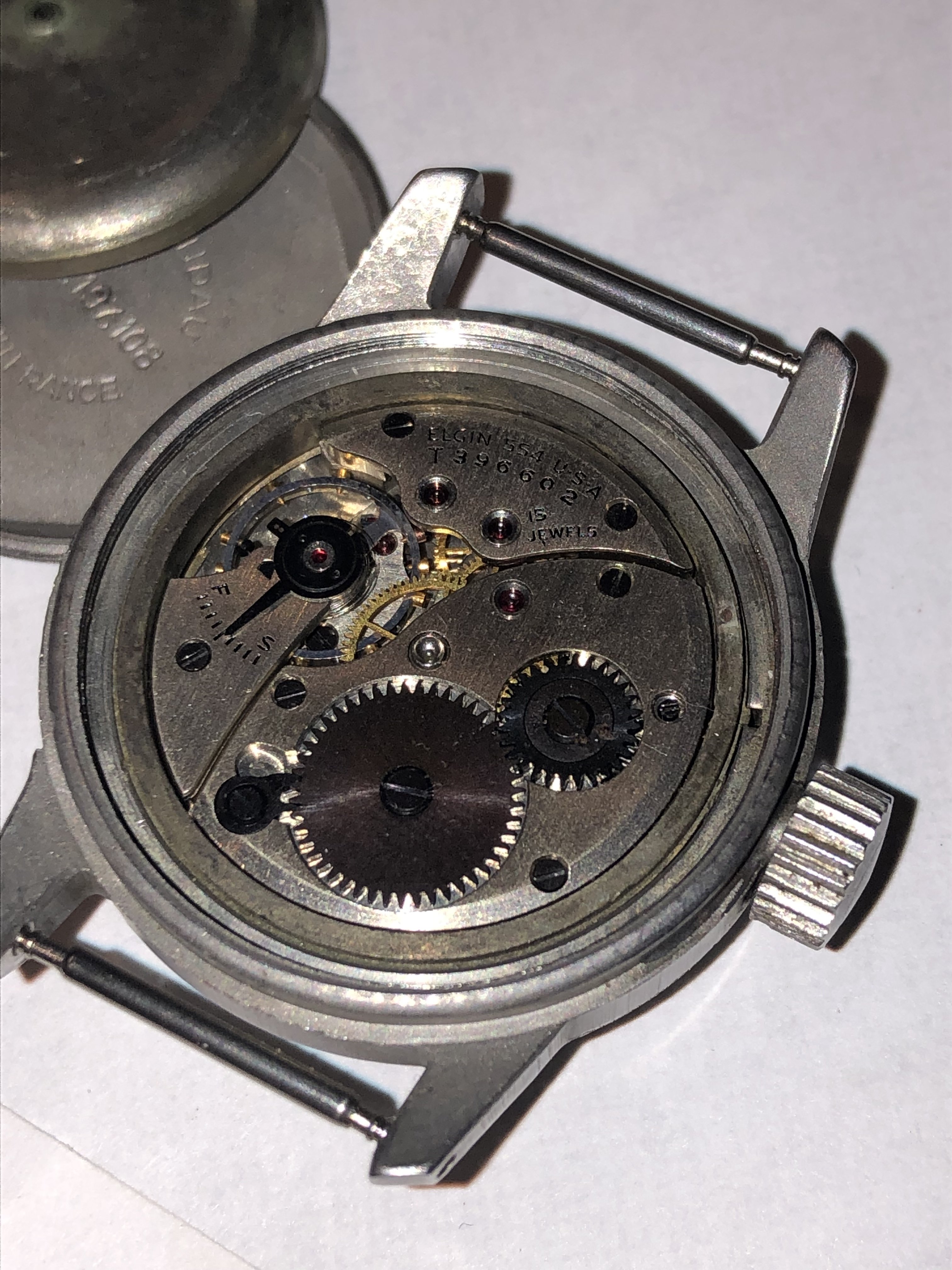

I just got a lovely vintage Elgin that was sold as recently lubed and serviced by a hobbiest (not a watchmaker), and keeping time. Obviously I always take that with a grain of salt and eventually have them serviced by my watchmaker anyway, but this one came running fast - and I mean real fast- as in gaining 5 hours within a 24 hour period. The regulator is set dead center so he didn’t accidentally set it too fast.
Is it possible this got magnetized during shipping and that may be the cause of the fast running? How would I know if the watch is magnetized? I plan on taking it to my watchmaker anyway but he is several weeks out right now and I would like to wear it for a bit for fun.

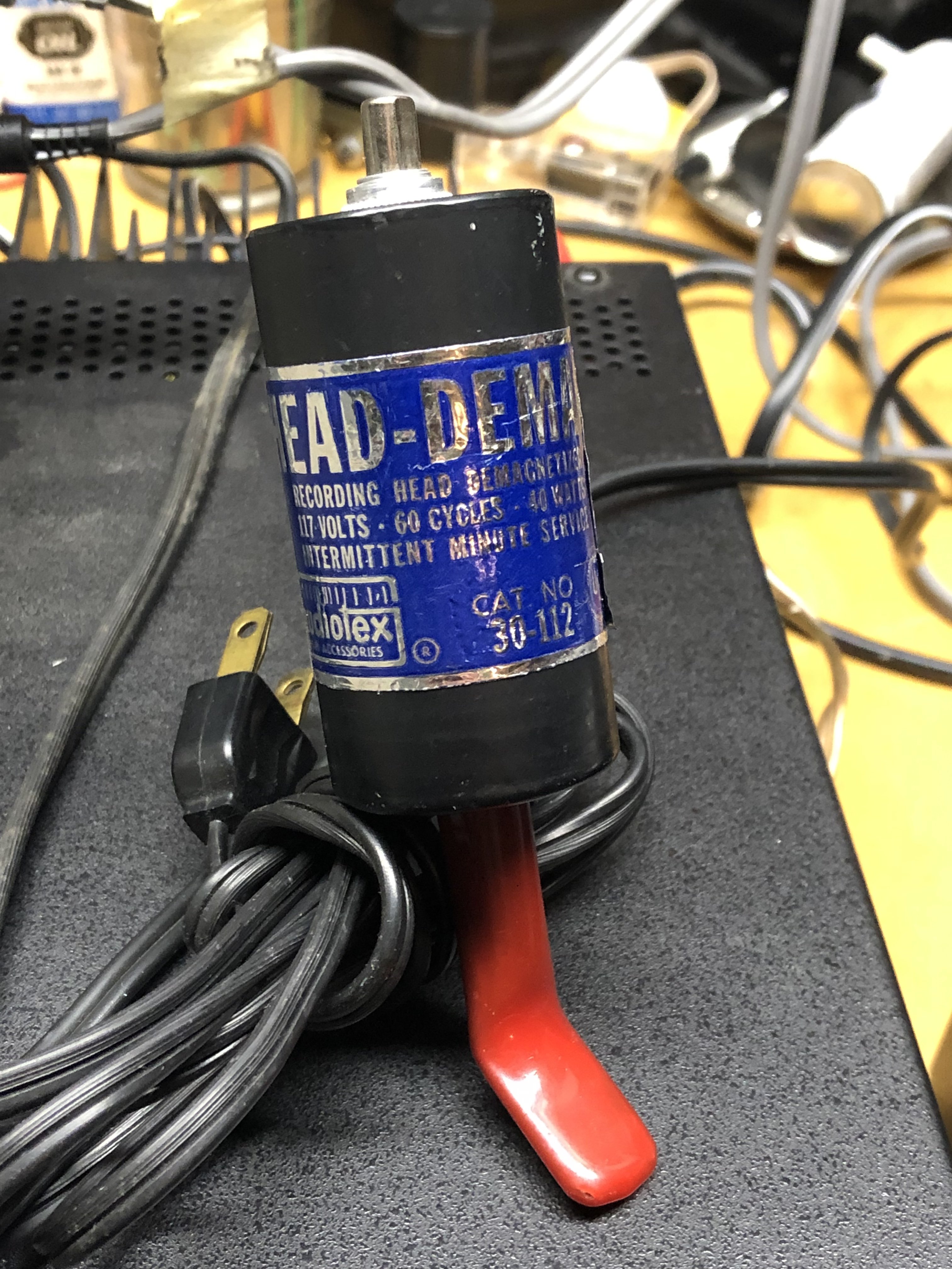

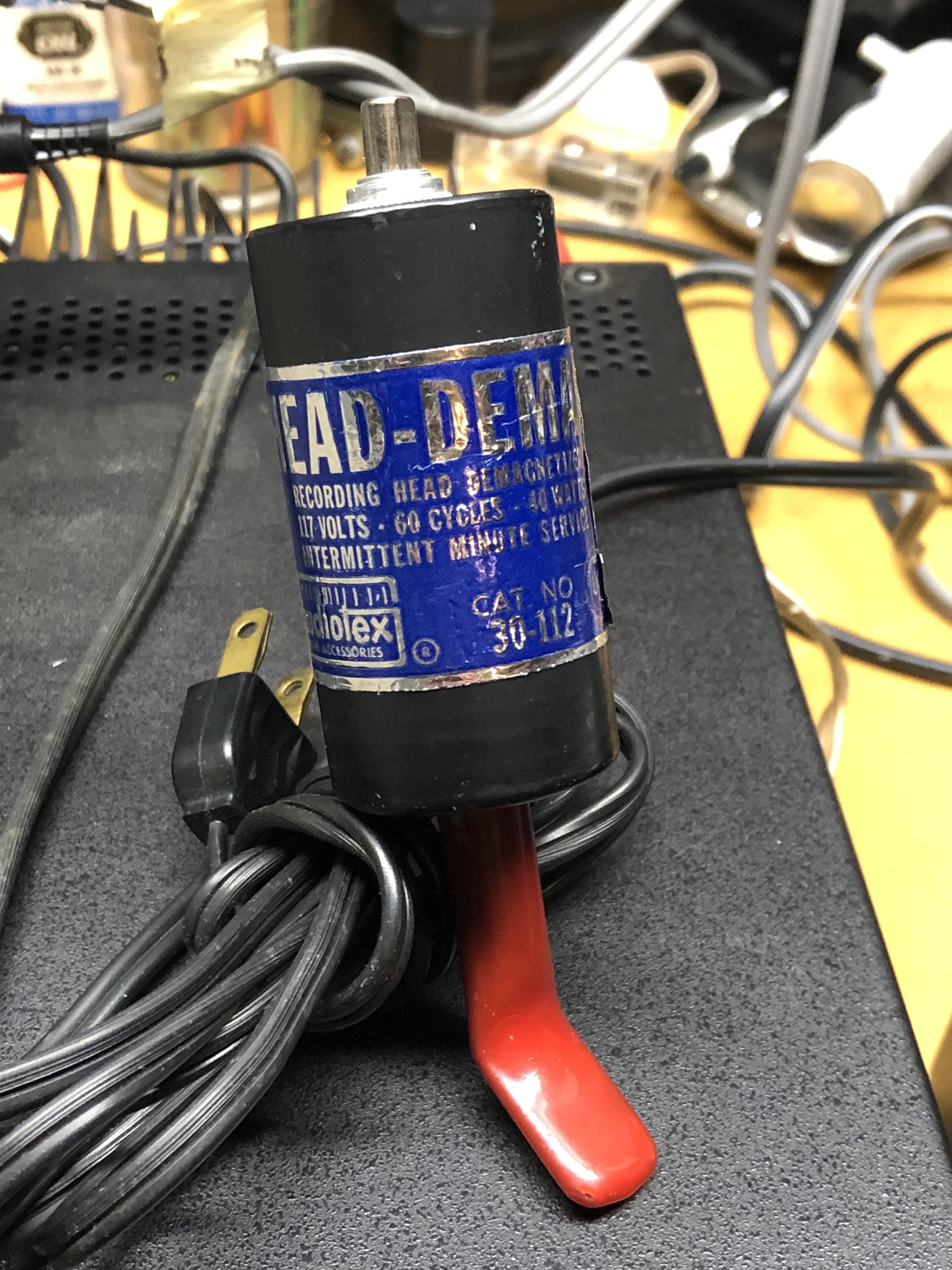

I have an old tape head degausser- the kind we used on open reel machines back in the day:
you hold it at arms length from the tape head and push a button, slowly bring it to the head and make a couple circle passes and pull it away from the head to discharge the magnetic charge- then release the button again at arms length. Would this type of demagnetizer work on a watch or would this do bad things to it- like the hairsping? If this is ok, how would I use it on a watch?

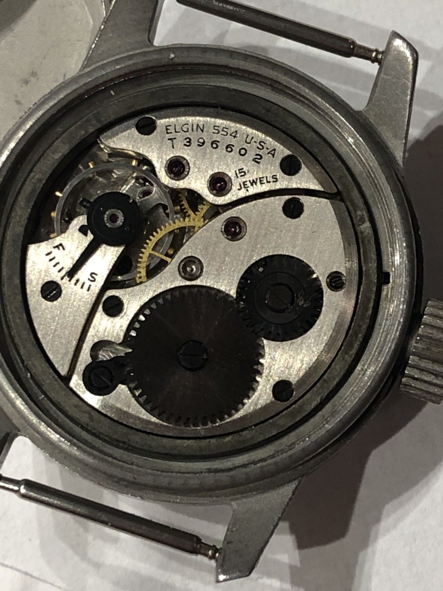

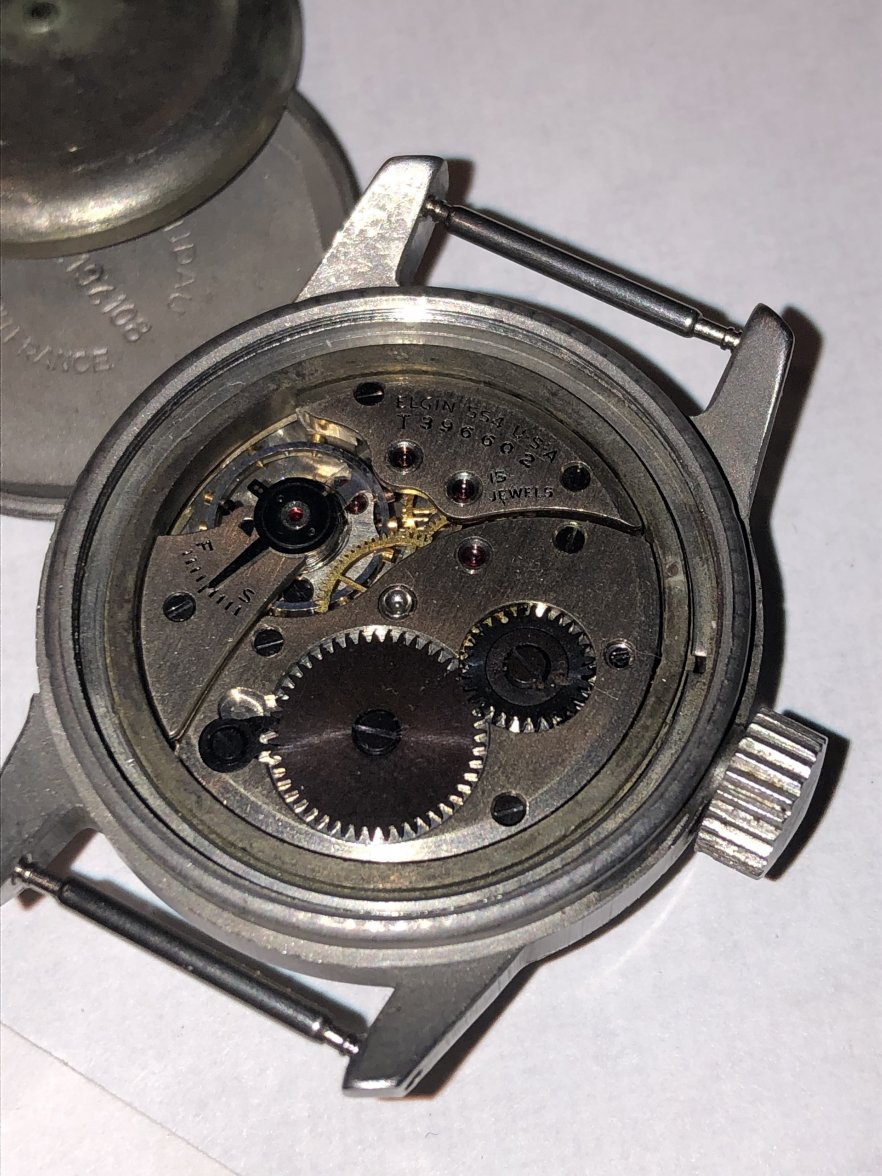

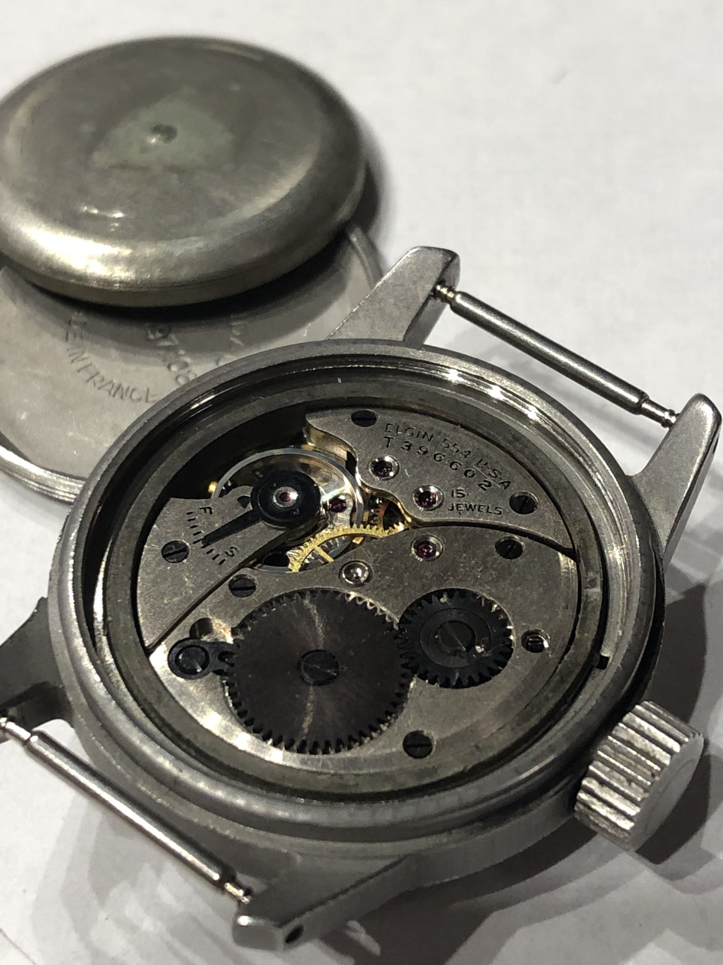

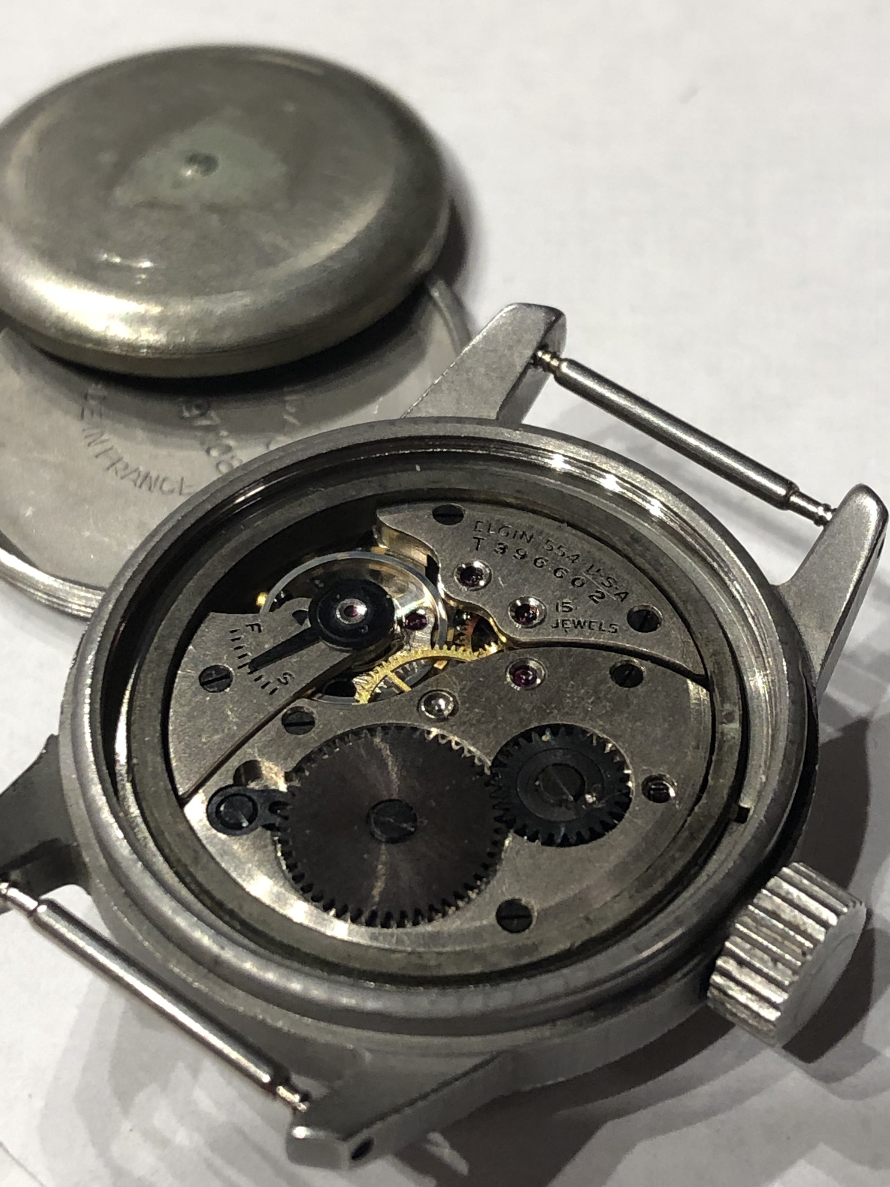

Movement shots for keener eyes than mine. The hairsping May look suspect in the flash stop action shot...maybe?

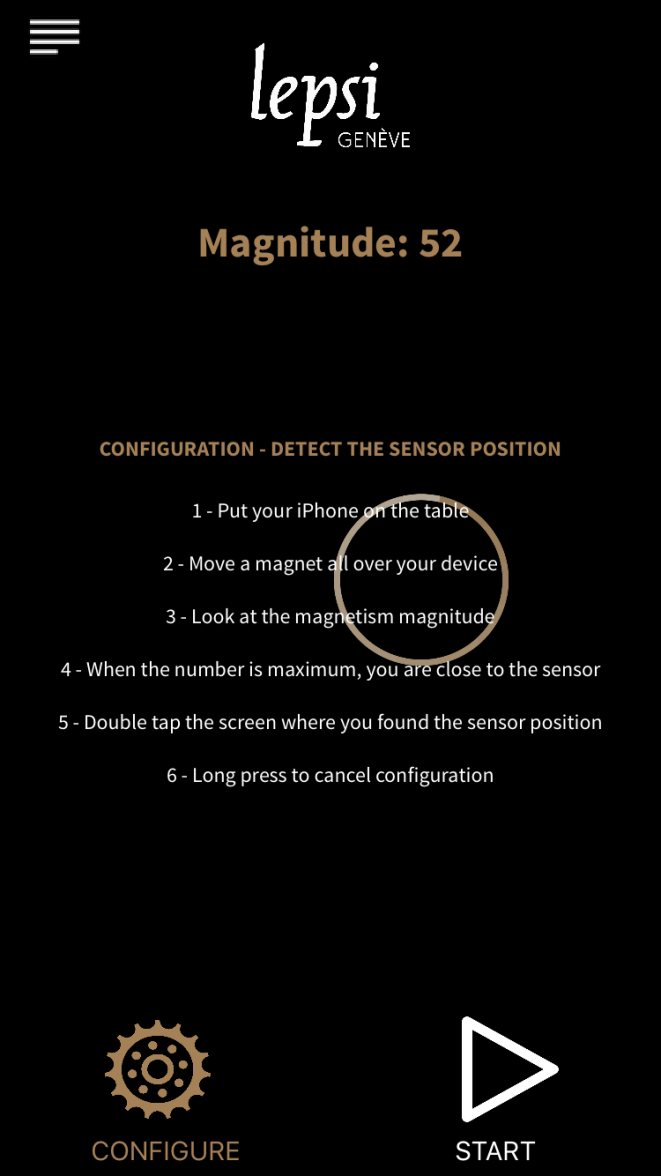

24,746
54,965
- Lepsi smart phone app.
- I'll bet your degausser will work.

16,305
45,013
I would have already tried it if I wasn’t afraid of don’t something bad. I just want to make sure that when I bring the electro-magnet to the watch the hairsping isn’t gonna to fly off in an unspooling nightmare 😲
24,746
54,965
The watch/tool demagnetizer is probably virtually identical to what you have, in a different footprint. The usual protocol is to start with the watch close to the demagnetizer, push the button, hold the watch in place for a few seconds and then slowly move the watch away from the demagnetizer while holding in the button. It should take roughly 5 seconds to move it to arms distance, although I don't think the speed is really critical. Release the button and repeat the process a few times.

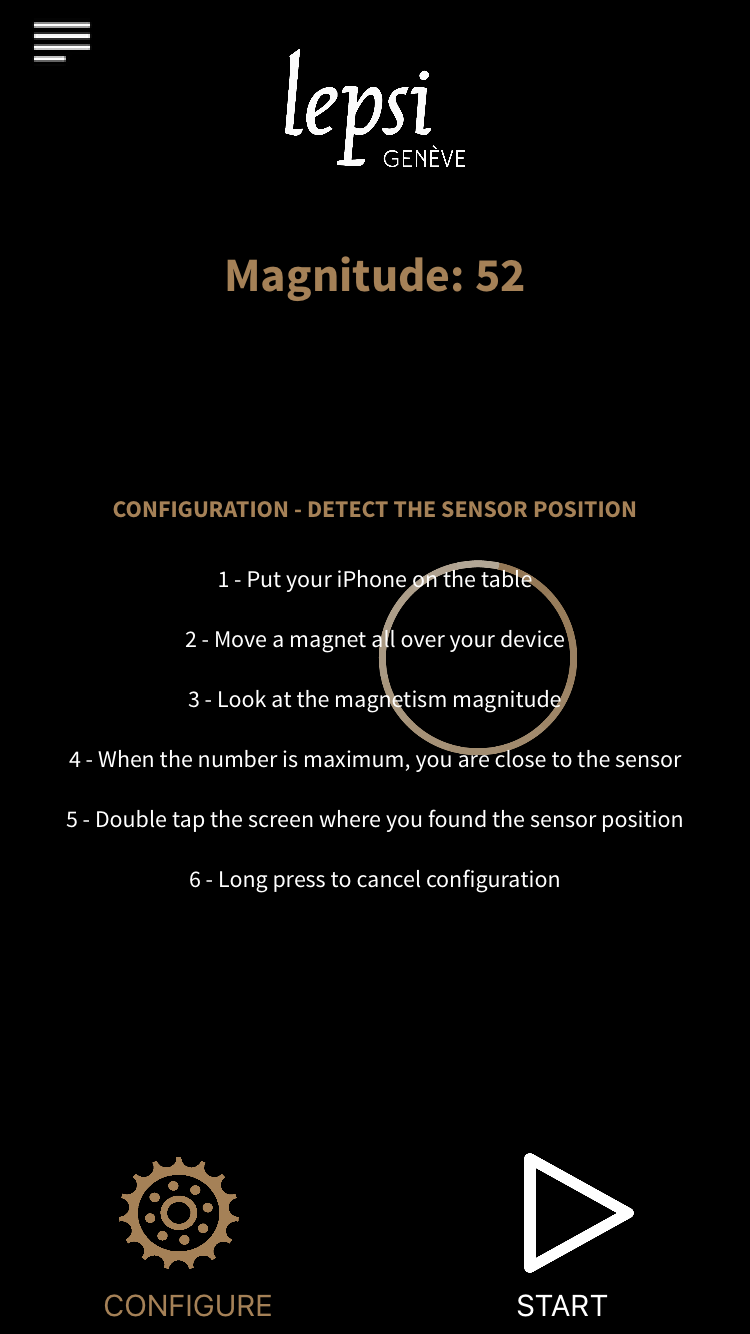

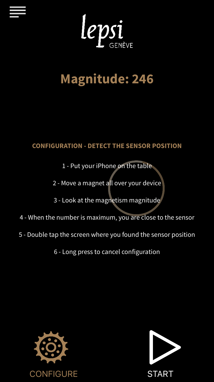

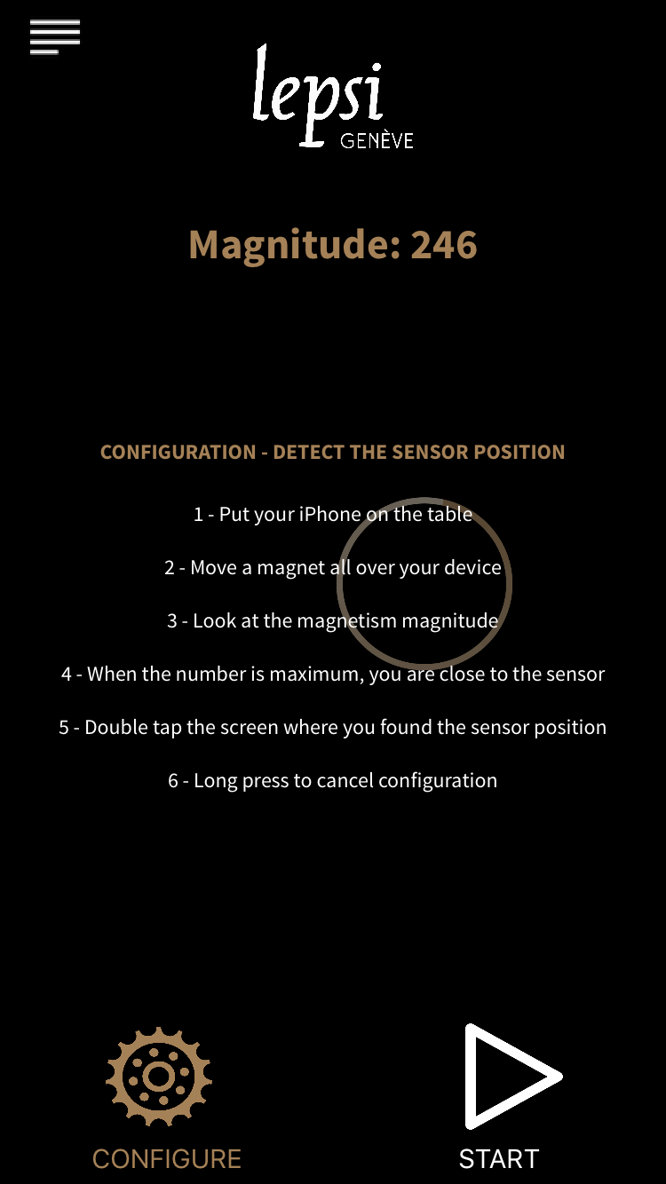

So I downloaded the app first pic is just sitting on the table.
It said place a magnet on the screen to find the sensor by reading the magnetism-I put the watch on it.
That looks high.
