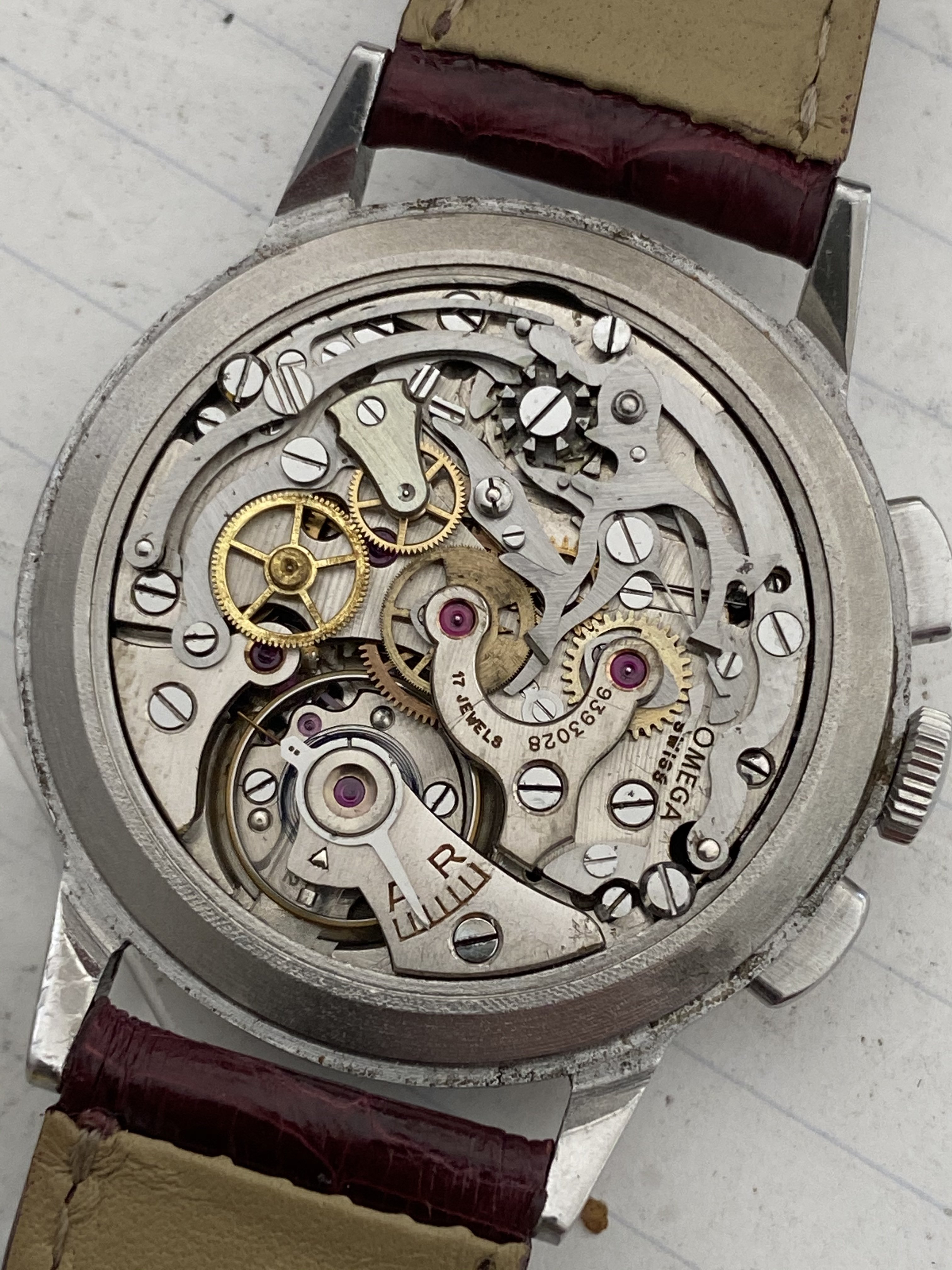

Damaged 27 CHRO T1 Movement?
824
1,493

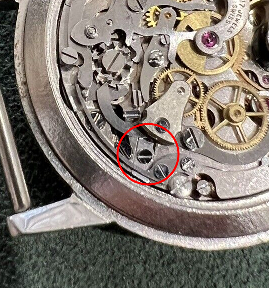

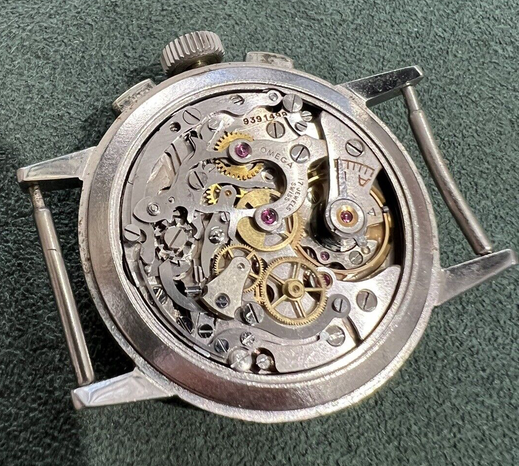

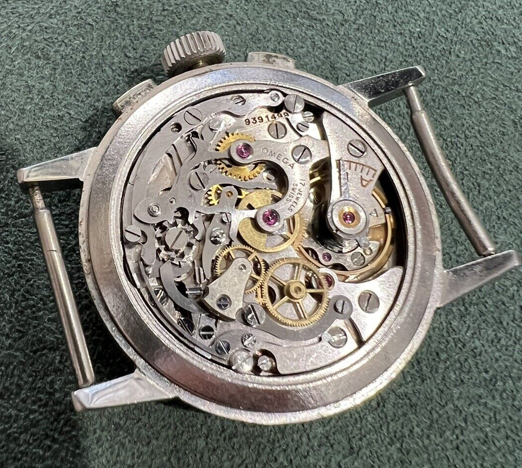

I've been wrong many times before, so I thought I'd check with folks here with more experience, but this movement has significant damage, right? I'd also guess that the chances of finding a replacement part are pretty low, unless the cal 320/321 updated version is compatible.

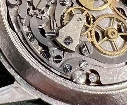

I’m by no means experienced, quite the opposite.

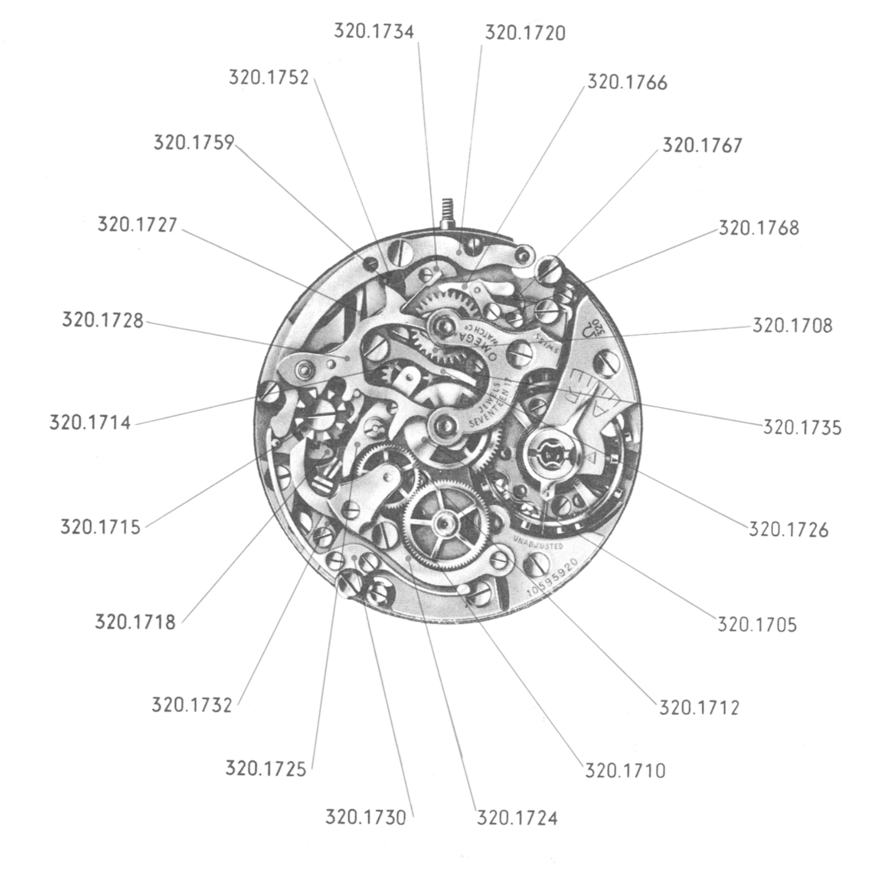

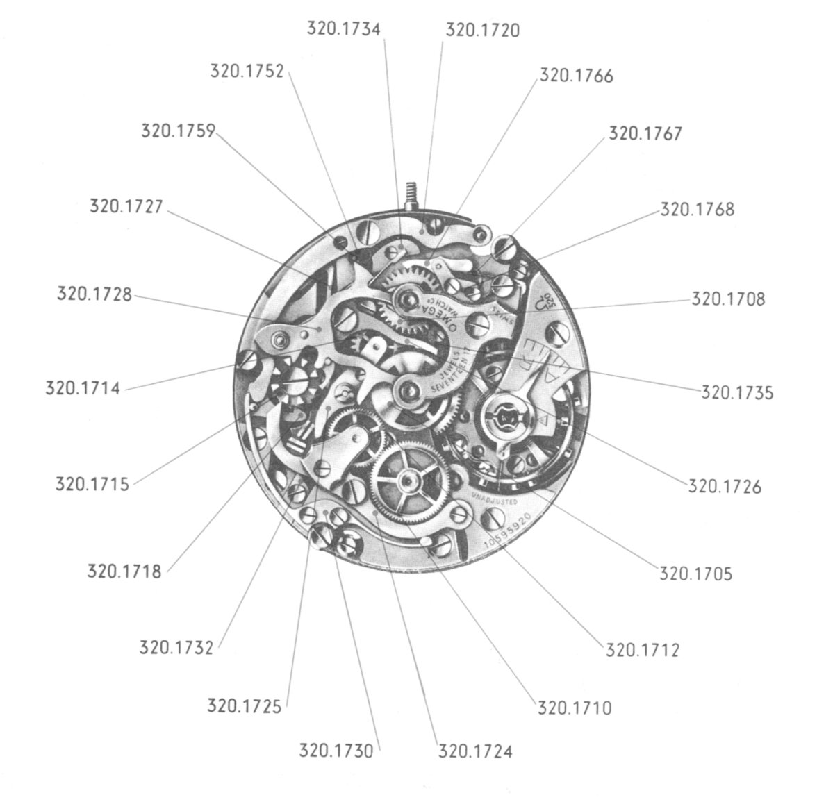

However, I thought I will try to understand what the issue is, but I have hard time locating the problem. Is it about part 320.1724?
824
1,493
What I'm seeing looks like a large crack in the piece to which 320.1732 attaches. Maybe it's just the camera angle / reflection?

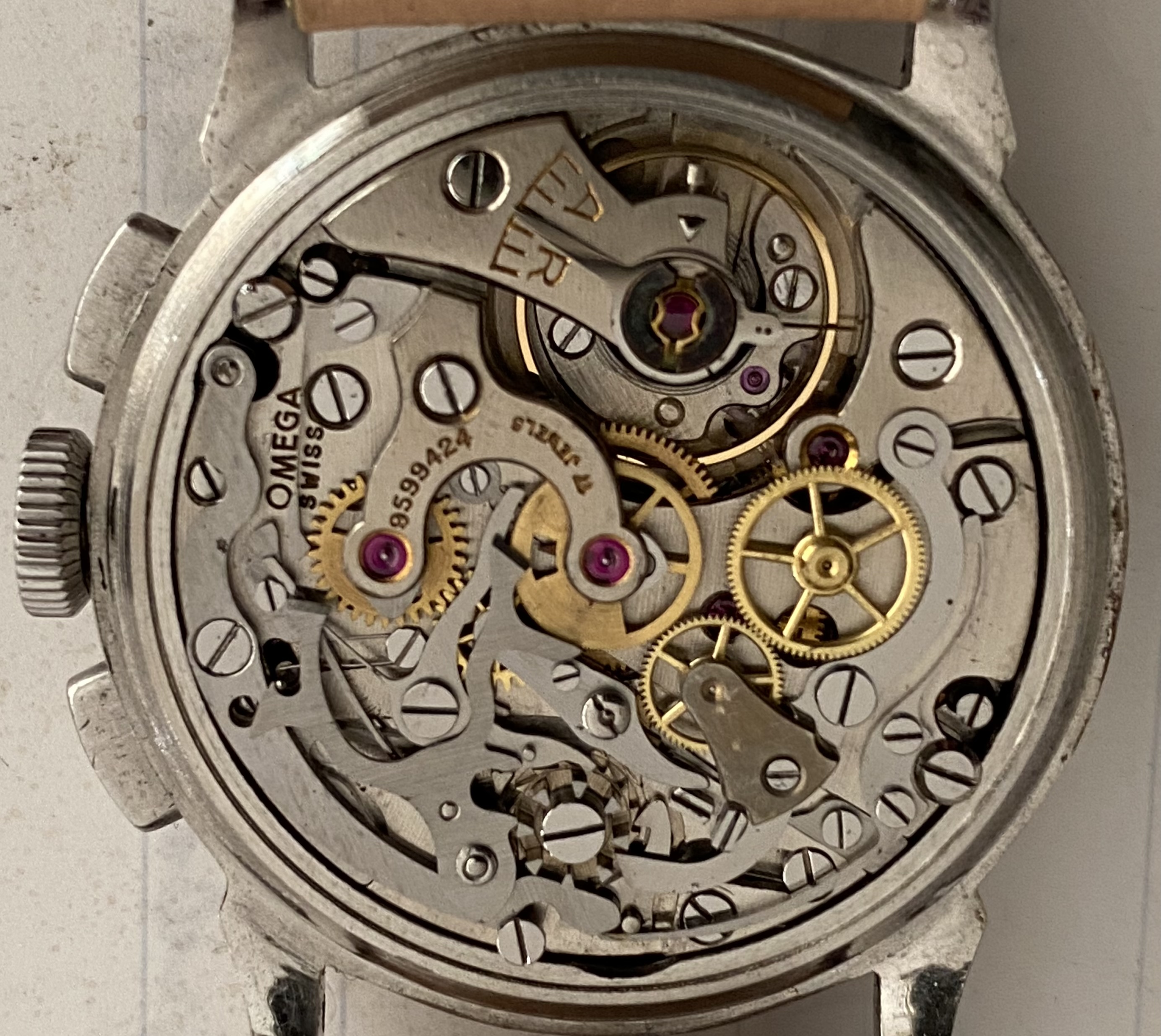

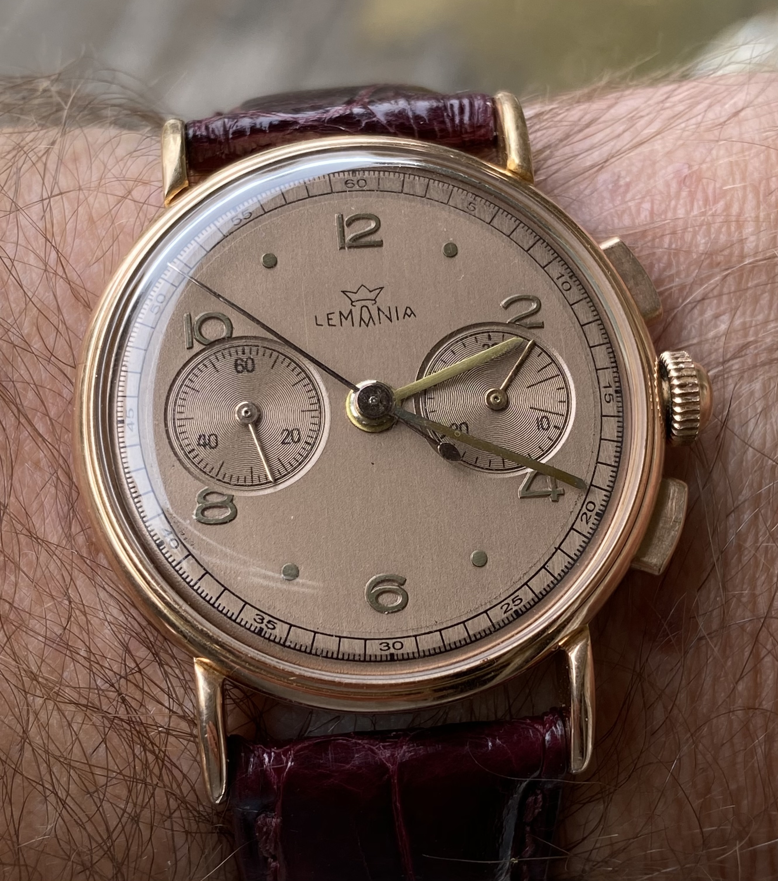

My early two register Lemania:

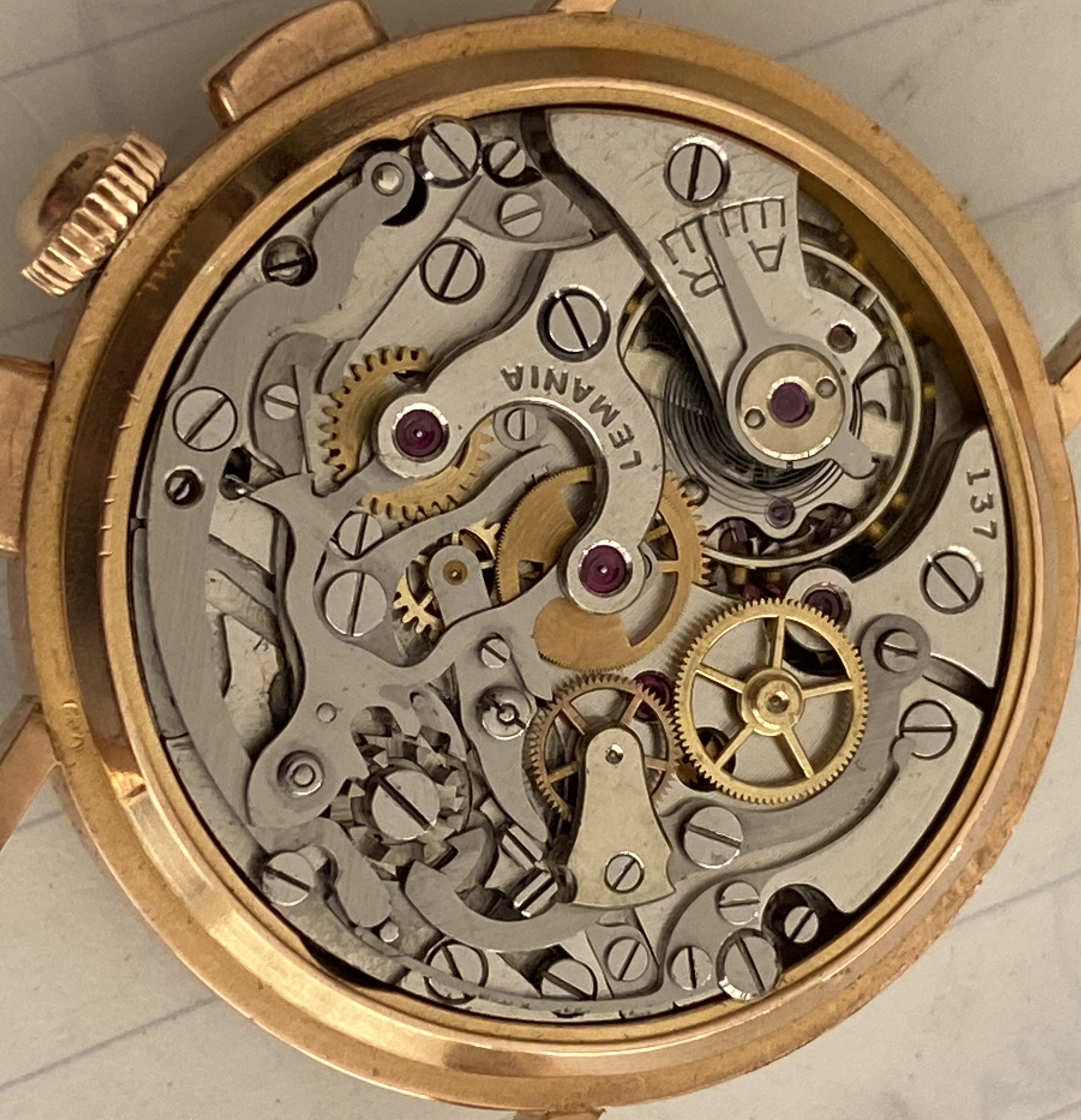

Looks like two distinct parts to me, not one that’s cracked.
(Mid 50’s redial)
Thank you very much for the examples. With those clear photos, I think you are correct. (A good reason to check with OF.)

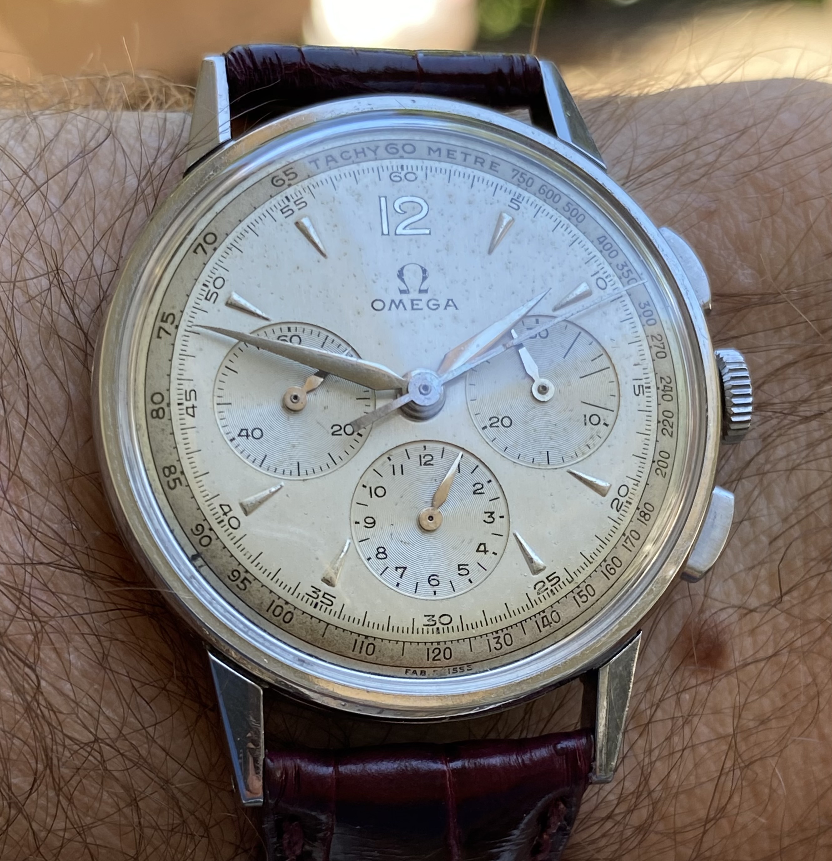

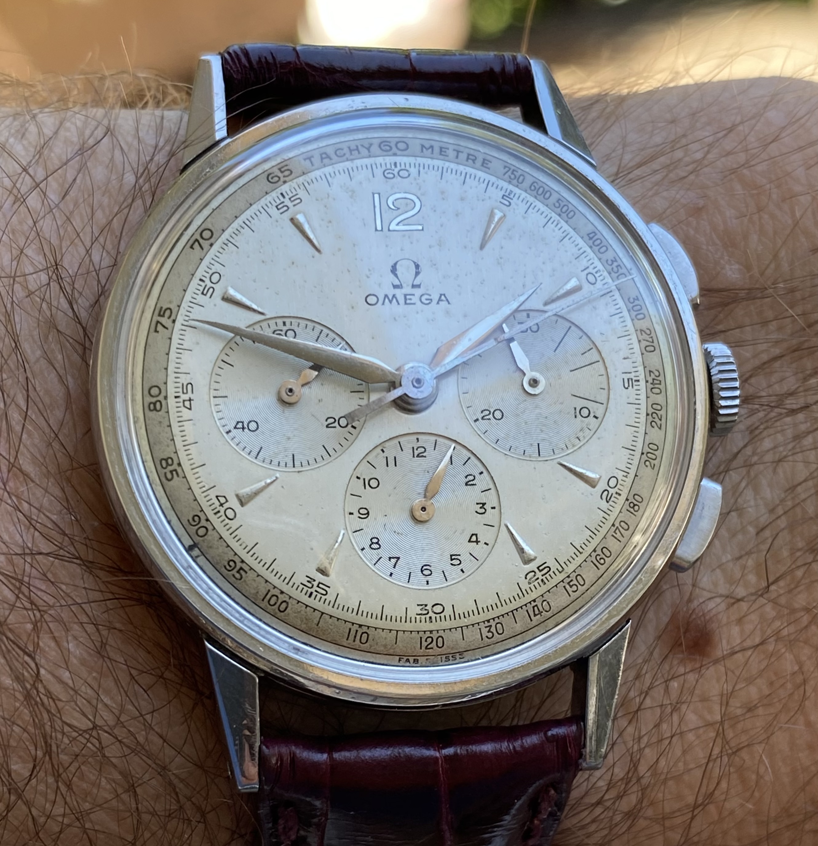

By the way, that’s a really early serial number, probably part of their first run, for an Omega 320, which came before the first 321s. Dates to late 1942, early 1943.
Here’s the earliest 321 I’ve found so far:
