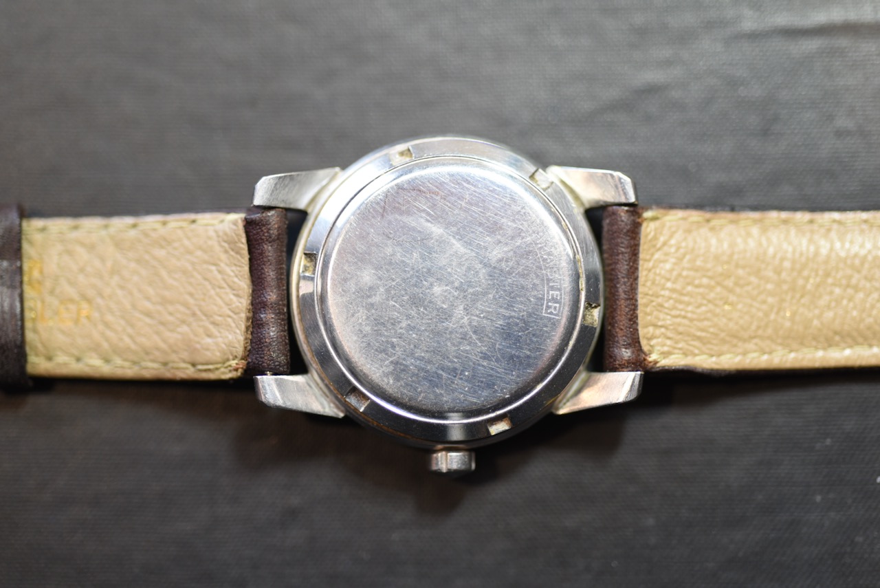

Dad died a dozen years ago, and Mom recently gave his watch to me. It had one of those awful stretch bands on it with a calendar in place of the links below the watch case, where you'd wind the tiny crown to find the calendar to match the current month. It was stretched out and rusted, so I replaced it with a band from one of my grandfather's Elgin watches. I've worn it a few times, usually when going out for dinner or need to dress up. Otherwise, it rests in an old jewelry box my uncle had. It keeps excellent time, and winds itself as expected.

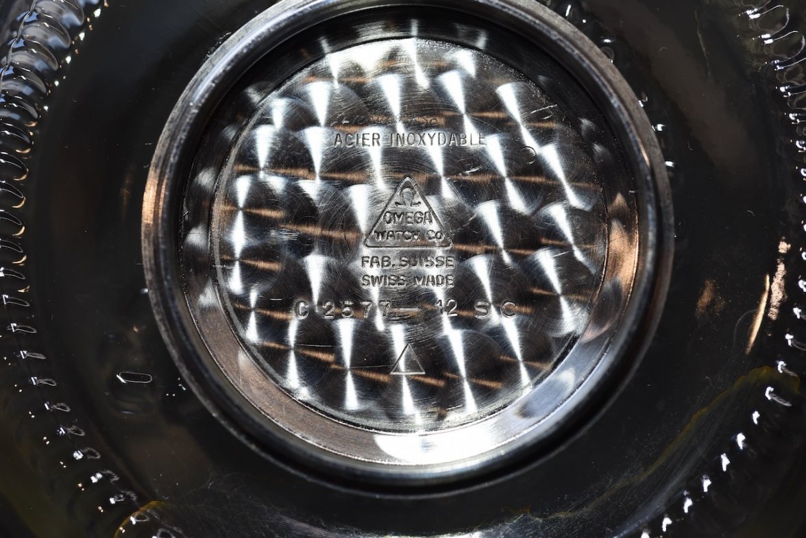

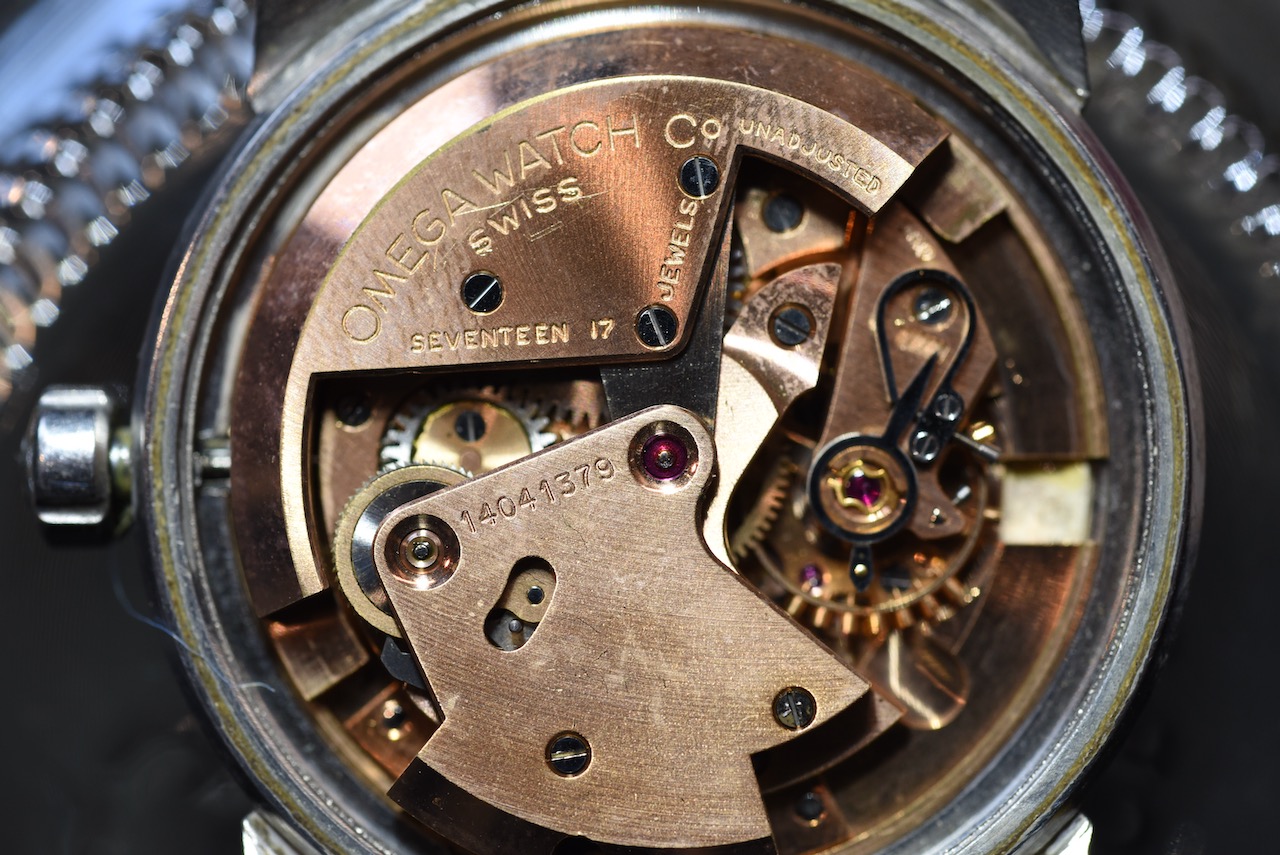

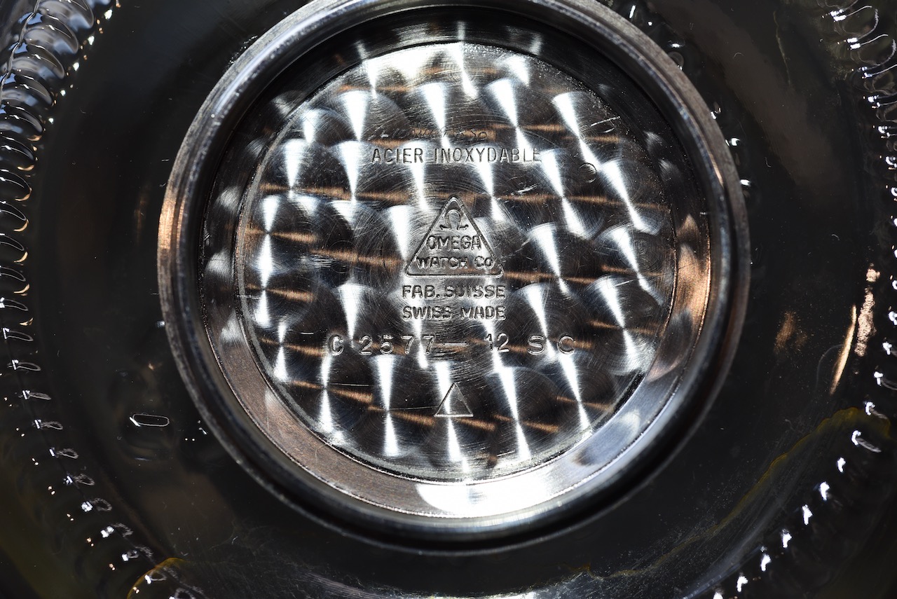

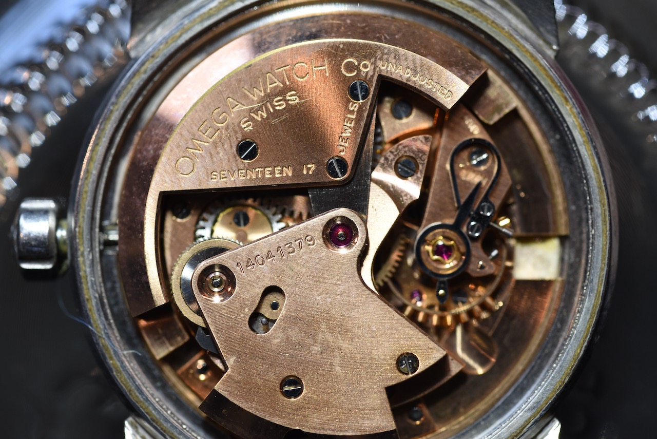

A huge thanks to the folks who steered me to the Kong dog toy. That made removing the case back relatively easy. Inside, I found that I have a calibre 354 movement, and reference C2577-12 SC watch with the serial number 14041379. According to the frequently linked reference, this watch was made in 1954. I'm not sure if this date can be narrowed down any more. A site called OmegaAddicts has a database of serial numbers, and finding ones close to mine yields a very late 1953 or more likely early 1954. Not sure where he gets this information, as the published serial number ranges are for even years during that period.
Yes, I got that blue fiber out before putting on the case back. 😉

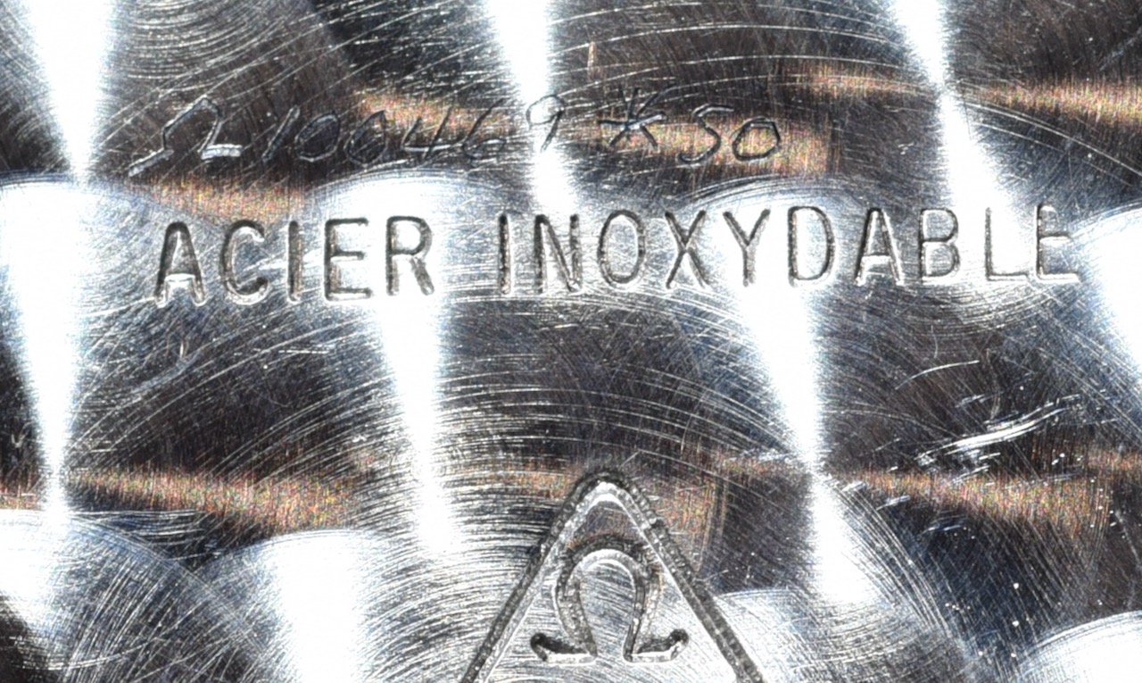

Mom seems to think that the watch has never been serviced. But I thought I remembered that he sent it in for some reason. Probably losing time or the automatic winder wasn't winding. Looking at the watch face, and after reading so many other "Dad's watch" threads, I thought it likely had been redialed. After I got it opened, I found this marking inside the case back.

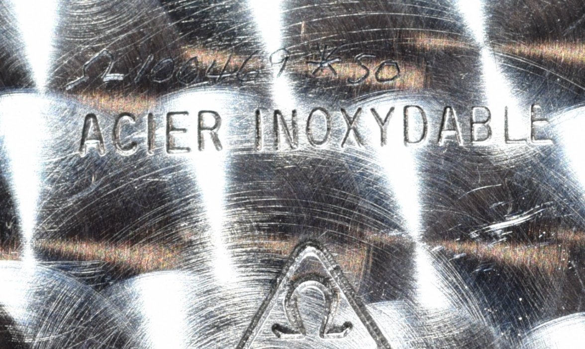

I assume that the etched information is a watchmaker's markings. If it is difficult to read in these reduced images, it shows Ω100469*50 (or S0). Can I assume it was repaired at an Omega service center, and that the next group of numbers represents October 4, 1969 or April 10, 1969, depending on where it was serviced? Are the last three markings a standardized code, or simply something that particular watchmaker used?

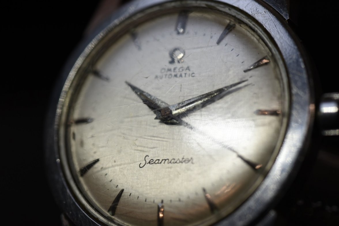

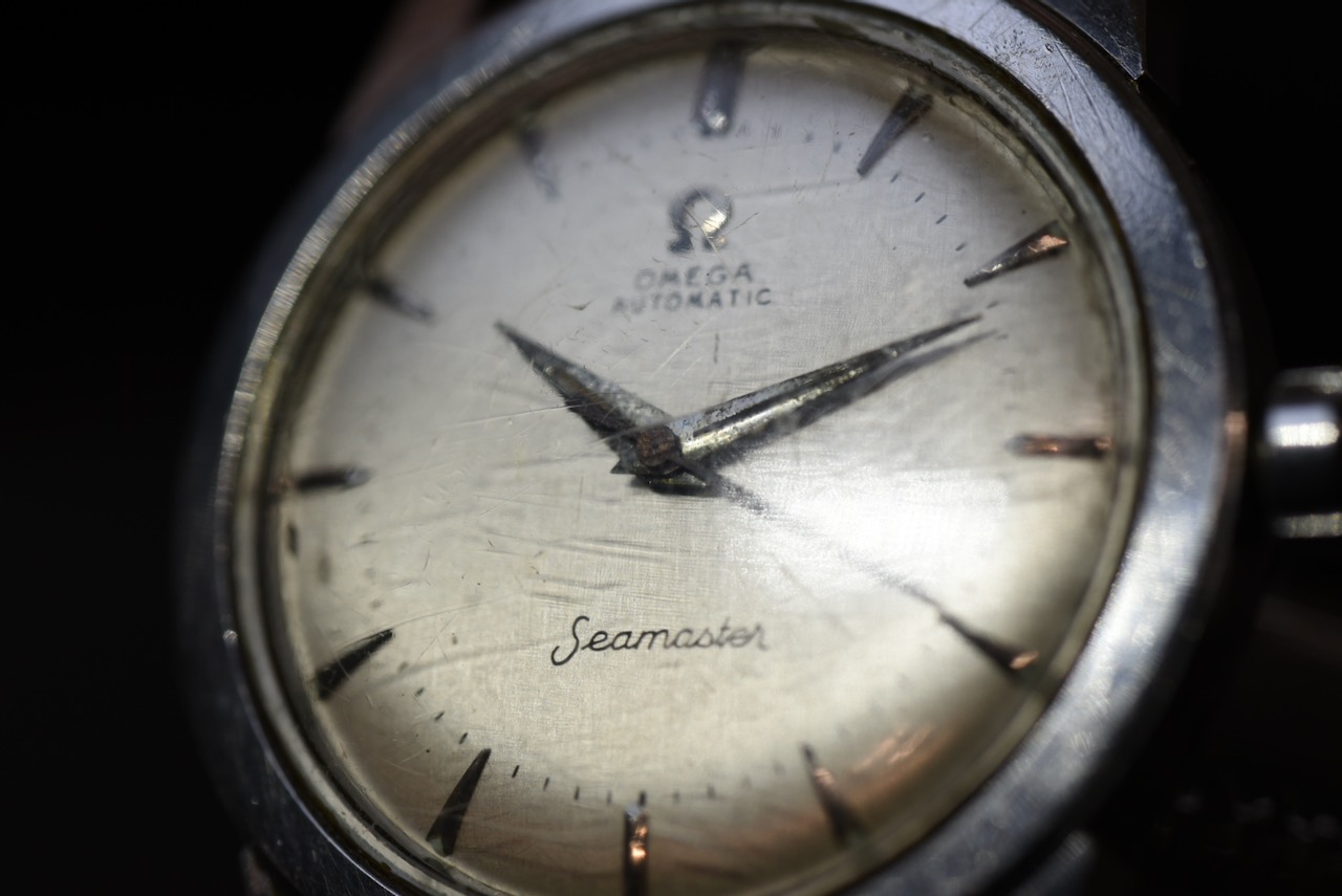

A closer look at the dial, and with the help of similar threads, I'm all but certain the watch has been redialed. The text for AUTOMATIC is nearly the same size as the OMEGA text, and the text looks almost hand painted, particularly the M. Some of the hour markers are off by a bit. Am I correct that it has been redialed?

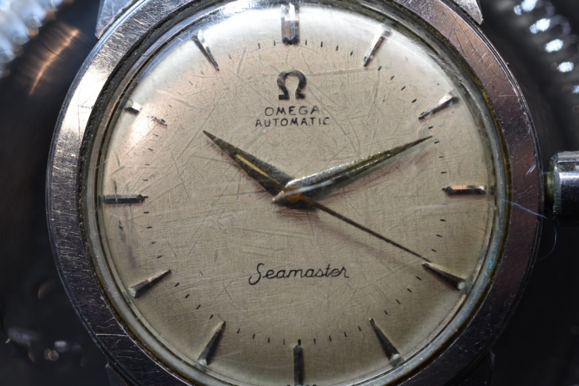

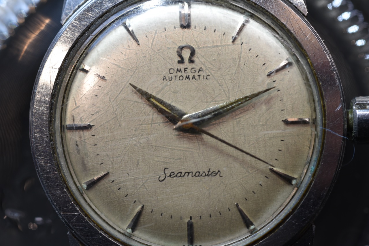

This photo also shows how scratched the case and crystal have become, and there's a crack near the 9 o'clock marker. This crystal does not have the Omega logo on the center. Did all Hesalite crystals have the logo molded in, or only certain models or years? I'm assuming since the dial was replaced, the crystal would have been at the same time.
This photo shows more of the scratching, and that the hands are corroded. There's also a bit of green at the 6 o'clock position, so at some point, moisture has gotten inside.

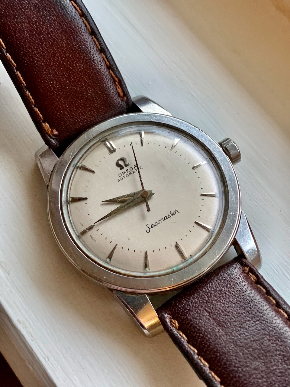

So, that's the watch as it is today. I have no intention of ever selling Dad's watch, but I enjoy wearing it on occasion. My own wonderful wife knew how much I admired Dad's watch, and bought me my own Seamaster in 1999 (2551.80.00), which I wear all day, every day.

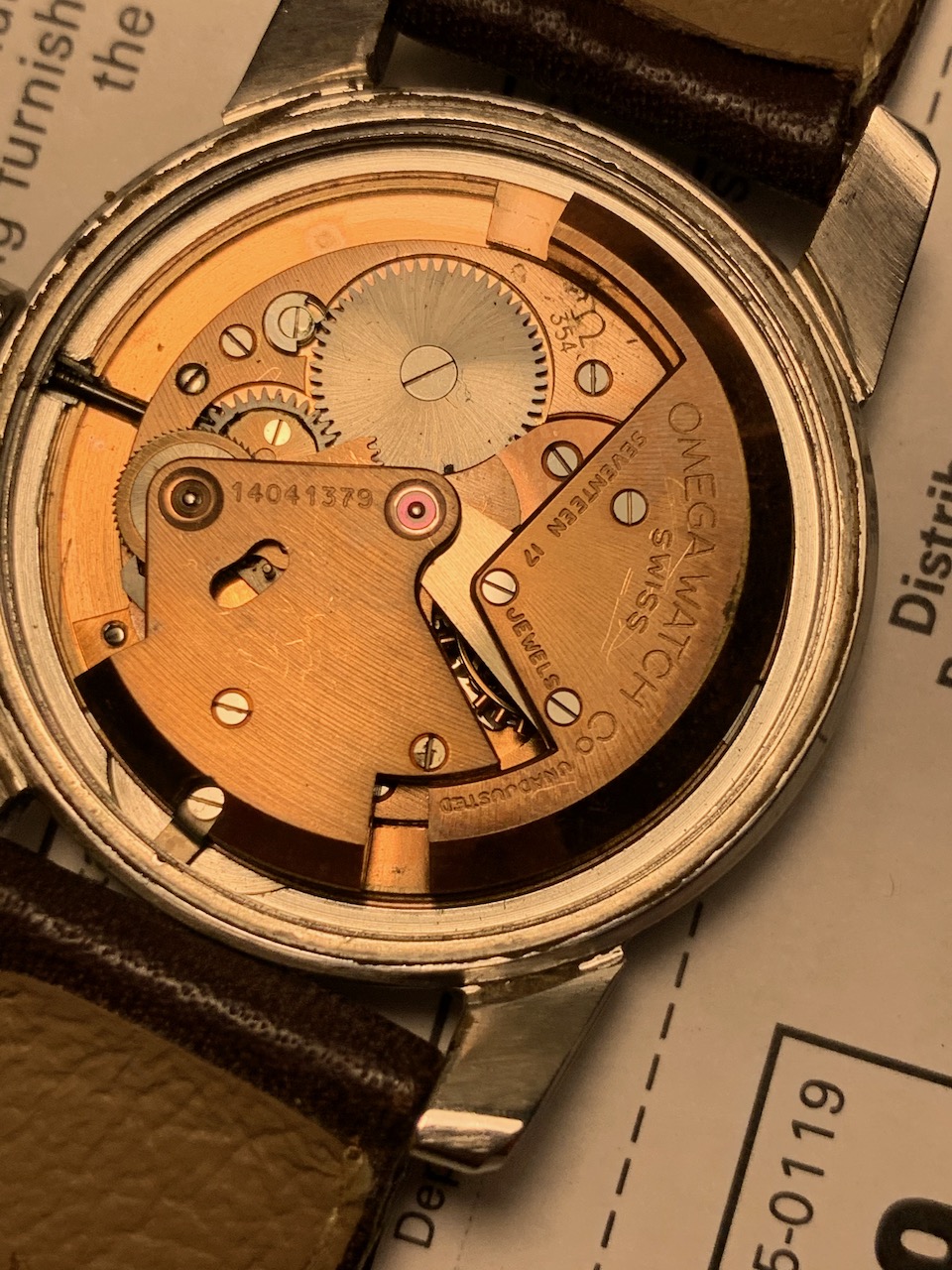

Additional photo, because I realized my macro shots did not include the calibre. Yep, it is dirty in there!

You should be able to get an Omega crystal for this watch will (probably) have the symbol. It might be a little early for the symbol.
The watchmaker marks are a code used by that place so, I doubt you can ever be sure what they mean.

I also think it has been redialled so I'd think you're right about your value estimate. Not to worry as if it was my Dad's watch, I'd wear it regardless.

I think the watch looks honest and has had a life, as you said... The dial has been redone, you already mentioned that. Well, the case hasn't been polished, which is a big plus.
As for the crystal, it should have the Omega logo in the centre. I am not sure if original crystals for this reference are available from Omega, but I'm sure that @Archer knows this.
You will find a matching used spare part for the rusty second hand, if you do some search.

- first of all, I don’t find the case to be so badly scratched up. You’ll be surprised how transformed your watch will look only by changing the crystal; when you get the watch serviced I suggest you ask that the case not be polished- as it may clash with the age and condition of the dial;

Does anybody know what the triangle is/means on the inside caseback below the reference stamp?
I have seen it on another vintage seamaster bumper model and have since wondered about it.

Dial has been refinished. Get it serviced, new crystal and maybe try and find some gently used hands to replace the current aged ones

@Syrte You've convinced me to look beyond black. The mahogany that's on it now looks okay, and likely of a similar time period, as it came from a grandfather's Elgin, so I might stick with it.
