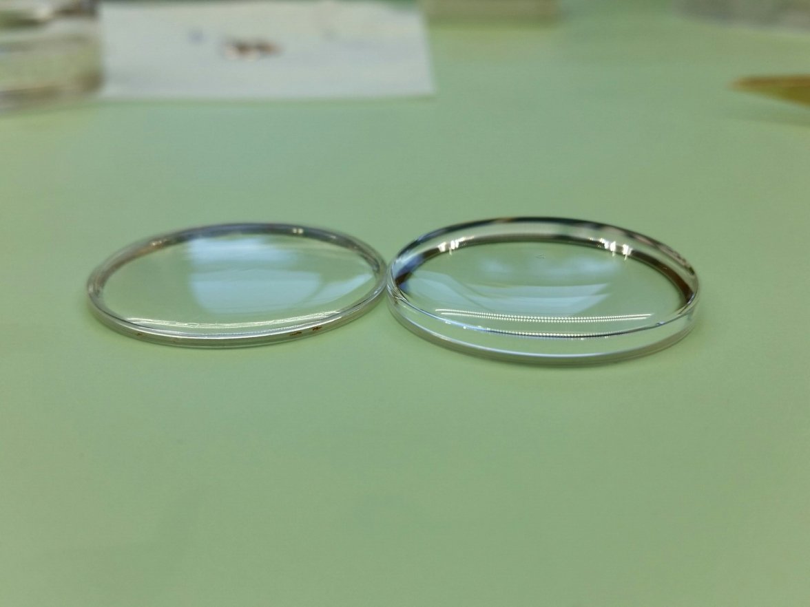

Here is the original, low profile crystal and the size of the replacement.
I chose to polish the original for my 14381.

Wow, what a difference. Is that small Omega logo inscription actually in the inside or the outside?
2,816
6,951
Inside. The originals were also very lightly etched compared with the later replacements.
