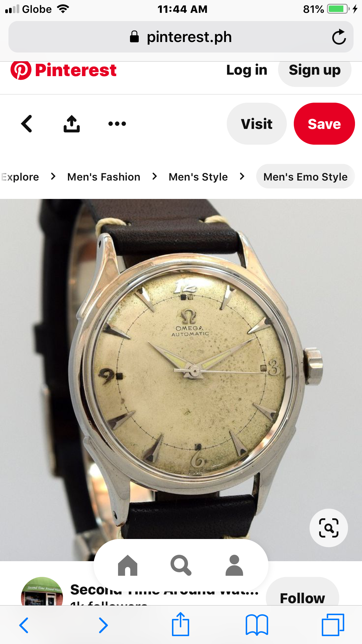

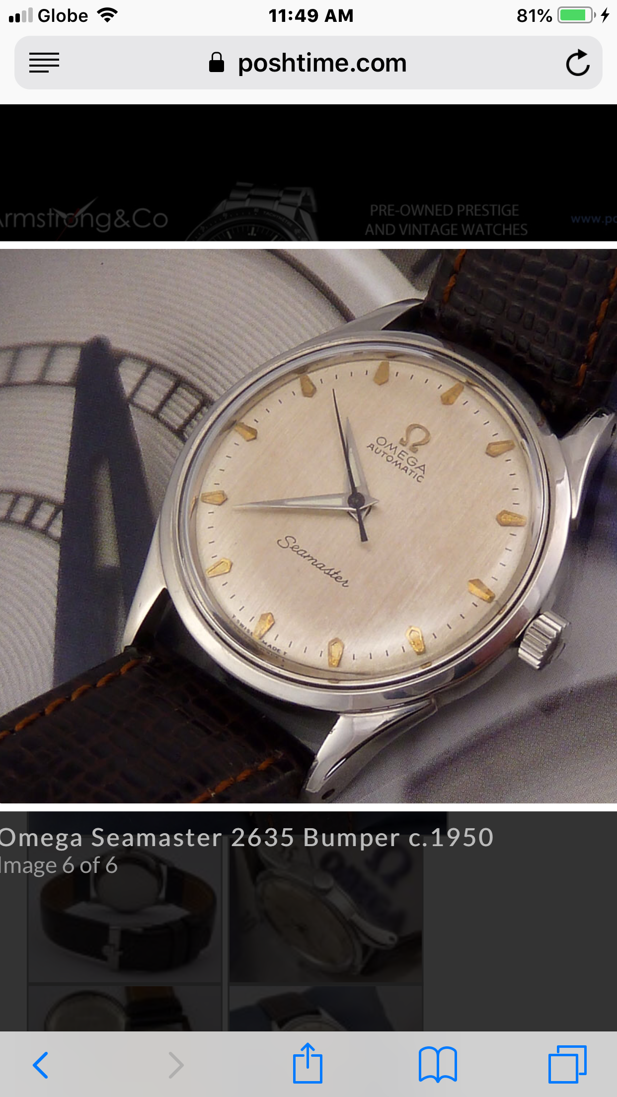

Size for 1954 Omega Seamaster ref 2635-7 33mm case diameter, Caliber 354, do i indicate the case diameter or the crystal diameter? Attaching pics (not mine but same model) of the same watch for reference.
