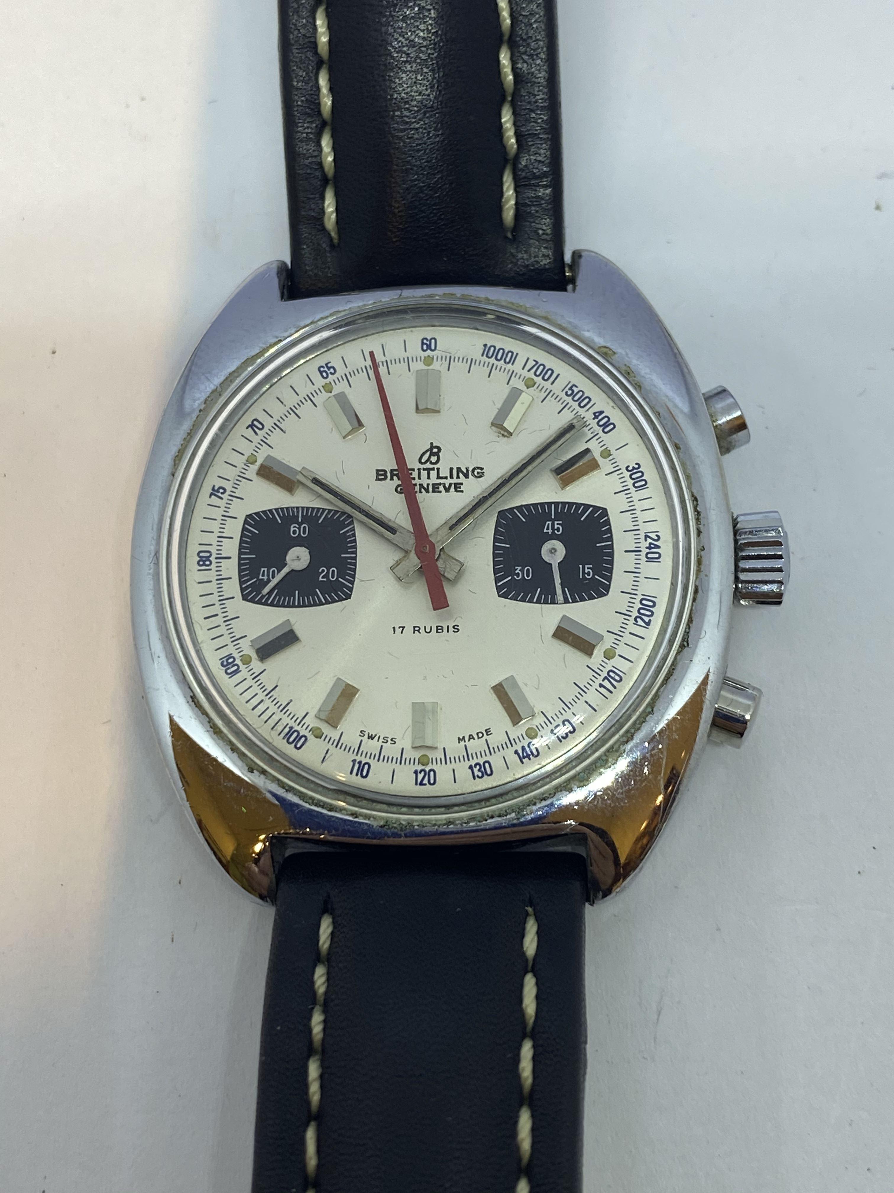

Posts 584 Likes 283 peire06 ·Nov 19, 2020 Hi to all fellow members. Can someone help me identify the reference of this vintage (1960s) Breitling chronograph? Thanks. Much appreciated. Peire06
Posts 212 Likes 315 Ascalon ·Nov 19, 2020 Looks like it is based on a Valjoux 92 movement. Very distinctive for the 45 minute chrono counter.
Posts 2,298 Likes 3,155 Passover ·Nov 19, 2020 Looking at the subdials - Isn't it more early 70s than 60s?
Posts 2,597 Likes 5,666 w154 ·Nov 19, 2020 Ascalon Looks like it is based on a Valjoux 92 movement. Very distinctive for the 45 minute chrono counter. Could be Landeron or others. Not just the Val 92 with a 45 minute counter.
Posts 479 Likes 1,553 MoclovFlop ·Nov 19, 2020 w154 Could be Landeron or others. Not just the Val 92 with a 45 minute counter. Yeah, Landeron 248 is a good call. But I think I'd put my money on a Valjoux 7733 being in there. And that logo screams non-original. I'd suggest you walk away unless the authenticity doesn't bother you.
