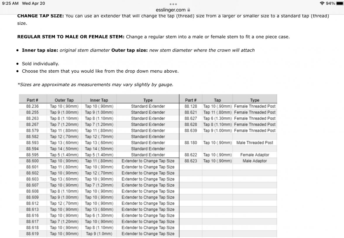

I have a watch with a .9mm winder stem but a screw crown and tube with 1.2mm thread. Is there a converter like a stem extender which can make a 1.2 crown fit a .9 stem?
Before anyone comments, I have tried to get 1.2 winder stem but cannot source one! Any advice much appreciated.
15,743
47,136

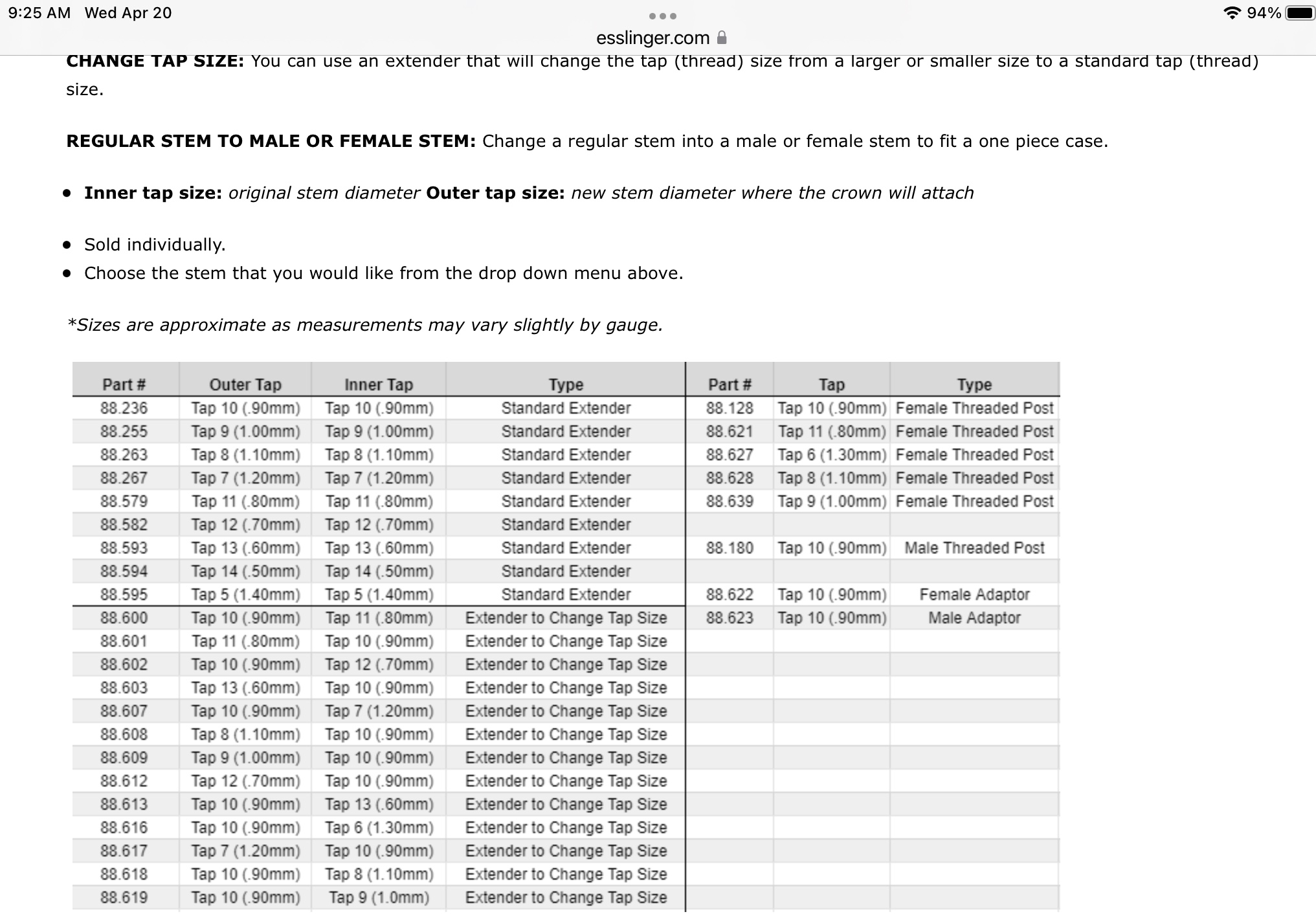

Available from Esslinger, and most other watch material suppliers. These are slot in packages by size, of 10 or 12. So don’t try to buy just one.
