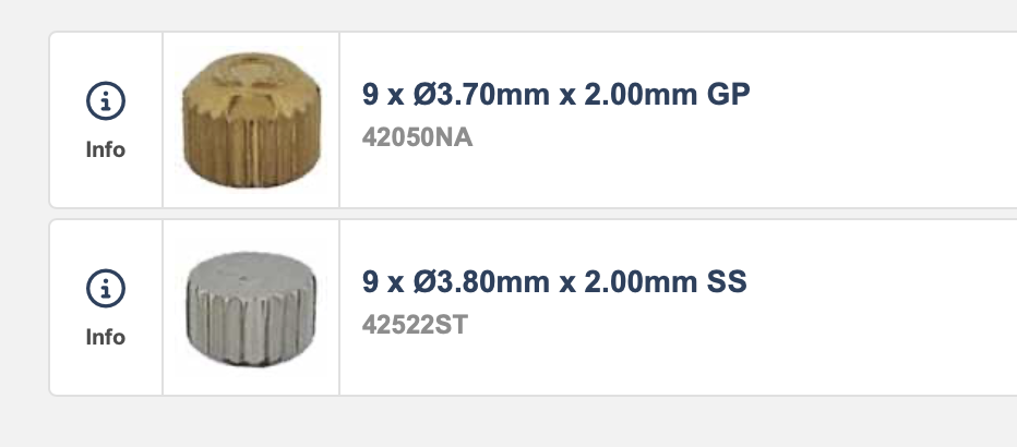

@ossfm , I've a feeling that the crown that was on your watch may be for the 168.016/18 rather than the correct replacement crown for the 168.010
I can't be absolutely sure (because Cousins no longer list all of the crown colours) but I think that 42050 is the domed option for the 'hidden crown' Connies and 42522 is the flat topped version (which is more like the original IMHO)

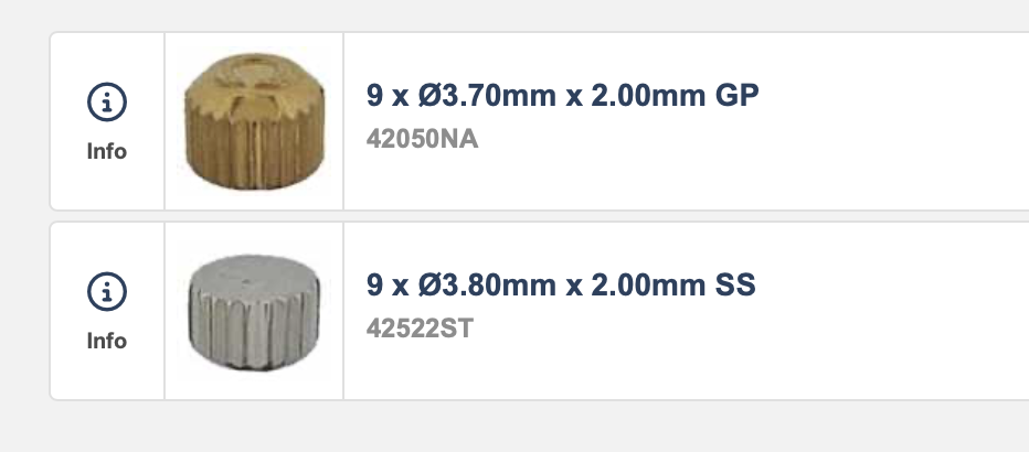

That might very well be correct - I've just quoted from a list of references for crowns/plexis that we've had here. Could be Omegas service option.
Yep, you're quite right - they're both quoted as 'correct' replacement crowns for both the 168.004 and 168.010.
The domed ones have appeared on the earlier 'fully hidden' .004s and it has been suggested that they could have been an original option (as a semi-hidden crown) but I don't think there is any hard evidence of them being an original option on either .004s or .010s

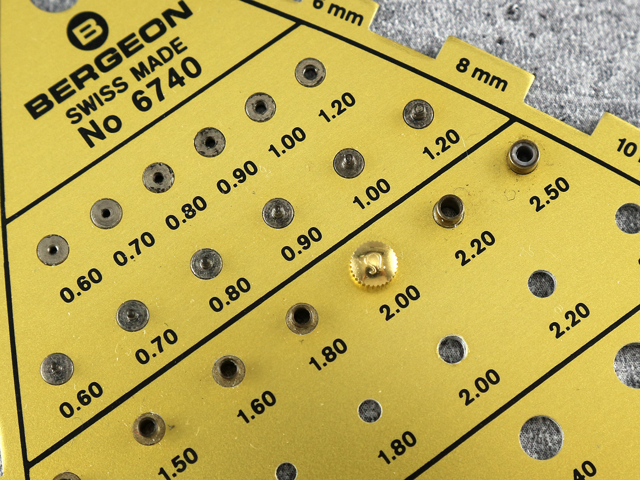

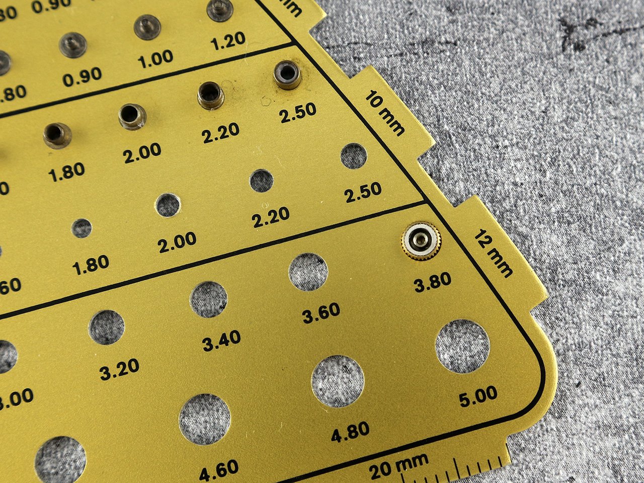

The Ebay link is still valid. The caliper picture is a bit concerning since it is almost 1mm too small: 2.93 vs 3.75 as shown above.
