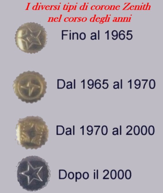

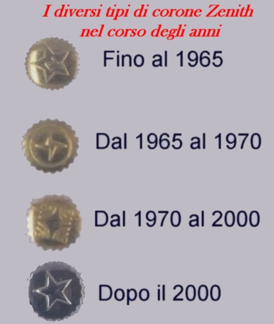

I'm looking at a Zenith from the early 1960s and the crown looks a little out of place relative to the case. The logo is the one where the star is recessed by a wavy pattern forming a square (see: https://www.ebay.co.uk/itm/Vintage-...560611?hash=item340d5df463:g:BPYAAOSwi6tdD15C). Does anyone have any knowledge on which logo was used on crowns in this decade? If it is the wrong crown, does this indicate anything about the rest of the watch? Thank you very much

The crown you have linked is generally accepted as being a 1970s+ version

I would have guessed a star crown for that watch. After that, the crowns had the pin-wheel logo. The 4-corners square logo is later IMO.

@wristpirate Is correct but I have seen that crown on later 60s watches as well. I don’t know that there is a hard and fast rule about when, exactly, they switched. The long buckle is the right style for the time but it looks like it’s a Mondia. The case number would suggest 1963 give or take.

Yellow gold crown on a rose gold watch. That tells you enough about originality.
As @Dan S says I'd guess a "Z in star" logo crown for this model, not one I know well enough.
