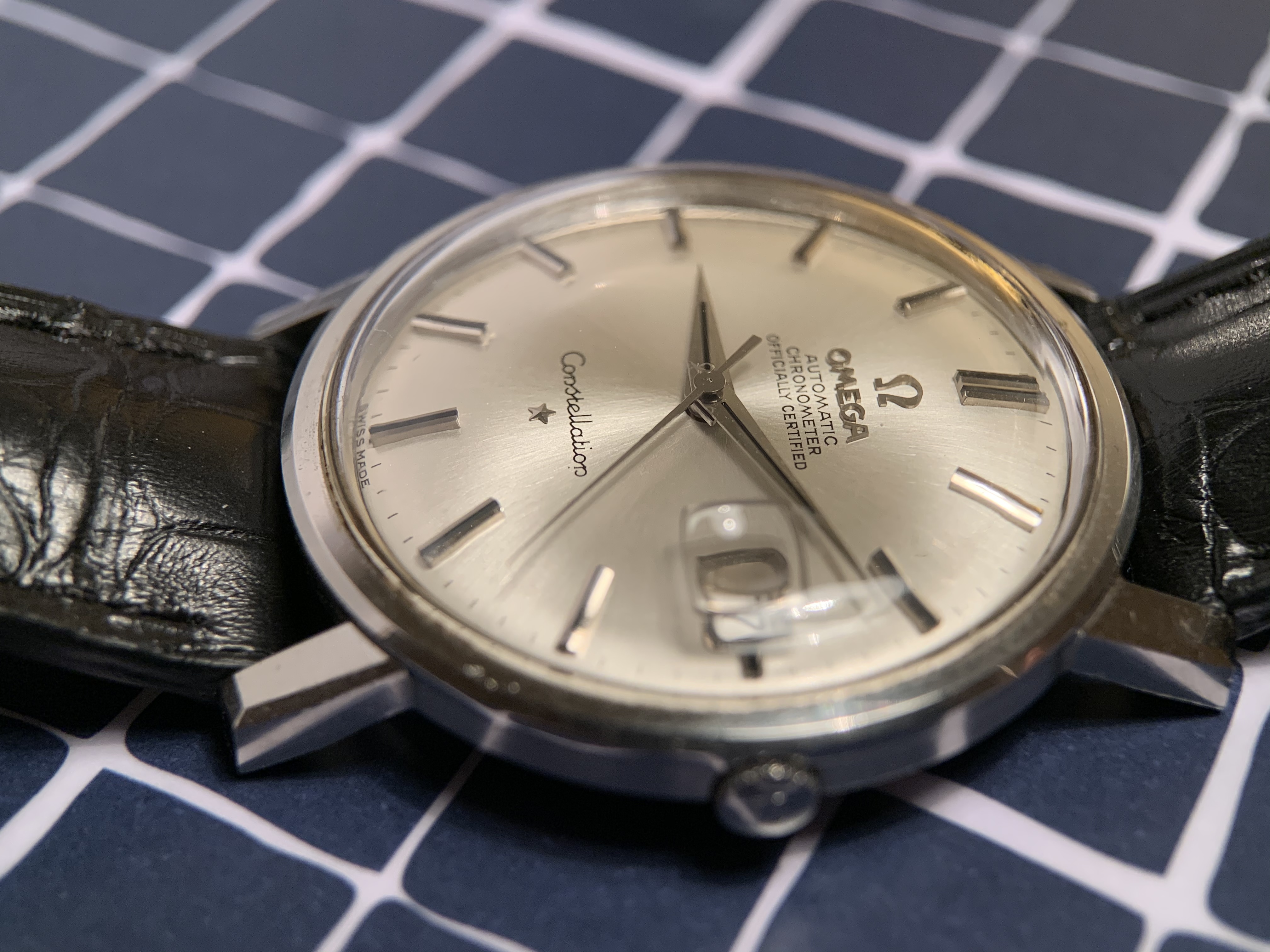

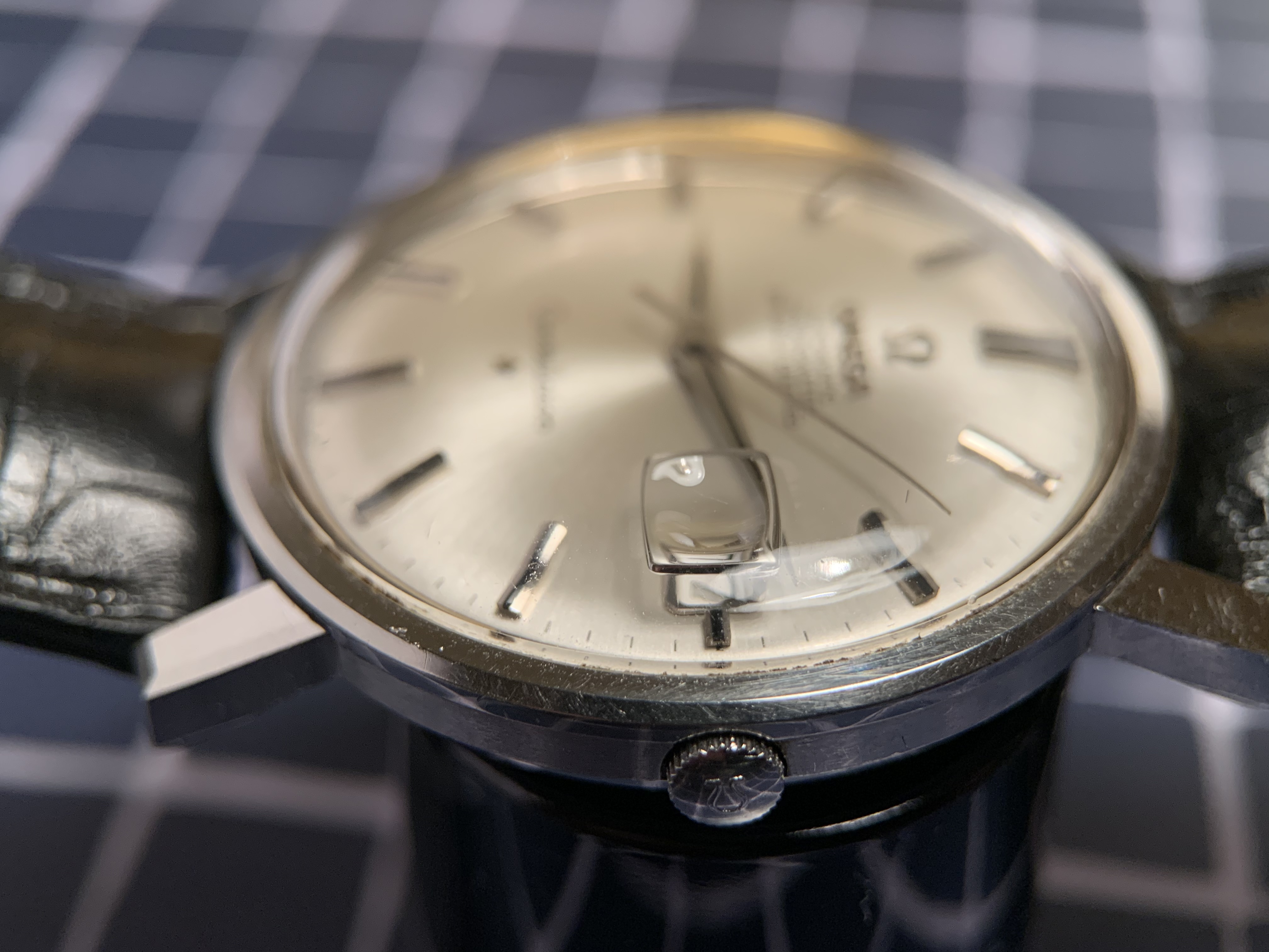

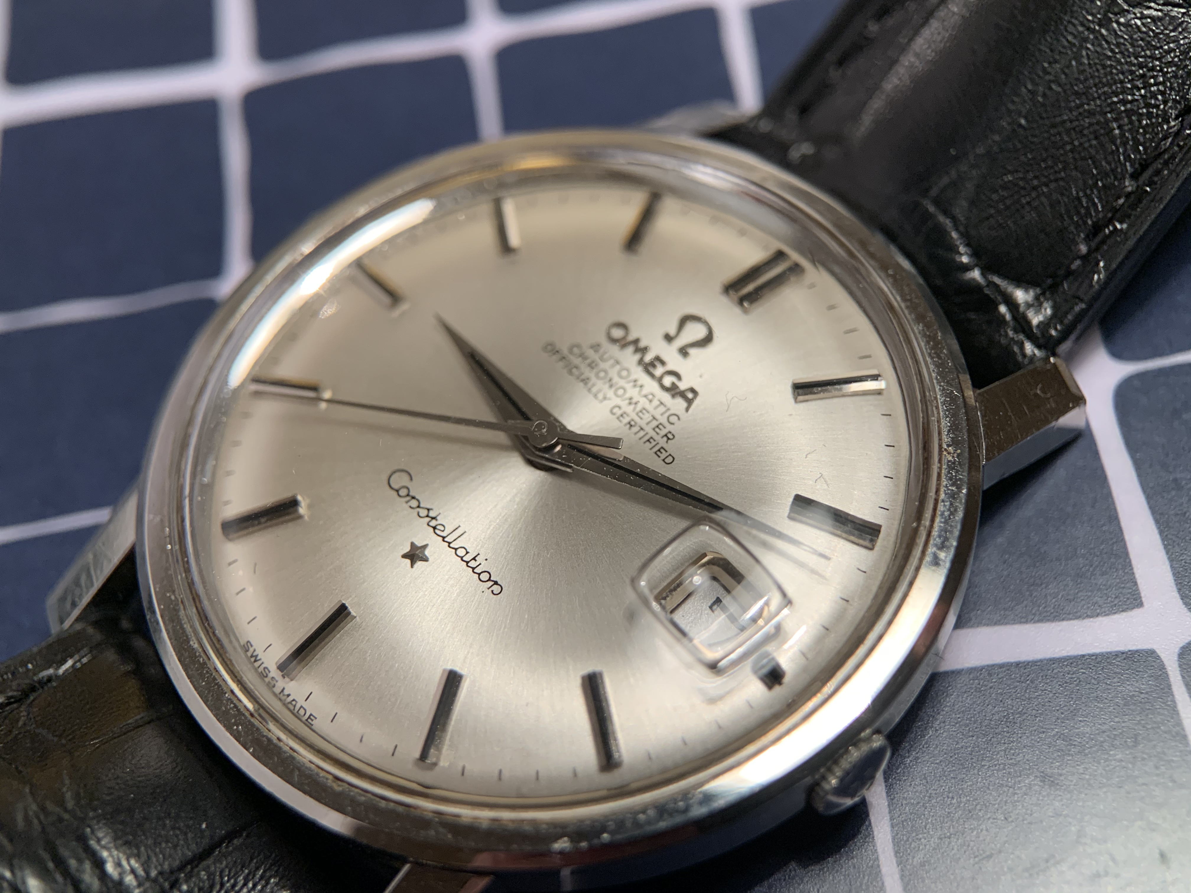

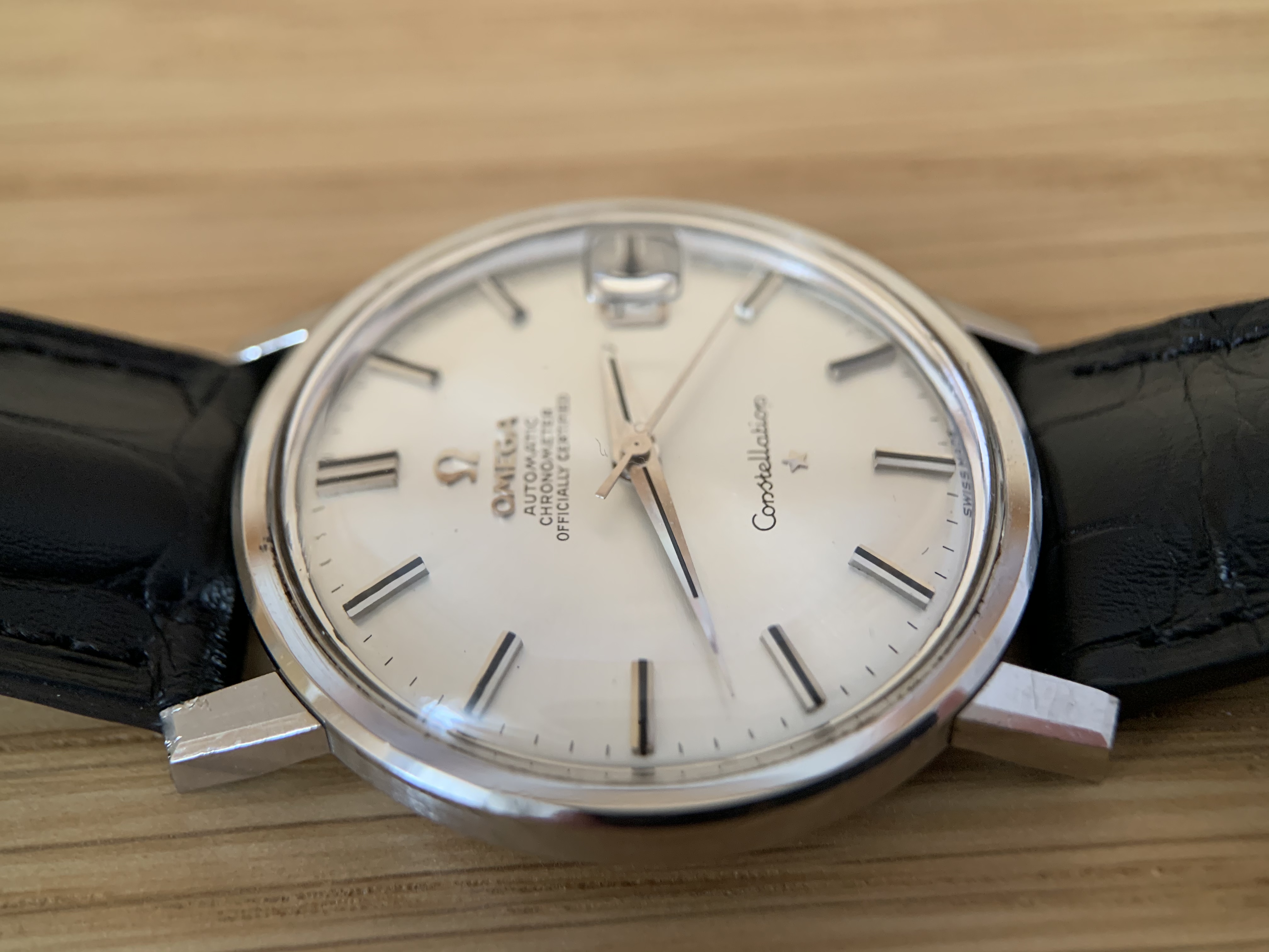

Hello,
I'm a newcomer to this fantastic forum, but I know I will be welcomed !
I will try to do a quick and modest review of my latest watch acquisition, I have been enjoying for a few weeks now : an Omega Constellation from 1966, which appears, in my non-expert opinion, in a very good shape for its age ! (and sorry in advance for my sometimes approximate english because it's not my native language...).
I must confess that I've always had a weakness for these vintage Omegas from the 50s and 60s, which are very sober and of top class (it often goes together ) : so, I decided to take the plunge for my first vintage watch, and here is the result on my wrist (tmèses photos were taken rather quickly with a simple phone : therefore, they're not necessarily very artistic, at least not as much as many other great pics available on this forum !).
I must admit I've hesitated a lot before taking my decision to purchase a vintage Constellation, because of the numerous fake watches presented as authentic ones, more or less successful (and often dishonest) redials, franken watches, etc. In short, it's difficult to get started without having some basic knowledges to rule out questionable models (and, sometimes, sellers)… : so, many thanks to this great forum, I took the time to familiarize myself with the main characteristics of the different models, then I looked for a selling opportunity in the sales section, in order to have the most serene mind possible regarding its authenticity (a wonderful transaction with Shabbaz !) : I'd like to thanks very much all the contributors to this truly remarkable site, thanks to which I learned a lot ; and no doubt I will continue to do so !

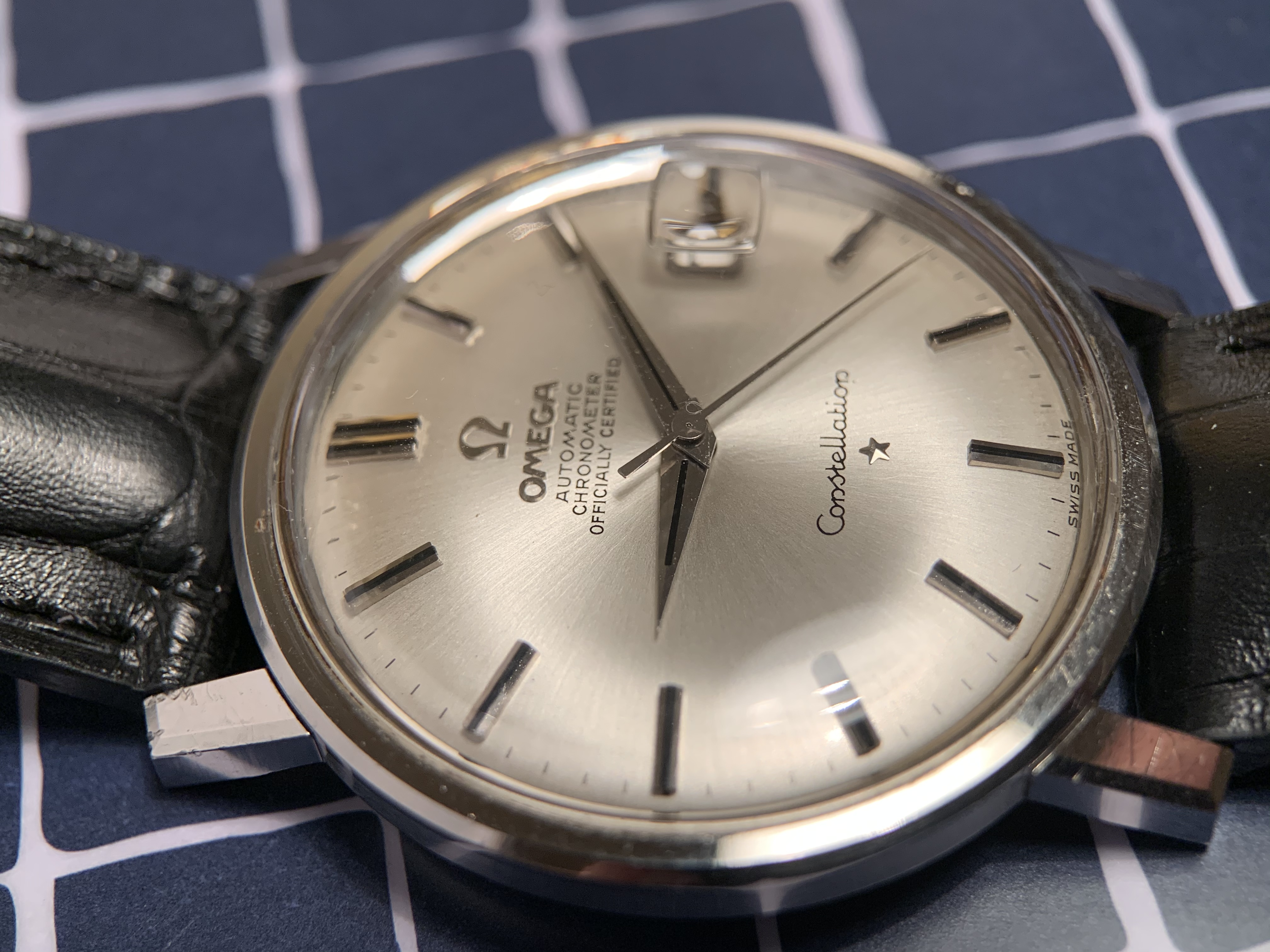

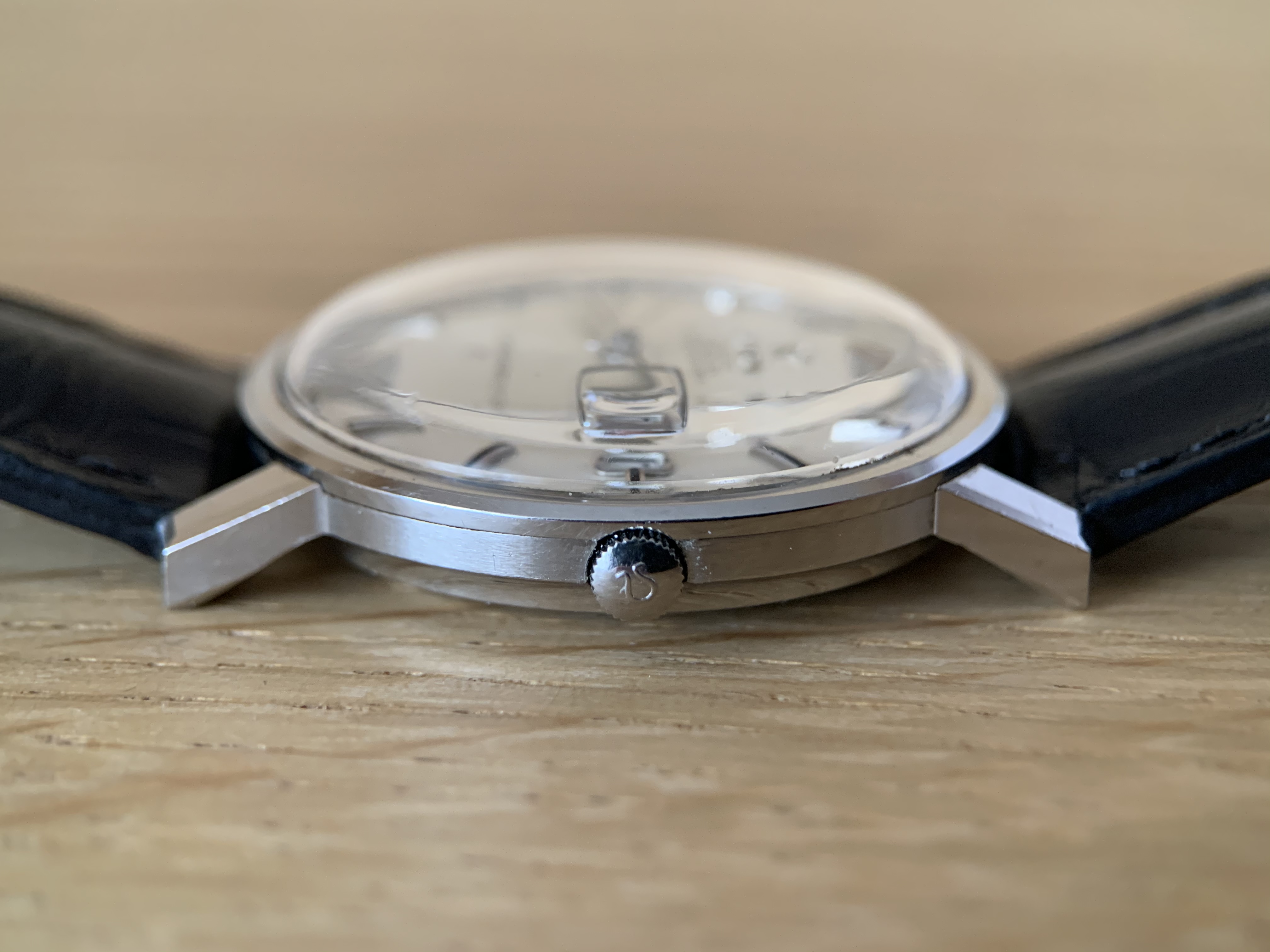

This Constellation (model 168.010 from 1966) has a diameter of 35 mm, which is actually very different from what we can see today on most modern watches. I like the idea of a subtle and discreet watch, which slips easily under the sleeve of a shirt, compared to certain current watches which sometimes tends to be a little too much ostentatious (but it is a very subjective opinion and many will probably disagree 😀). And with my rather thin wrists (16.5cm), it goes without problem for me ! In the end, it was not so much the size that surprised me but the lightness of the watch: it's actually very strange to hardly feel the watch that you have on your wrist, even if you get used to it very quickly !

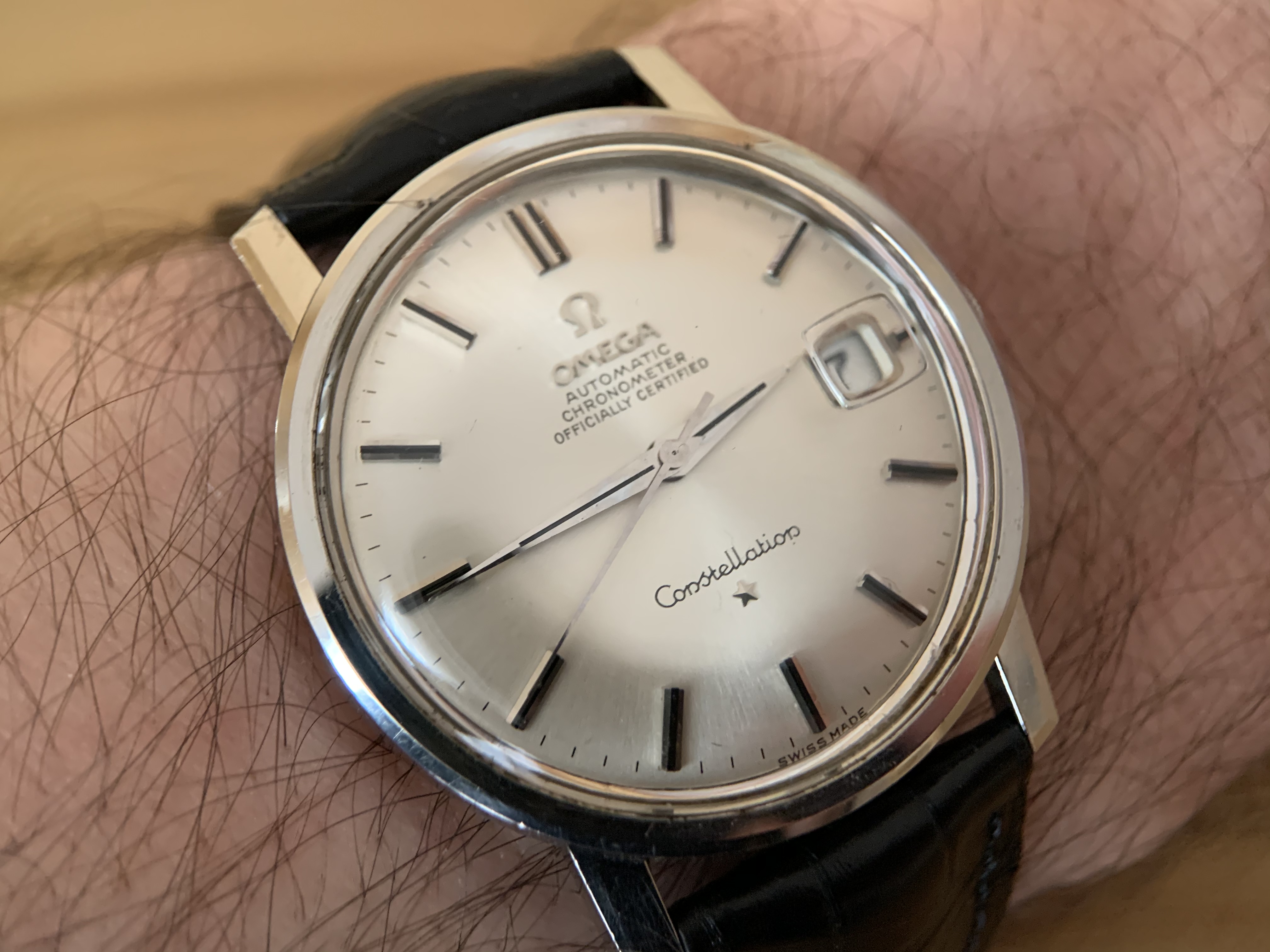

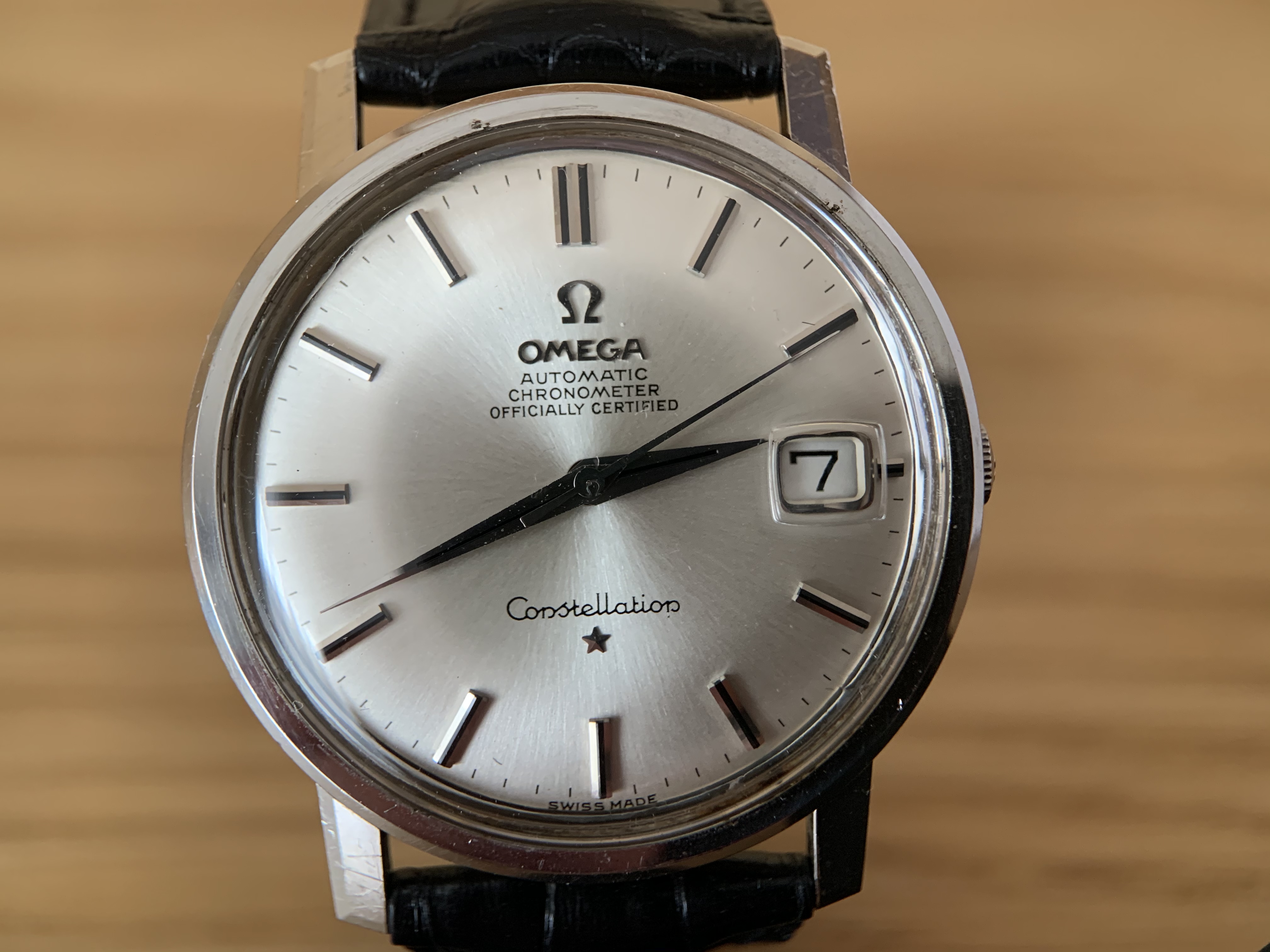

This Constellation has a magnificent silver sunburst dial, steel indexes with onyx inserts (although I never really got to see if they were really inserts or simply painting ; I understand that Omega made the transition between the two methods during the production period of this model), dauphine hands on the same model as the indexes, as well as a date at three o'clock. On the back, the traditional Genève observatory and these eight stars is proudly represented !
The whole watch is of great finesse, especially the inscriptions which are really of a subtlety that I had never seen before (all the more if you keep in mind that they are more than fifty years old). Obviously, the case (and in particular the lugs) has some scratches, but it's far preferable to a polished one : and they gave this watch an incredible charm !

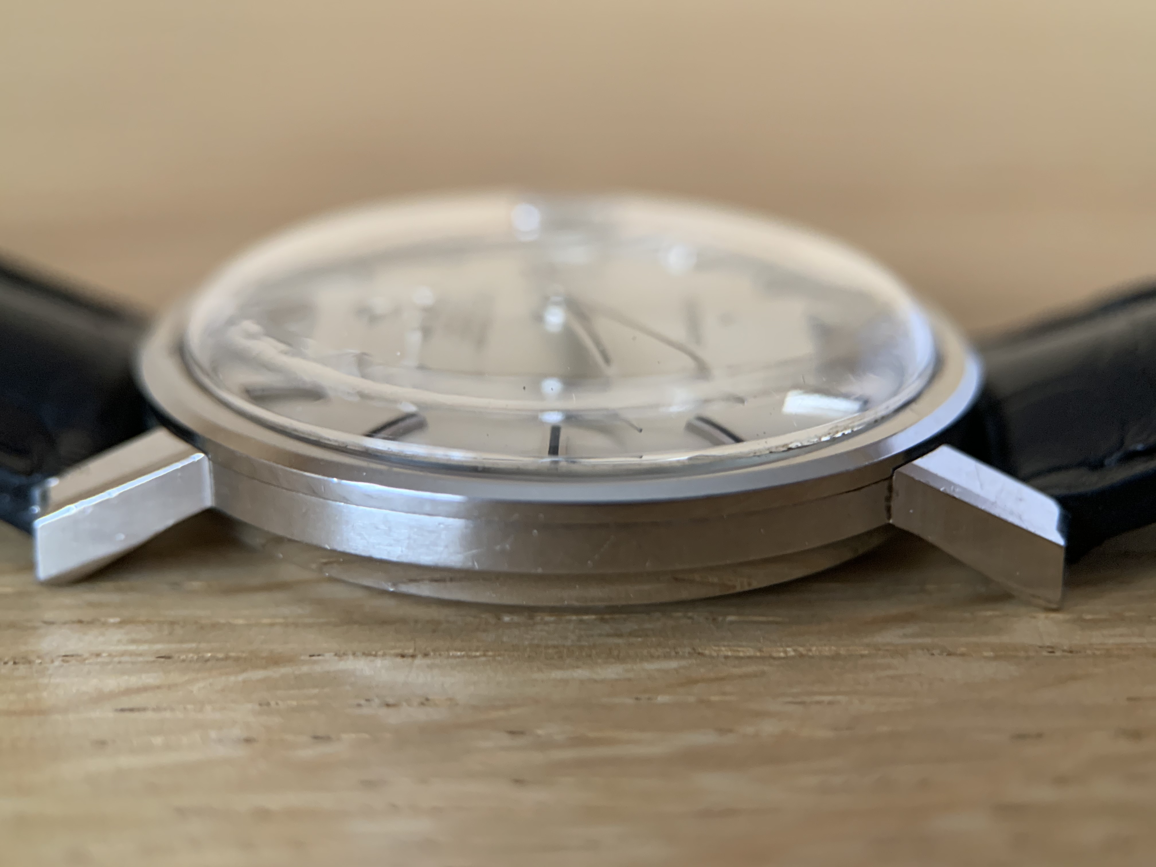

Note in particular the 3.5mm crown which is partially hidden into the case: if the objective is undoubtedly to keep the watch the most refined silhouette possible, I must admit that it's not really easy to handle ... (and I don't have particularly thick fingers !). Fortunately, it's an automatic watch and I escape a daily winding ...

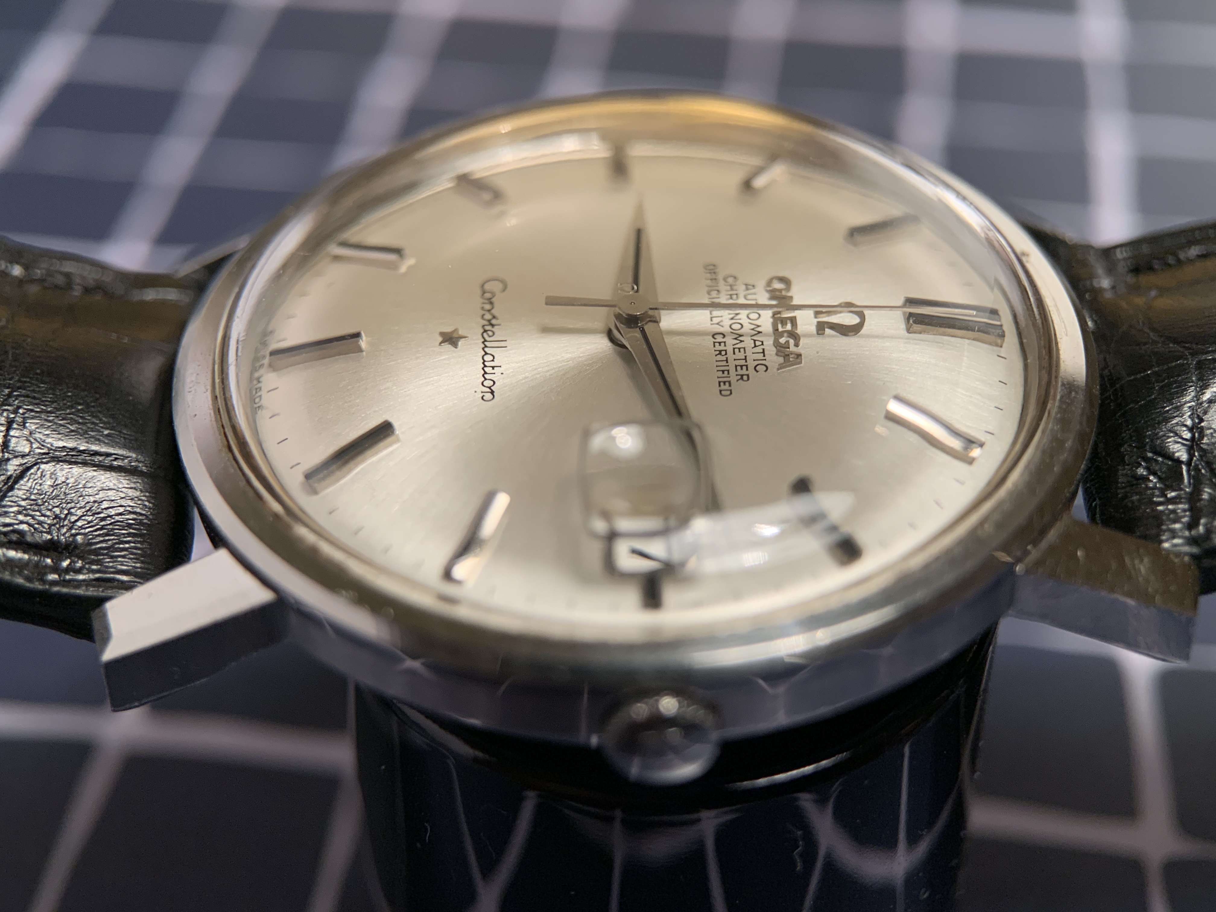

One of the (many) reasons why I fell in love for the Constellations of the 50s and 60s is the domed plexi crystal : the reflections are just extraordinary and I'm ready to give all the sapphire glasses of modern watches for the rendering of light through the plexiglass.
And, as a bonus, the presence of a dial lens, which I understand is not so common on Omega watches, provides a nice additional contrast ; and, of course, the Omega logo engraved in the center of the crystal !

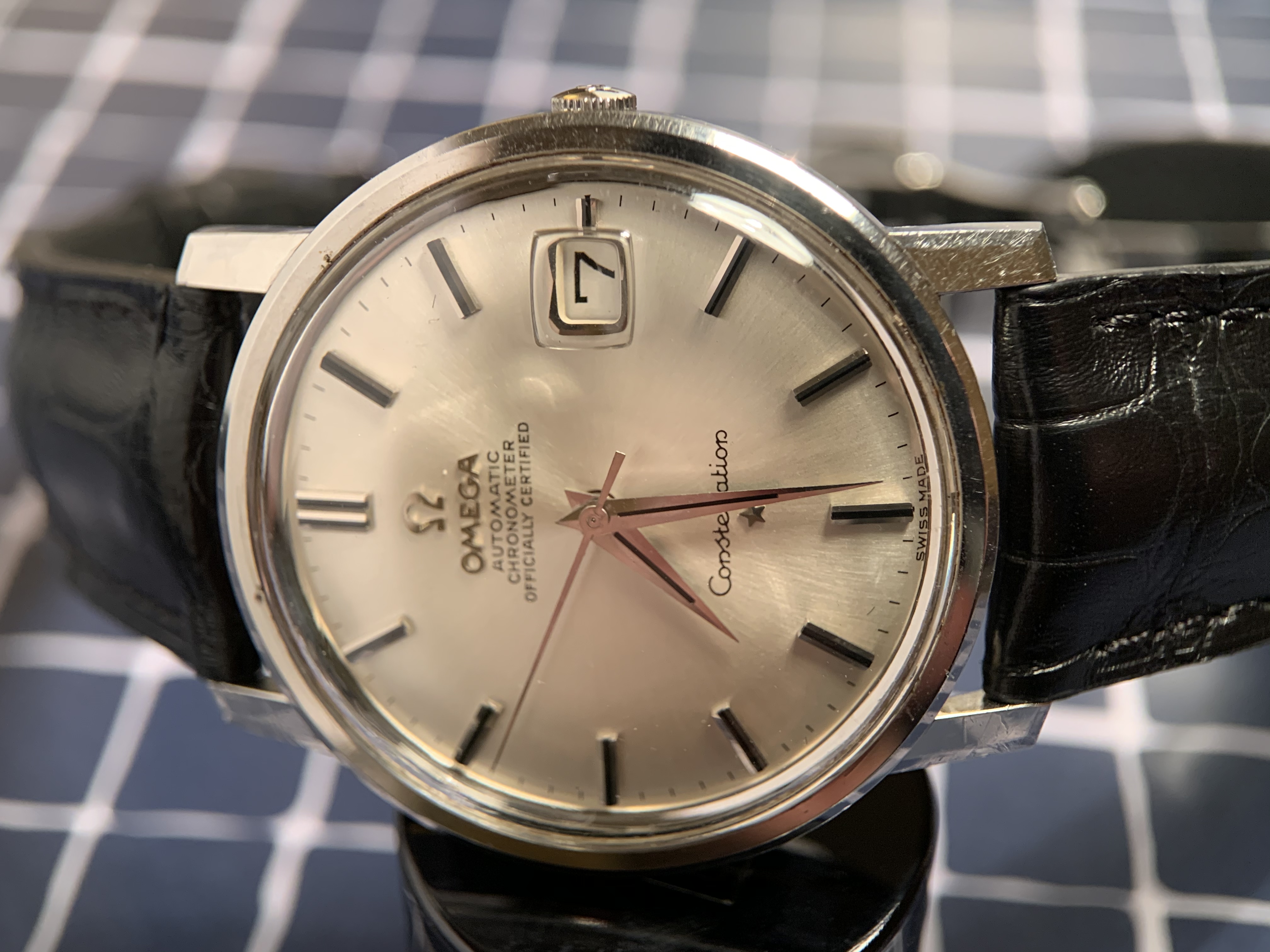

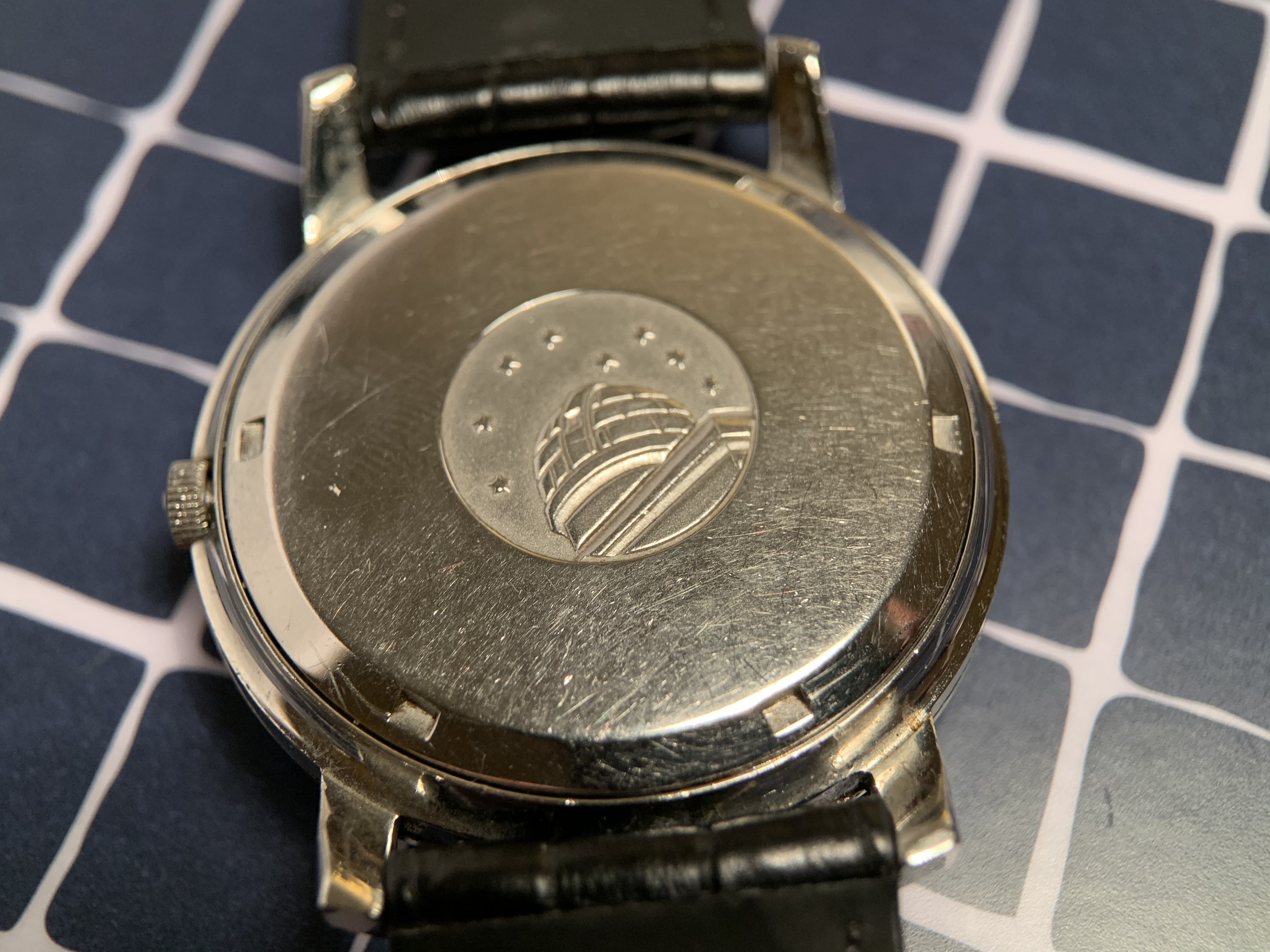

This Constellation is equipped with an Omega 564 caliber: it's an automatic movement with a 50 hours power reserve, which still seems to be present today despite all the years gone by. The accuracy comes out at around -20sec per day (fully wound), which is very acceptable for a watch of this age and which could undoubtedly be improved during a next servicing.
Note the quickset date system, that I discovered on this occasion. In short, the crown has three positions: the first to manually wind the movement, the second for setting the time (so far, nothing very unusual) and a third allowing to advance the date by one day. So, to get to the right day, you have to pull the crown from position 2 to 3 then return to position 2, and start again as many times as necessary. To be completely honest, this device gives me cold sweats : the somewhat "brutal" day jump when you get to the third position, the tiny crown (it seems rather fragile for my fingers which are used to modern crowns), the whole mechanism over 50 years old ... So I'm very happy not to have to use it very often ...
And finally, I thought that a watch of this class deserved a strap as classic and sober as possible : a simple alligator strap in black leather, which corresponds to what fitted these watches at the time in the 60s. The only concession to modernity, a folding clasp rather than the traditional pin buckle ...
And voilà ! I could not be happier with this little treasure every day on my wrist and I see no reason why it should not continue !

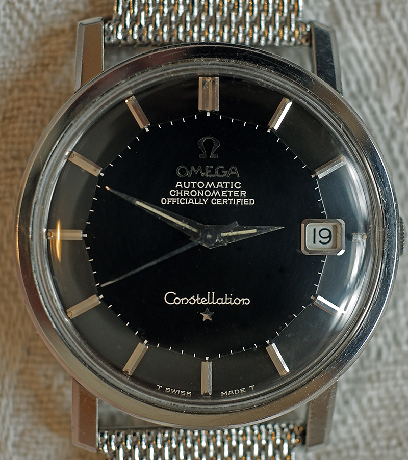

Mine says hi !
Movement number dates to 1962 but the dial was changed mid or late 60s.

Lovely write -up, the evident pleasure in owning your Constellation shines through.
-and it’s obvious why because it is a lovely watch you have there (not sure how @Shabbaz could bear to part with this one)
Great dial and sharp facets on the lugs.
Pie-pans usually get all the praise but in my book, the subtle sophistication of a dome dial Constellation is hard to beat.
-and the hidden-crown case further exemplifies the simplicity.

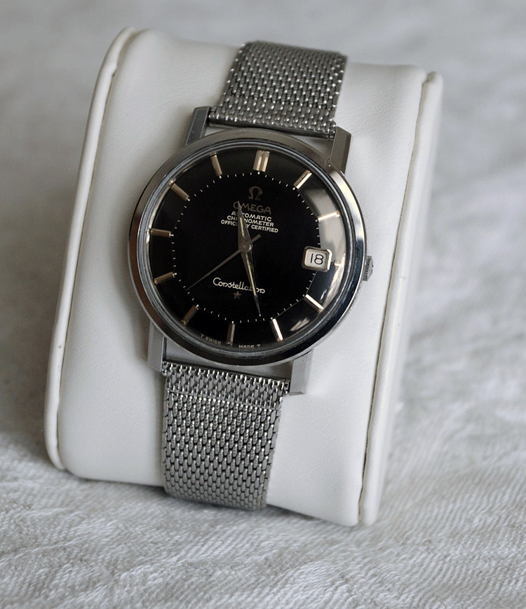

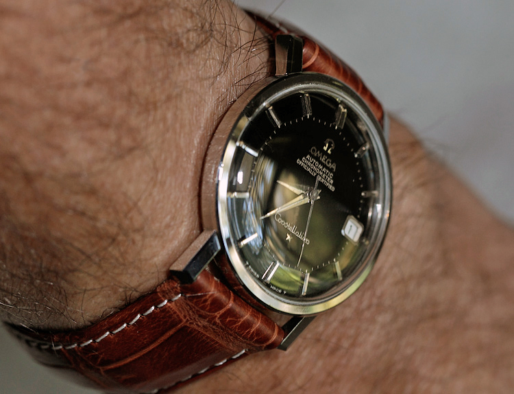

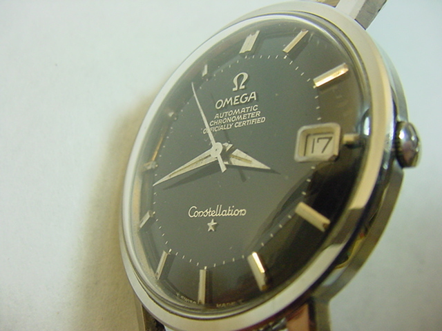

Well. I've sold it because of the black dial 168.010 which I bought recently. And I did not wear the watch anymore. So I love to see it go to a (very nice) member. Watches are meant to be worn. This one was lying in a box.

Thanks you all for your kind answers and your encouragements ! (I don't know if I deserve this much)
Could I dare to take this opportunity to ask several questions (without link between them) to which the specialists you are will surely have answers ?
1 / I noticed that, on all the 168.010 models with dauphine hands I've seen (but maybe there are other cases too?), the minutes and the seconds hands did not reach exactly the minutes indexes (the hands are too short about around 1mm-1.5mm), while I had the impression that it was rather the rule for Constellations : do you know where this specificity comes from (did Omega use hands initially designed for smaller cases)?
2 / During a serciving, I understood that it was very difficult to change only the crown gasket and that it was very tempting to completely change the crown itself (which I obviously don't want to do !). So, is there a major problem with having an unsealed crown? (for normal use I mean: I do not intend to dive with it, but can there be moisture infiltration that can cause damage inside?)
3 / I've always imagined that it was impossible to overwind an automatic watch (but maybe I am wrong?). On this model, I can almost feel a blockage of the crown once fully wound, or at least a very very strong resistance which really doesn't make me want to go further...,which is very different from the other automatic watches that I have in my hands. Is this something common on this type of caliber?
Many thanks in advance for your precious answers !

1.this is also the case with its cousin the 168.004
‘Pencil’ hands on the 168.010 are also slightly short of the minute hache marks.
It may be that standard dauphine hands were used and the dials were slightly larger.
As the usual sources no longer have hands to cross check this, it would need someone with an Omega parts account to cross reference hands, say, from a 168.005 dome dial.
Perhaps @Archer might kindly oblige if he has time?
2. crown gaskets were not intended to be replaced in Connie crowns.
An old gasket in a crown will always present a potential risk to moisture ingress.
There is a replacement crown (two actually) for the 168.010 but it is not hidden and protrudes slightly but doesn’t look too bad.
We all value originality, so be careful when around water (washing hands etc, not swimming) and if you live in a particularly humid area consider replacing the crown.
3.it is impossible to overwind a Connie movt. (Or any automatic I believe)
Given the particular difficulty in using a hidden crown, I’m impressed that you have actually wound the watch fully.
Winding the watch will no doubt show some progressive resistance but there shouldn’t be a ‘blockage’ - it may be a factor of the difficulty in using the hidden crown.
@Archer has suggested using a special winding tool for crowns that are difficult to use.
The 564 is used in a number of other Connies and is no different in winding to the earlier 561.
just remember to set the hands to 6.30 before using the quickset date in order to ‘protect’ the quickset mechanism.
hope that helps.
(P.s. you might have got more responses if these questions were posted in the vintage Omega forum. )

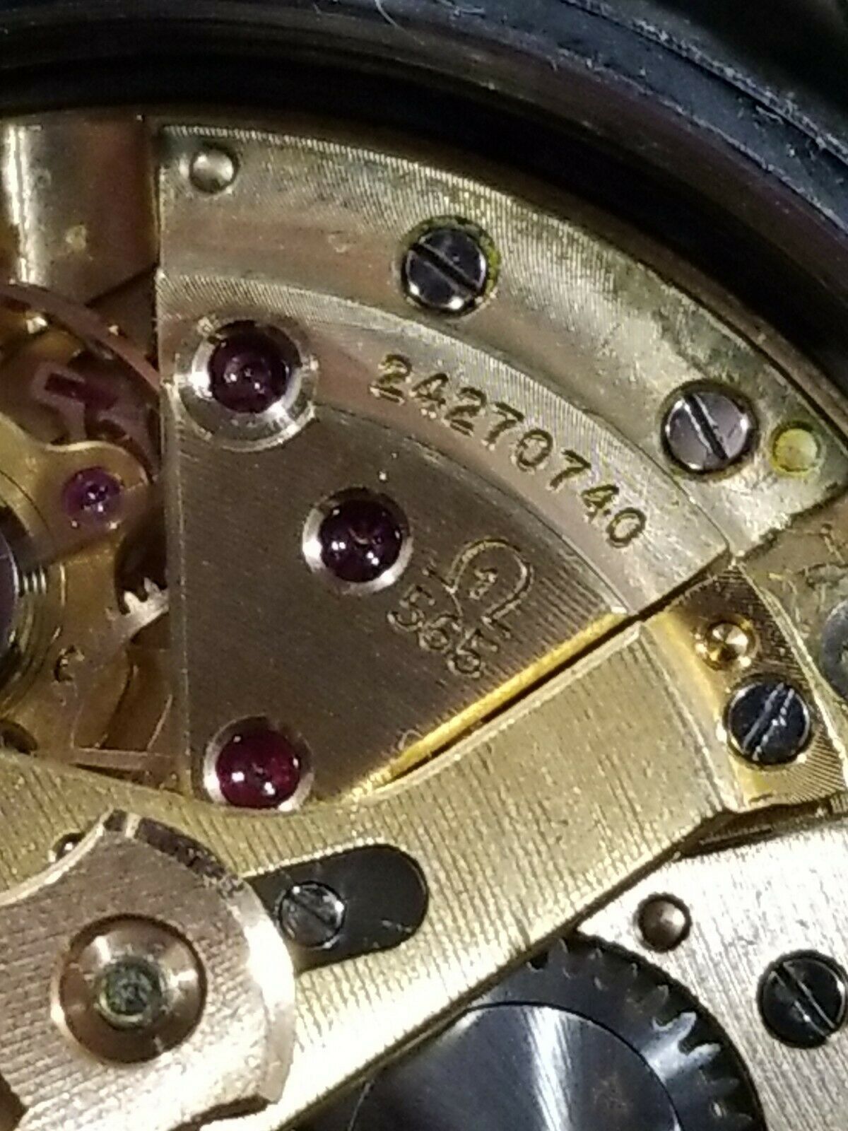

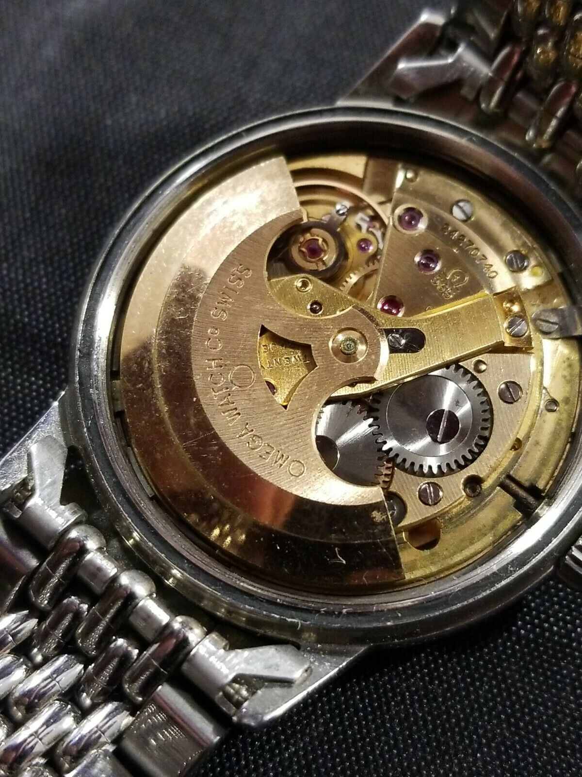

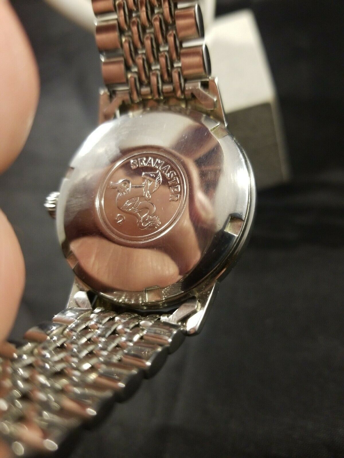

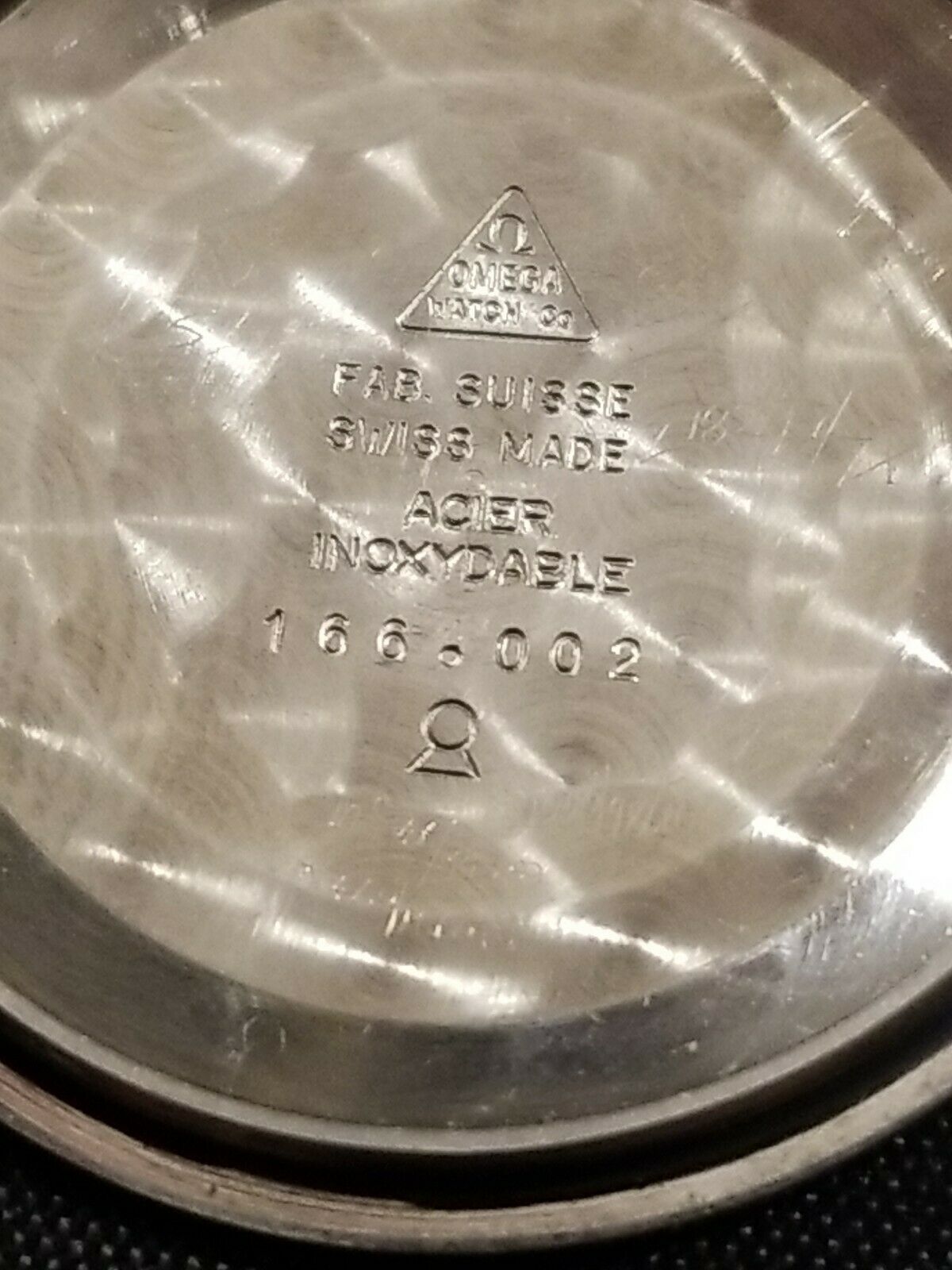

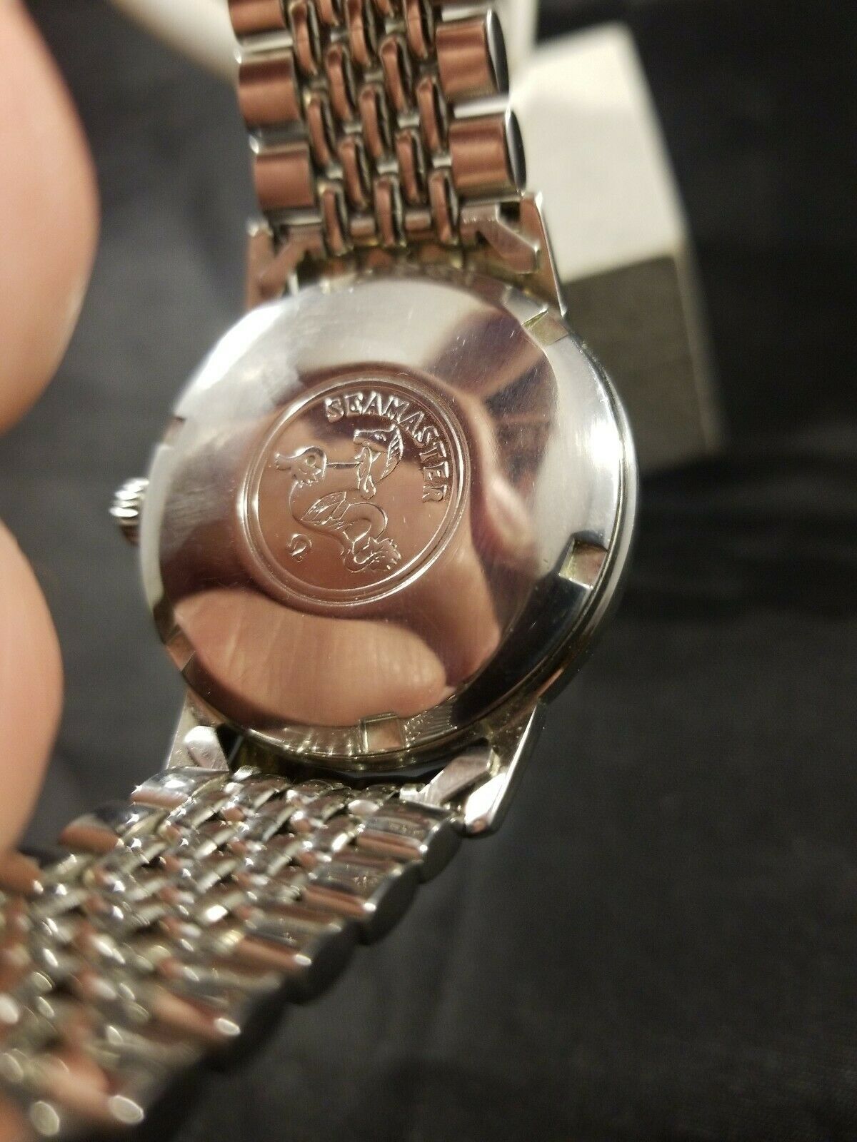

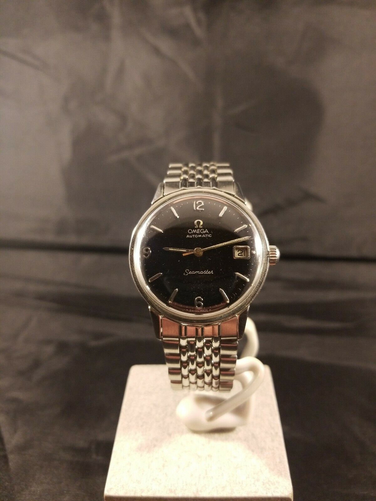

I am looking at this piece, can someone please help me if this is real or fake 565 Seamaster?
4,519
11,129
Can't tell. Strange lighting. Is it stainless? Best way to check is ebay sold listings for "Seamaster 166.002". Try google, too and look at other examples. Don't get excited about what people are asking. Focus on sold prices.
btw, we have a Private Sellers section on this site with known sellers so it it much more safe.
Appreciate much you input, Thanks! Strange but i can't find something like this on Google, i found this in Ebay and is described as rare vintage 1966.
4,519
11,129
I would divide by 2 and start from there. Beads of rice bracelet if correct and plenty long, $100 to $150 (ebay price). Seamaster head. Reasonable case. Redial. Mismatched parts on a Cal 565. Assume it runs well. $200 to $300 (ebay price). So 300 to $450. Knowing that it will have a limited audience due to condition if you try to resale. There are some assumptions made here. Pictures aren't the best and the bracelet could be a complete farse. Not sure about the end links.
I would look for a nicer example. Not sure why you are so focused on this one. There are much better Seamasters at this price.
