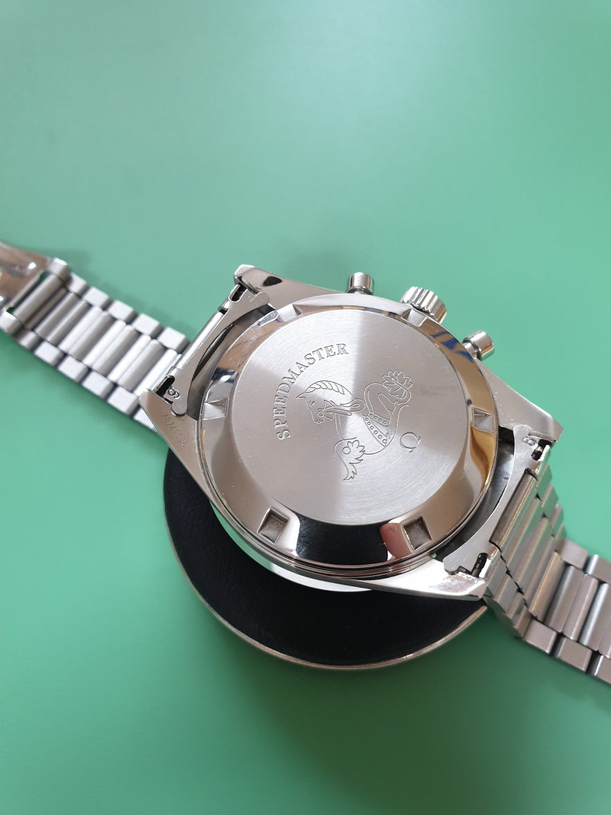

Yep exhibition case backs need a different spacer to account for removal of the dust cover.

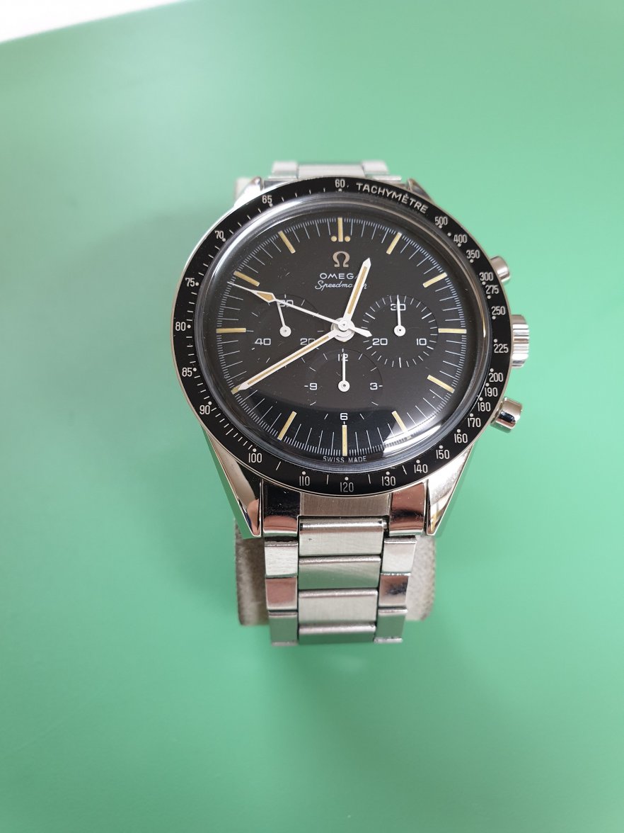

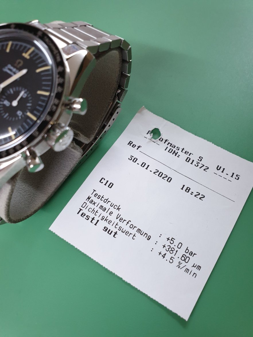

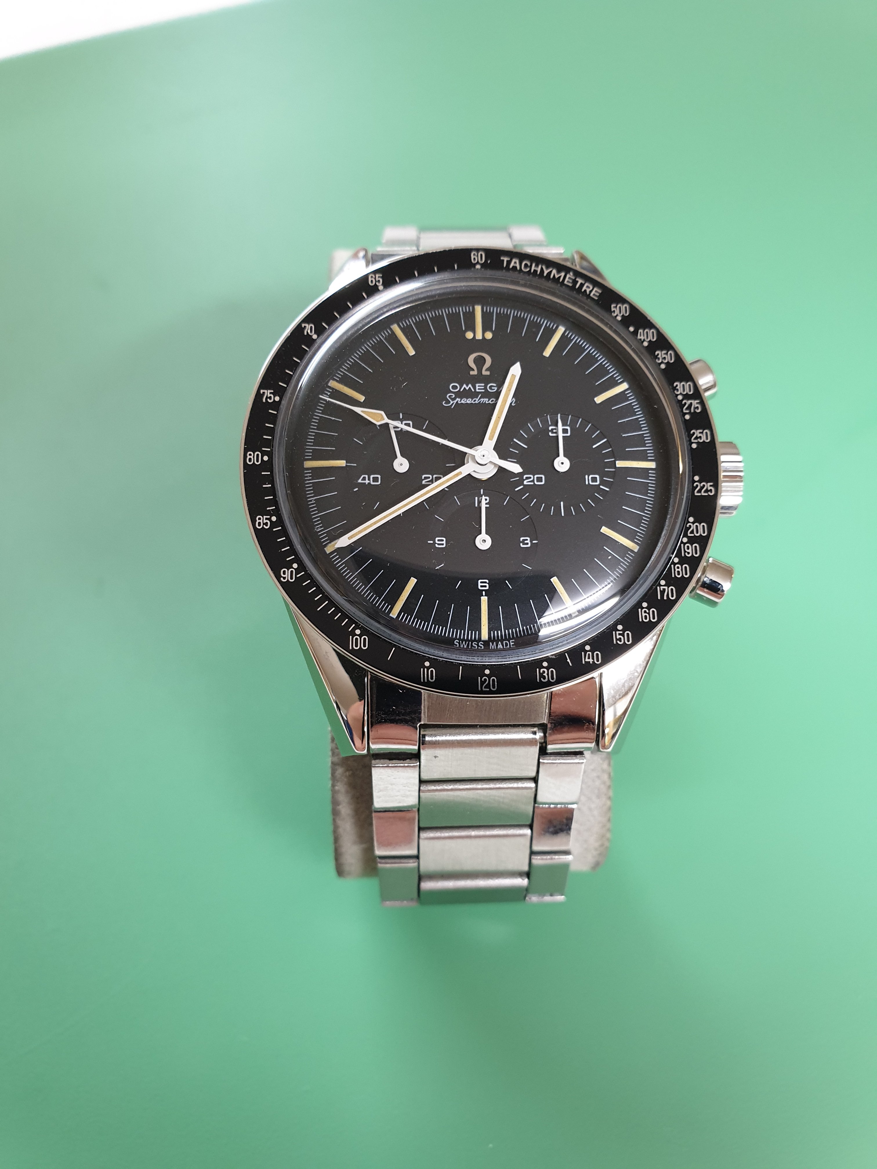

Hi timetostart,
this is my first answer to a post.
My aim is to help, and, if possible, to support you.
An original Omega Speedy hesalite will fit without any problems to the FOIS.
You just remove the original sapphire crystal and fix the hesalite (and you have to use the sapphire seal - and you will not see a milky ring beneath or under the hesalite after swaping).My FOIS is also water resistant up to 5 bars.
I did a lot of work/ changes to the watch. All parts of the most " older"
Speedmaster models are interchangeable. Casebacks, dials, hands, crowns, crystals etc...
I stay in contact to an AD/ Omega Boutique with level 3 service and the watch maker there is a wizard. He did all the works I pleased him to do. No questions, no doubts....a very helpful and kind man.
Hope all this will help you.

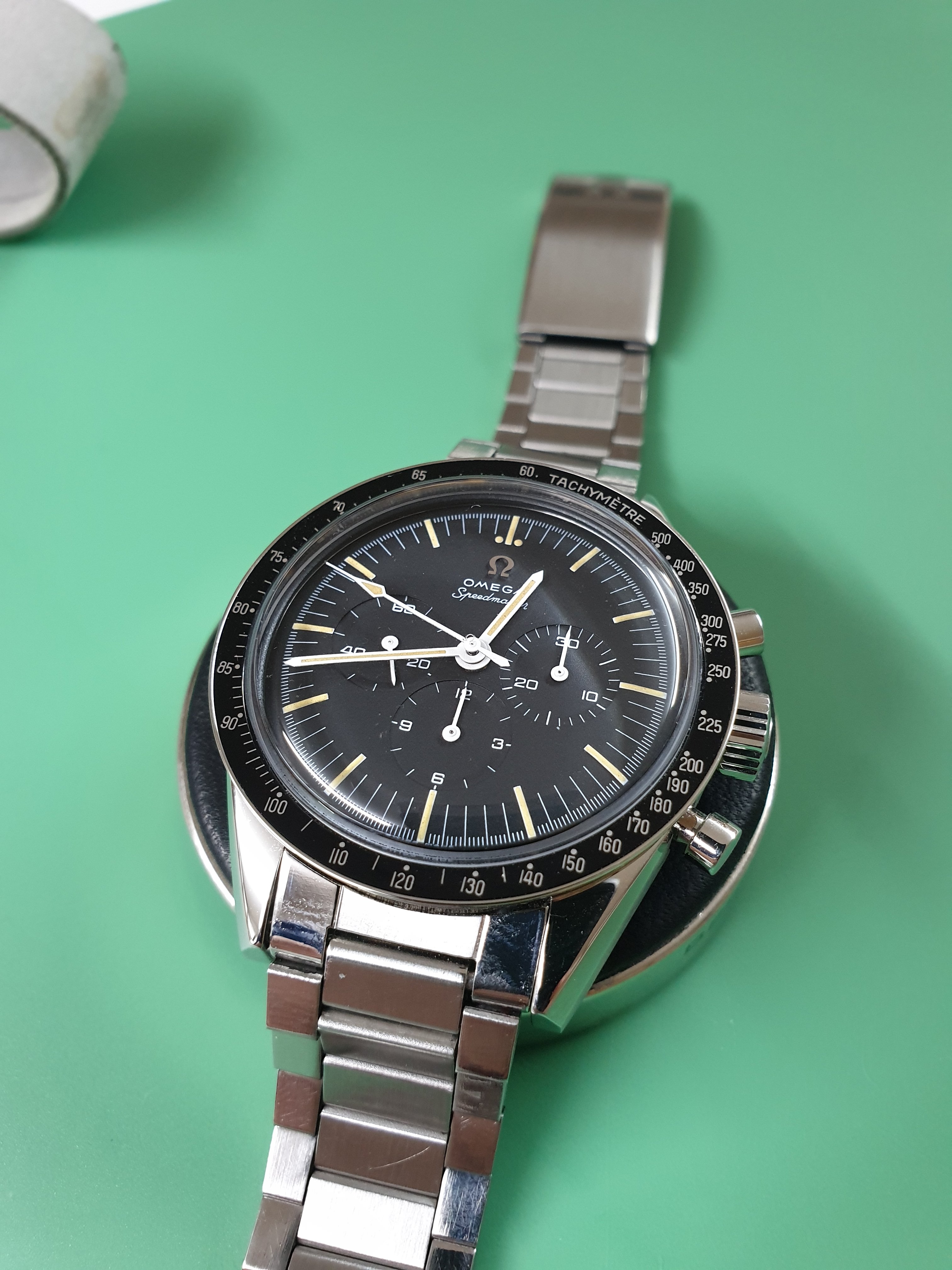

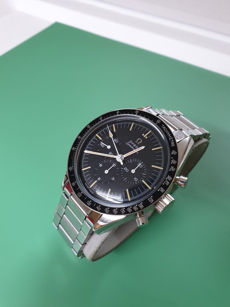

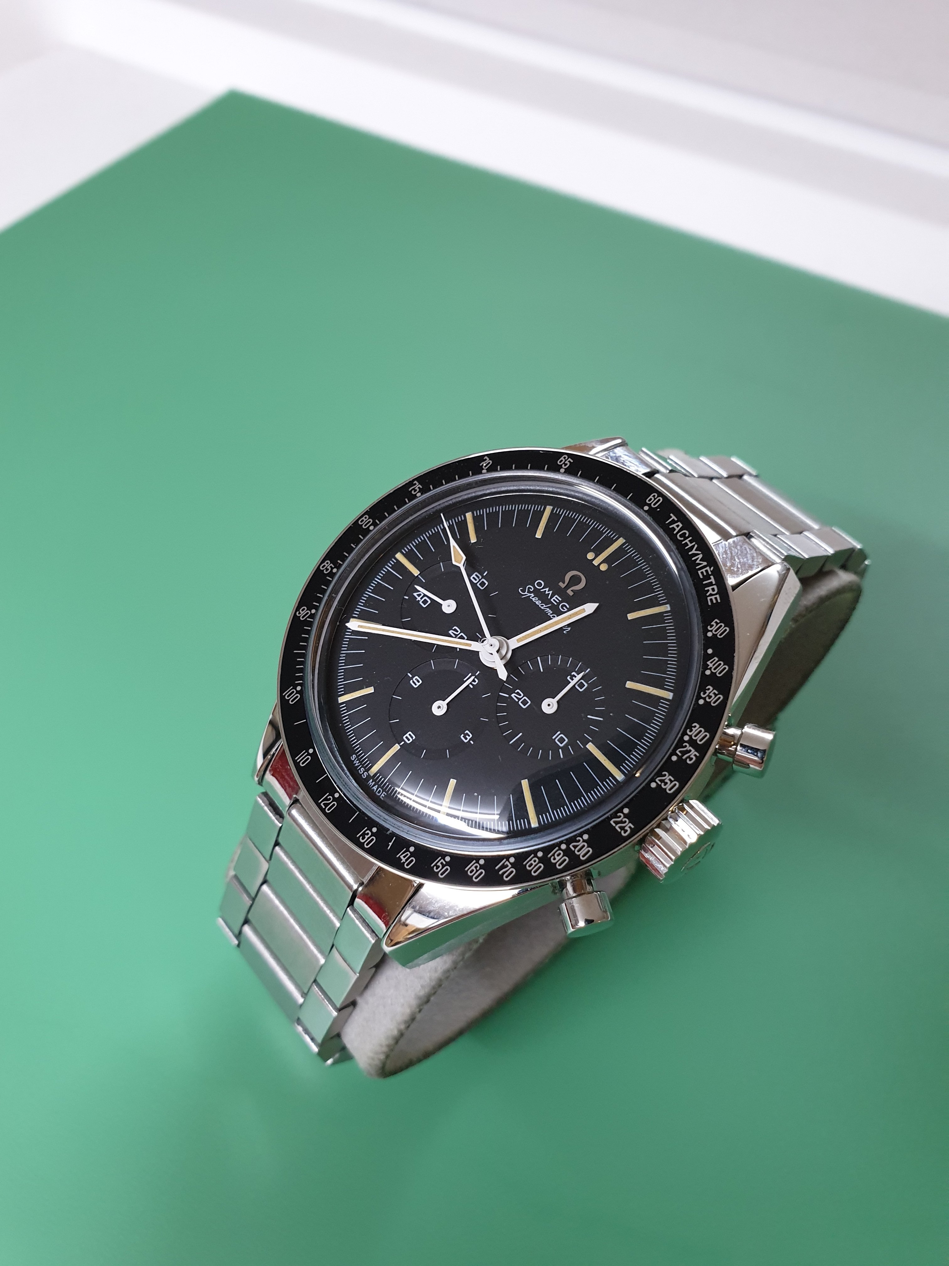

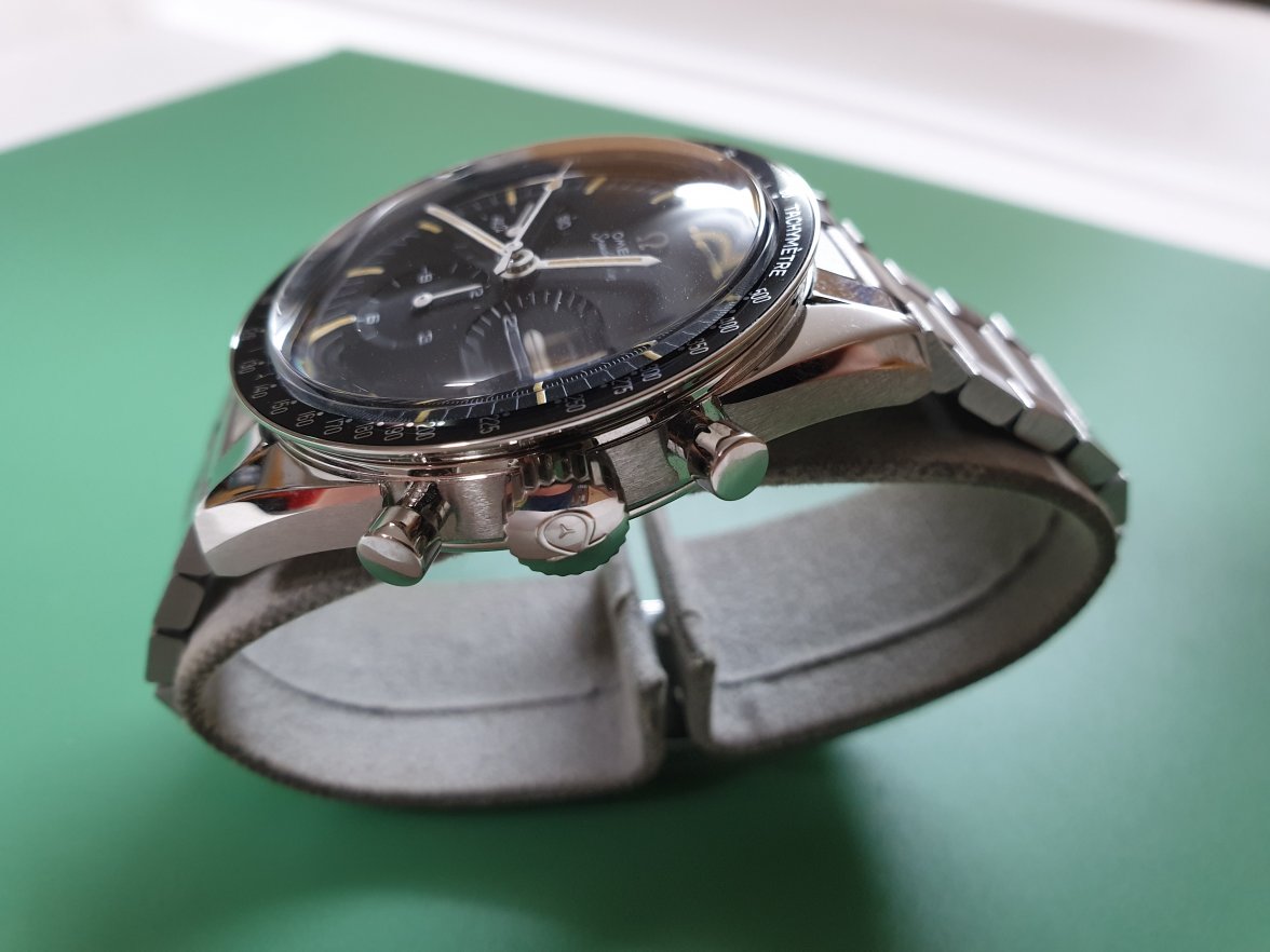

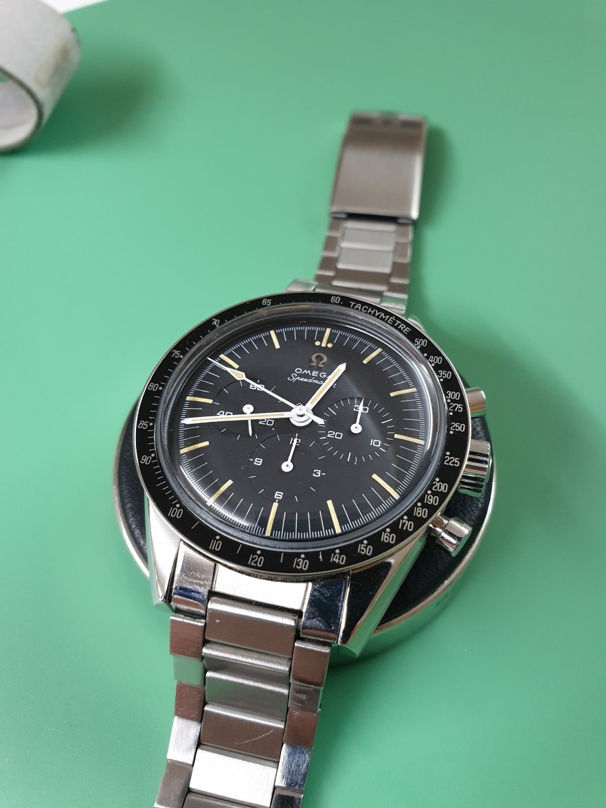

Thank you HAL9000 for the inspiration to pursue a crystal swap on my FOIS! Your pressure testing results proved to me that this hesalite exchange must be possible. It's now my favorite Omega.
