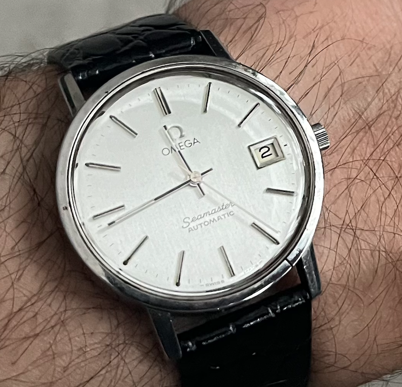

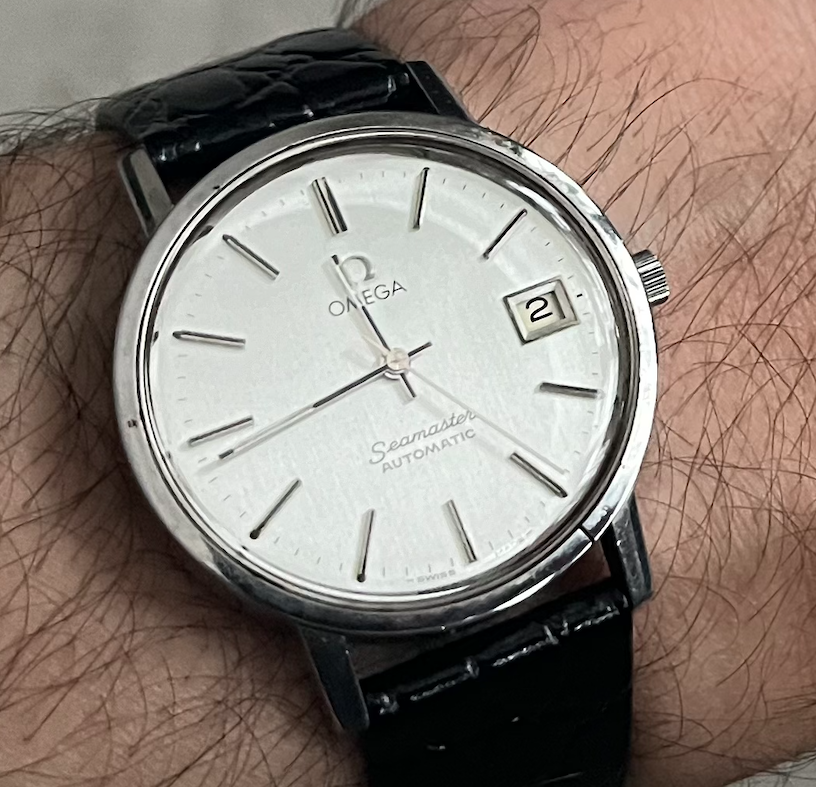

I discovered a hairline crack in the bezel of my Seamaster. The watch runs beautifully and the bezel doesn't feel at all loose. Is it something to worry about?..if I can/should change it where can I get one? Omega will charge me the price of a service/bezel that will be more than the watch is worth.

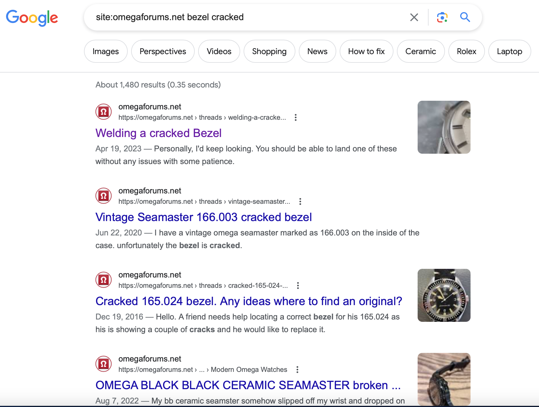

Generally, replacement bezels for these watches aren't easy to find unless Omega still supplies them. Try a search like this for other people in the same spot.

thanks....I just spoke to a watch repairer and he said that the bezel is not holding the glass in...which was my biggest worry. Its a finishing bezel for aesthetics but is still firmly lodged. Ideally he said I need to find one used.. or as you mention, get it repaired.
