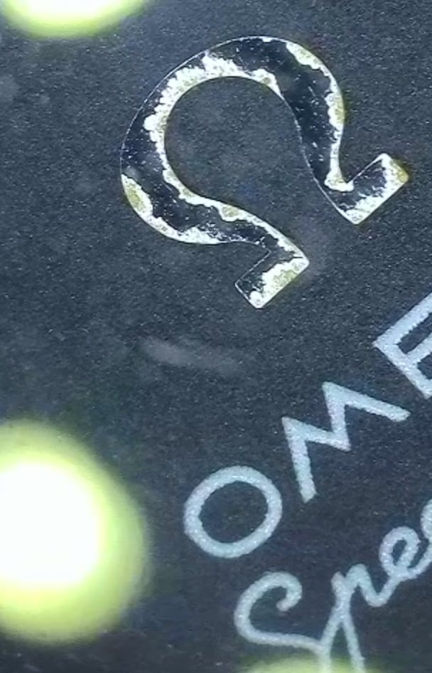

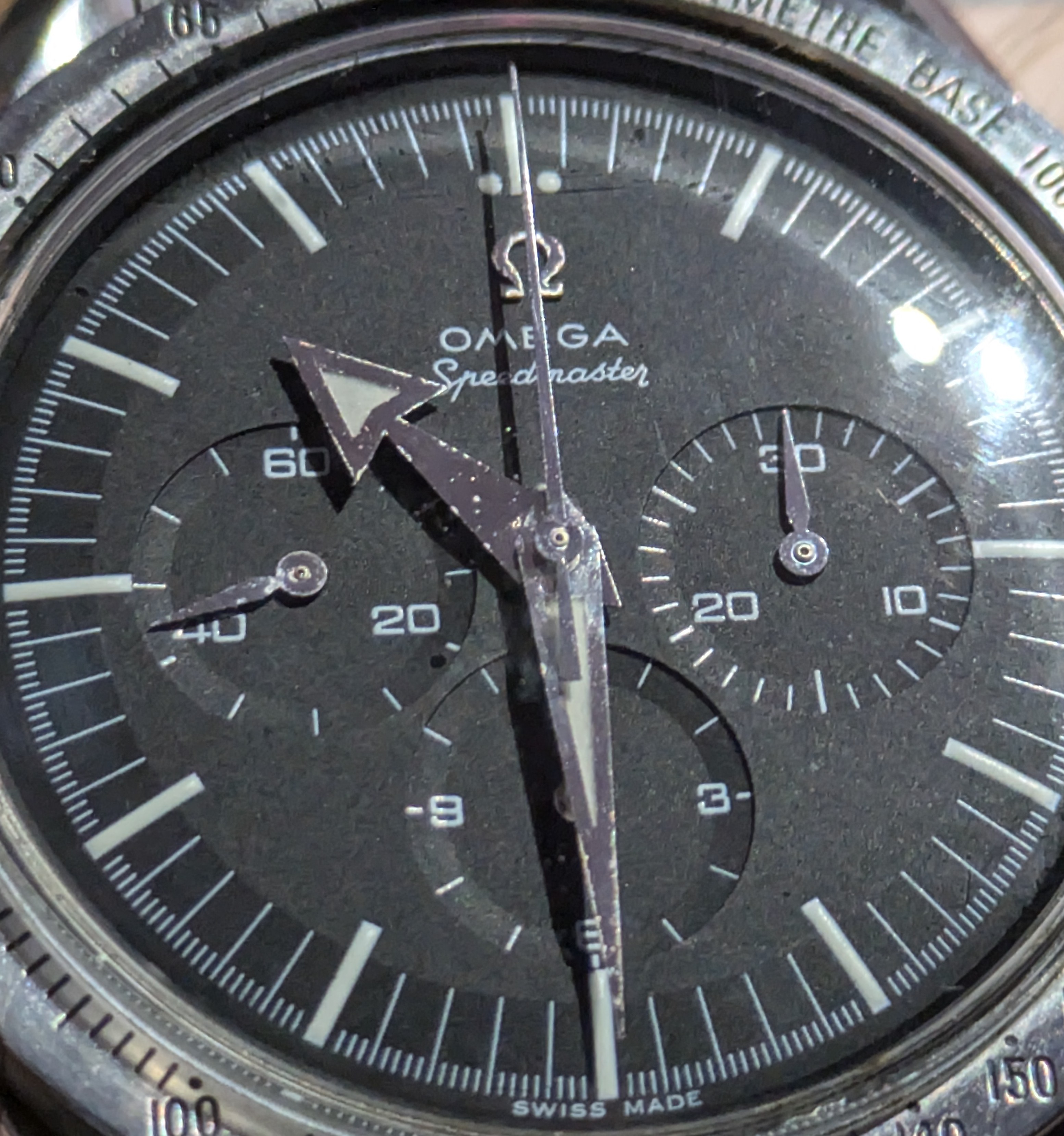

I bought a full set 1997 broad arrow 40th anniversary - the watch was serviced only a year or two ago and is mechanically running great within a second a day and the movement is clean, but the entire handset and applied logo looks really rough and oxidized/corroded.
I think the watch was serviced but it was requested to leave the "patina" alone on it in order to keep it original.
Does anyone have any idea of how much Omega would charge just to replace all 6 hands and replace the dial but not service the whole watch - perhaps replace the hesalite too. All I can find anywhere are full service prices or resellers trying to sell 3594.50 broad arrow dials for close to £1000.
My other option would be just leave it as is then maybe get a full service done about 5 years from now and sort it all at the same time then.
In the UK by the way. Many thanks

Well I had it done and got only the dial/hands replaced... and the new minute hand that was put on by Omega has some big dark streak down the middle of it.
Took 5 weeks to replace the dial/hands.
No idea if the way it looks now is considered to be "within tolerance" cosmetically or if I should be contacting them about replacing the hand again with a better looking one.
