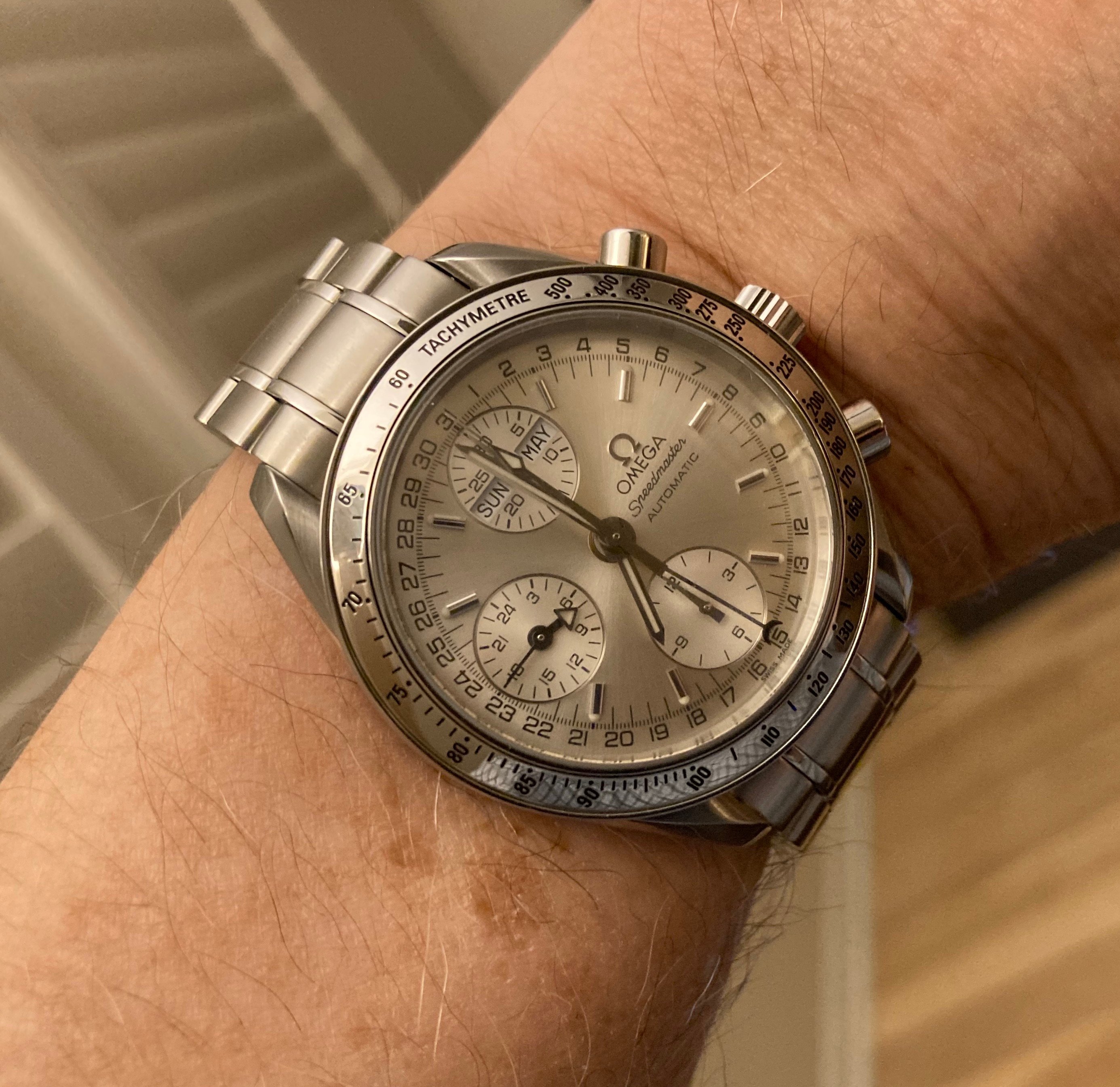

I recently picked up a 1999 Speedy Triple Date, absolutely love the watch, it's in pristine cosmetic condition, literally looks brand new, all functions and pushers operating normally. But, it's running roughly -15spd based on informal daily monitoring, and the WIS in me isn't liking that (even though I think -15 is just barely within original spec limits for the Omega 1151 if I read that correctly).
I've read enough warnings to not want to try and open the watch myself to regulate the timing--though I've done so before on inexpensive watches like a Seiko 5. So my question: how much would a watchmaker, Omega tech or otherwise, charge for doing the regulation? I really don't want to spring for a full overhaul charge with an Omega certified tech, though I will if necessary. Advice?

It is a 20+ year old watch. If its never been serviced, its long past due and it would be money well spent. As far as what someone is charging to regulate, cant help much there.

Would you buy a used car that was pristine on the outside if you had no idea how the engine had been previously cared for, there were no service records, and it was running roughly - and you decided to just have the timing sequence adjusted without looking at anything else? Get it serviced.

I would be a bit surprised if any reputable watchmaker, Omega certified or not, would be willing to do piecemeal work on a 20+ year-old unserviced watch, especially for a stranger walking in off the street. In all likelihood, they make some adjustments, and then the timekeeping continues to degrade because the watch needs a service, and then you come back and complain.

Even if you need parts, every Watchmaker can service that Valjoux based movement. Might be around $600.

It's not a "stock" 7750. There are differences that in some cases, will require specific Omega parts to replace worn parts - the biggest one is the rotor bearing...completely different set-up to the standard 7750, and a common wear part.

FYI--Omega has apparently upped their prices on servicing as well. Omega site lists standard service on chronograph movements at $900. I got an estimate from a well-known independent in Seattle and their quote was the same--$900. Seems high given I was charged $750 from an RSC on two different Rolex models (which I paid). Thing is, those were $8K watches. $900 on a $2200 watch is a tough pill to swallow...

The amount of effort and time required to service/administrate would not differ much between your Rolexes and an Omega.
Basing service costs on the value of the watch doesn't meet the pub test.

Assuming you contacted Nesbit's in Seattle their pricing will be the same as Omega's in my experience. The big advantage with them is they will be sympathetic to your requests for any case refinishing, saving dial and hands, etc.

Lots of ADs sell preowned watches that are already serviced and come with a one or two year warranty. You bought cheap and now need to service it. All part of the game IMO. Enjoy your new watch!
