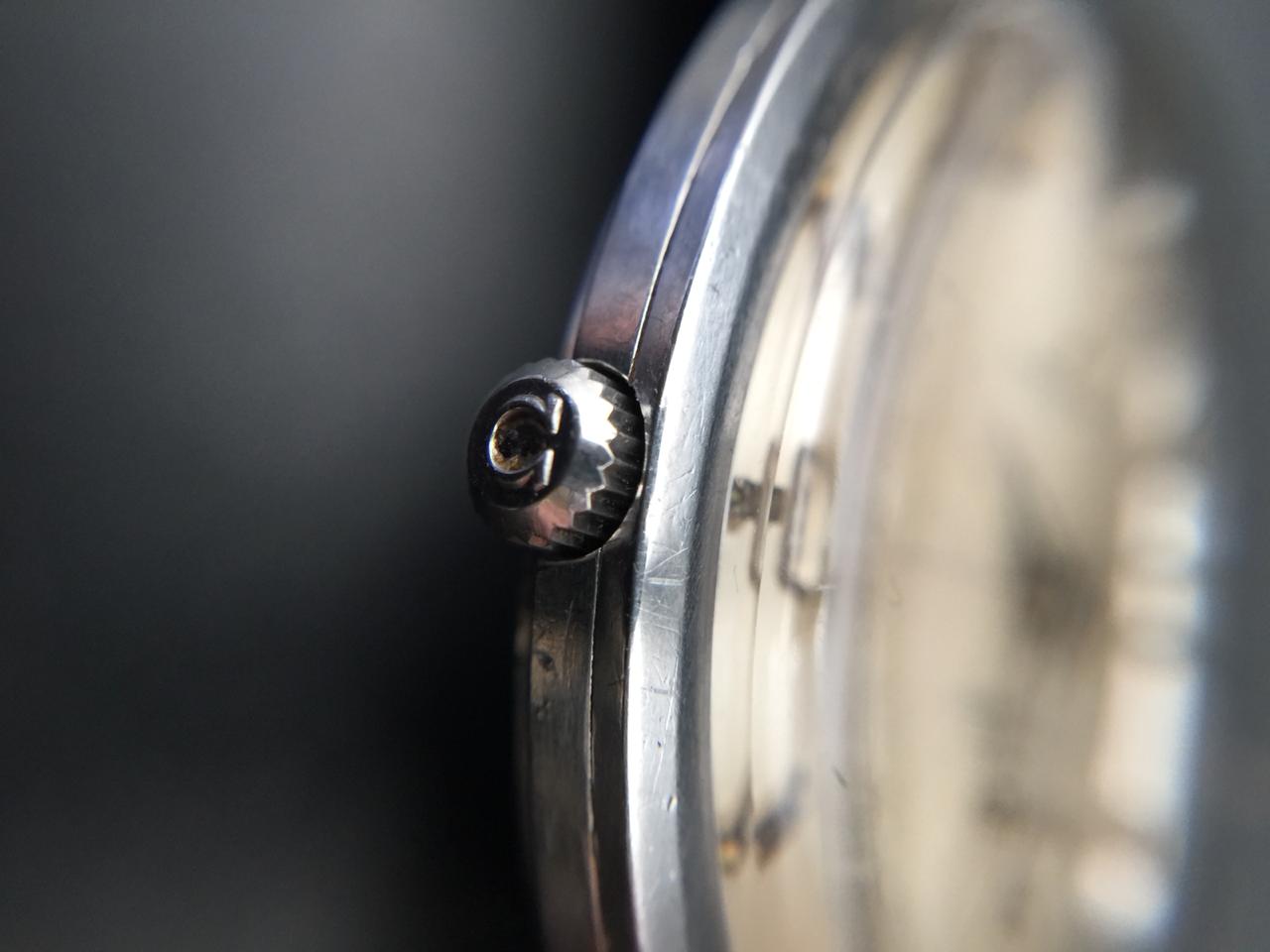

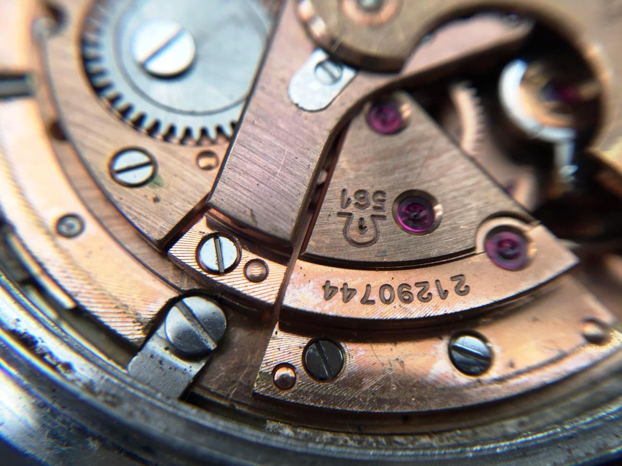

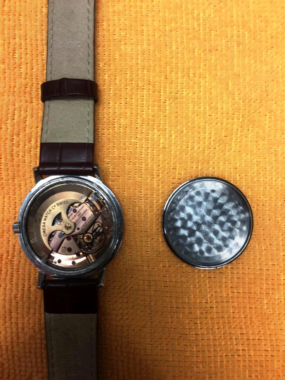

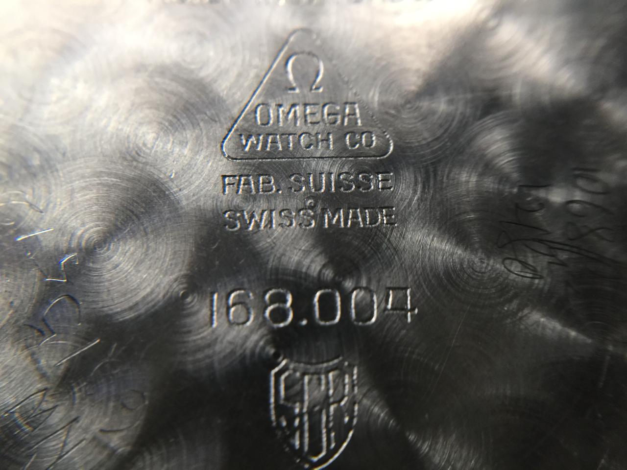

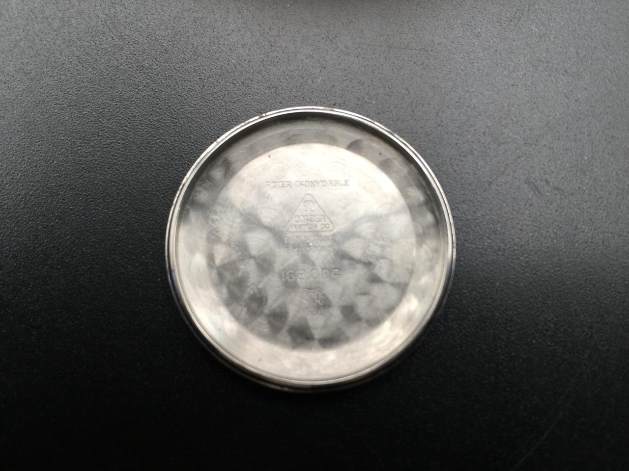

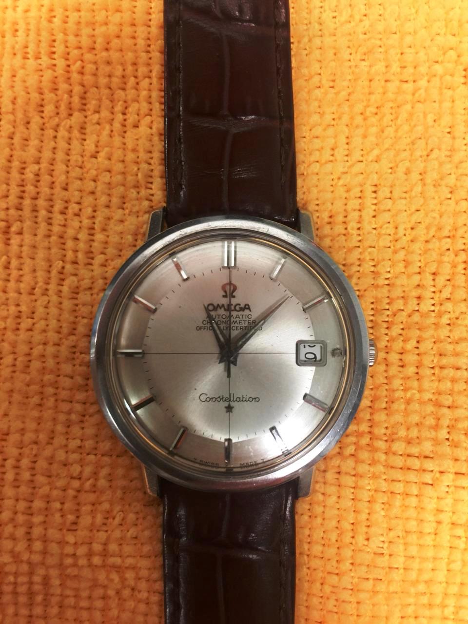

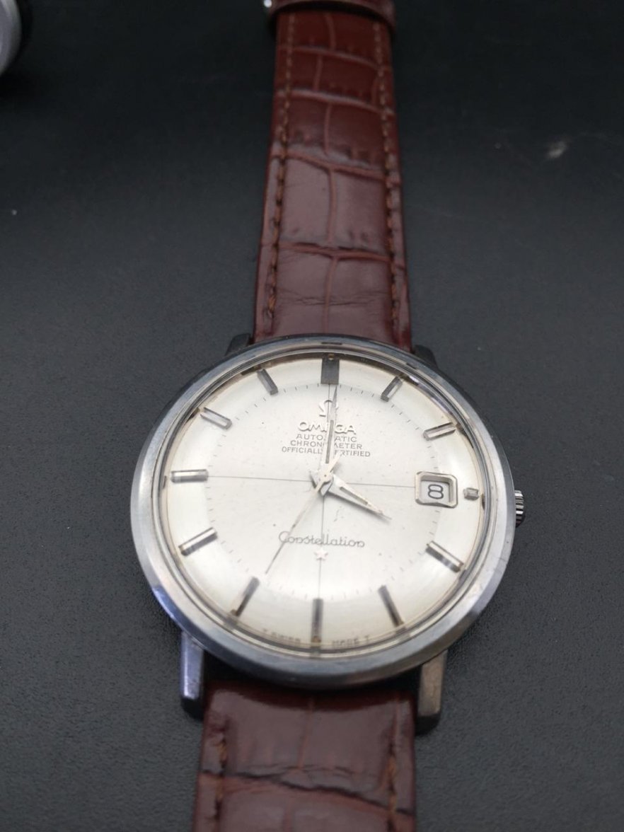

Good day all!
This Connie is a prospective purchase and I would like candid opinions please?
Pros:
Original dial which is quite clean
Serial number, cal. number (561) and ref 168.004 match and date it to 1964
Not overly polished
New crystal (aftermarket)
New rubber gasket
Service crown (better than hidden crown for setting time)
Cons:
Is the case soft?
Rotor is quite worn. However not much evidence of rotor rub on the inside case-back?
Price is $1200 from a dealer.
Pics aren't perfect but this is what I got from the dealer
I am tempted but would like to know if I would be overpaying? These models don't come up that often and I think the dial is very reasonable which is the most important/valuable aspect of this specimen!

If the dial is OK for you, I think it looks fine, albeit a little worn.
However, keep a keen eye on the "Private Watch Sales" thread on OF and you might make a better deal.

Poor example and ambitious price IMHO
Thanks for your opinion? Why do you think it is a poor example in particular? I would like to learn more!
343
1,008

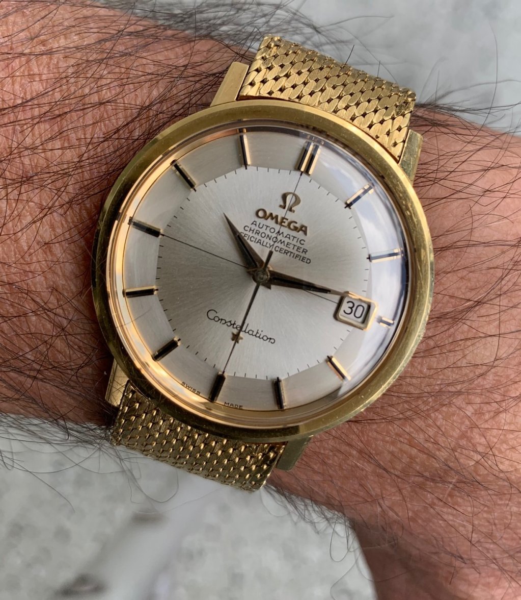

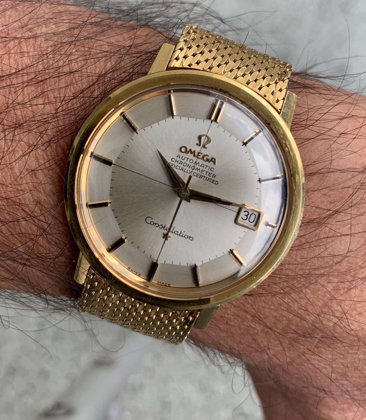

I have thought a lot about the watch you're intersted in and couldn't place exactly why I am not enthousiastic about it. The dial is ok, would have profited from onyx inlays on the markers. So dial is ok, bezel seems sharp enough. But the lugs seem soft. I'll post this 18K version which I bought a few weeks ago for 2470 GBP alltogether with the 18k bracelet:
So its a borderline thing in my opinion: The wrong crown matters somewhat, and the lugs should really be sharper for a SS version. The scratches on the rotor are certainly not attractive. Also, bear in mind that pie-pans on 168.004s are less pronounced and thus less desirable as a general rule. So all considered, the price is a bit high IMO.

I give you a like for your watch and for your comments.
I feel the same way about the OP’s watch, - it leaves me a little underwhelmed.
I have to agree that the case is soft and the dial is just ‘okay’ (there’s something going on with the 3 index)
I’ve no idea what has been going on with the rotor or how you would get multiple scratches like that on it. It is also rubbing on the movement.

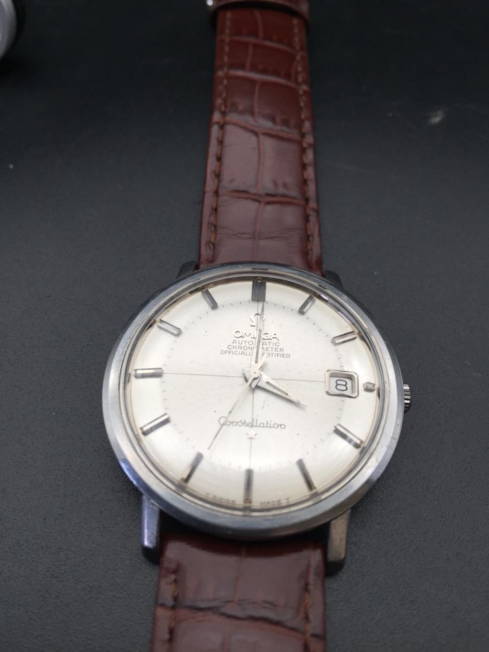

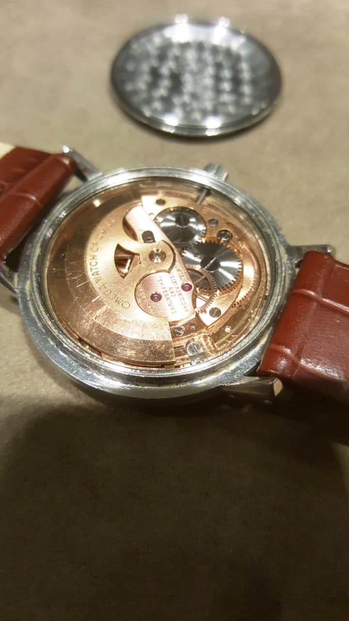

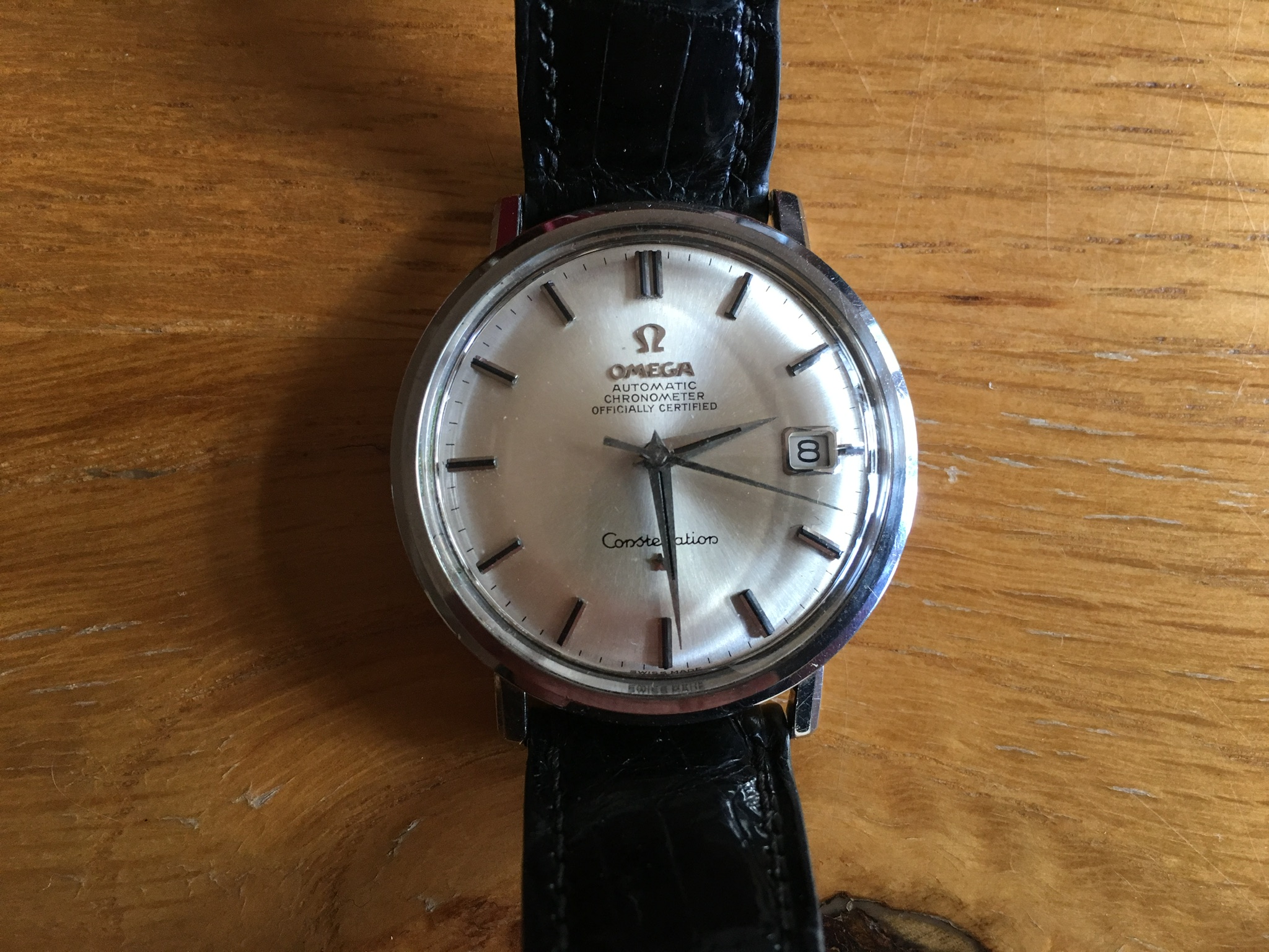

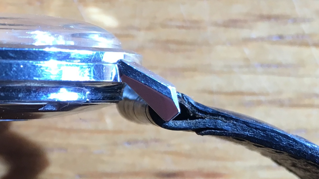

For further reference, here is an SS dome dial .004 I was lucky enough to snag earlier in the year showing how the case should look.

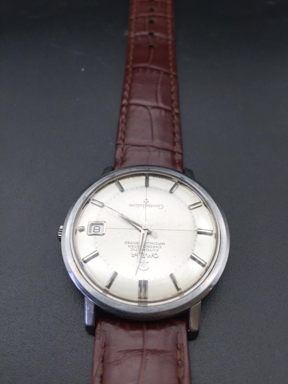

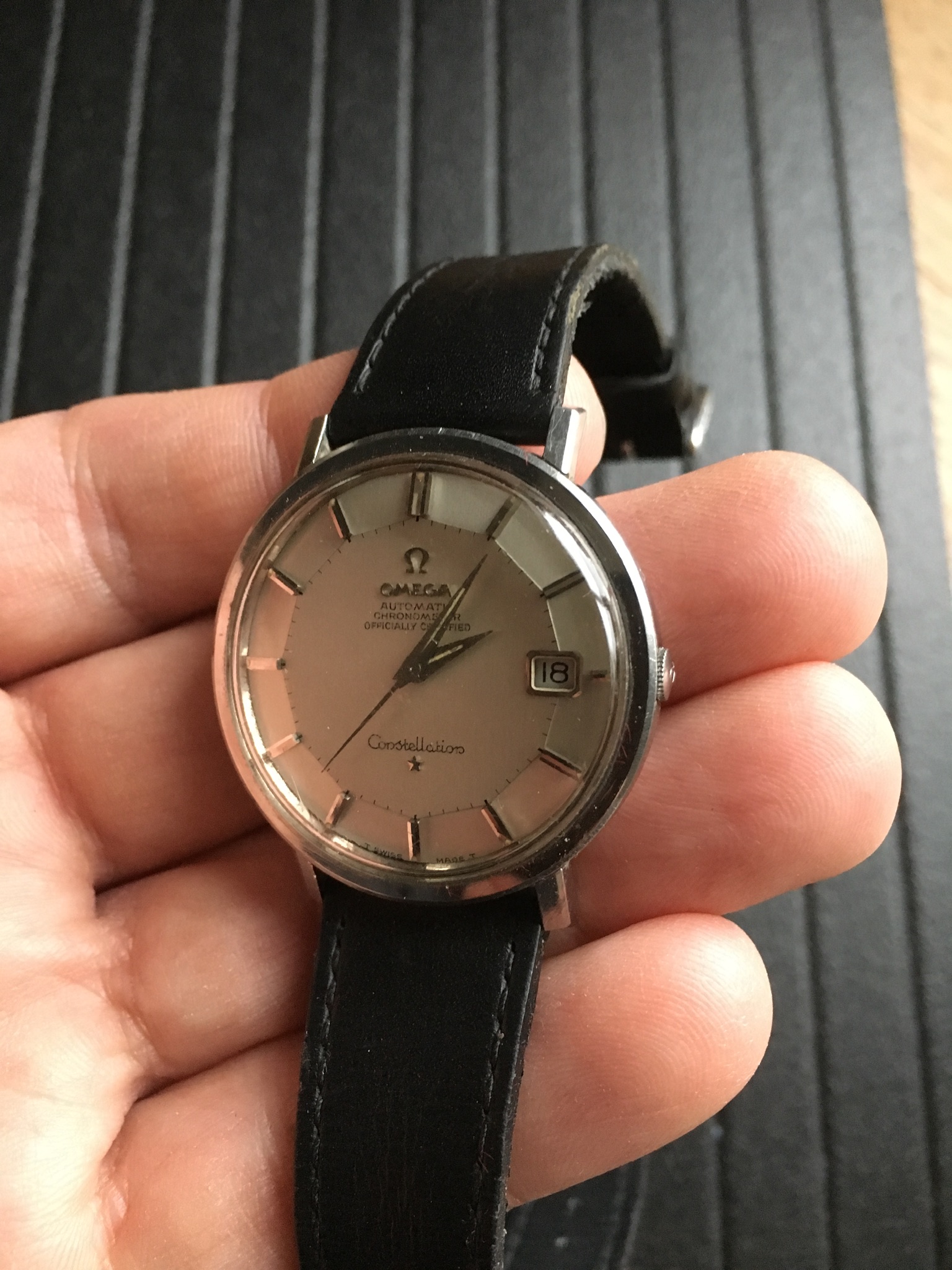

And a pie pan .004 I picked up a little before that

Wow! Wow! and wow again! The response from all you experts is just phenomenal! The specimen's you have are excellent.
It has become very clear to me that this watch that I was interested in is not going to lead to its purchase. Patience to wait for the specimen in the right condition and right price is the wisest advice in this game.
