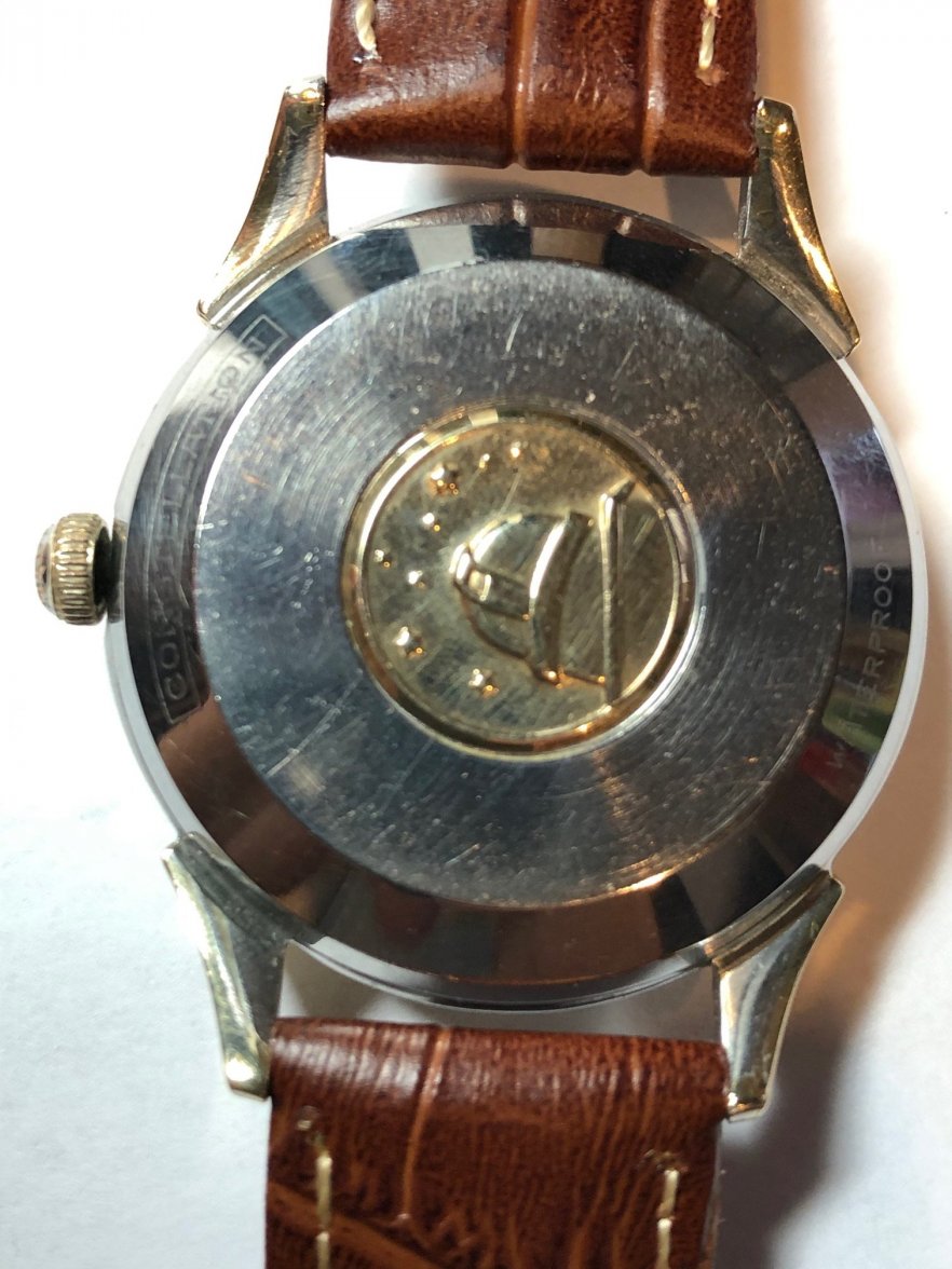

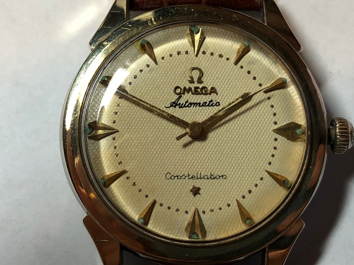

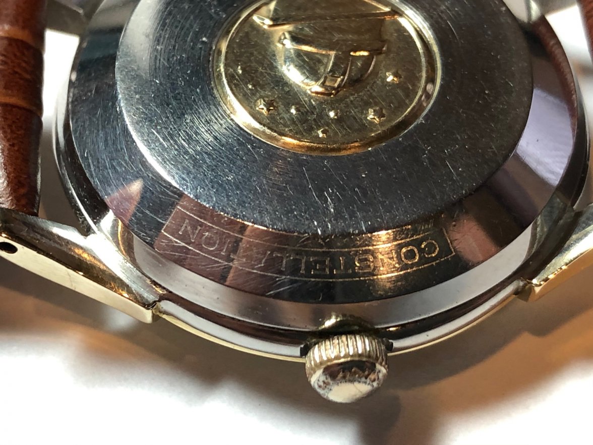

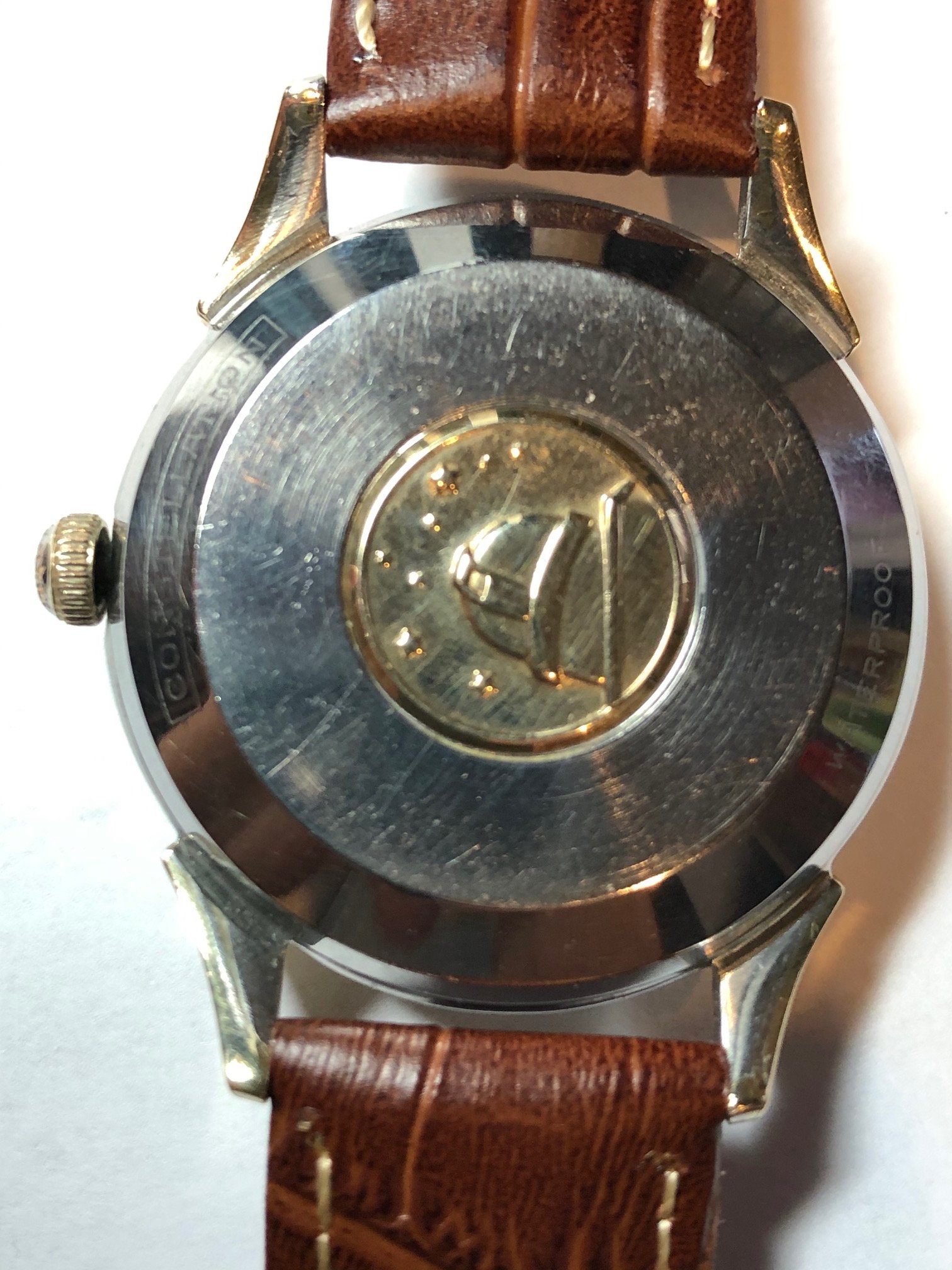

I was fortunate to be on the receiving end of a classic Constellation but for the life of me I can't find a good picture to help identify it's vintage.
This watch has come to me with zero provenance other than it was stuck in a desk drawer of a friend of mine and he happened to give it to me in passing as he was headed to the thrift shop to donate it and some other items.

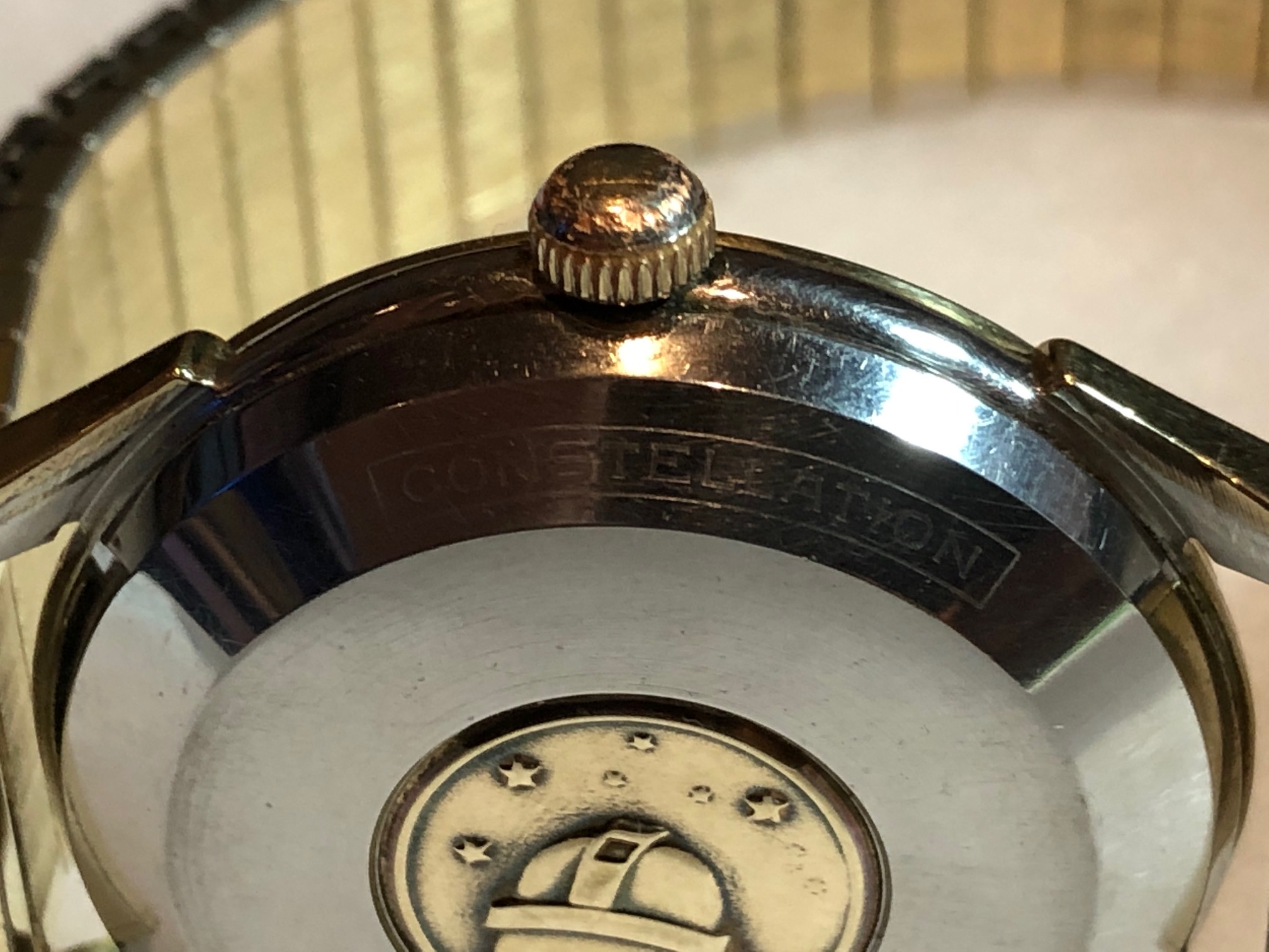

I held it in my hand and within a few seconds the movement started up. It came with an awful twist-o-flex band and was pretty dirty. A bit of a clean and polish of the crystal and a fresh leather band we are looking pretty good.

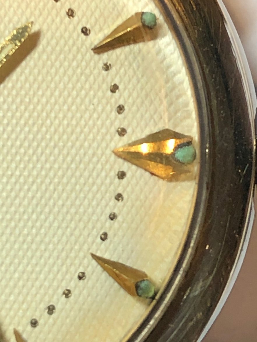

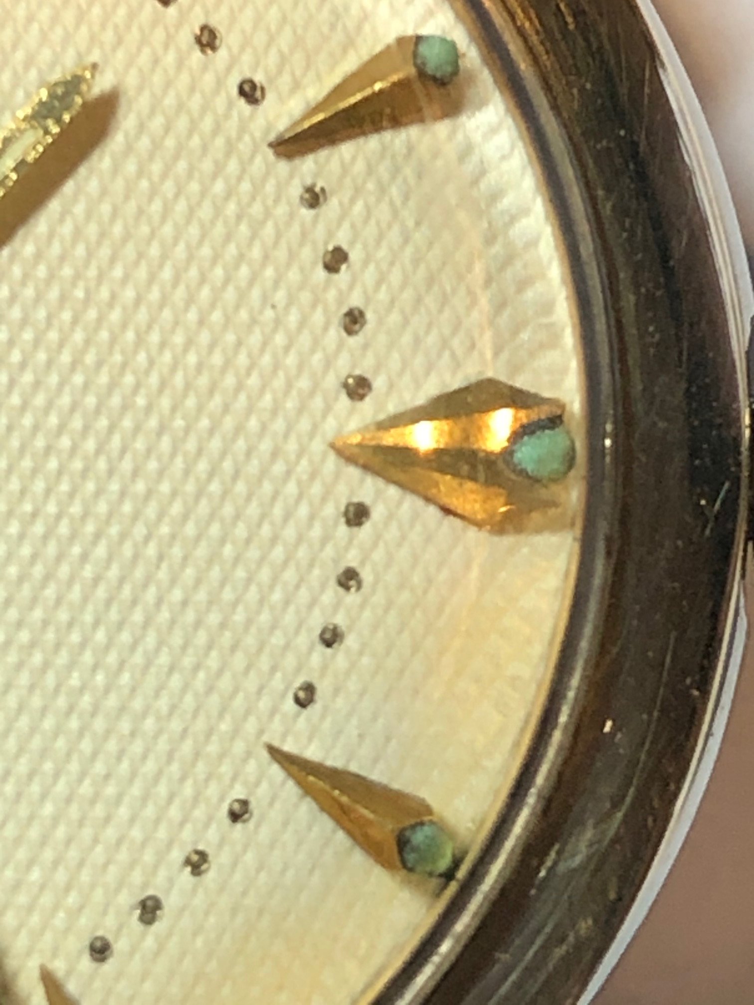

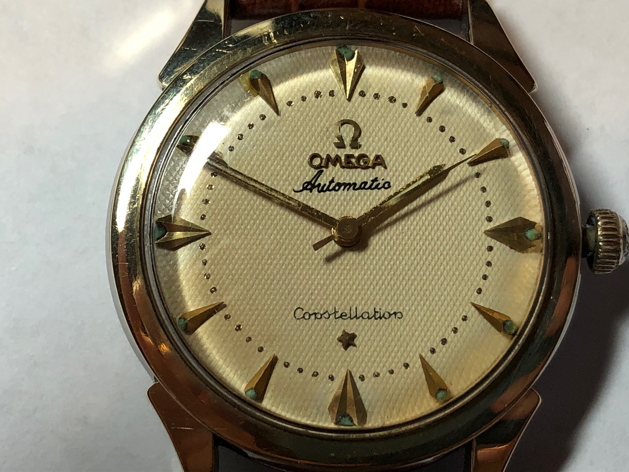

The watch is gold on stainless and the dial markers are points (not numbers) and have luminescent dots on them. Surprisingly the luminescent markers still work after being exposed to a desk lamp but under a close look are showing their age.

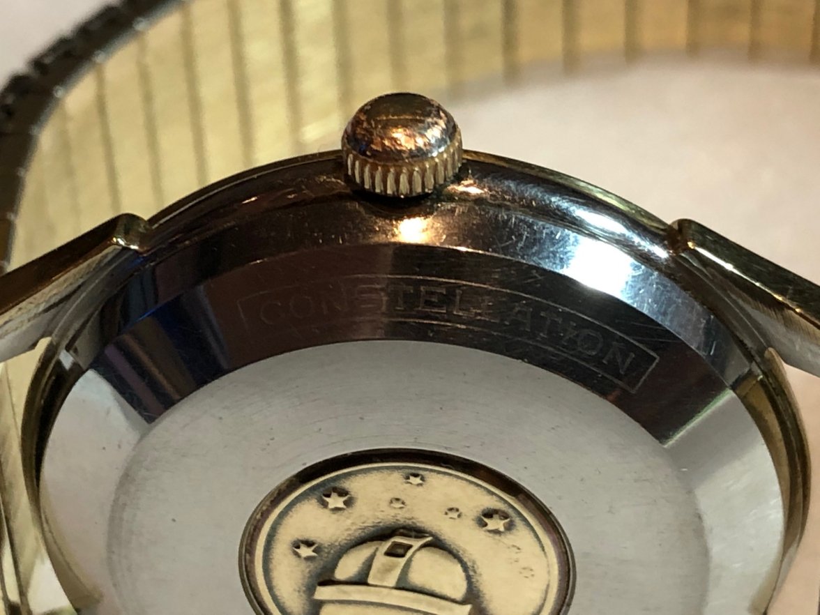

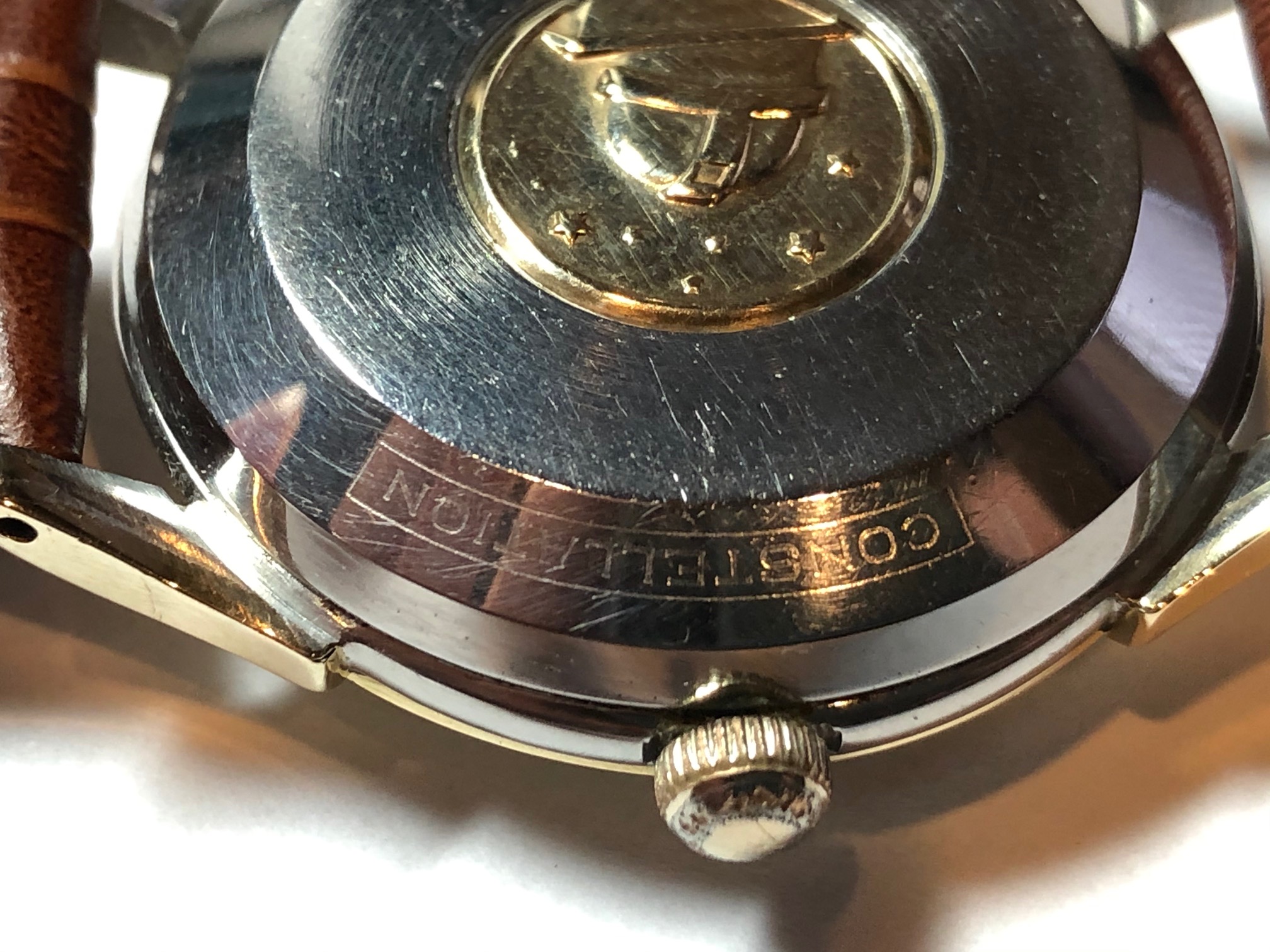

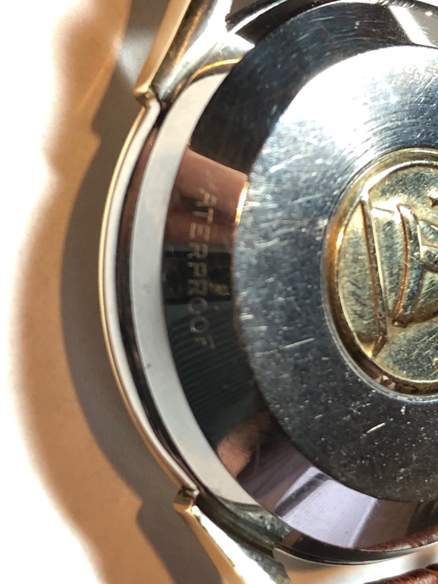

On the dial the word "Automatic" is in a cursive font and "Constellation and Waterproof" on the back. I have been unable to find a picture of a similar one yet on line and I thought I would ask for some help in solving the mystery.
Given the watch is keeping very good time losing only 2 min or so in the last three days I am reticent to open the watch up until I find a good watchmaker here in Portland, OR.
I am super curious about what I have, but I will likely just enjoy it for the time being following the "ain't broke, don't fix it" mantra.
thanks in advance for any help you can give!

Welcome to the forum. The dial has been refinished, which is unfortunate as waffle dial constellations are uncommon and quite sought after. The hands and crown have also been replaced at some point.
You should have a watchmaker remove them case back so that you can take photos of the movement and inside of the case back - this is where you’ll find most of the info on the model and be able to assess whether other parts have been replaced.

Not sure if it's help but:
1. bad redial
2. the crown and hands have been replaced
3. relume
I'm sure other opinions will follow

It's a repainted and relumed guilloche dial. Modelnumber is on the inside.

** I will get the back opened and we can sort out the numbers but you are thinking the dial might have been replace or just "relumed" ?
Are original crowns and hands still available? would it be best to remove the lume completely? sorry for the newb questions.
** thanks for the quick reply. I would assume crowns and hands might be able to be replaced and the lume material removed I would expect. I am not sure a total restoration on this watch is worth it but given the initial cost (free) and I have no specific sentimental feelings on this it could be in the cards. Thoughts?

What they mean is:
"the dial has been refurbished" - it's not original. Which reduces the value somewhat.
"the crown and hands have been replaced" - again, not original, reducing the value and collectibleness somewhat.
"the glow-in-the-dark paint has been stripped and replaced" - ditto.
None of these require ANY work on your part to correct, and at this point they are pretty much uncorrectable anyway.
Unless you're trying to sell it, no big deal. Your watch is perfectly functional as-is, and it would still command a reasonable fraction of its "untouched" cost were you to sell it.
To find out more details - (the date of manufacture, and etc.) you'll need to remove the case back, which is probably best left to a watch-maker. Three relevant bits:
Serial number: an 8-digit number etched somewhere on the movement. Pretty small, you may need a loupe.
Case number: on the case back. tells what case model you have, generally speaking.
Calibration number: 3 or 4 digits on the movement. Tells what kind of mechanism you've got.
The biggest reason you might want a *GOOD* watch-maker, and not some random guy from the mall is for a general servicing, which cleans up the mechanism and tests the seals and should ensure that it continues to work for years to come. Without servicing an old watch may be prey to rust and decay and things silently breaking. Servicing may run you a few hundred dollars- whether it makes sense is up to you.

... are thinking the dial might have been replace or just "relumed" ?
Completely re-painted, and also re-lumed.

Interesting- I would have thought it would have been cost prohibitive to repaint a dial on something like this?! Why not just get a "new" dial at that point. Without any history I guess I will never know the reason.
It's EXTREMELY common, and used to be done routinely.
2,326
1,887
Not too long ago a dial refinish would be $15. Now it's more for collector-quality refinish. But it used to be cheaper than dirt and a lot less expensive and easier to get than a replacement.

Here is the update after finding a watchmaker who could handle a proper service
Cal - 501
Case 2852 -4 SC
Serial number 146 51 654
Digging now to understand what this means so I can get an idea of what a proper dial should have looked like given this info.

The model is an Omega Constellation with the model reference 2852
The movement calibre is a 501
The movement serial number is 14651654. You can find the production year with one of the many charts out there ( mid 50's )
If you Google "Omega Constellation 2852" you will find many dial variants
