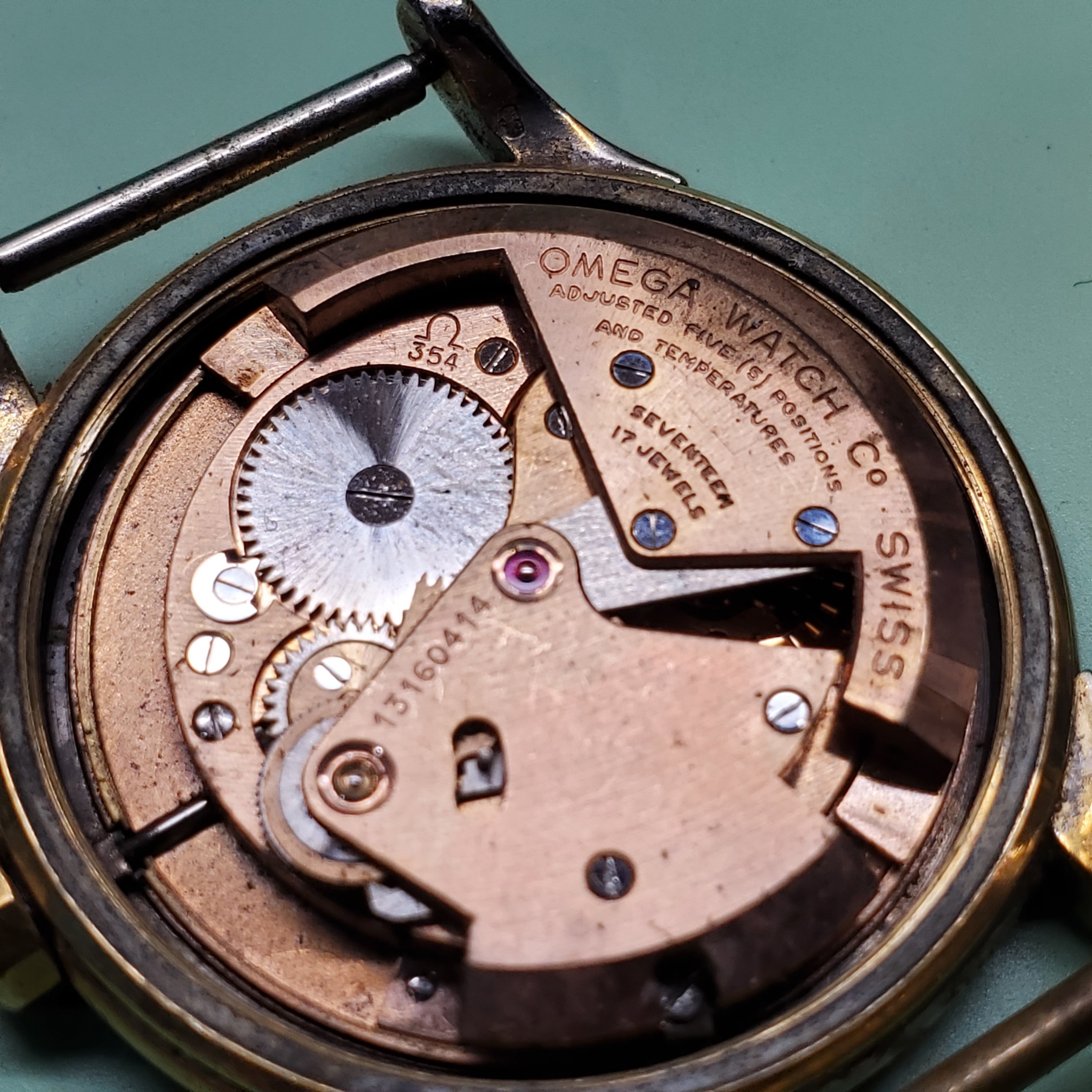

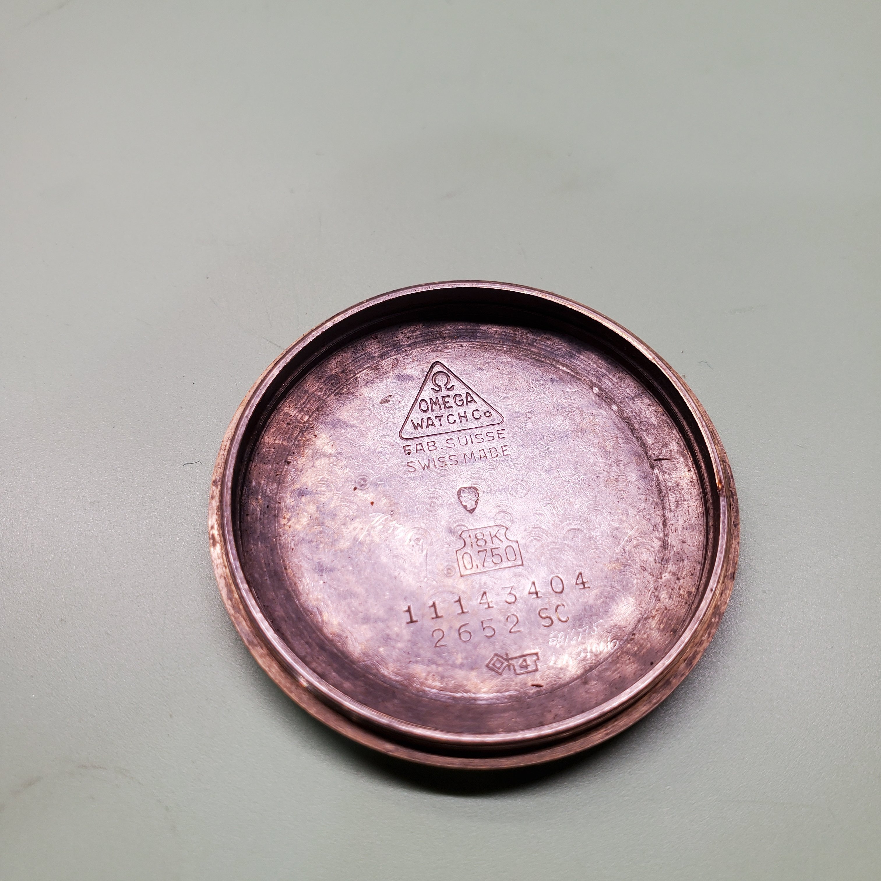

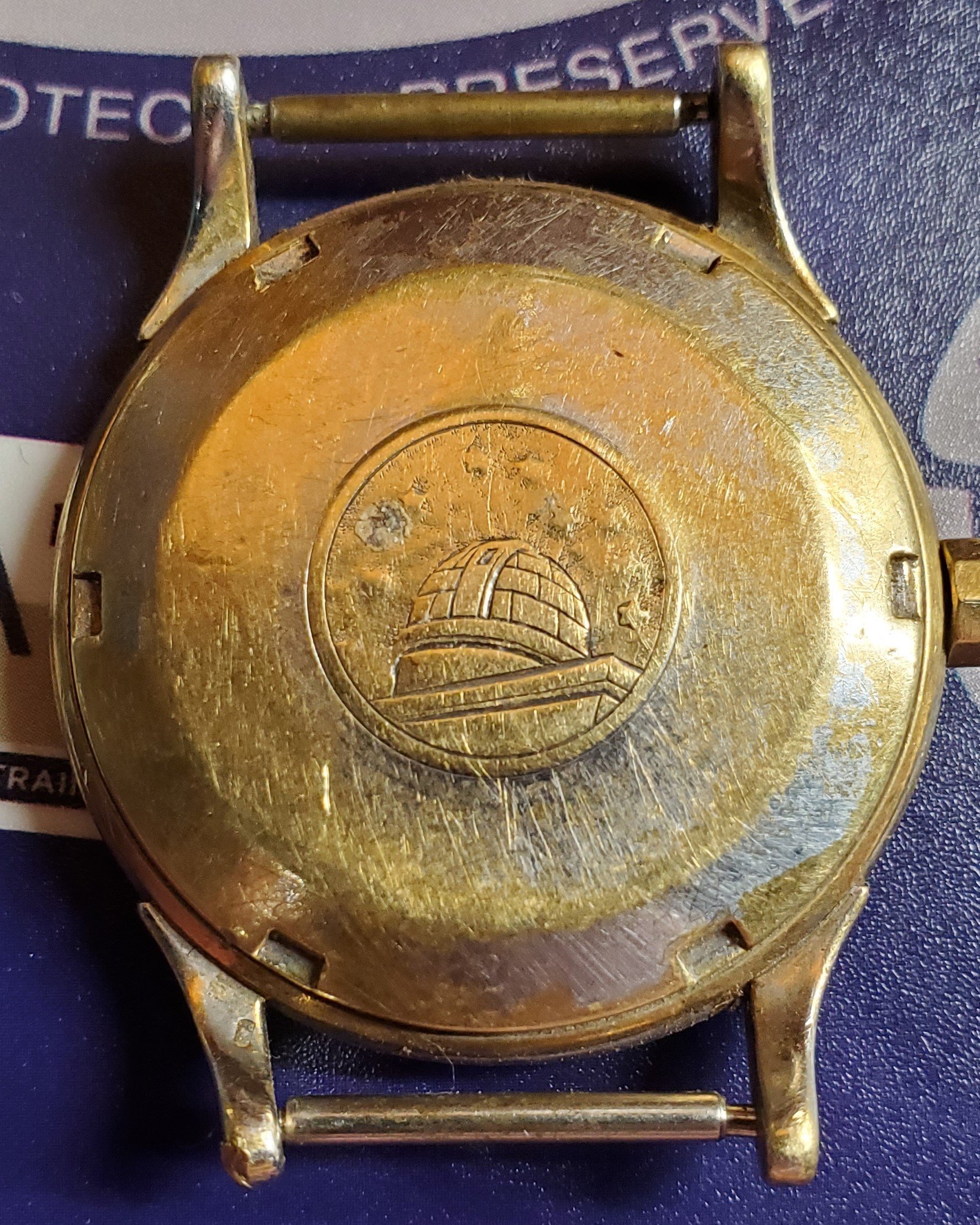

In the bottom of the box, I stumbled across this very rough Constellation. It's marked as what "the internet" says is solid 18k gold. However, it has what appears to be a silver-colored plating OVER the gold.
Was this rhodium? White Gold? Is this gold filled/rolled and I don't understand markings? Does the movement appear to match the case and dial? Should I attempt to get this up and running? The balance is good and swings freely. Part it out?

It is a Globemaster, which is nothing more than a Constellation rebadged for the U.S. market.
You can read more about the history of this watch here:
https://download1648.mediafire.com/...MjMdzGajA/r6z1f6wcg9qeqfg/Globemasterpost.pdf
I believe that it is 18K gold, as it is properly hallmarked. It is hard to see the color of the case from the photos. You can always take it to a jeweler who can confirm the metal content for you.
The watch looks to be totally original, except maybe for the crown. The dial is in decent condition considering how it was stored.
Although the case is very worn, this is a watch well worthy of a movement service, ultrasonic cleaning of the case, straightening of the lugs and a new crystal. The seconds hand is missing, but a watchmaker knowledgeable in vintage watches should be able to find a proper replacement. You will need to throw some money at this, but I think you will be rewarded for your investment.
