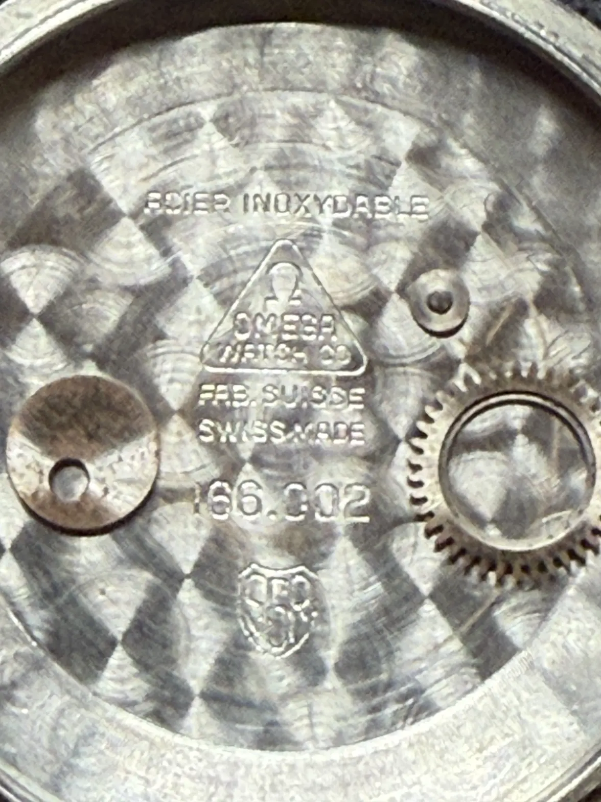

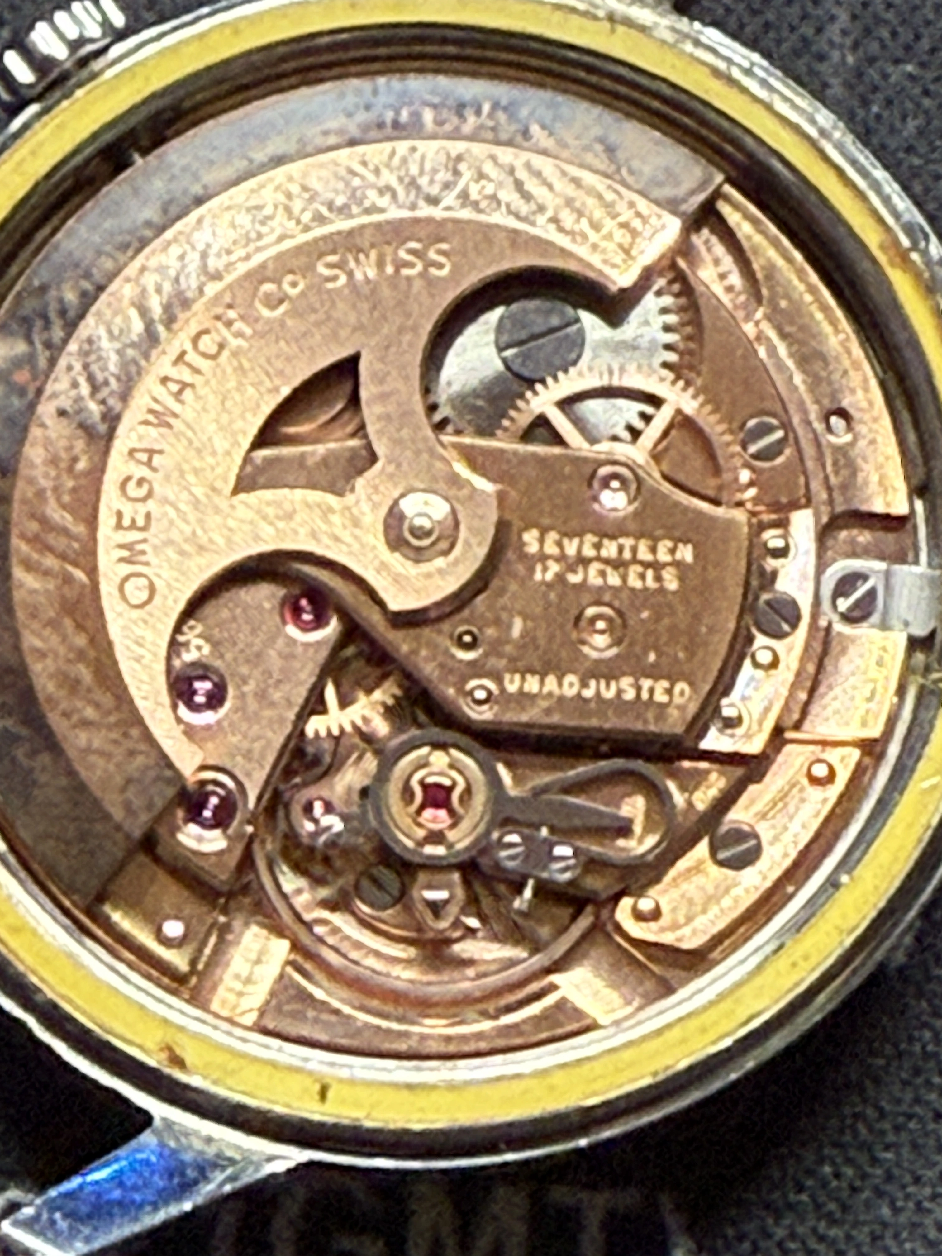

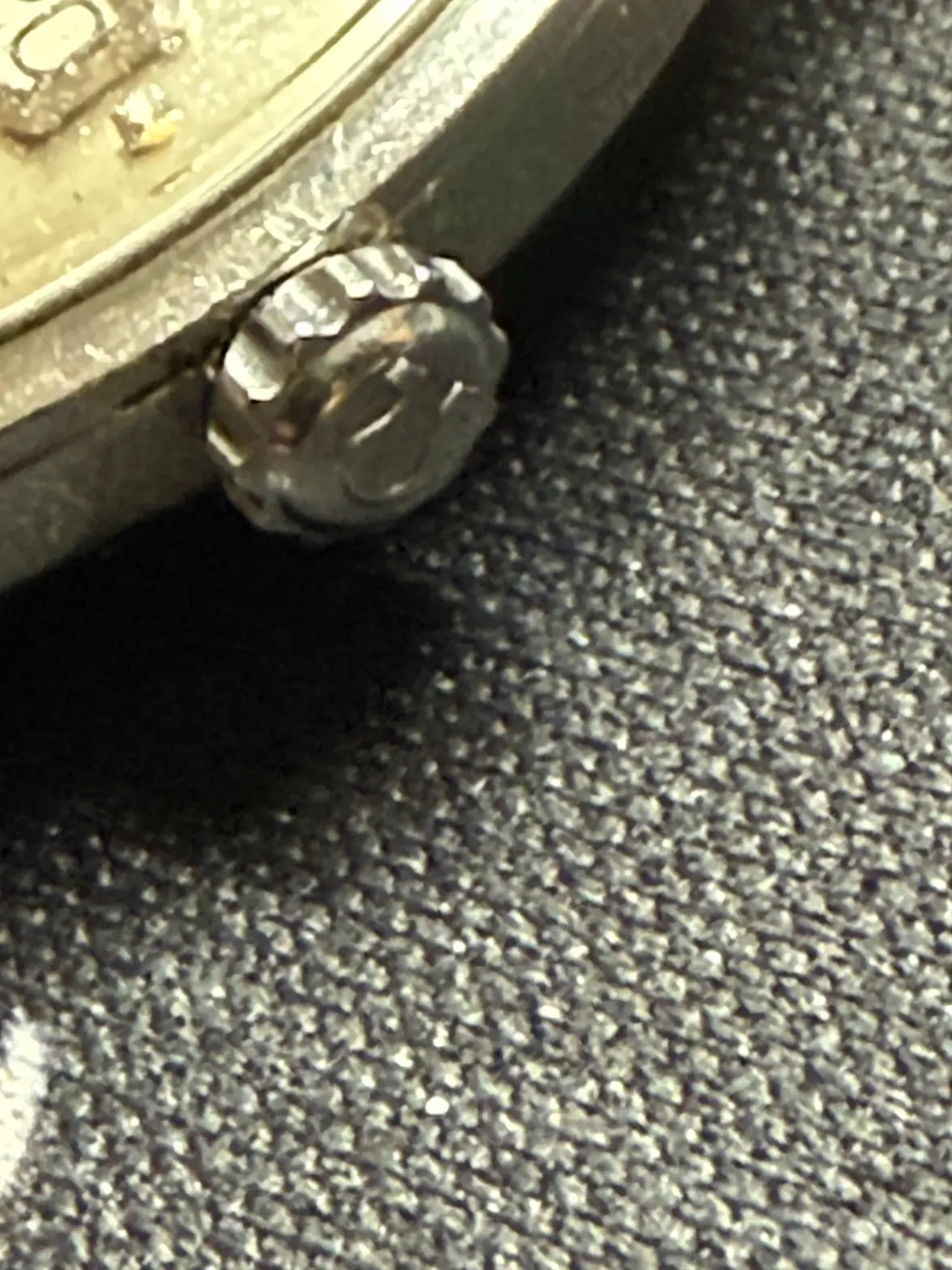

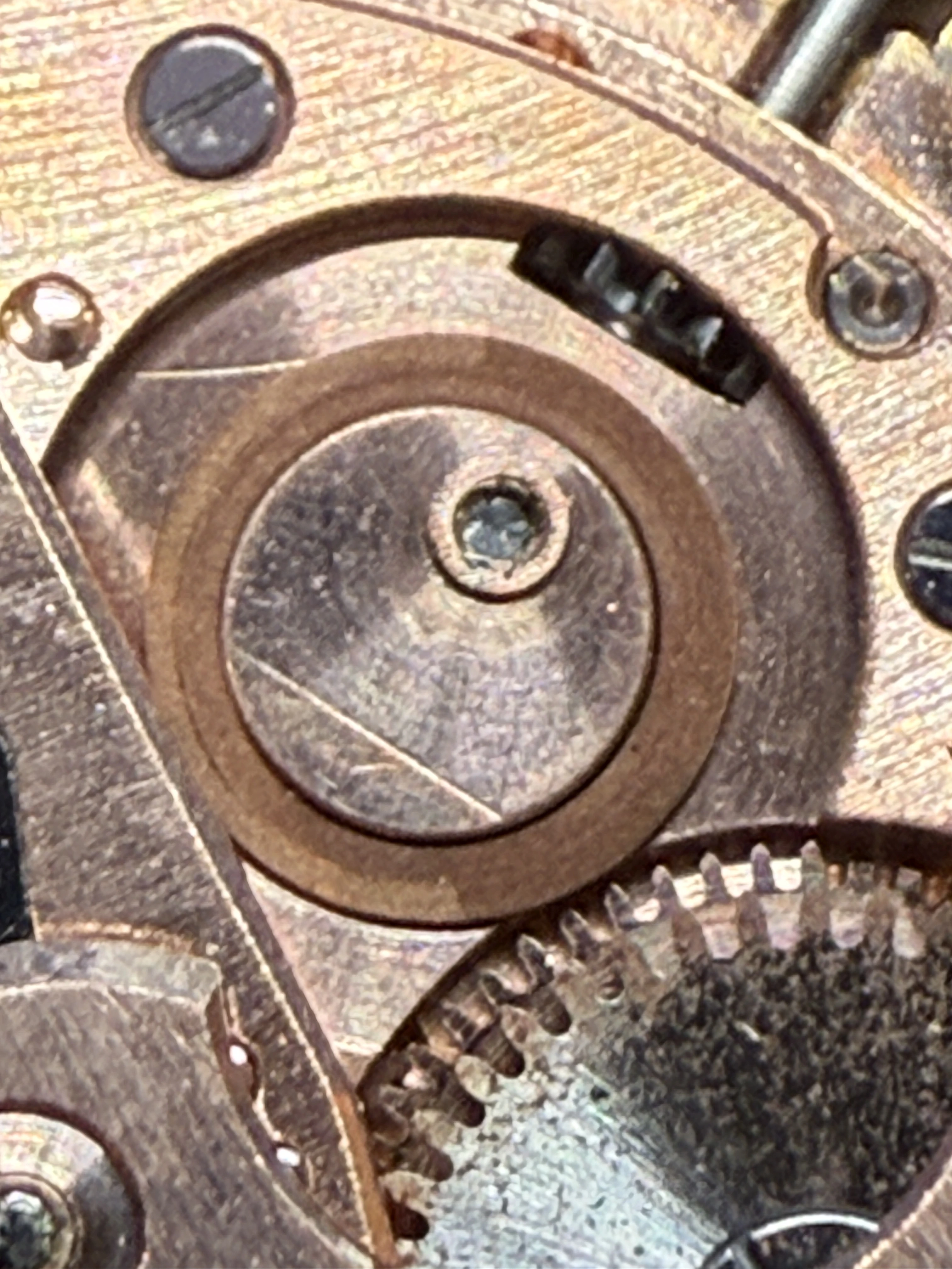

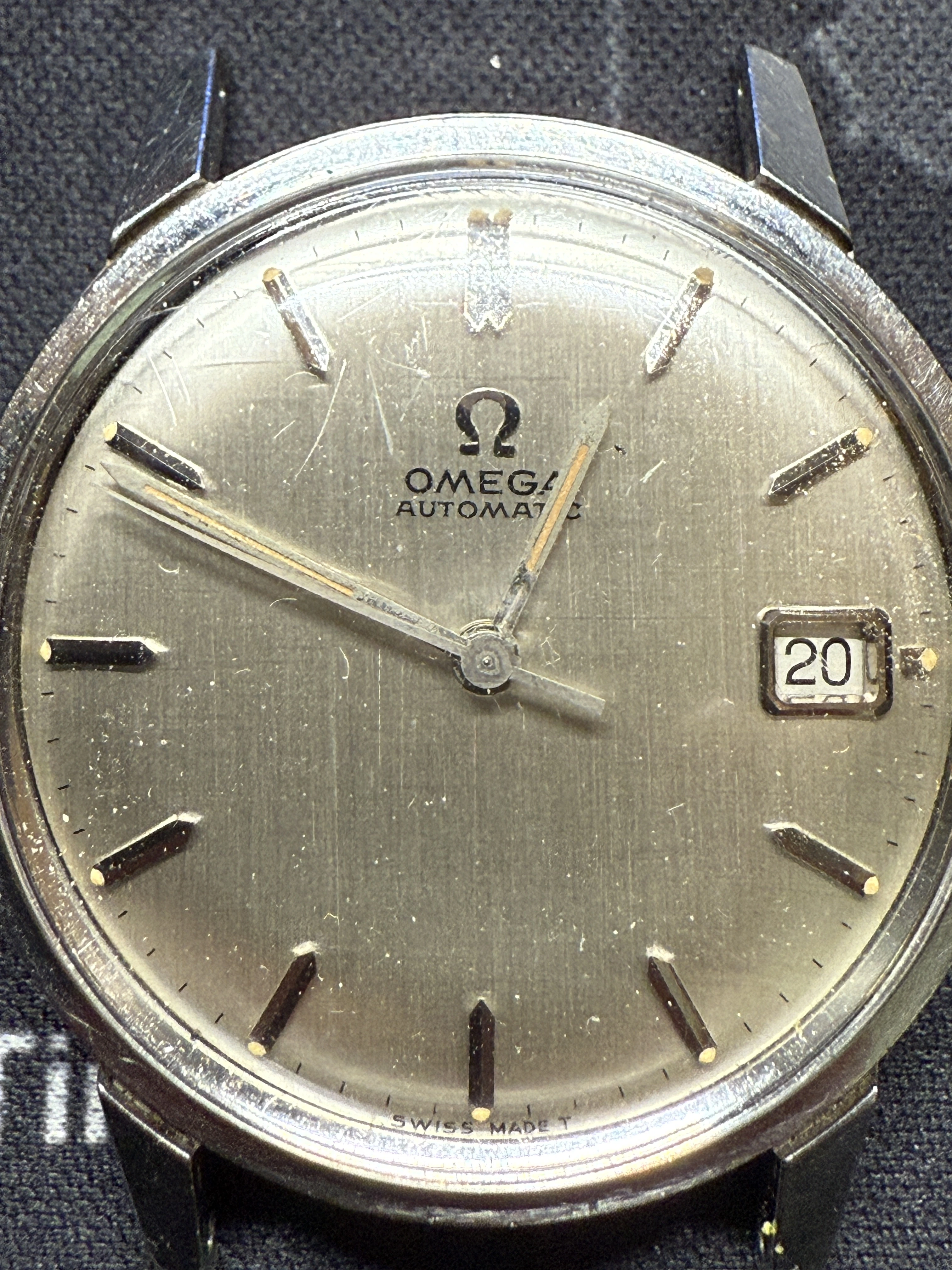

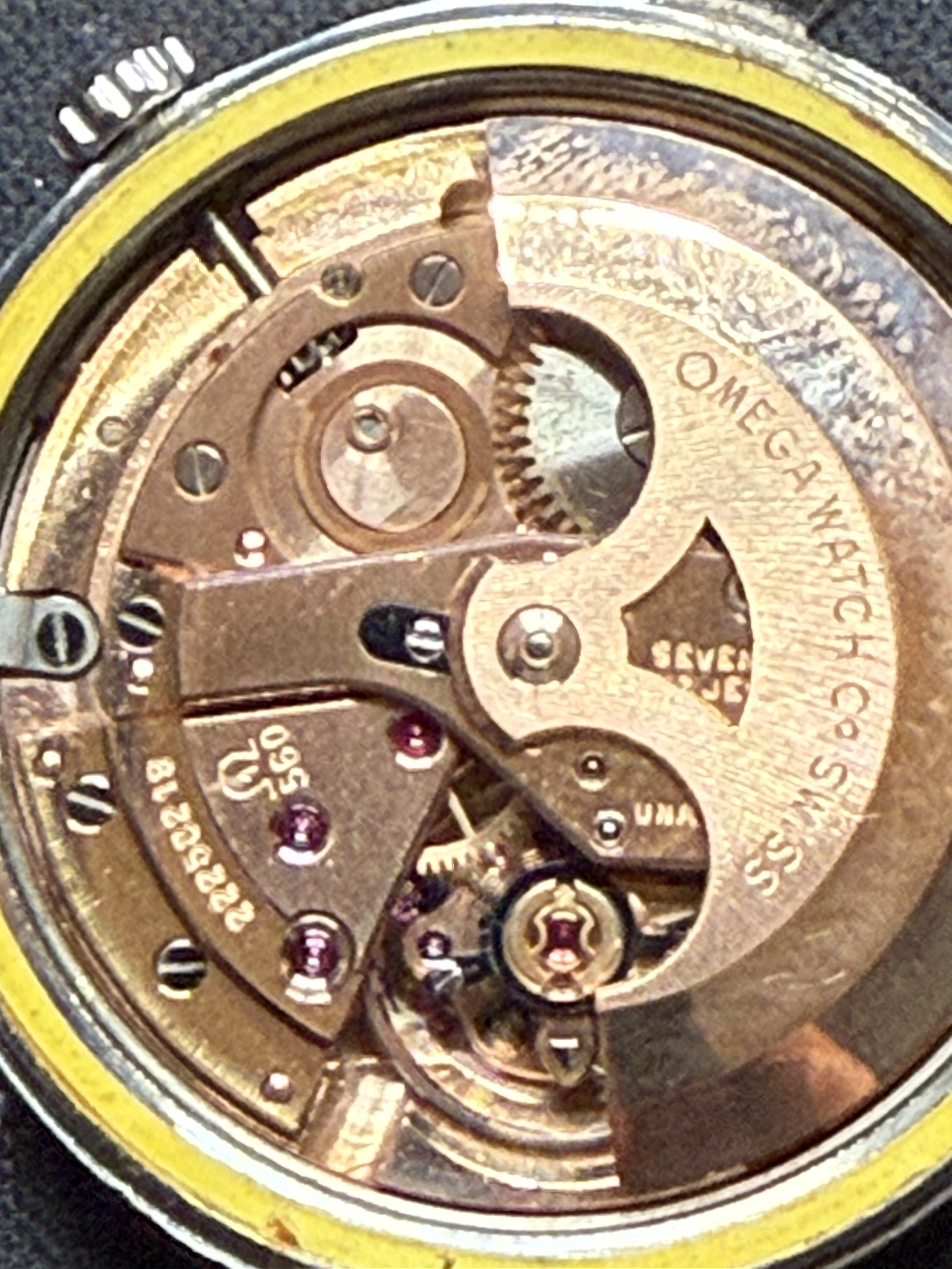

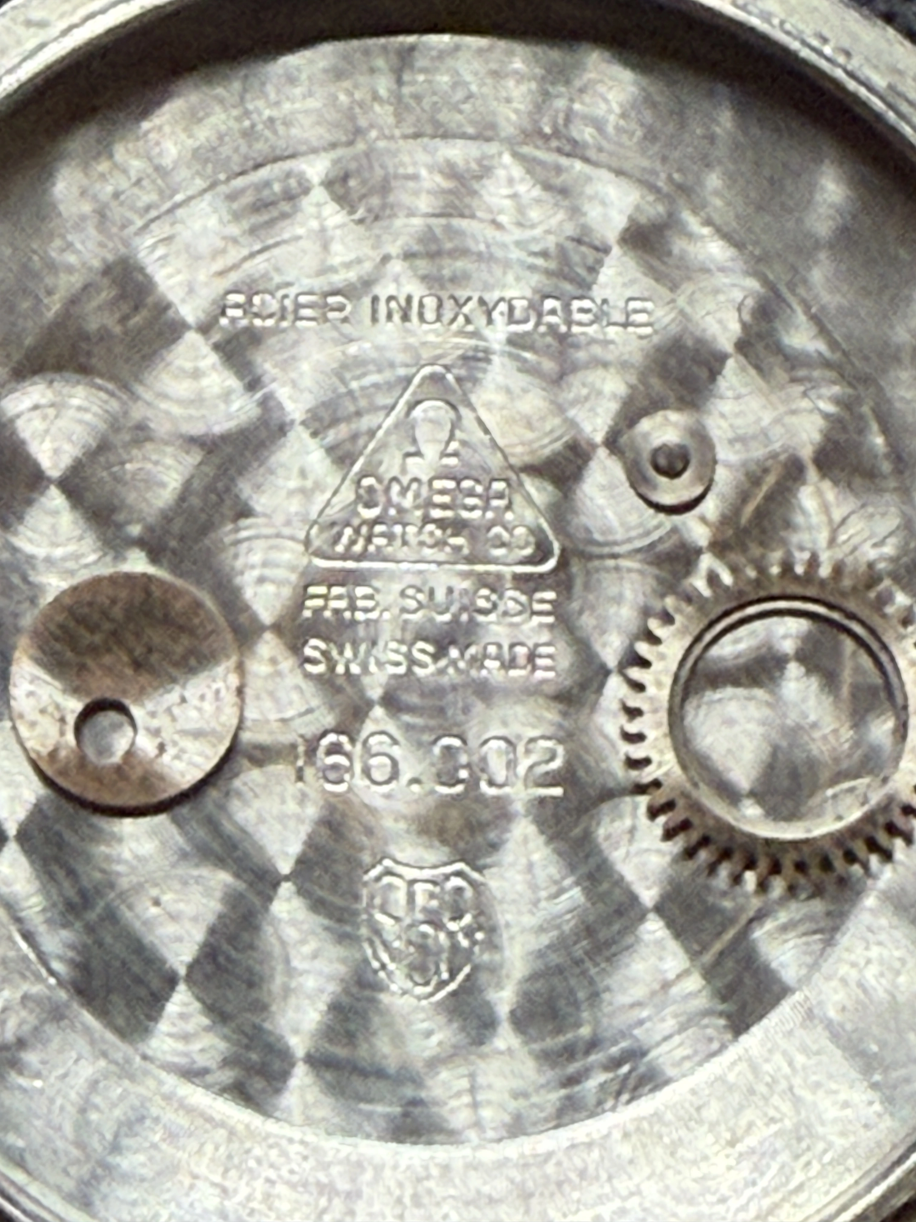

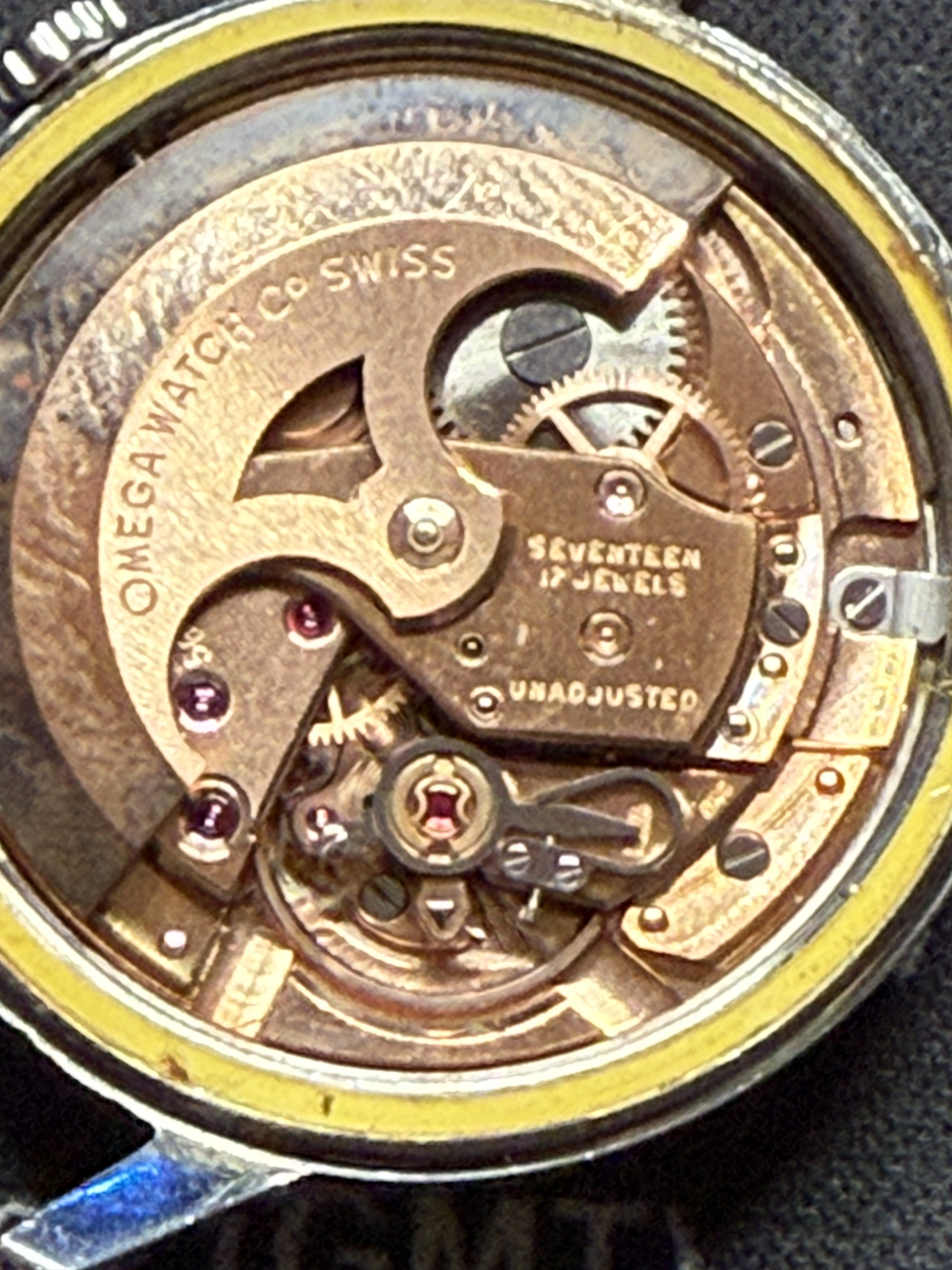

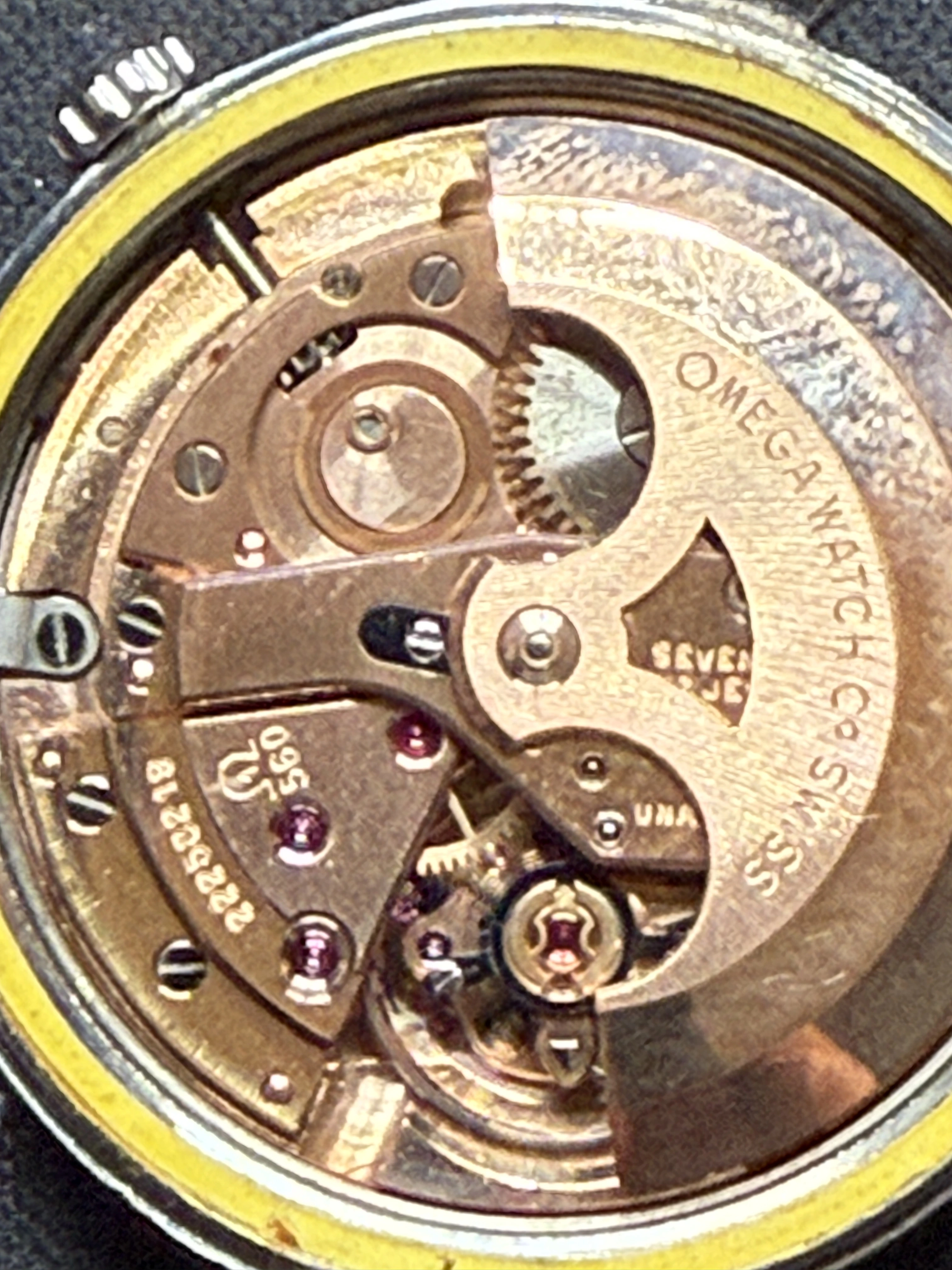

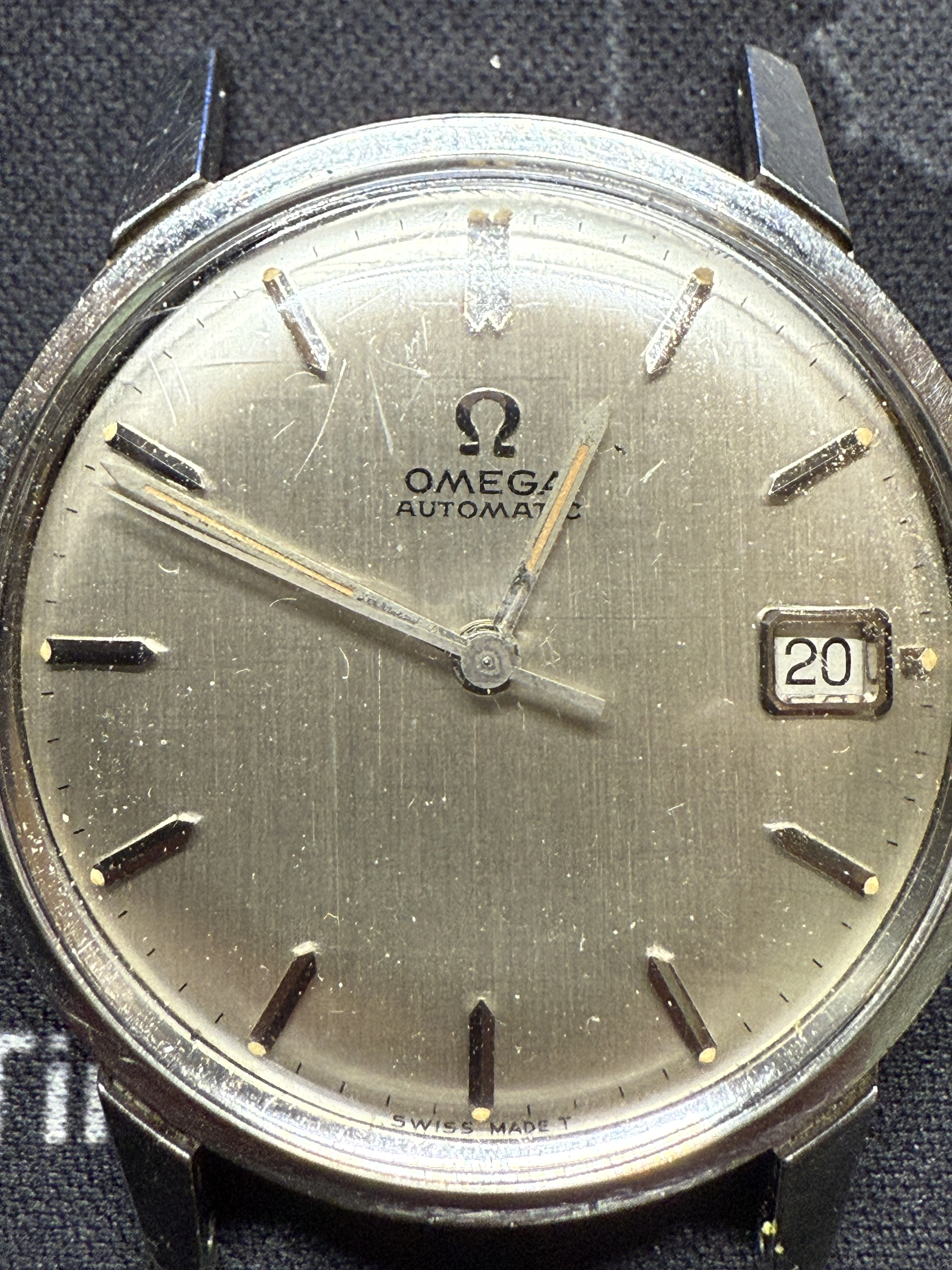

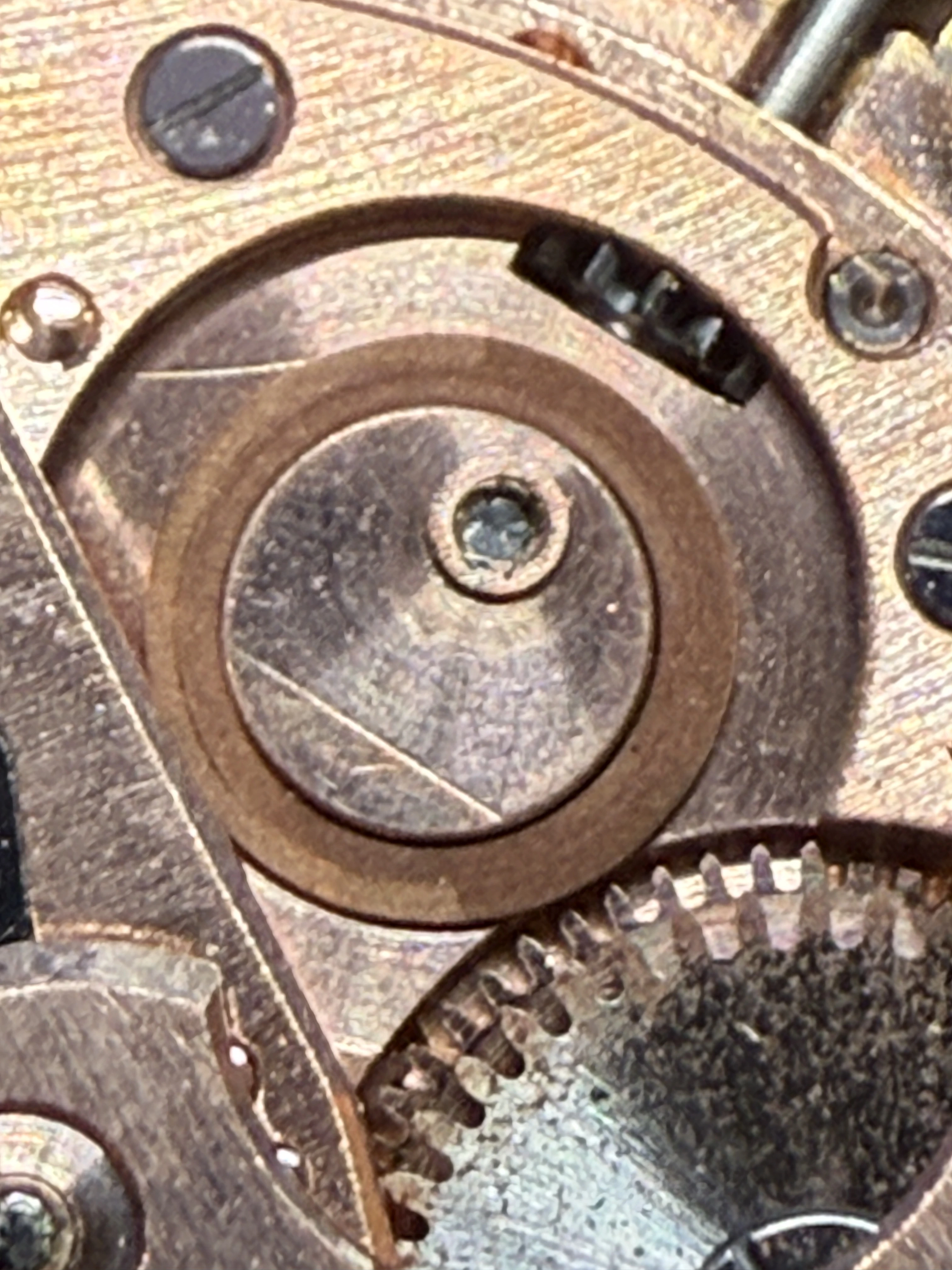

I am new to vintage watches and I picked this up at a pawn shop in 2006 for $40 with the intention of getting in to the hobby then, and then life happened. Today I decided to go down the rabbit hole and opened it up and I found the winder screw broke off in the winding bridge. So my question is, is it worth the effort trying to fix?

Yes, looks in good shape and worth £500+ in today’s market. Check out sold prices on eBay or window shop on Chrono24
13,538
23,482
Yup. Case looks sharp, dial probably looks better than in that picture (I assume some of the marks/dust are on the crystal).
30,219
78,024
Nothing there will be a problem for a professional watchmaker to repair…
18,803
39,062
I think the crown wheel screw is an easy fix for a competent watchmaker. With a service and a new crystal you will have a very nice watch.

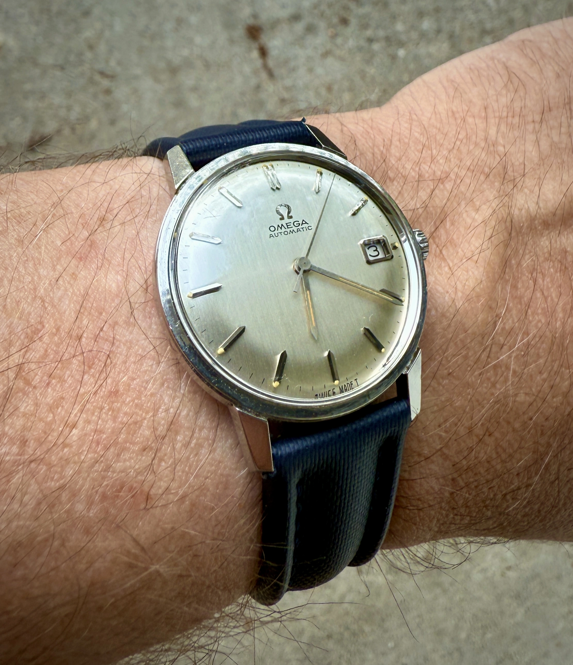

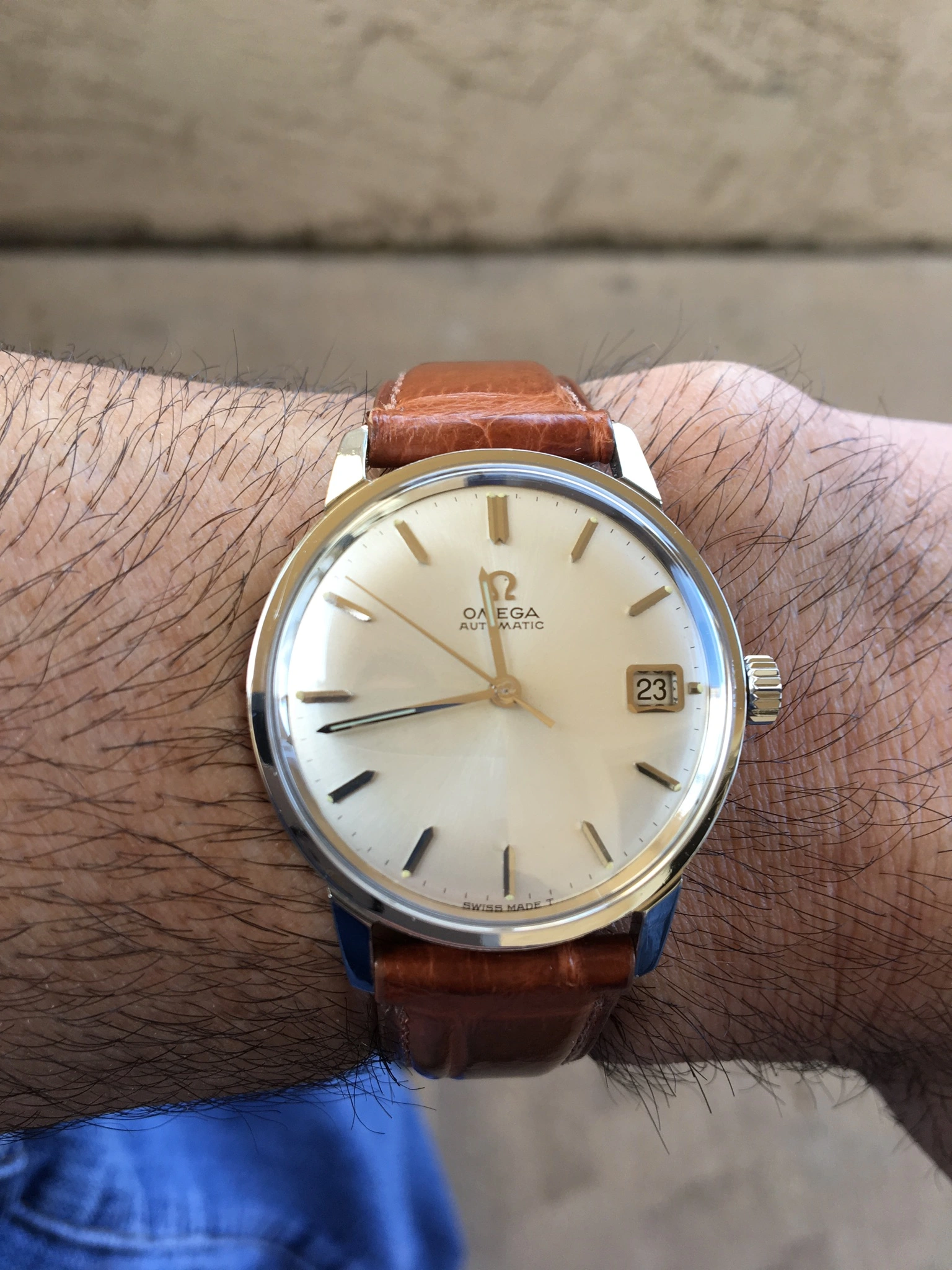

Here's what mine looks like after a visit to Archer..The hands were replaced because the finish was flaking also, the crown was replaced because I intend to wear the watch and wanted it to have some moisture protection. The original hands and crown were returned to me incase I want to have them put back on.
