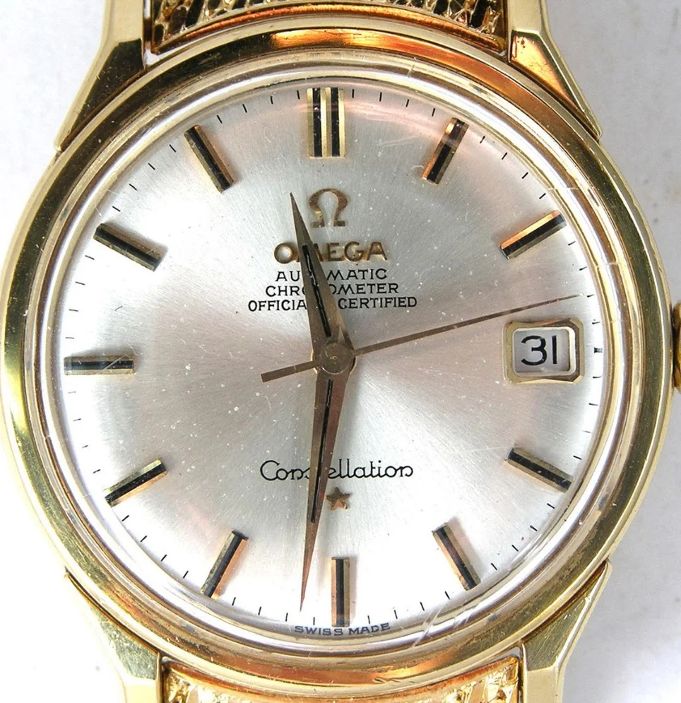

Here is one with a really flat dial:

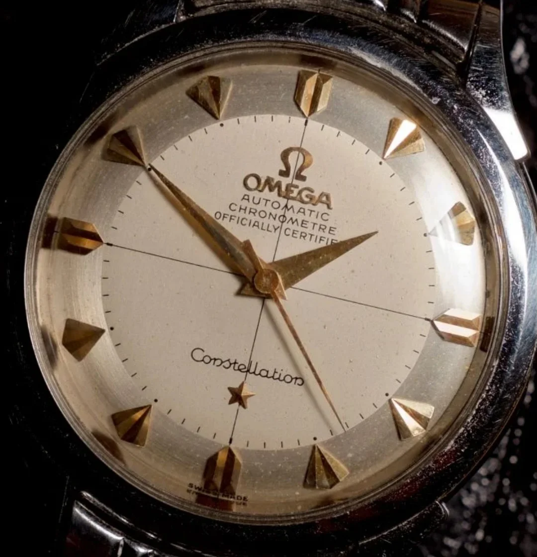

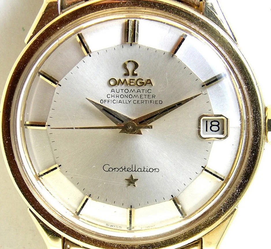

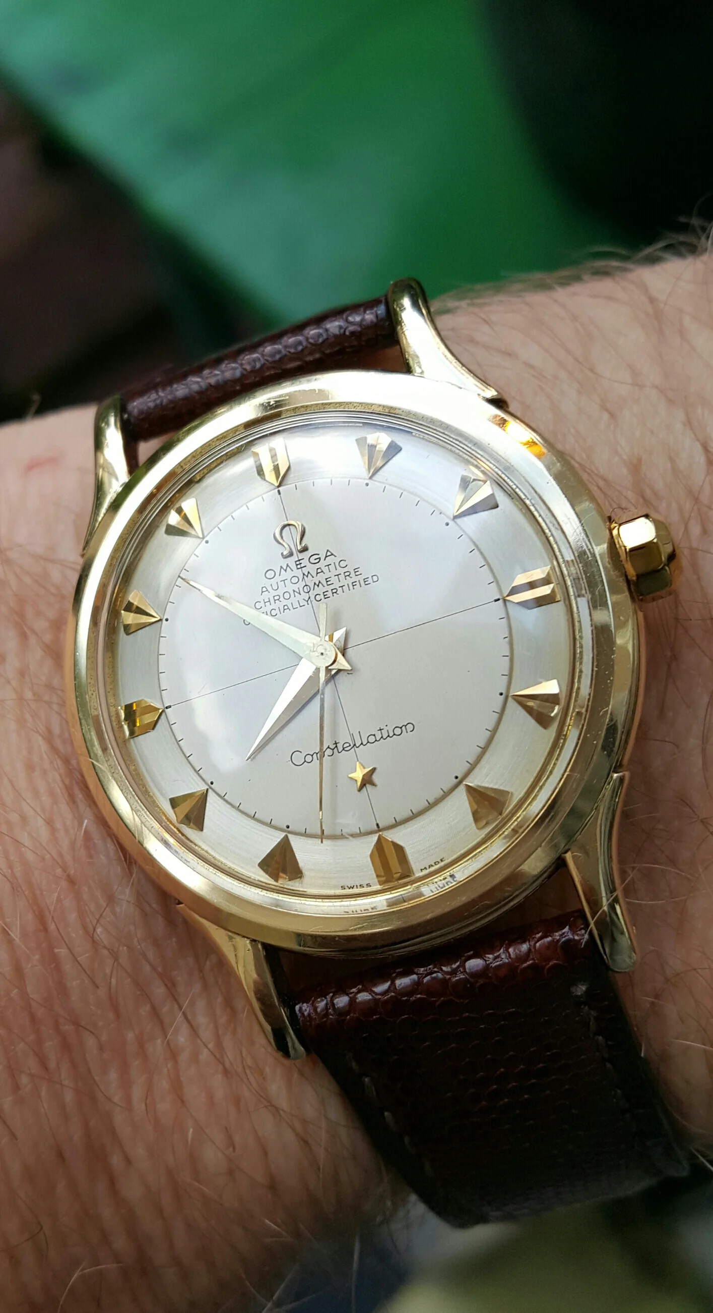

Here are two very clear white dials, domed and pie pan:

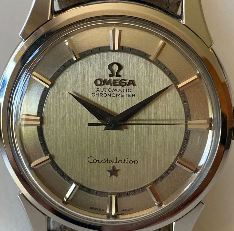

  • The 'domed' has the outer minute indication and long hands. No part of the dial is flat.
  • The 'pie pan' has the twelwe sided flat inner part, the twelwe flat facettes and the inner minute indications and short hands.

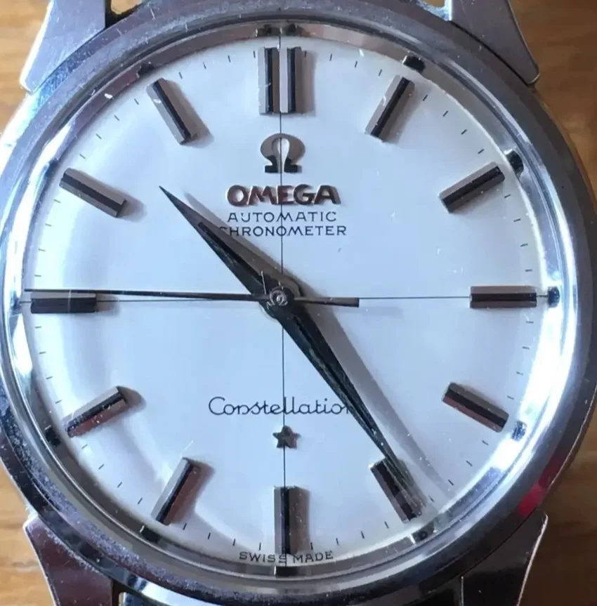

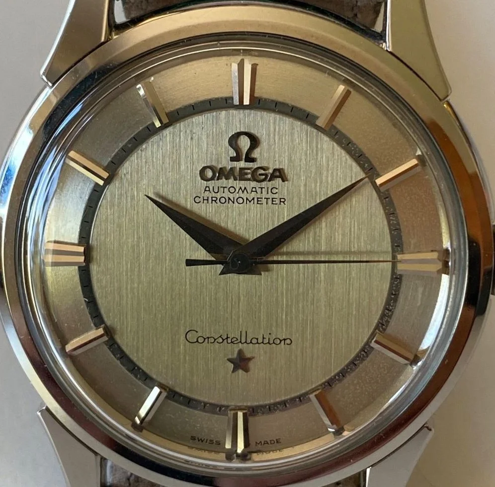

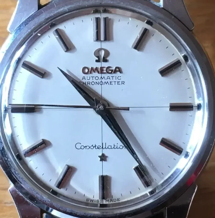

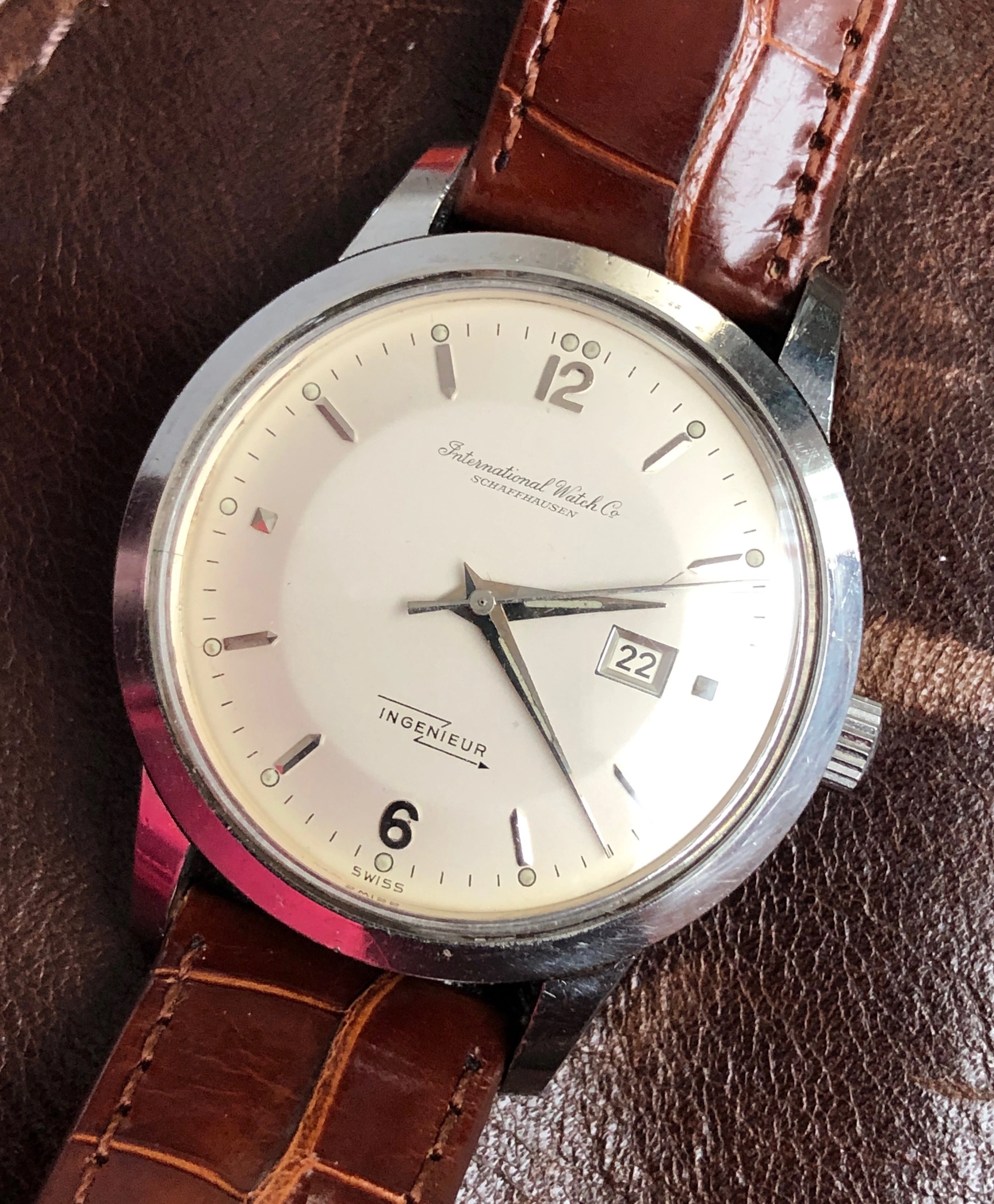

- But then there are, especially from the 50s, 'intermediates' with the flat inner part but really circelled, the domed outer part and the inner minute indication or even railway and short hands.
So I cannot name these as domed nor as pie pan. How do the experts call these?

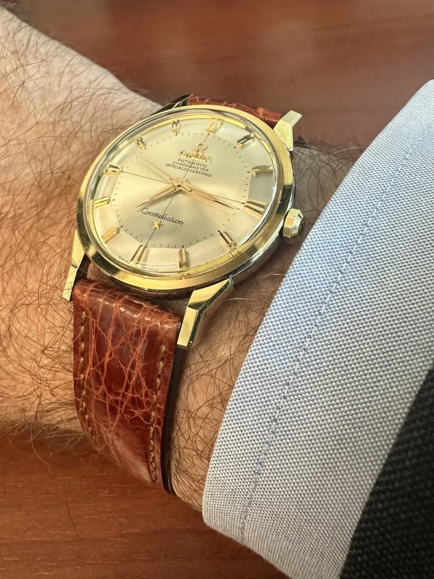

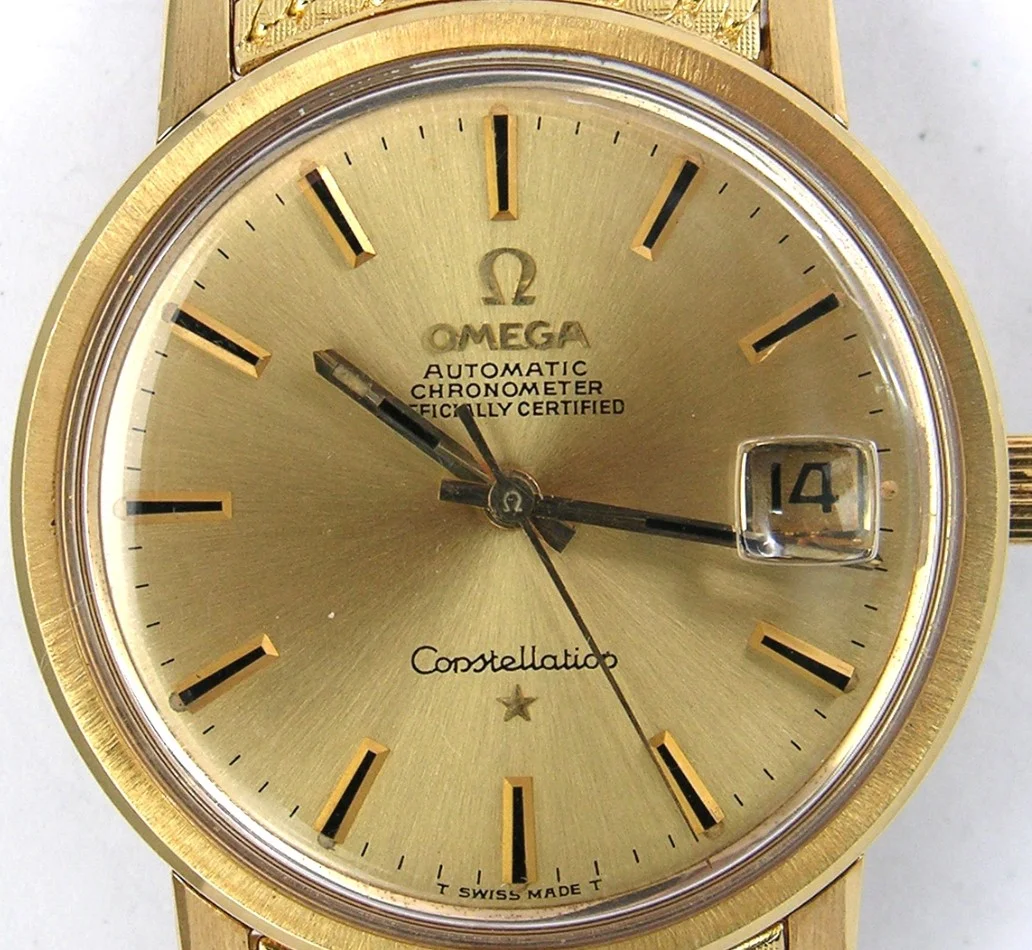

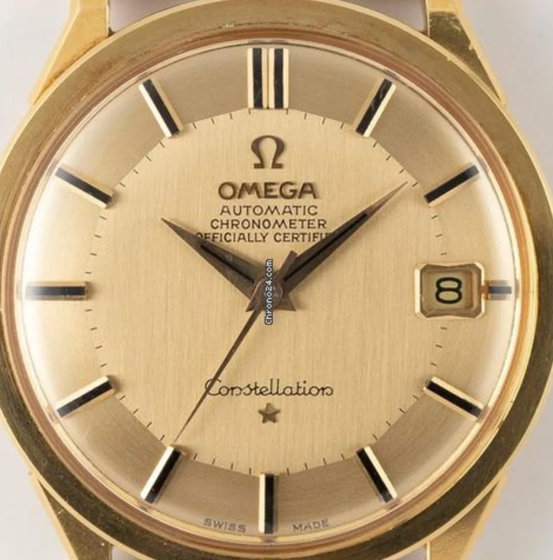

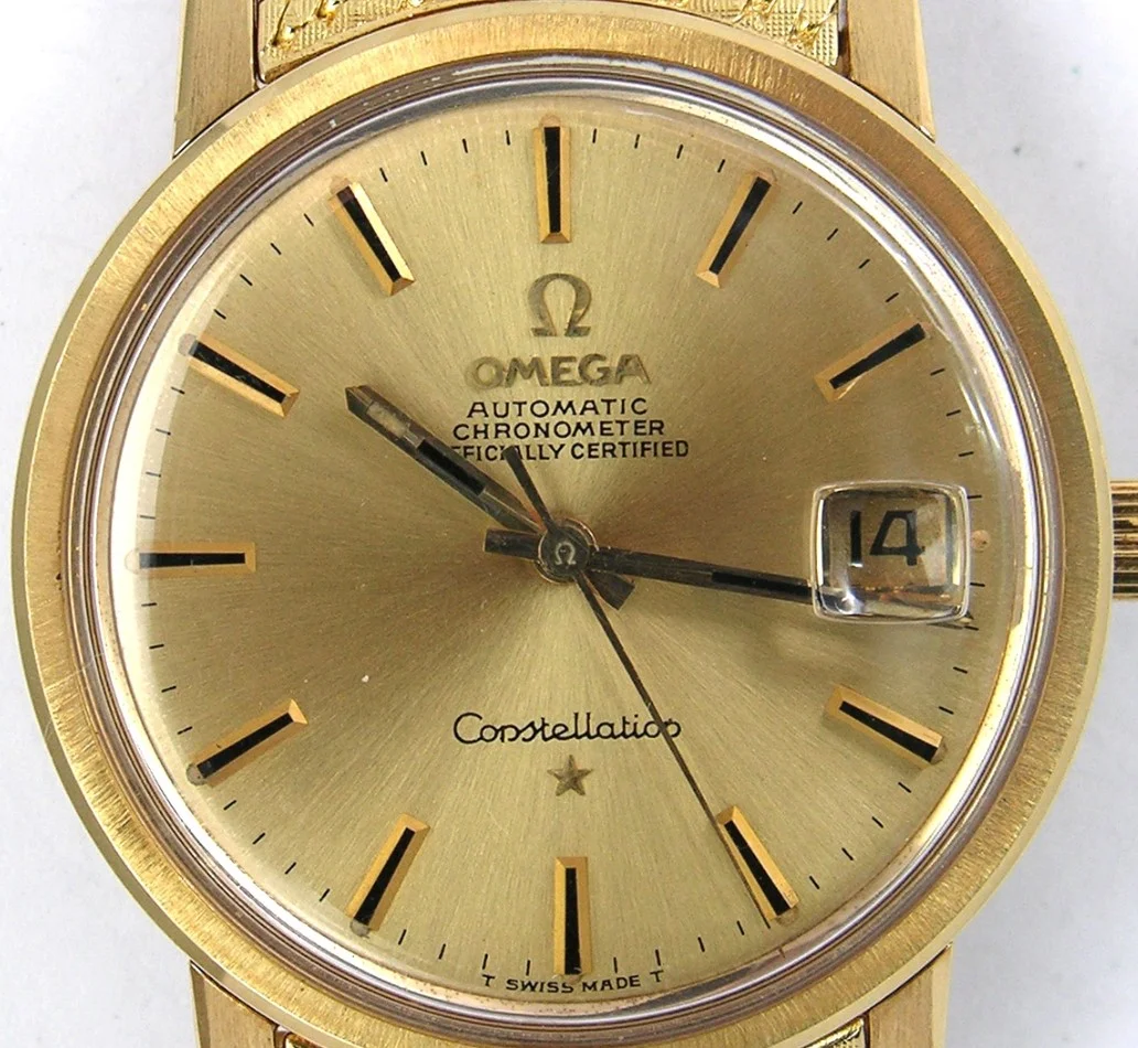

And here is a gold dial: domed or pie pan?
Even looking by a lens, due to the brushed surface I cannot say, wether the 12 facettes are flat or domed.
But the minute indicator ring has really 12 straight parts, so these 12 areas must be really flat (geometrically: two flats must meat in a straight line)
=> Is the straight edge the clear difference in the classification of pie pans??

The first one, 168.018 is easy - it is a flat dial, so not a dome dial.

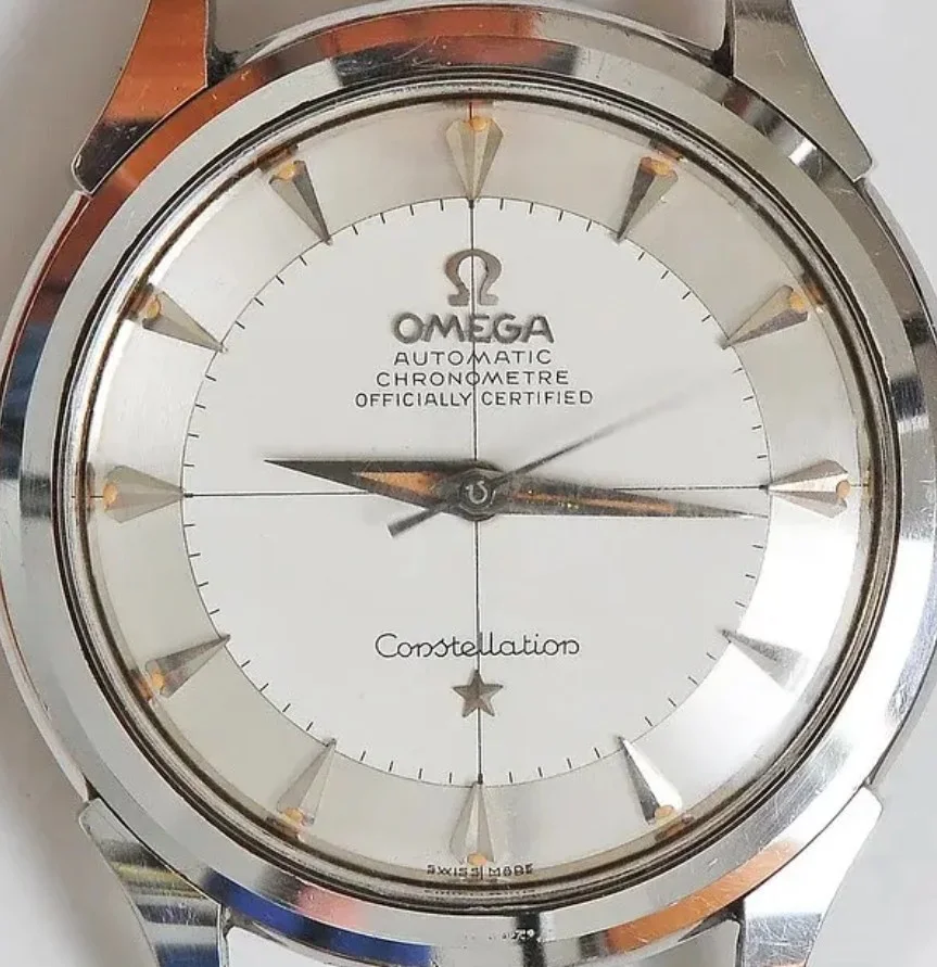

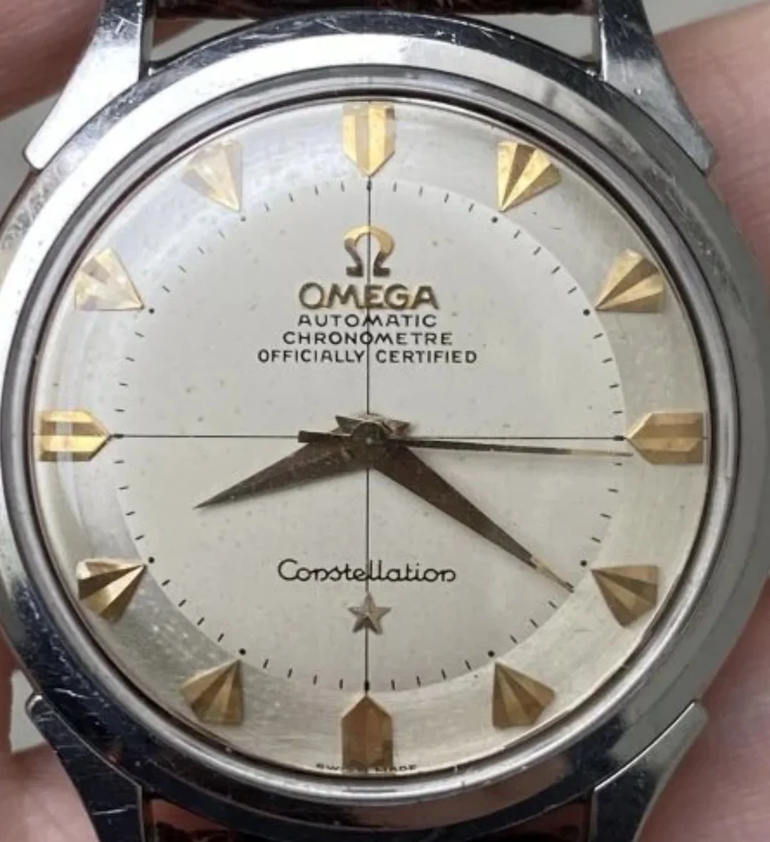

Your fifth watch is now known by most as a 'rail track' dial, so again not a dome dial

The simple accepted (by most) answer to a pie pan dial is that it has 12 faceted panels to the edge of the dial.
If it doesn't have that it is not a pie pan - no matter the length of the hands or outer edge treatment.

I would suggest that your gold dogleg is the latter.
One quirk of dome dials/ pie pans with cross hairs is that:
The cross hairs on dome dials go right to the edge of the dial (I.e. through and past the indices or numerals).
The cross hairs on pie pans stop at the edge of the central plane of the dial.

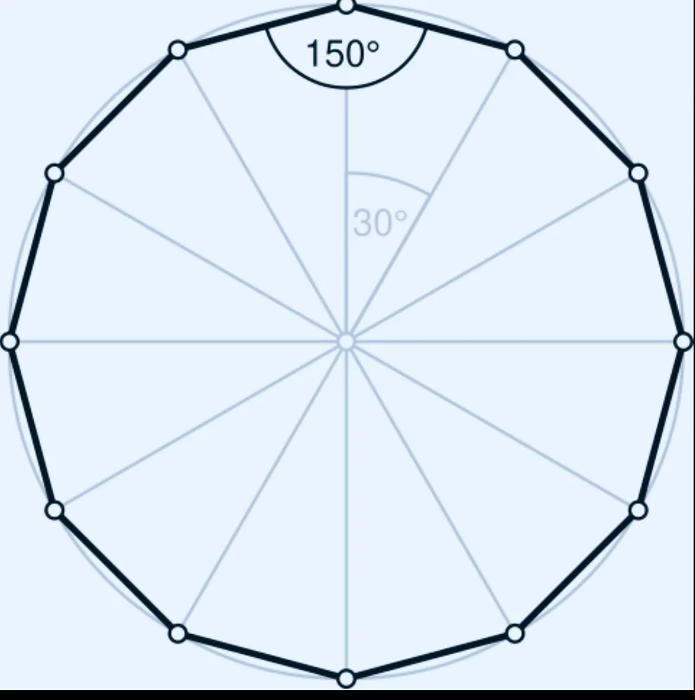

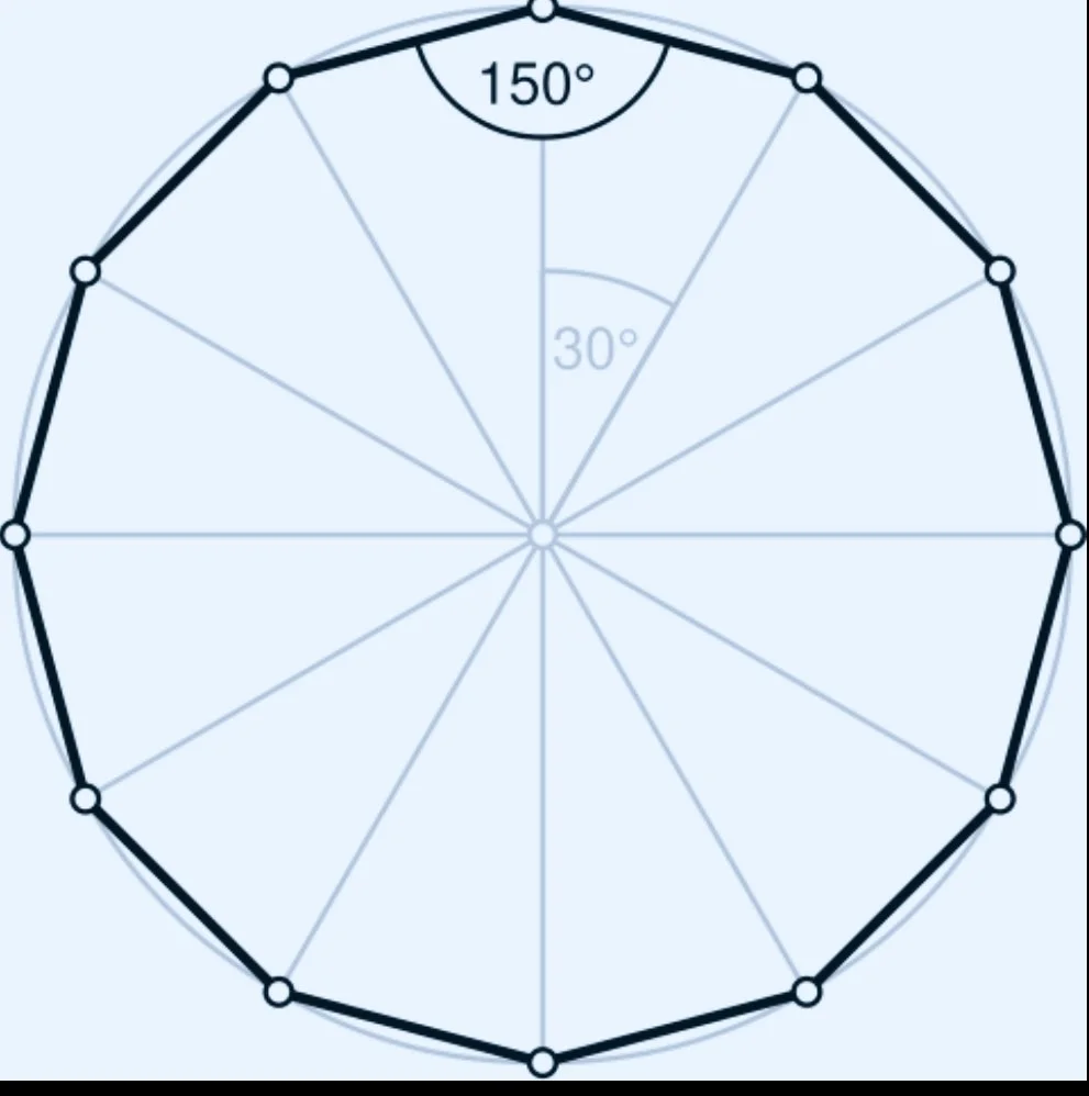

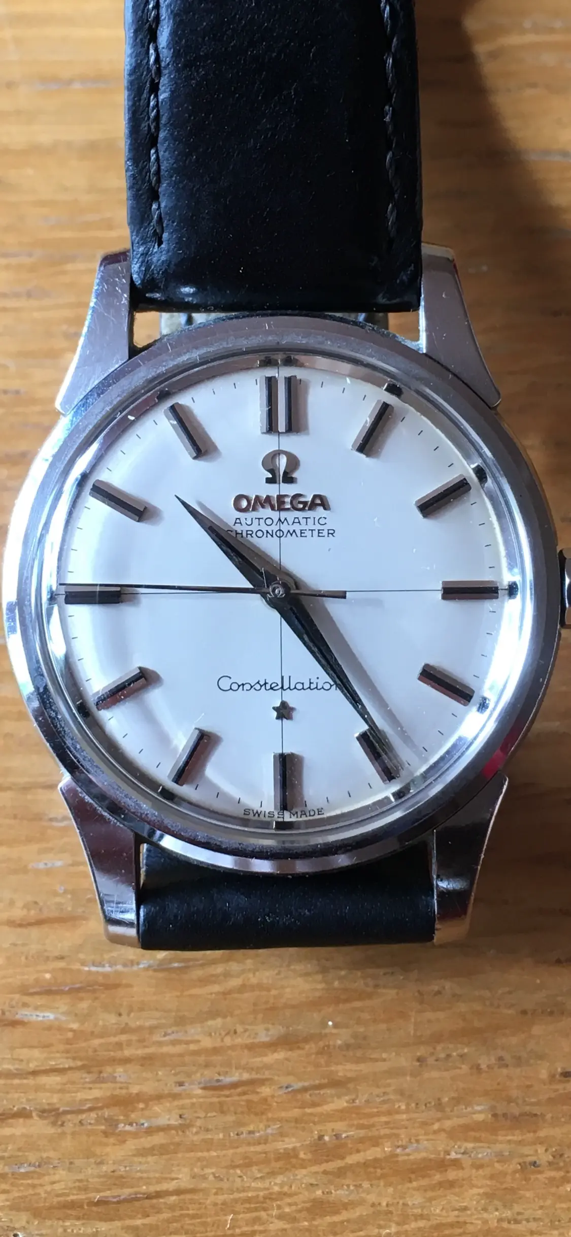

For my view, there is a simple method to decide wether pie pan or not:
  • The edge between a flat facette und the center plane must be a straight line, then its pie pan.
  • The edge between a flat center and a domed outer area 'must' be a circle segment.
You can easily see that in my shown watches 2 and 3 and in the drawing below.
But again, how do you call these 'intermediate' dial shapes (pic 3)?
Its definitively not domed, as the whole center is flat.
6,835
10,505
well, the only thing that you haven't shown is an agreed upon dome dial.
However, I would contend that there is no such thing as an 'intermediate' dial and the 'flat' dial you describe (pic 4 not 3) is in fact simply a dome dial with a paint effect.
This style of dial with a paint effect also appears on 168.004s

IMO, in general, pie-pan dials need not be 12-sided, but for Constellations, they are. Omega did not make circular pie-pan dials, with a sharp edge (discontinuity in slope).
I think you might also have missed an important point made earlier, which is that it can be very difficult to distinguish actual pie-pan dials from faux pie-pans.

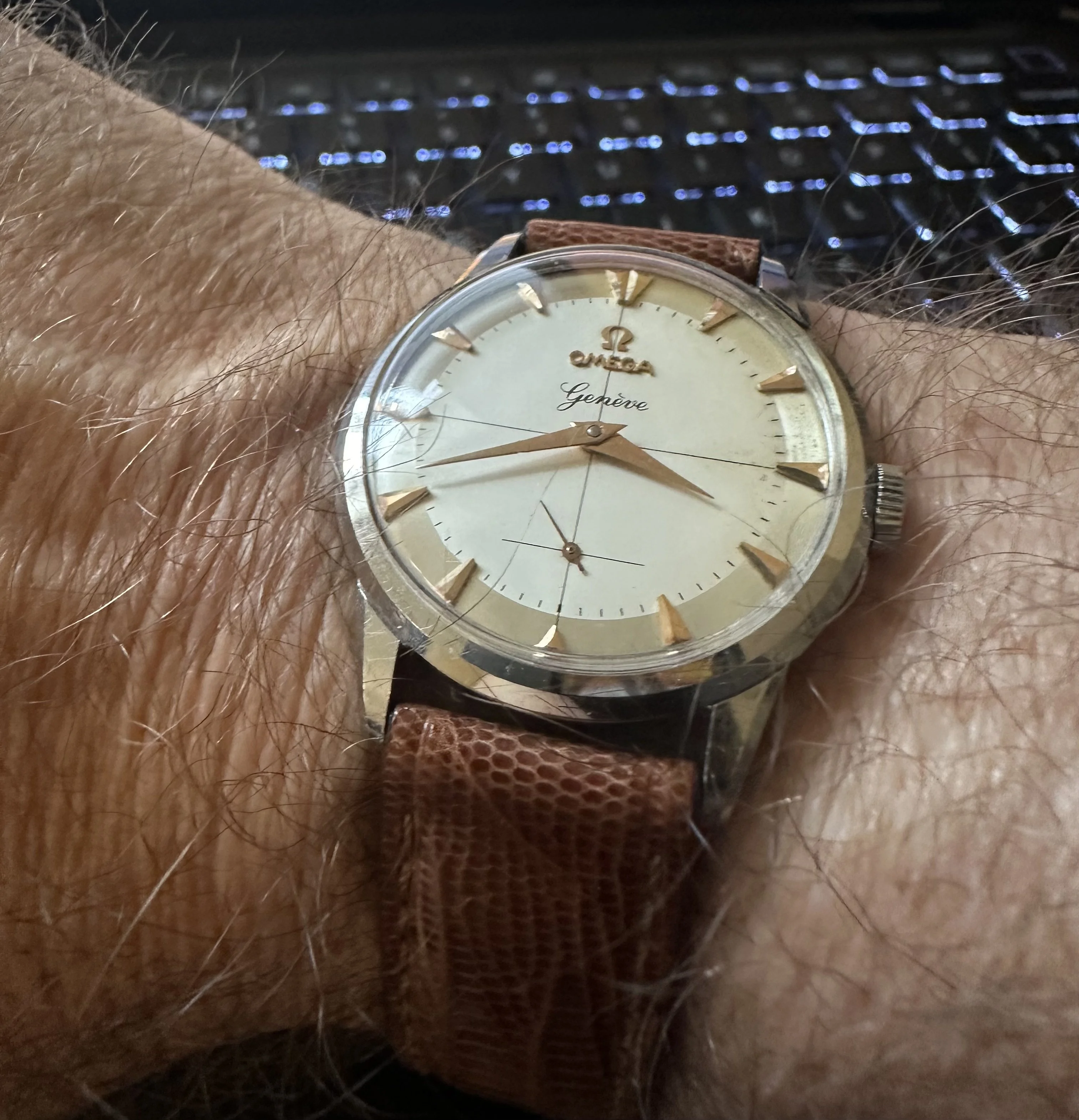

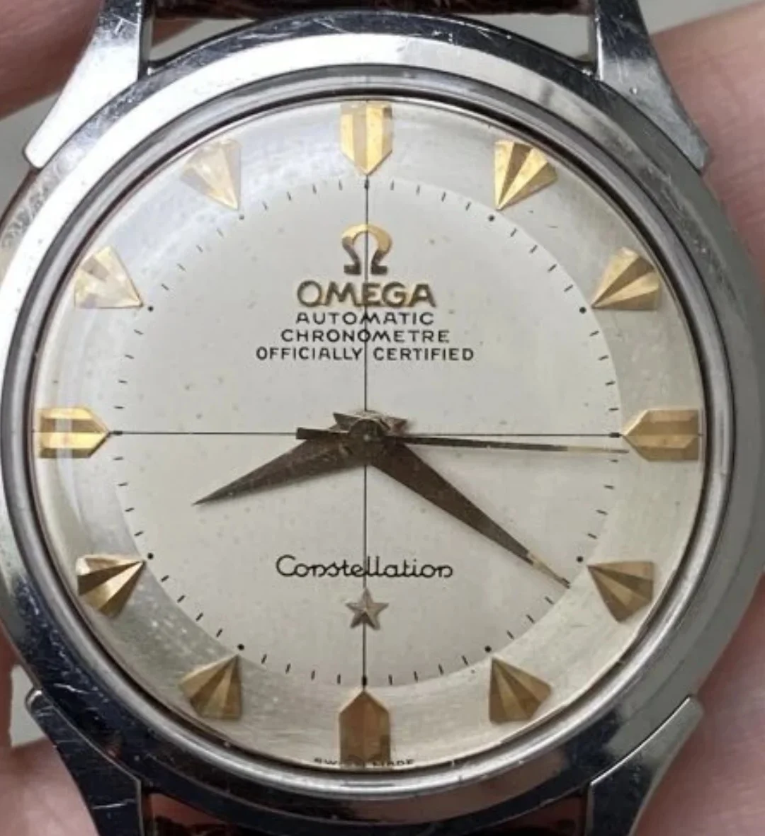

10,125
57,953

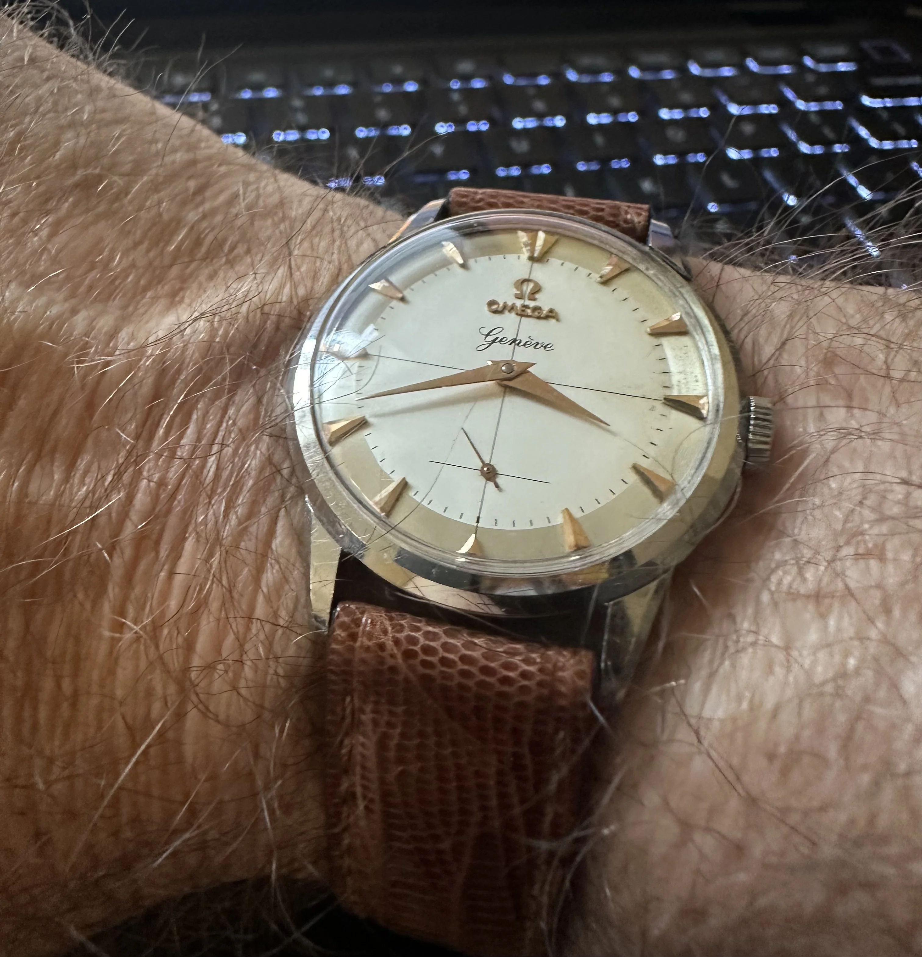

Here’s a good example of something that looks like a pie pan dial - especially from certain angles and in particular lighting conditions, but isn’t. My 1959 cursive Geneve reference 2903. Again, it’s the two tone dial that accomplishes the optical illusion.

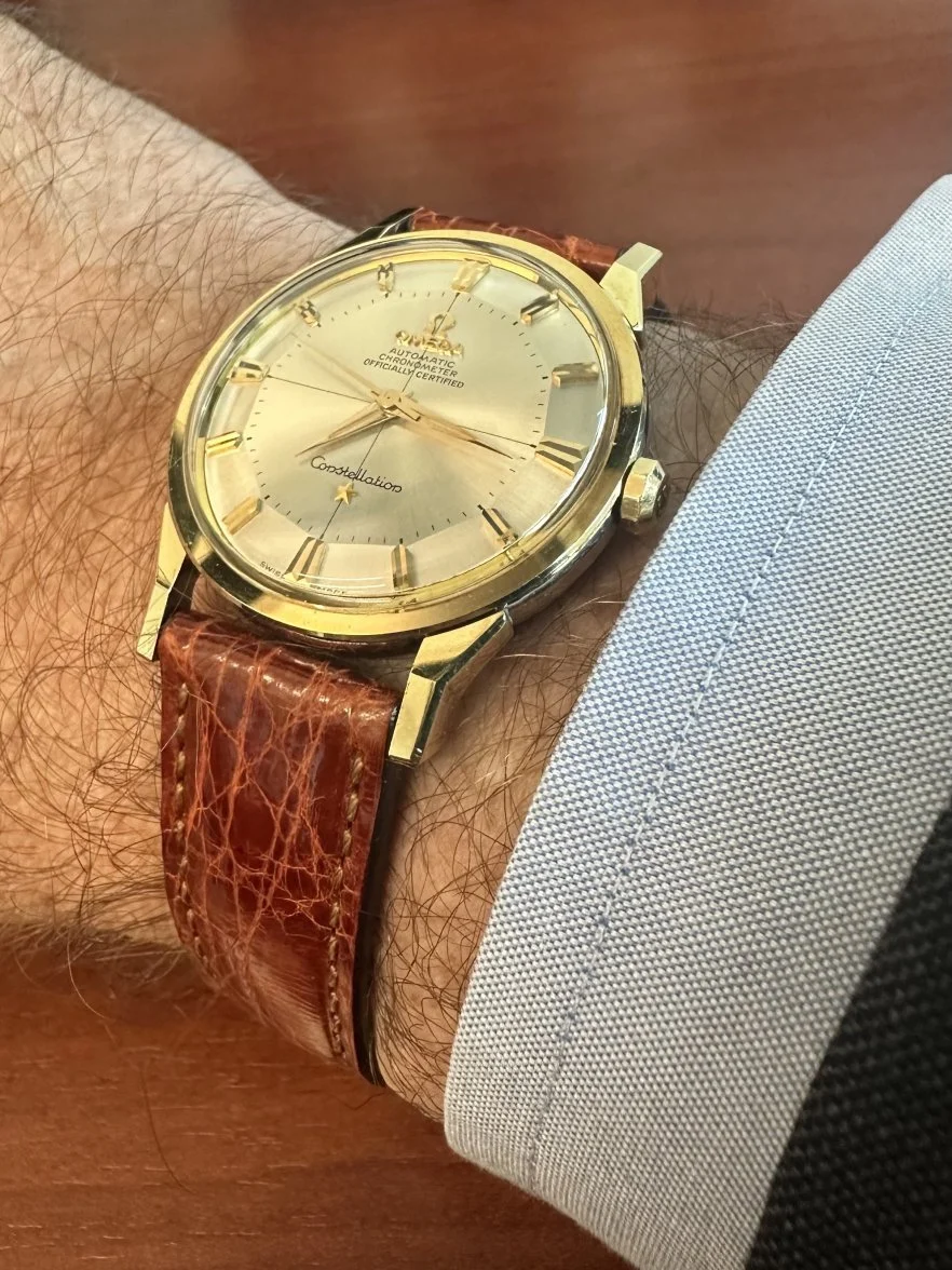

Now THIS is a pie pan dial. My 1962 dog leg Constellation reference 14900.
