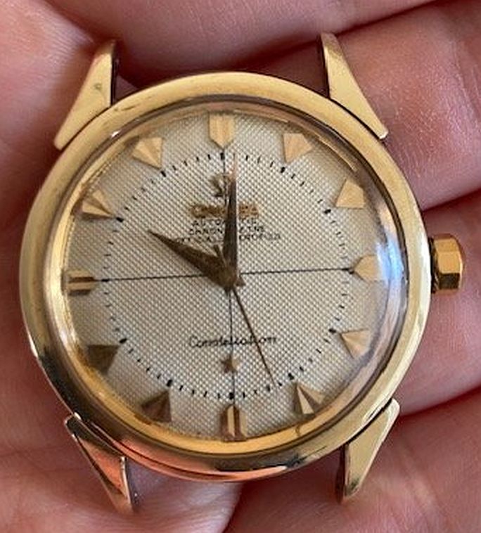

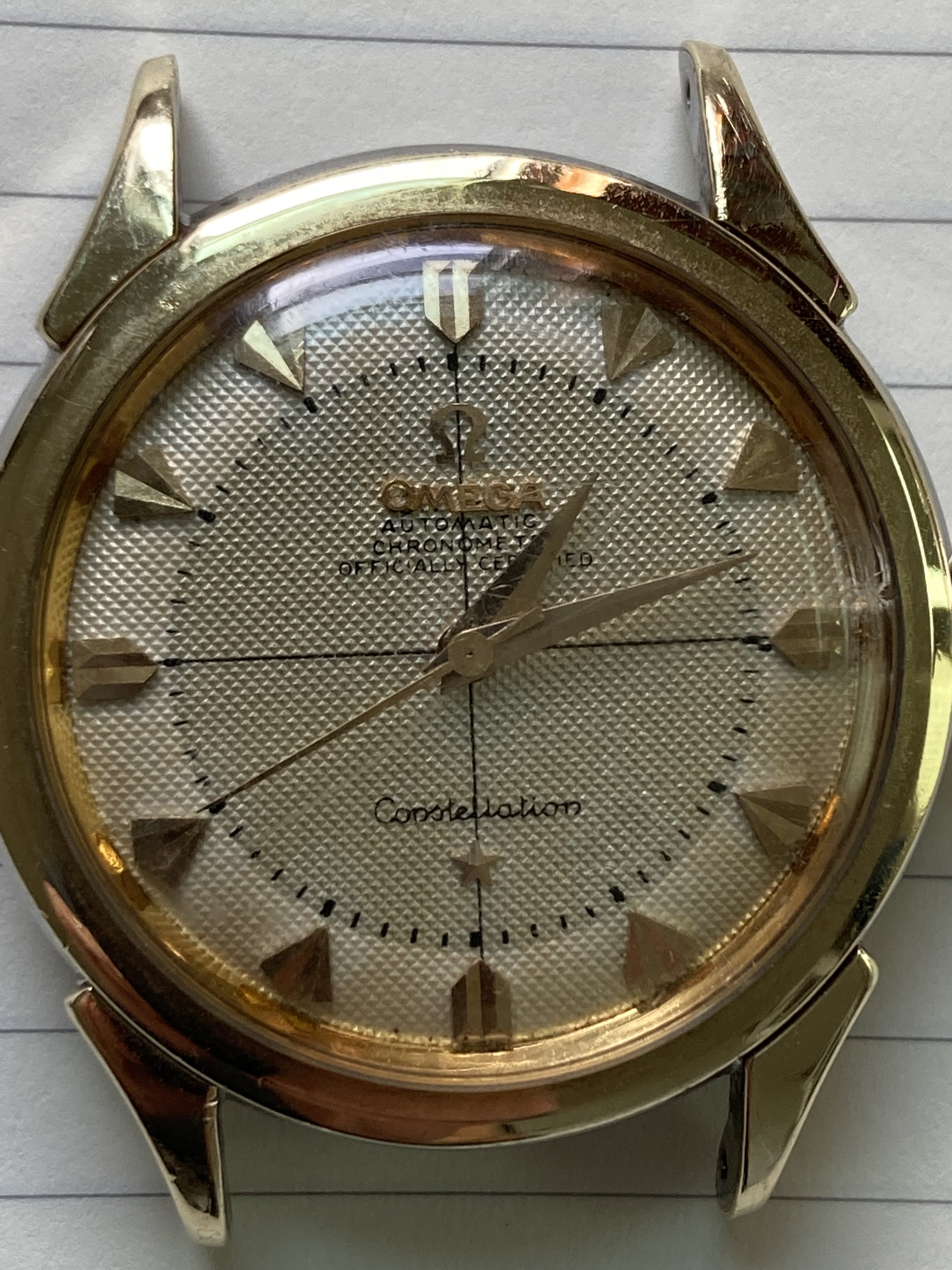

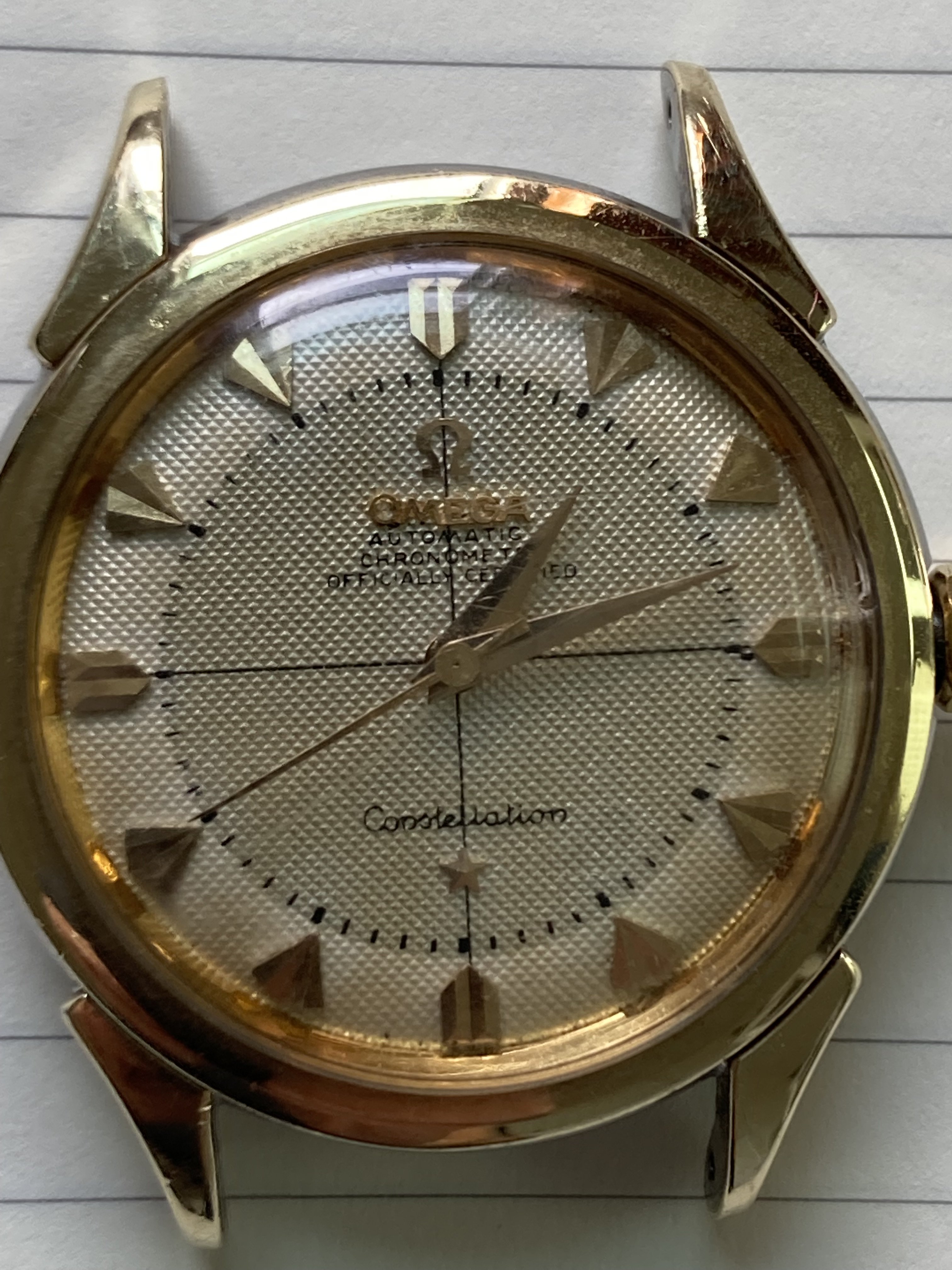

Hi everyone! Someone who is very knowledgeable about vintage Omegas suggested that the dial of a gold-capped? filled? Constellation I have has been redialed.
The watch has been in my family since it was purchased new in the 1950s, so I'm not sure when or where there was an opportunity for it to be redialed.
I do know that when the watch reached my hands, the OMEGA logo had come loose, as well as the seconds hand. Both have been restored by a watchmaker--though I'd say that the logo was not handled very well.
I'd be glad to have the forum's views on the dial. (And suggestions for where I might send the watch for a proper service--please feel free to PM me, if you would rather not post directly into the thread. If it helps, I live in Virginia.)
Here are some not-very-good pix of the watch:
376
1,204
I am not an expert but for me your pictures do not help me at all to be able to even make an option of the dial. I think you will have to try to make some better pictures. Regards.

The pictures are too low resolution for people to make a solid judgement. That being said, the line weight of the crosshair itself does look a bit heavy. And waffle dial don't lend themselves well to accurate printing but it looks like the minute track is slightly misaligned with the applied hour markers - though again these pics are too small to be sure.

I am sorry, but I agree with your expert's opinion. The text is not crisp enough and the minute track too heavy and uneven.

The photos are not good, but the way the vertical crosshair totally misses the painted marker at 6 o'clock is still pretty obvious.

Yup, I’m afraid even with that blurry picture it’s beyond doubt a redial. The Constellation script is also off, the straight n recognizable (and incorrect for the period), as well as the aforementioned points and general print quality.
It’s not uncommon for one of these to have been redialled during a service long ago. But hey, it’s still a family piece, which is wonderful. I’d still wear it happily.

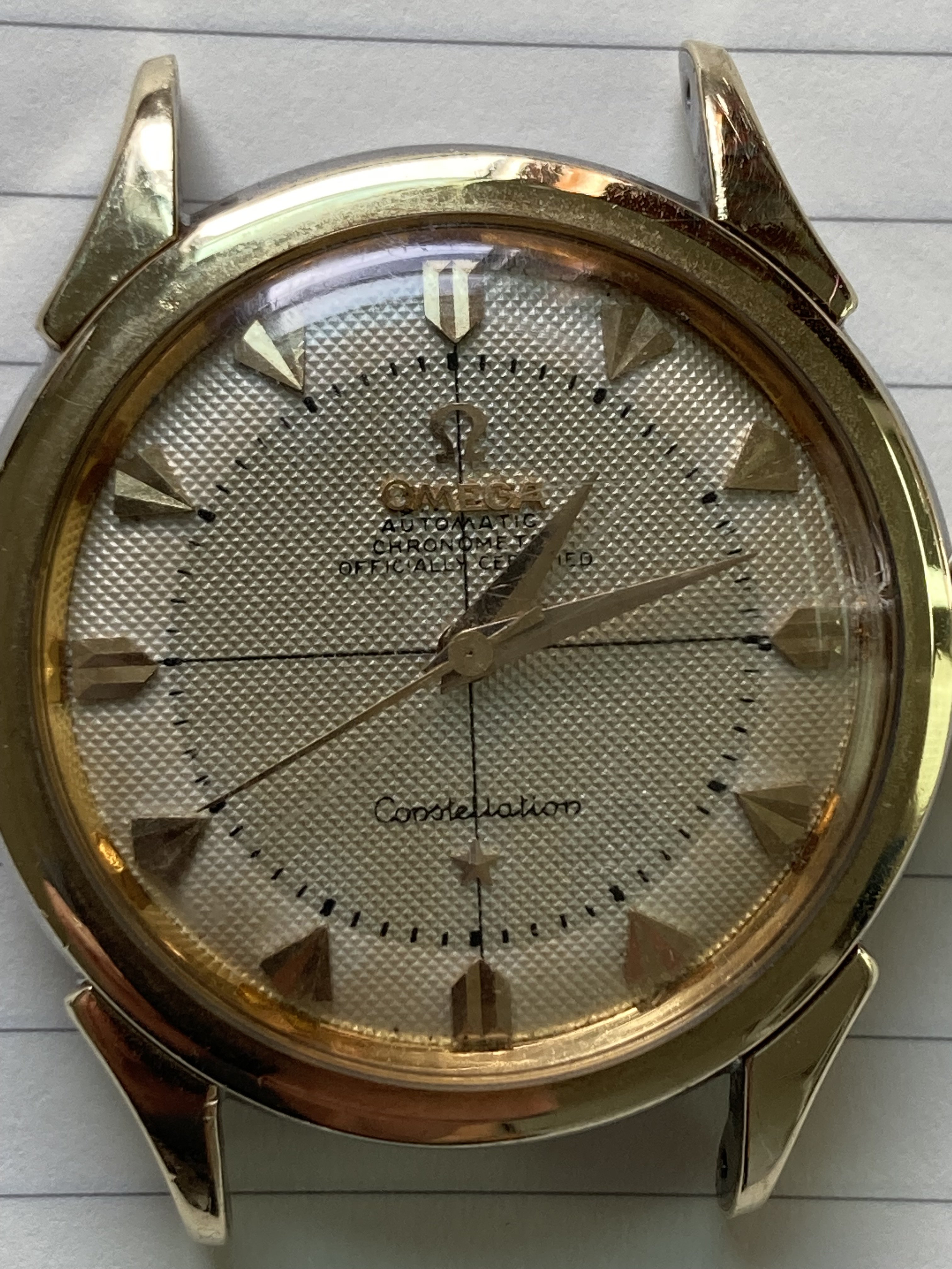

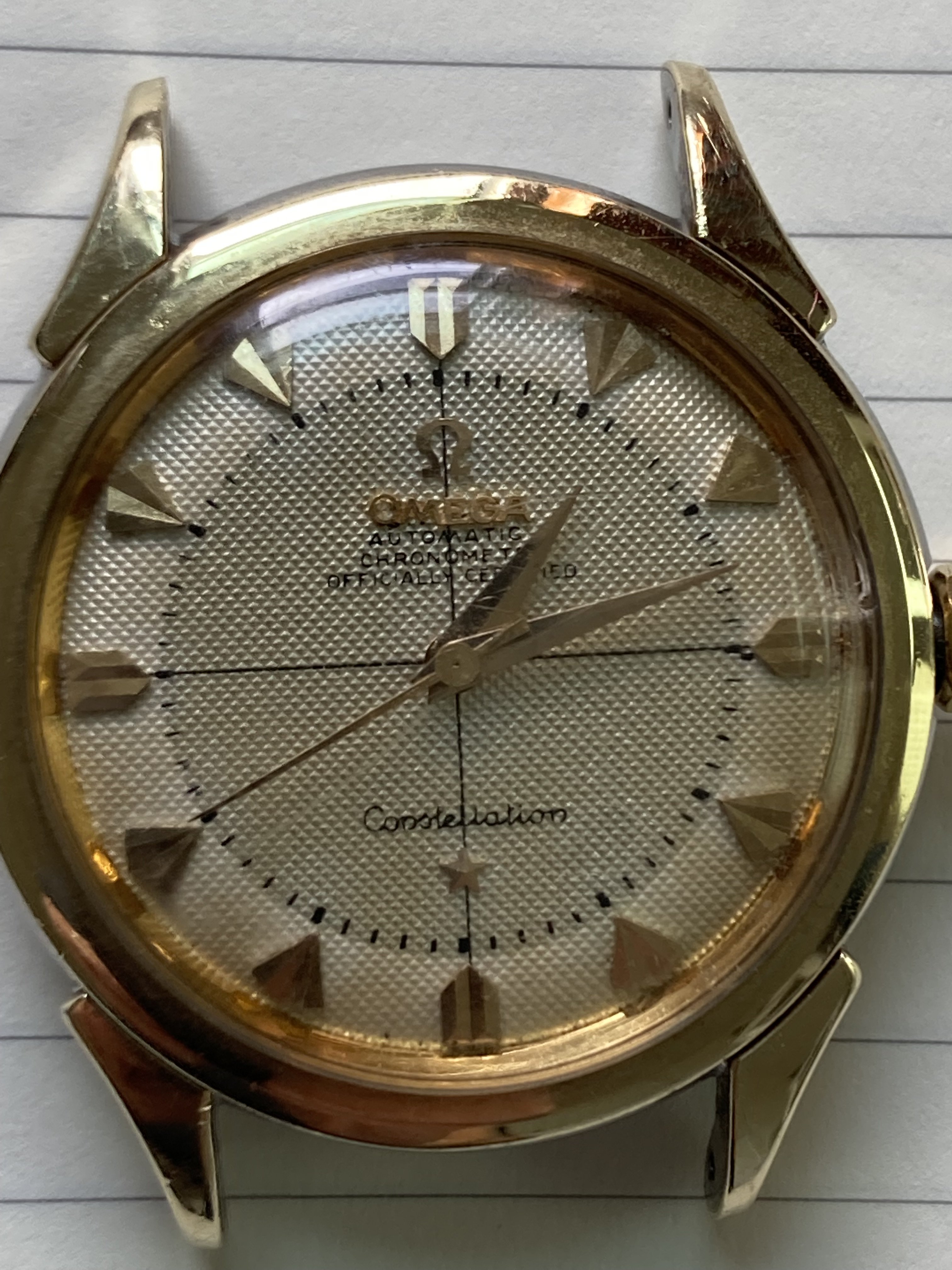

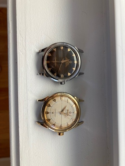

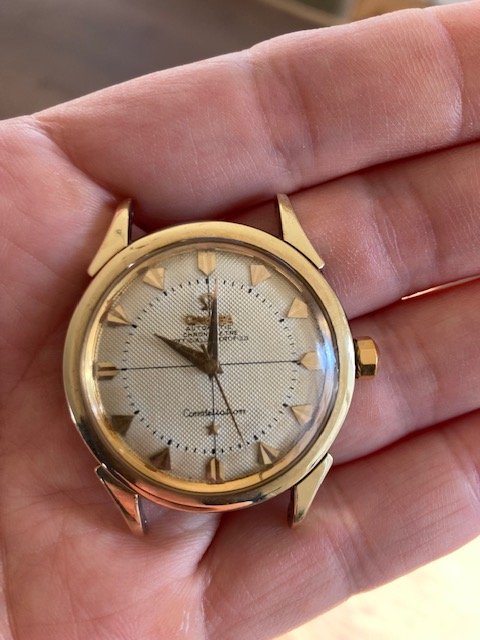

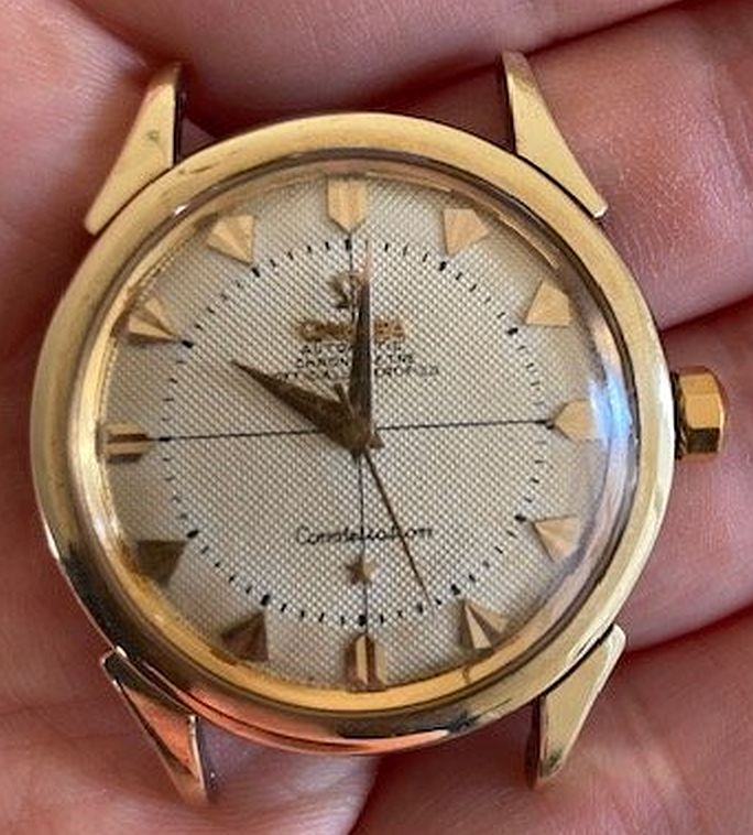

OK! Here are what I hope are some better pictures of the gold-capped watch. I feel pretty persuaded by everyone that the dial was "redialed" (is that the right word) at some time in the past. But maybe these images can confirm this?
If it turns out to be the case, oh well. I'm still hoping to get the watch properly serviced, and on a nice strap.

Ah! well, that's too bad. 🙁
But as I look at it, it makes sense. So, back in the day (whenever that was), if you sent your watch in for a service, the dial would be redone as a matter of course? It does look a bit sloppy, doesn't it.
