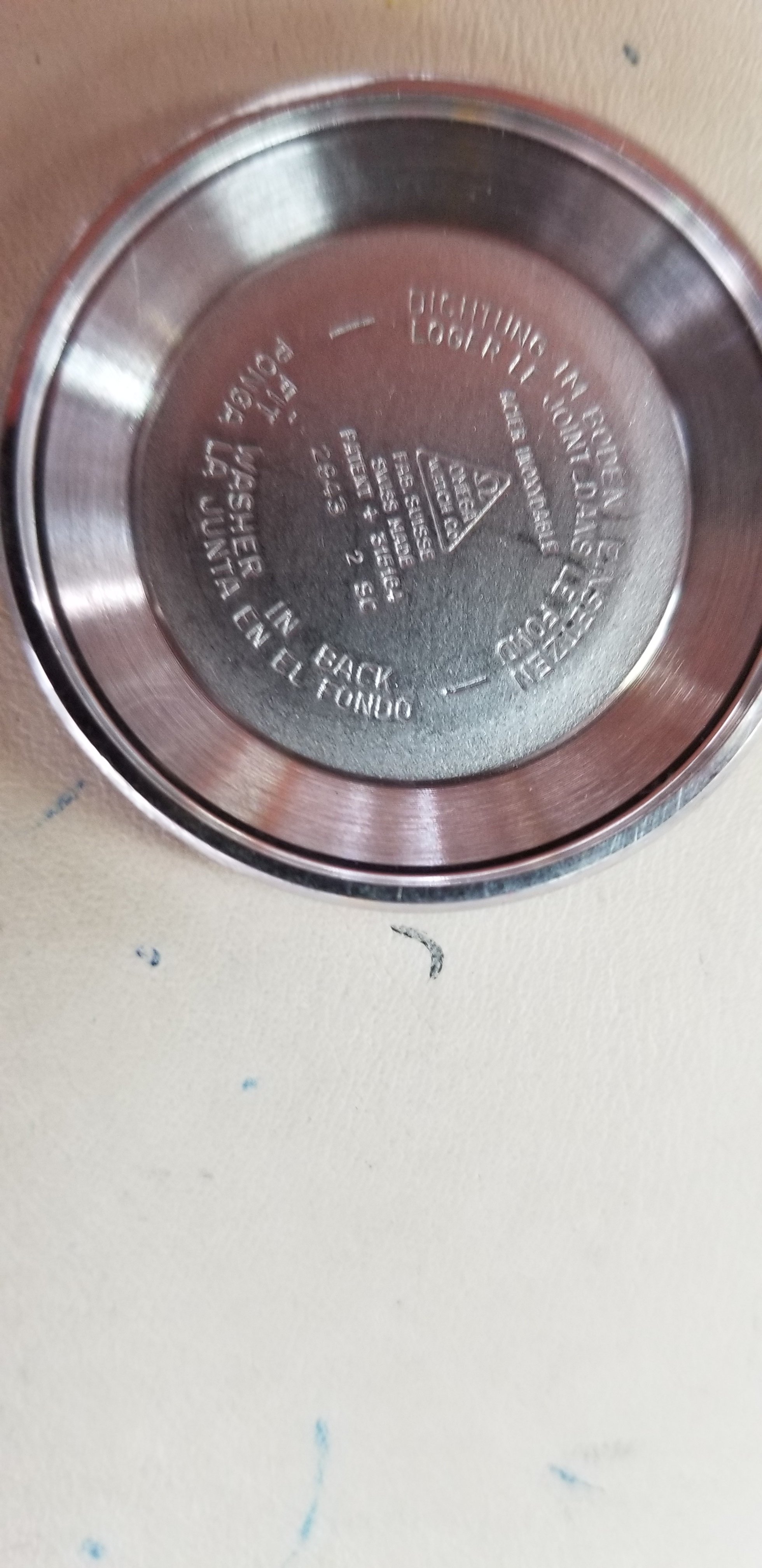

The case number is the identifier for the watch. It identifies most things except, sometimes, variations in dials and hands.
You can also consider it part of the model number for vintage Omega watches. For example, your case number, 2943, in combination with a metals code, identified the watch and type of case, for example, a CK 2943 is all stainless steel.

A calibre 504 is correct for a 2943 reference. AFAIK the 504 is only used in Constellation Calender references, so I'd wager your movement is original to the case. As for the rest of it, pictures are needed before anything else can be said.

The case number doesn't have any letters in front of it.
2,326
1,887
Thanks for the replies. I'll take some photos and post them.
I'm sorry for the confusion. The catalog number has the letters, they don't appear in the caseback.

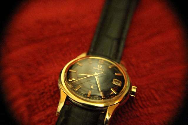

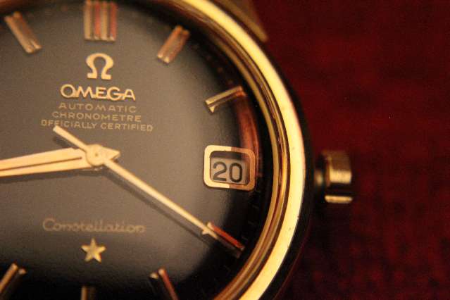

My watch has chronometer spelled with "re" at the end, which I understand is one of the variants consistent with the 1957-1958 time period the watch was made. However, I'm pretty sure it is a redial.
160
117

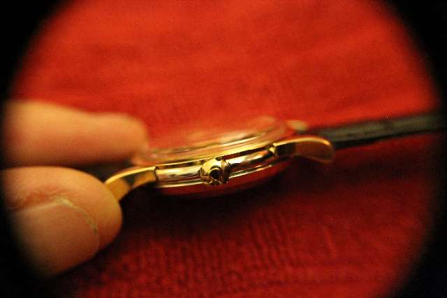

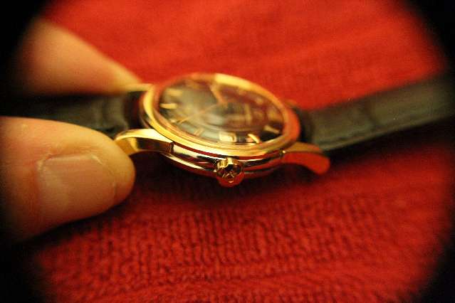

A couple more photos. I tried to capture the Omega logo on the crystal in the second photo.
6,685
11,654
Redial for sure. Strap and buckle don’t look original as well.
160
117
I thought the strap and logo looked kind of clunky.

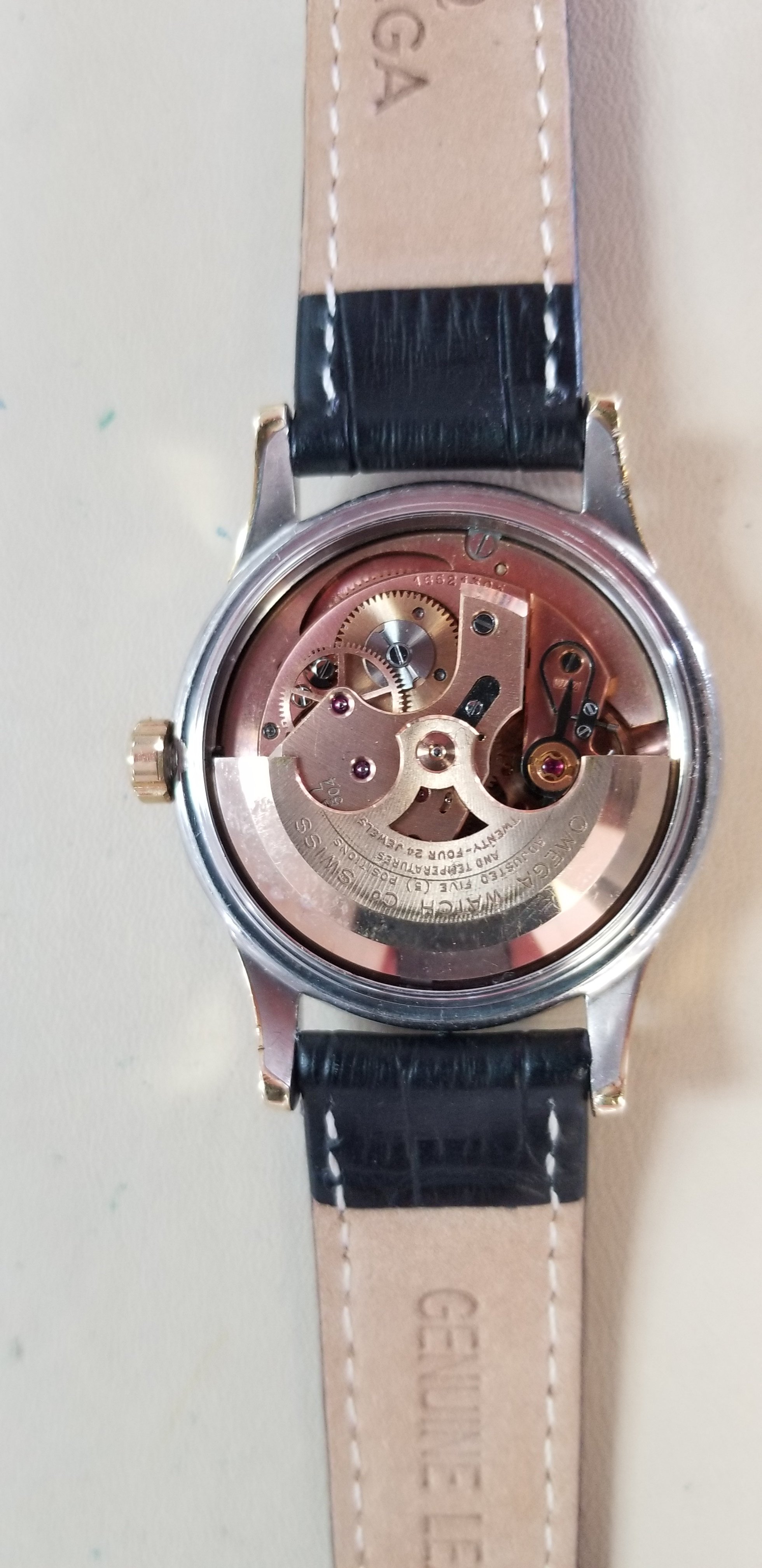

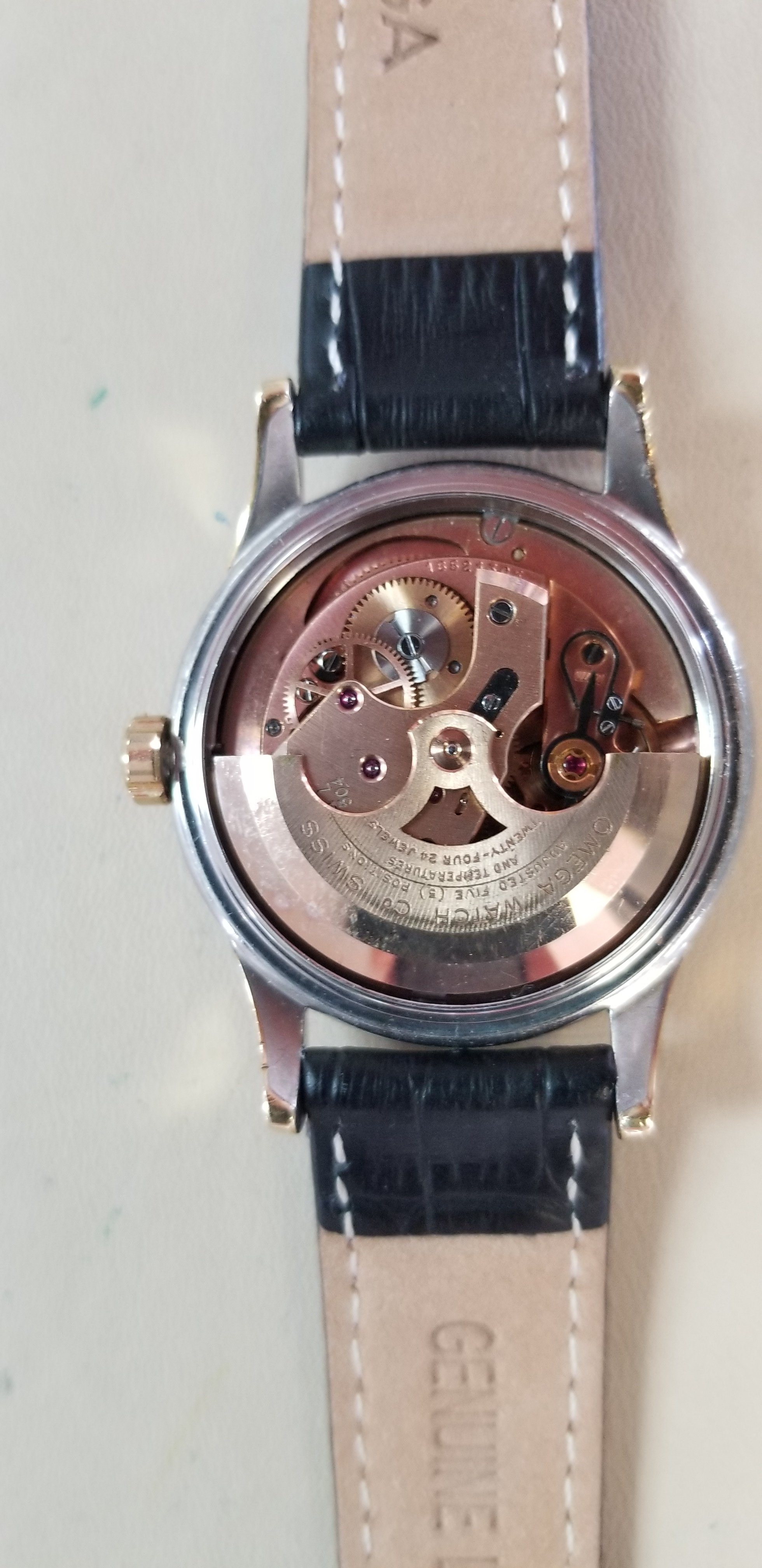

Here are a few of the movement and inside case back.
160
117
The movement parts are all the same color. Photos contain some light distortion.

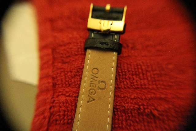

Located a stamp on the inside of the buckle “ACIENOX” with a box containing the Omega logo and the word “SWISS” beneath the box. Likely an authentic strap and buckle but not original to the watch given it’s obvious like new appearance.

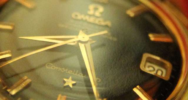

As far as the dial, I see no glue or solder marks around the hour markers or applied Omega and logo. Interestingly, from what I’ve read, the date surround on the older Omegas such as this had rounded corners and raised convex edges lined up with the curve in the dial consistent with the date surround on this watch. The calendar numerals appear consistent with examples I’ve found from the era. The word “CONSTELLATION” appears to have the correct serifs and font that I’ve seen on watches from this era. The star, however, although dimensional (raised from the dial) does not have bevels seen on other examples, and I’ve heard this referred to as hand made. And the words SWISS MADE are on opposite sides of the 6 hour marker as opposed to below it. And , of course the color/surface of the dial is not what one would expect from this vintage watch. Any way to tell by appearance whether the dial is an original refurbished dial or a replacement dial?

I’m sorry, I do not believe the strap or buckle to be authentic.
By looking at the back of the dial, if the original dial then there would be some marks consistent of Omega dials from this era. But it doesn't matter one way or the other really, a redial remains a redial and no-one cares whether it is on the original dial metal or a new blank.

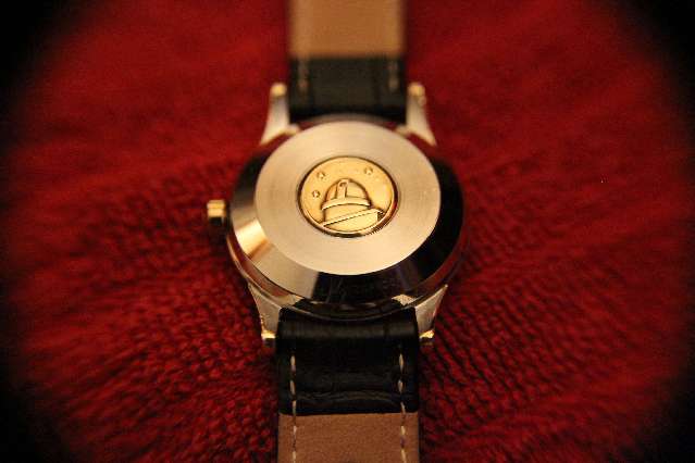

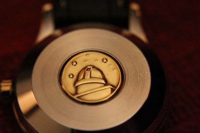

For comparison - the same model also gold capped that was hardly worn:

Thanks for your input, Tom. I'll take your opinion over mine on the band/buckle. Now I can go out and get one I really like.
