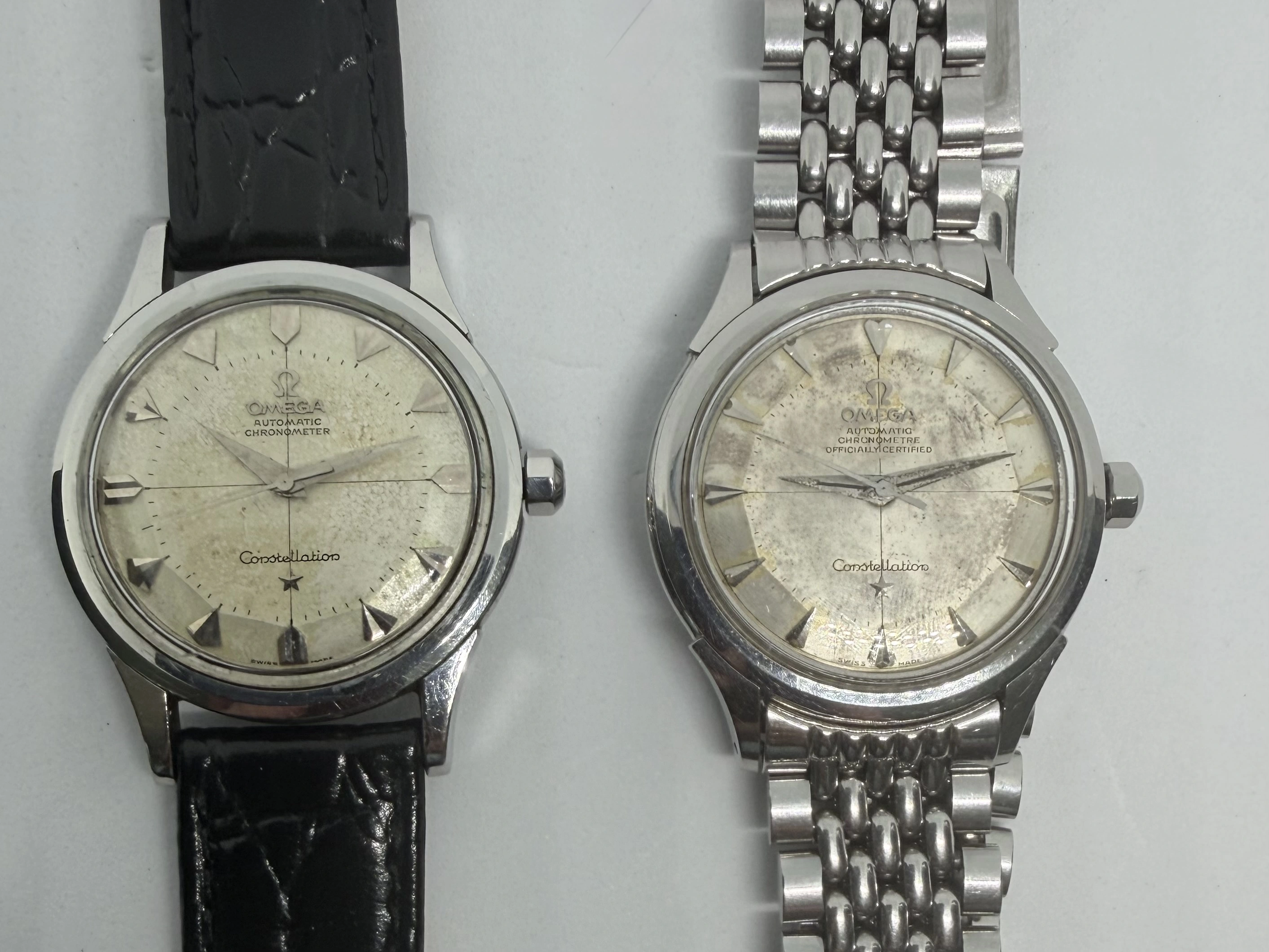

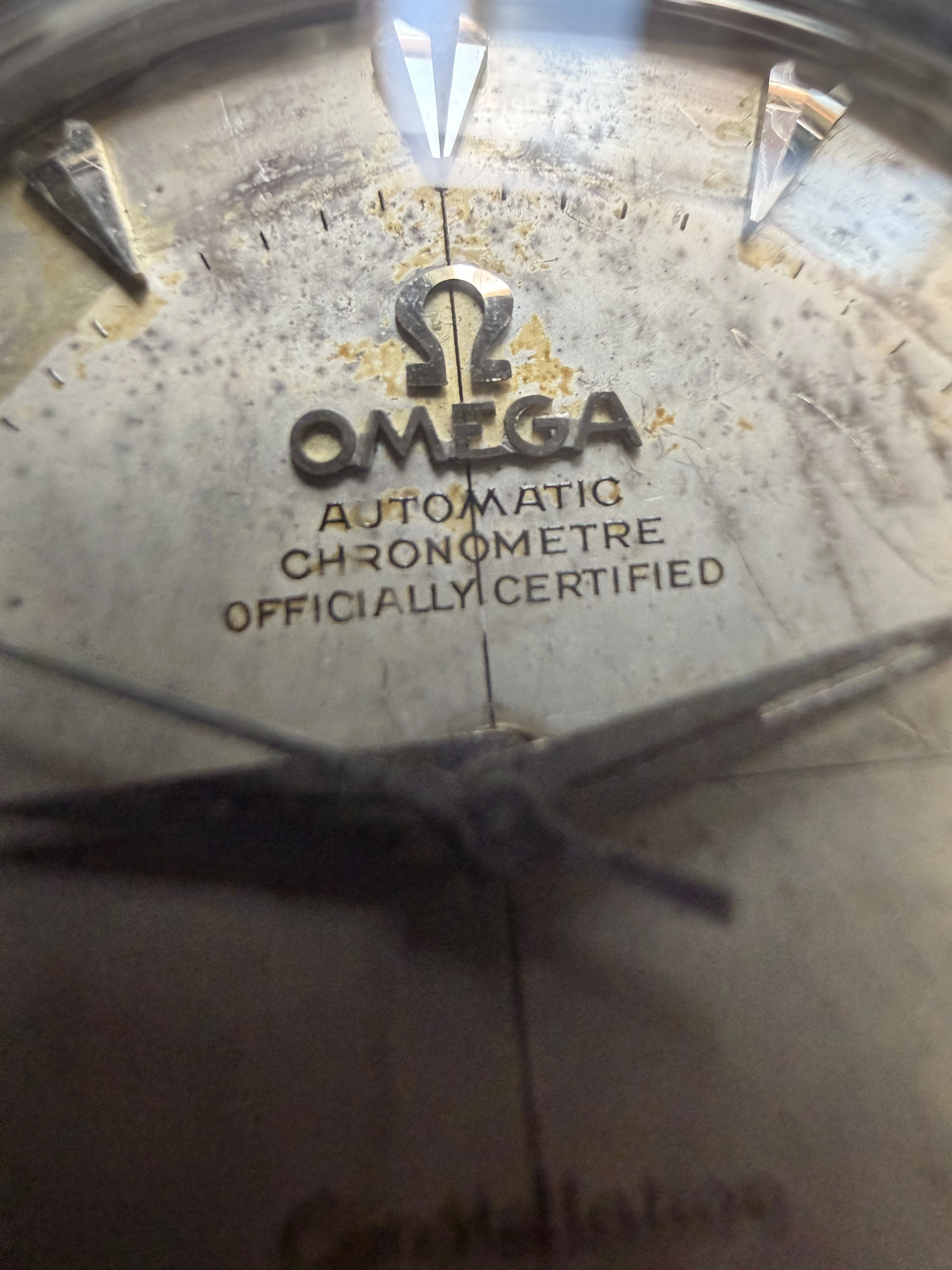

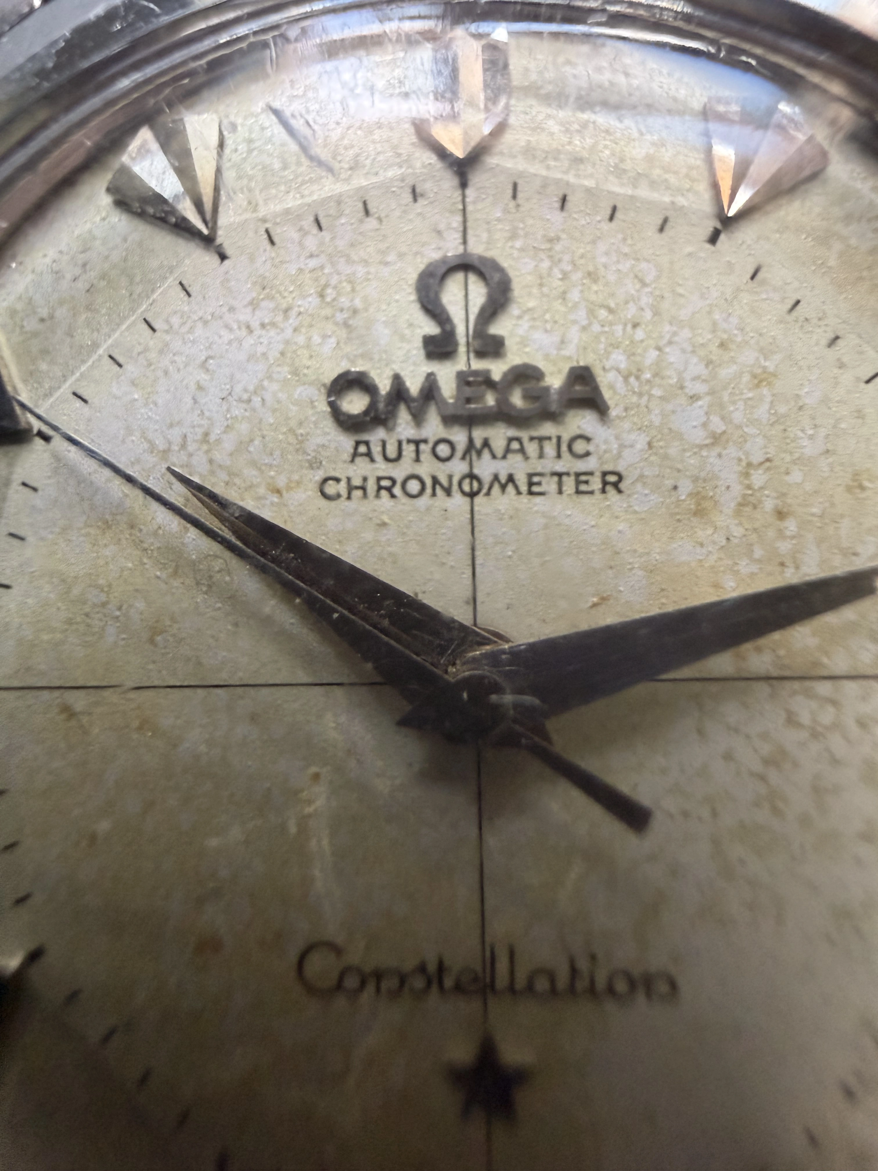

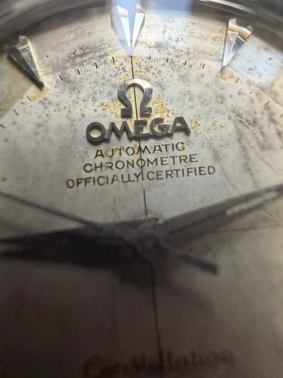

Hi all,
Question on the 2852 reference. Been seeing a few with only automatic and chronometer lines.
Safe to assume a redial? I’d expect the officially certified and possible chronometre spelling?

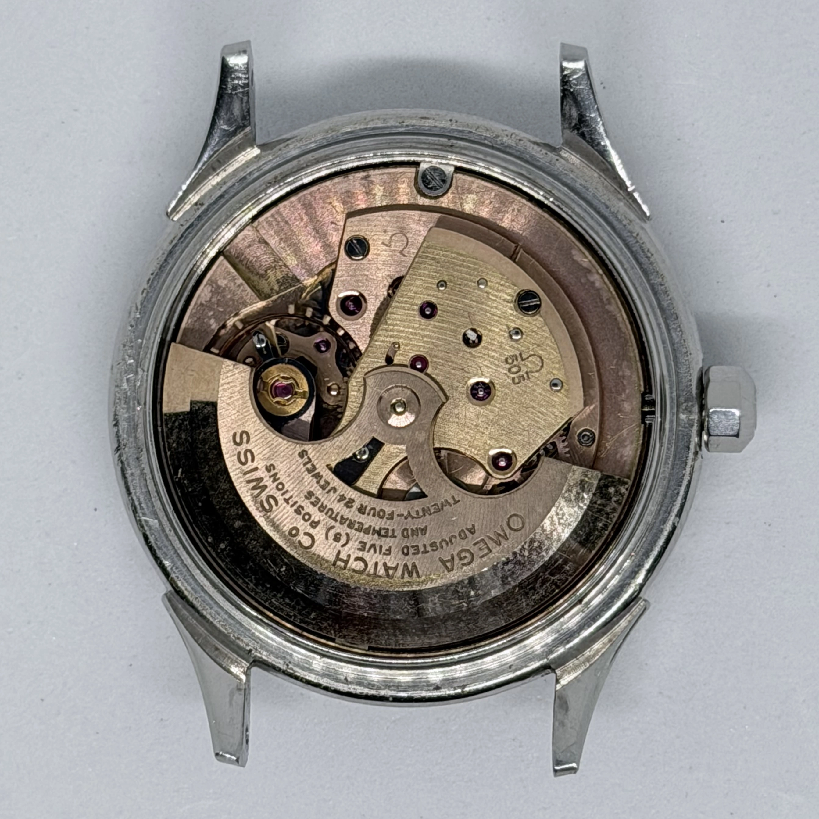

As far as I know the vast majority is with the RE spelling. But a few late examples have ER. There was an example posted somewhere in the middle of the aforementioned 2852 thread with the ER spelling.
13,519
18,808

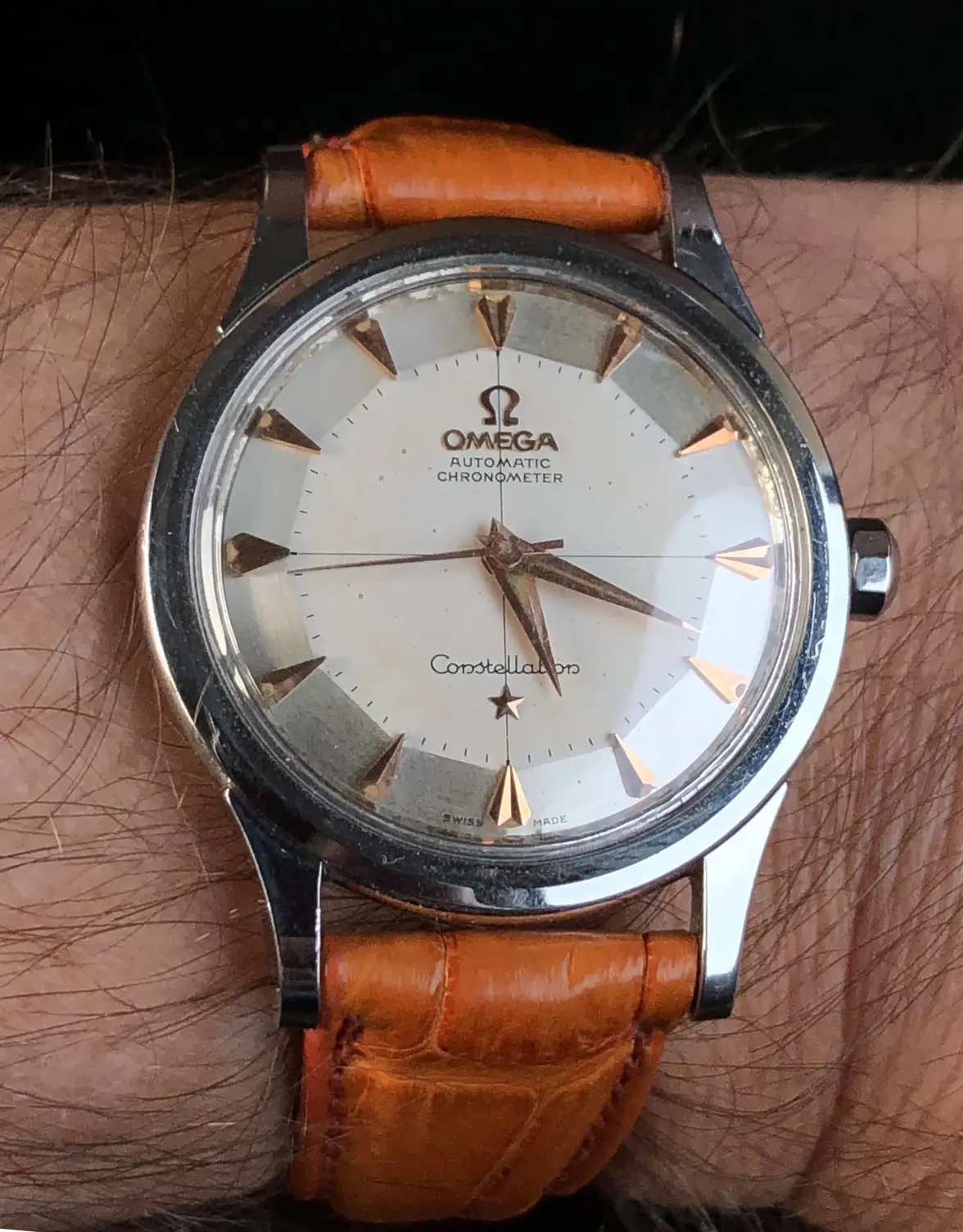

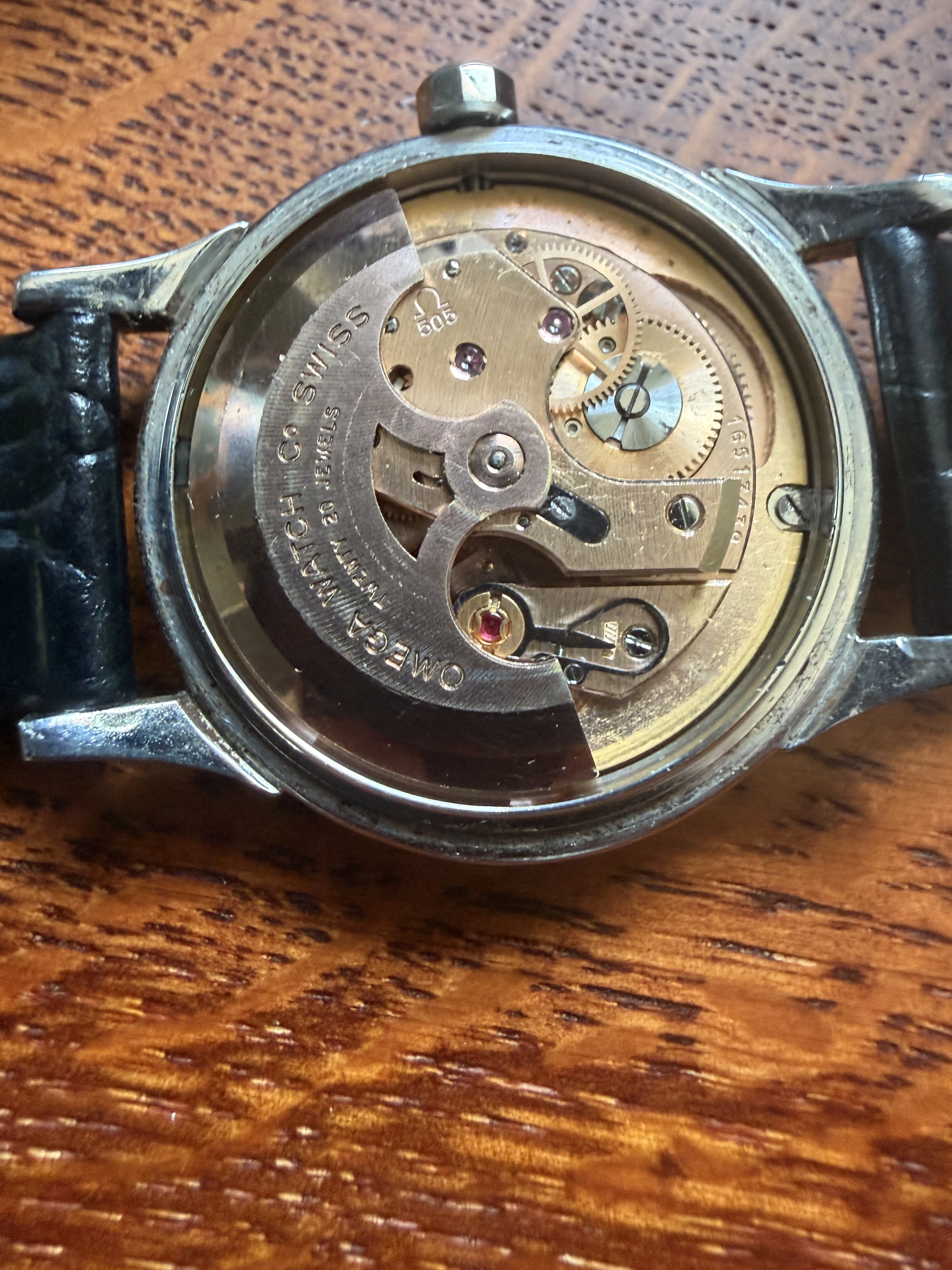

This is it:
This would be a very late Ref. 2852, at least a 16.5M serial number on a cal. 505 movement.

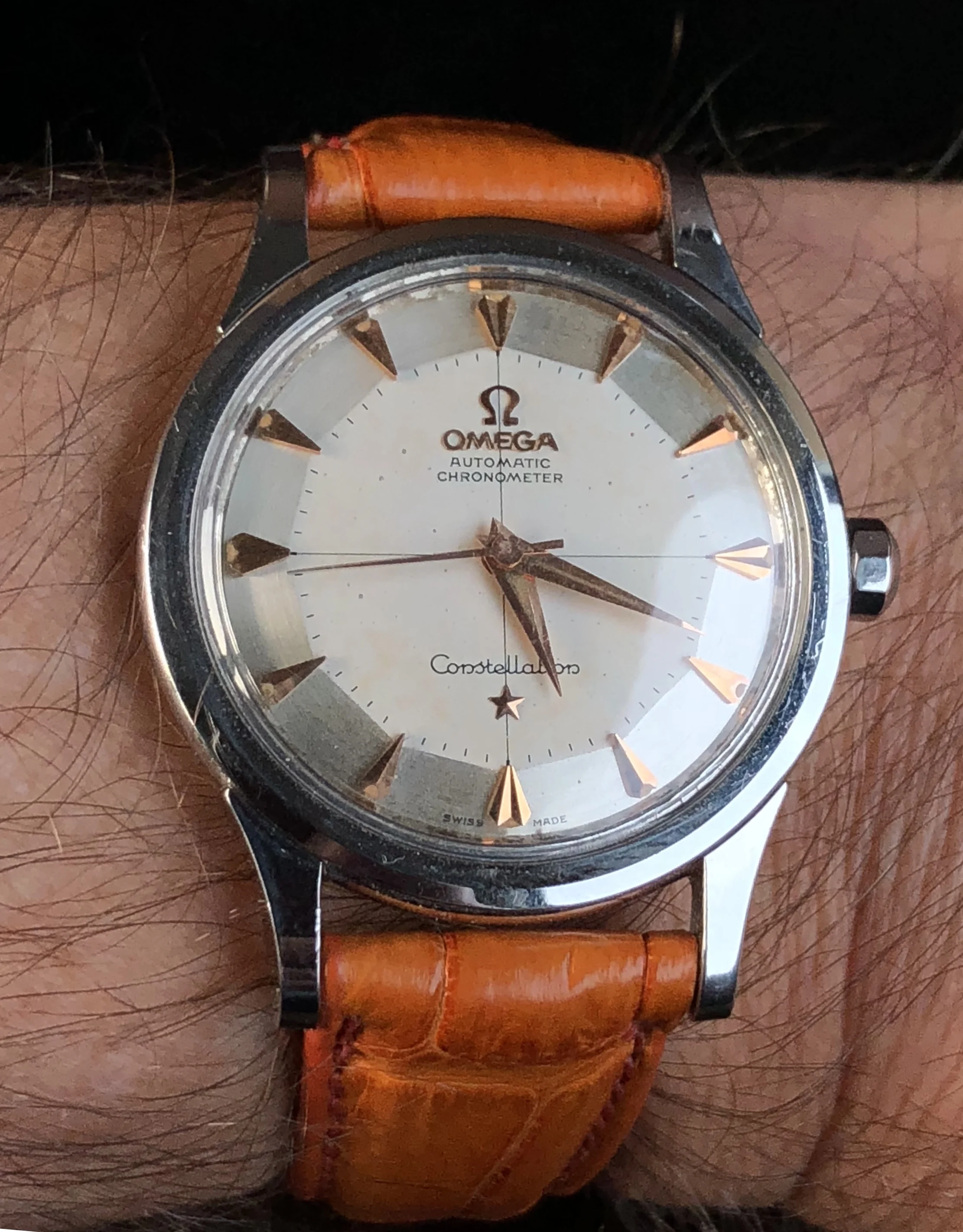

This is it:

Thanks @gatorcpa . So they do exist. I guess as with most omega, never say never!

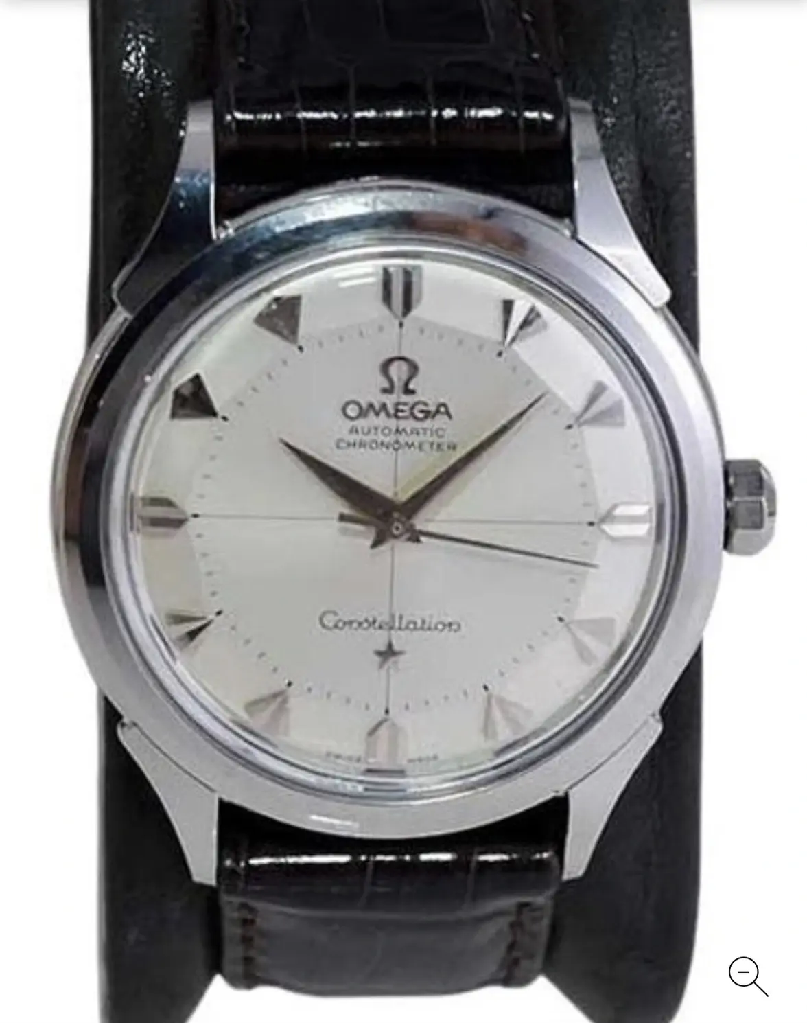

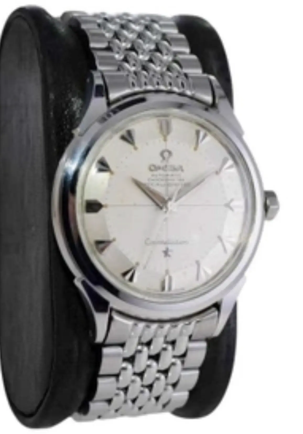

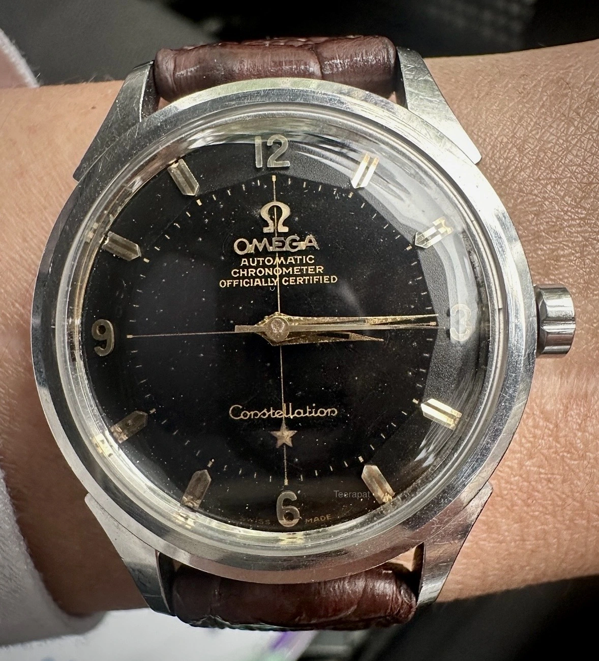

There’s this one from @hoipolloi too in this thread, although no info on the serial, but I would imagine it’s also a very late number.

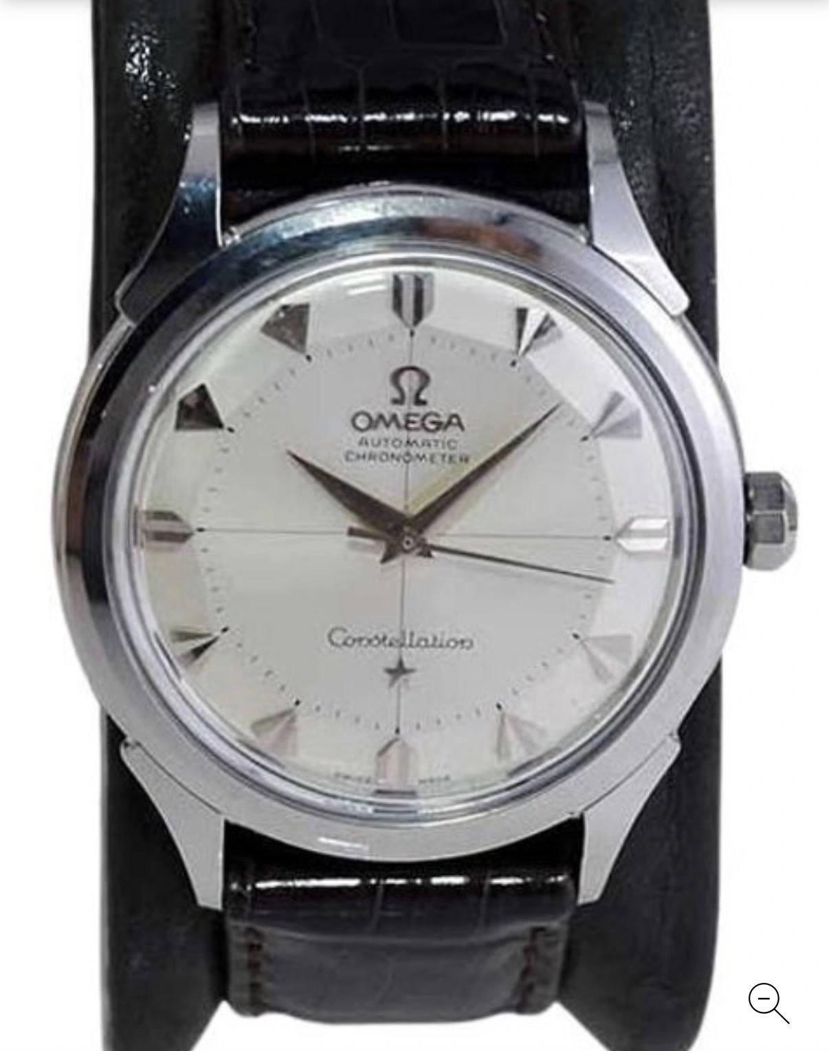

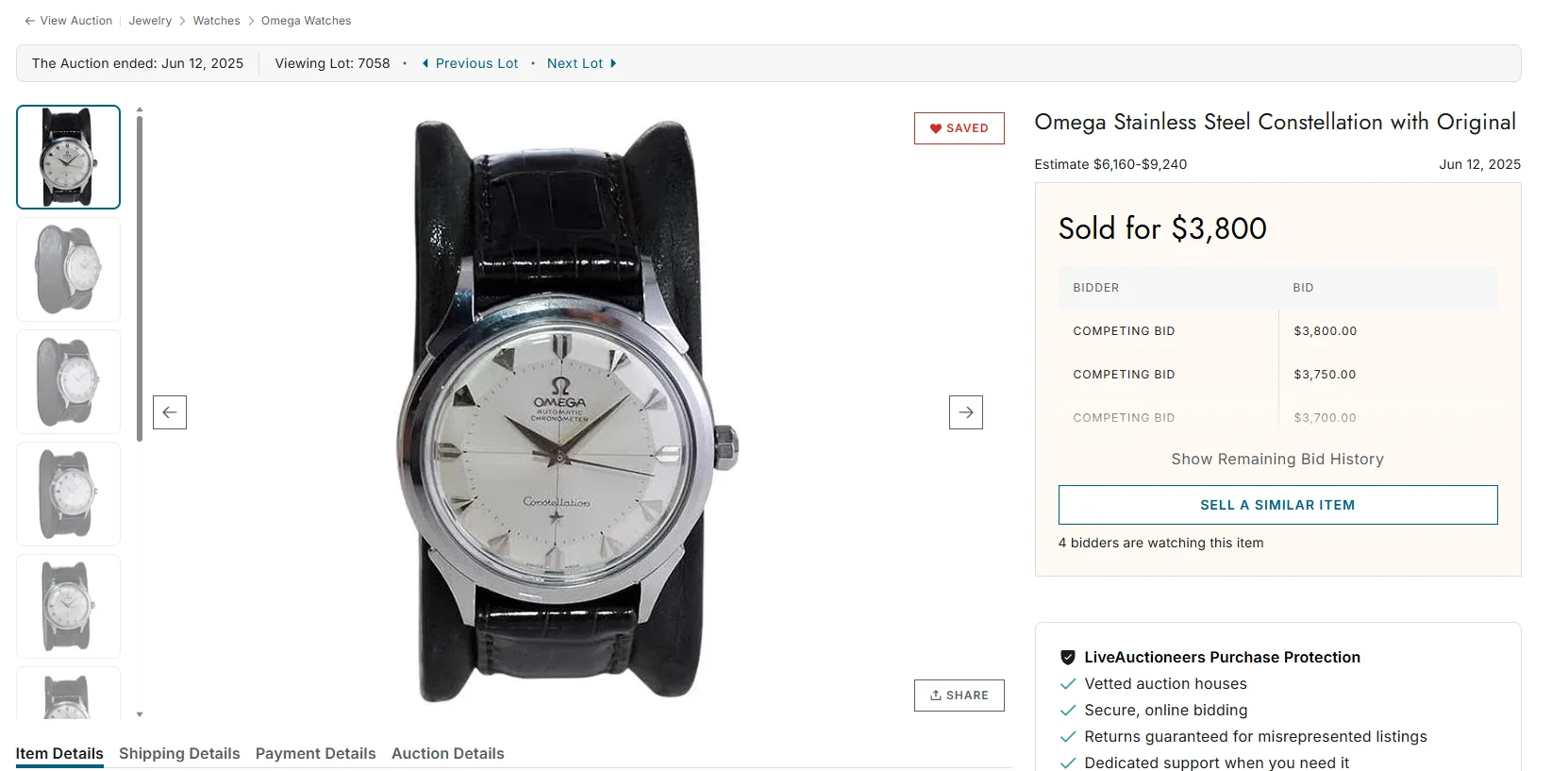

A word a caution on this one - I saw it auctioned on liveauctioneer last year, was supposedly sold and then reappeared shortly after at a lower (?) price on a website. It has been sitting there for a long time.
Not sure if there is anything wrong with the watch, or the website (which I had never come across)… or the price…
This was the item link in the auction, if you want to dig into it. https://www.liveauctioneers.com/item/208424766
EDIT: just to add, one thing which raises questions about the watch in this thread is the distance between minute hashes and the piepan edge/facet. But if you’re interested, perhaps you can post better pics so it can be properly discussed.
