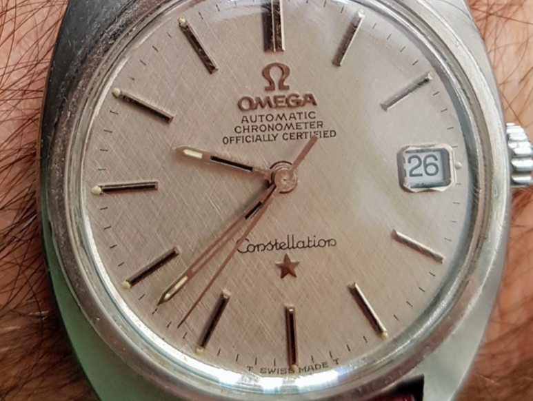

Hi All,
I'd be grateful for any help and advice on this C Case 168.017 - I posted a pic of this a while ago, and someone pointed out it has the incorrect hands. Lume pips on the hour markers means it should have lumed hands not these 'jet line' ones:
I enquired with Cousins UK but the 'correct' hands are not available via them - it seems they have fallen foul of the Omega proprietary supply thing. So interested in any thoughts:
a) should I just live with this?
b) should I source the 'correct' ones with lume (which I think should be these ones?) I read the hands on 168.029 with the day/date are longer so it would need to be the hands for this reference.
I'd appreciate your thoughts - if its worth sourcing the correct ones, would it worthwhile posting on WTB section of OF?
Thanks - Dan

It’s worth looking around for the correct ones, but don’t let that put you off from wearing this beaut as is in the meantime!
792
845
It might be the angle, but that minute hand is a little wonky....is it thinner than the hour hand?
Regardless, was the consensus that this is a correctly lumed dial (I couldn't find your original post)? I find it suspect that it isn't marked with a "T" by Swiss made and some of the Lume pips make me think that it was re-lumed or had lume added. It could be a no lume dial that had lum added, in which case the hands could be correct. Just a thought that occurred to me....

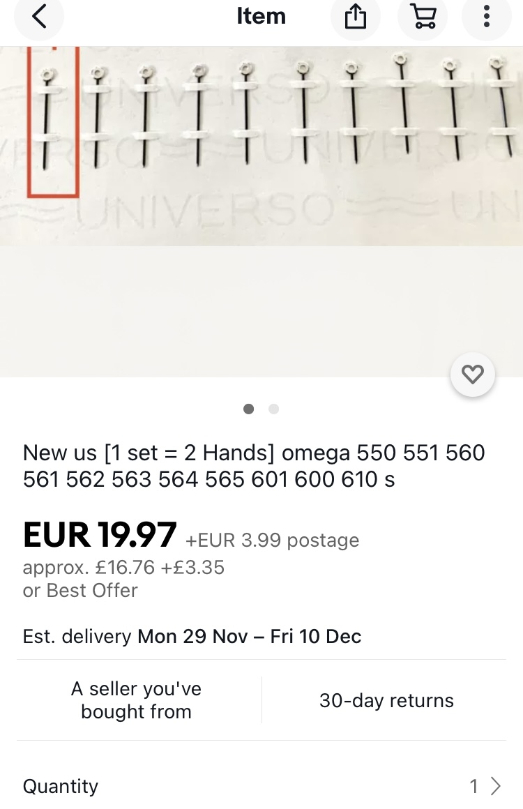

I had a similar problem with the hands on my 168:017 cal 561 and received the following very helpful information from @kaplan.
“Not at all, and to your luck, I think these are actually thin hands, I didn't take a second look before since they are very common:
https://www.ofrei.com/page864.html
My source is simply watching eBay, when you search for "565 hands" they come up - any movement# works
https://www.ebay.com/itm/274306443319Dead Link/roverimp/1/710-53481-19255-0/1?pub=5574889051&toolid=10001&campid=5338788128&mpt=1651429
eBay is cheaper, and just checked a pair that I bought earlier, they were actually thin, so I guess your quest might be over “
@Spruce thanks for your advice, much appreciated. I did try a search '565 hands' but couldn't see any that seemed right - but will keep that in mind for future - cheers Dan

Hi Lev
Good to hear from you - I think the hands on my Connie are Omega ones, just need to determine whether they are correct for this watch. Maybe there's something in the theory suggested here that the lume pips have been added?
cheers Dan
339
473
I think the lume on dial are not original but added later.
@hoipolloi thanks for your thoughts on this - it hadn't occurred to me that anyone would go to the trouble of adding lume pips to the hour markers. Who would go to that trouble? Seems a lot of hassle - but it might explain the lack of 'T' in Swiss Made. Help!! Where's Desmond when you need him...!

Hi Lev
cheers Dan
Great point, and even greater news for you, it might be all original - with the exception of the potentially added lume pips, which are obviously nowhere near as bothering as a wrong handset
