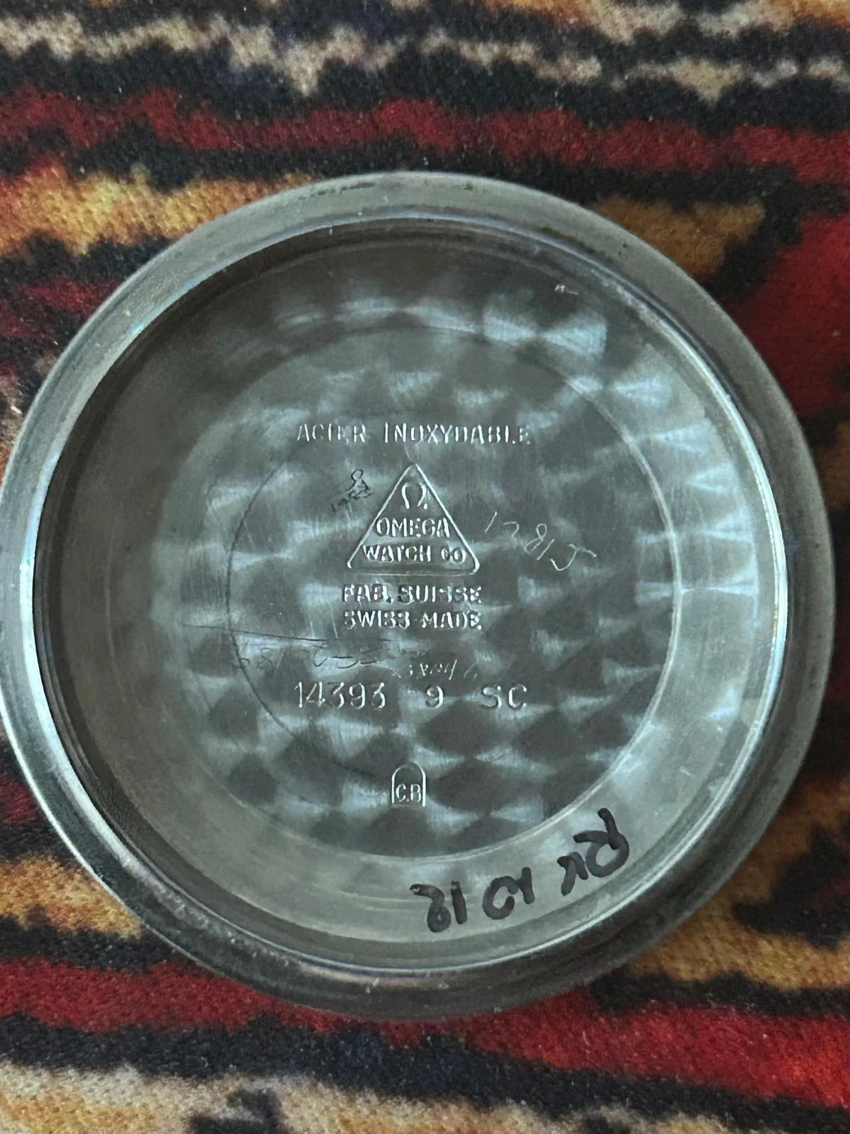

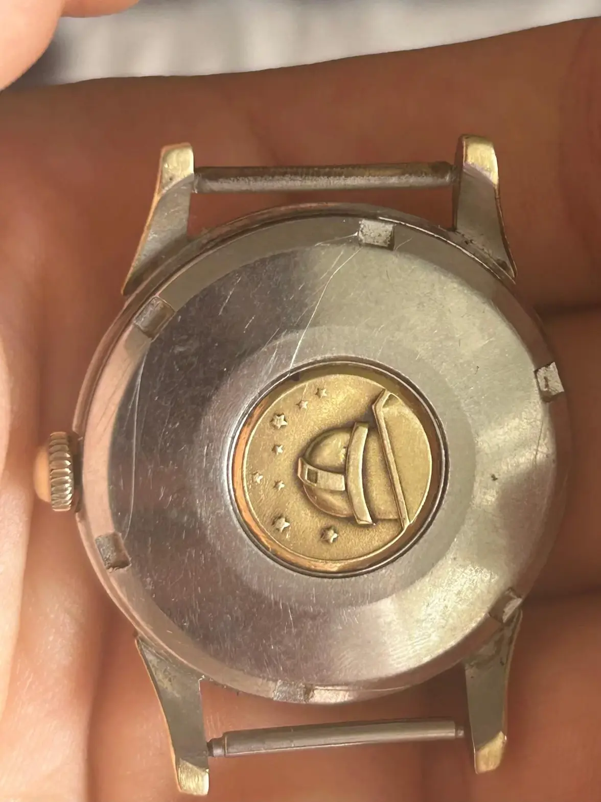

Inside caseback:
  • Omega Watch Co.
  • Fab. Suisse / Swiss Made
  • Acier Inoxydable
  • Ref. 14393-9 SC
  • Case maker mark: probably CB
  • Some old watchmaker service marks inside the caseback

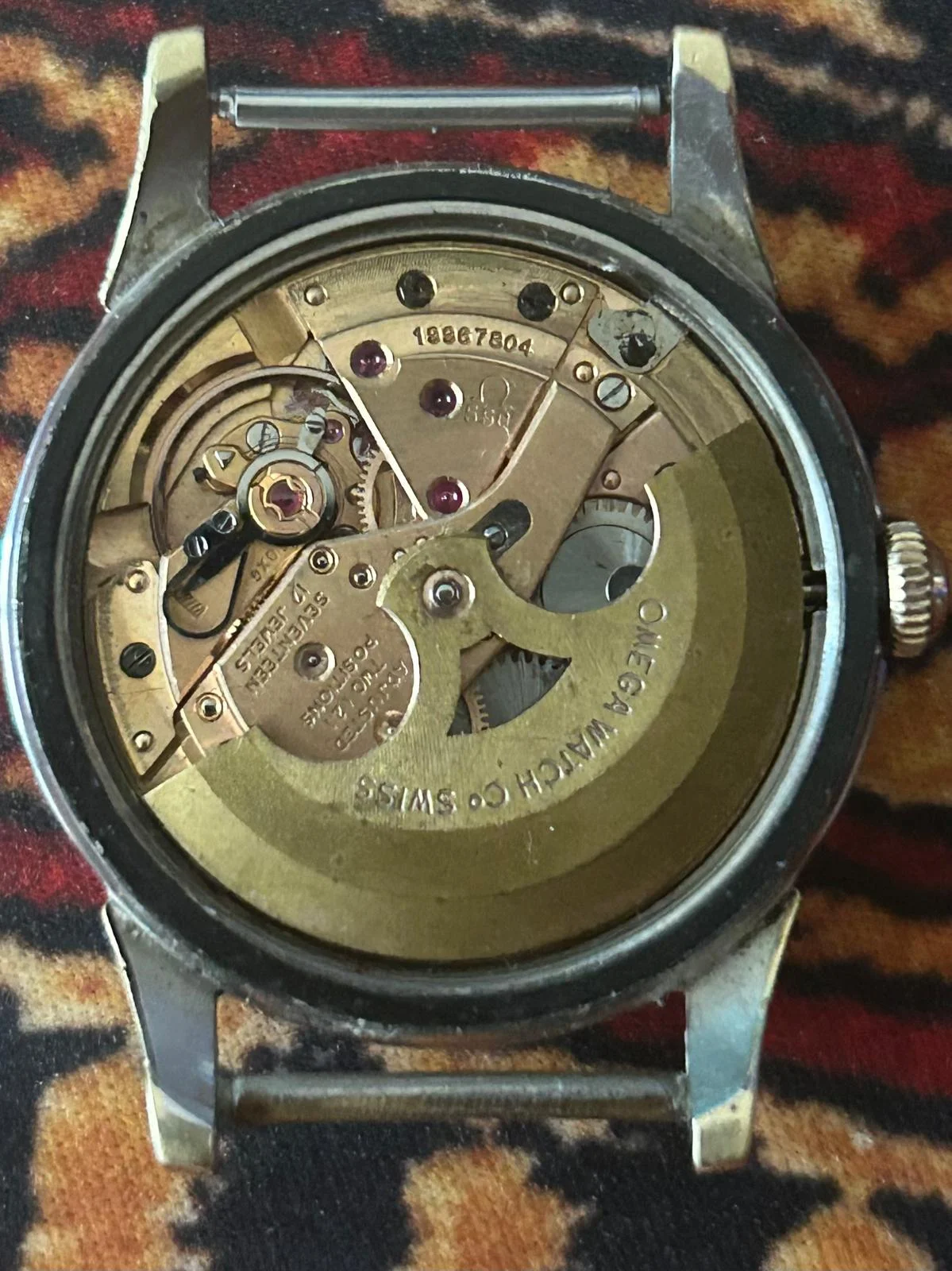

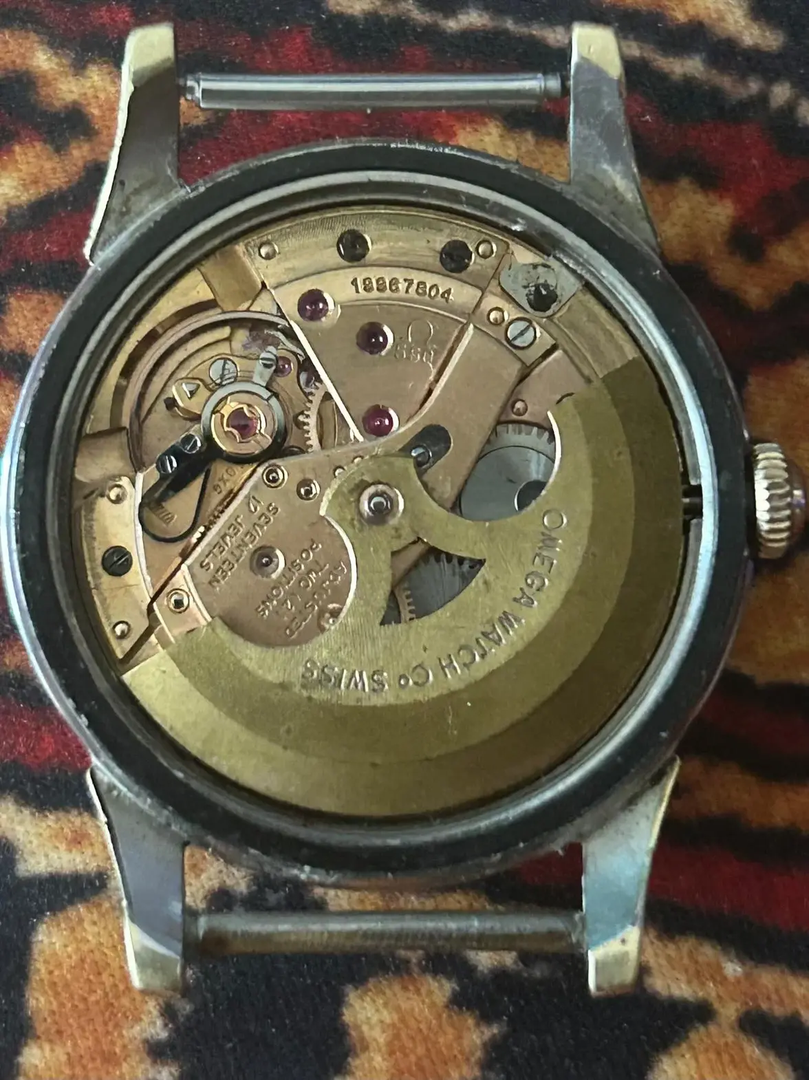

Movement:
  • Omega cal. 550
  • Serial number: 19,967,804
  • Adjusted two (2) positions
  • Seventeen (17) jewels

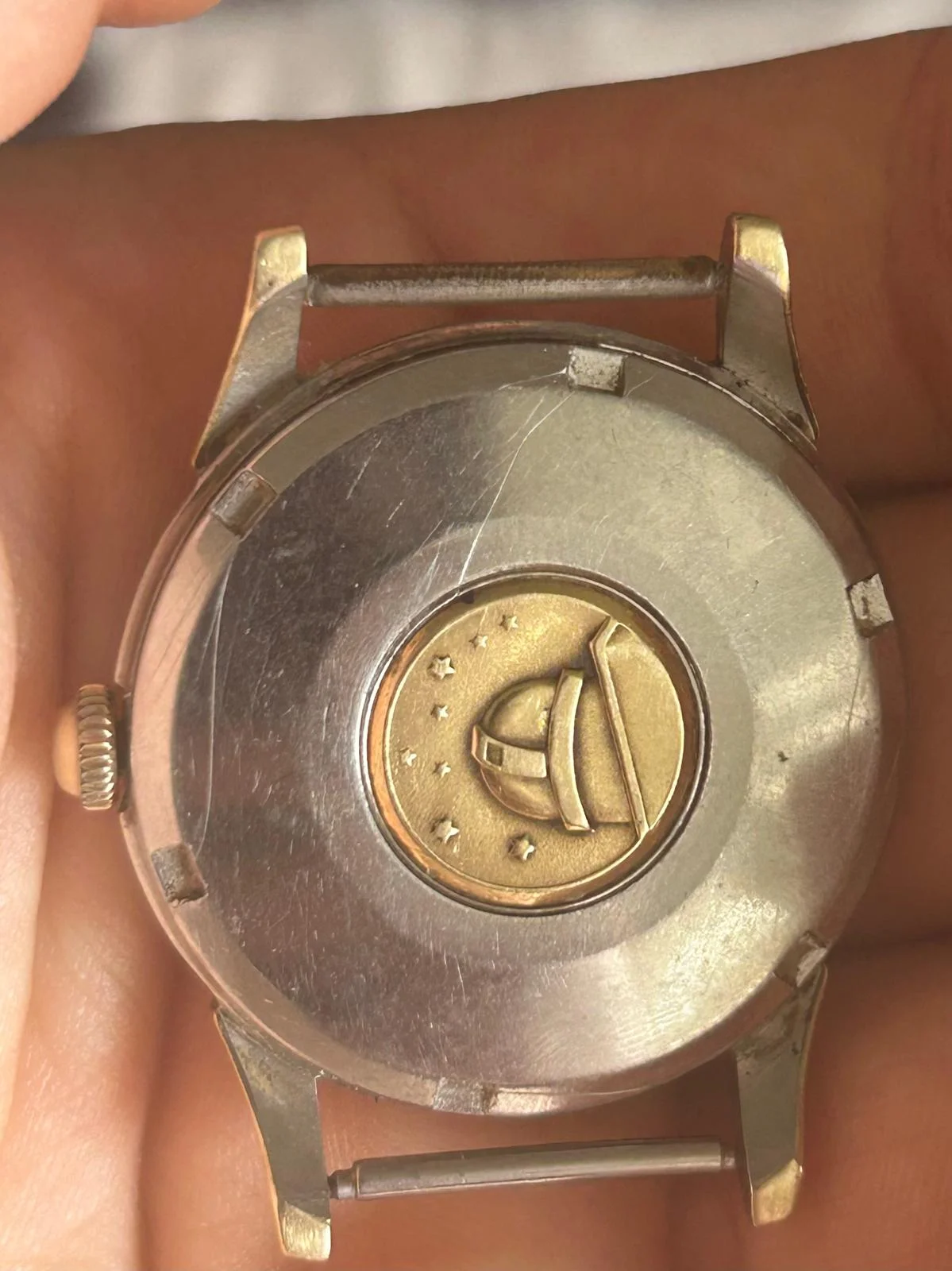

The watch has the Constellation observatory medallion caseback.

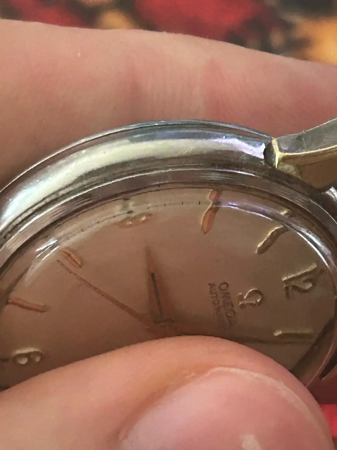

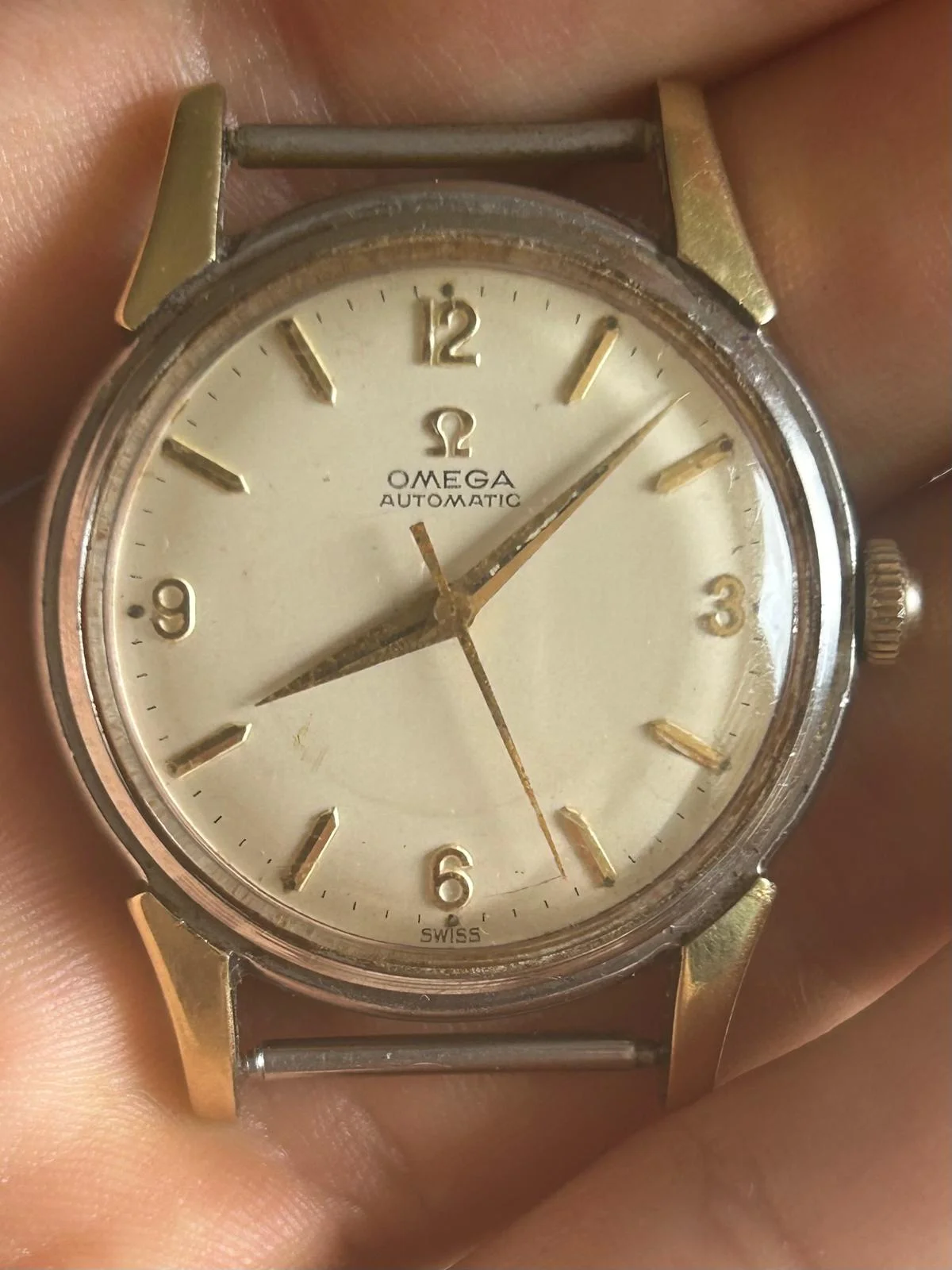

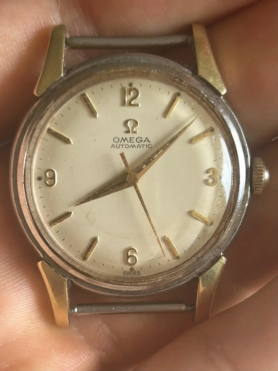

The current dial only says “OMEGA Automatic” and “SWISS” at 6 o’clock. It does not have the Constellation text, star, or Chronometer/Officially Certified wording. The crown is also a round unsigned crown without an Omega logo, so I assume it is a replacement.

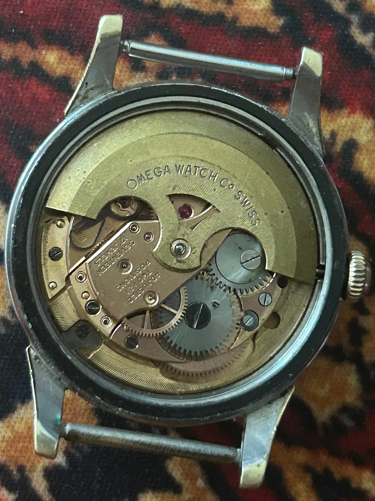

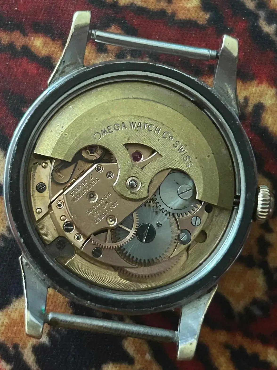

A watchmaker told me that the rotor/automatic winding part is damaged or has play. The rotor itself is marked “Omega Watch Co. Swiss”.

2. Is the current dial likely a service dial, redial, or a dial from another Omega Automatic?
3. What would be the correct or most period-correct dial type for ref. 14393-9 SC with cal. 550 and serial 19,967,804?

5. Is the rotor shown in the photos correct for cal. 550, or does it look like a service replacement/wrong rotor?

This isn’t a project remotely worth pursuing. Wrong movement, dial, hands, crown, missing bezel that’s unobtainium. The only thing that’s ok here is the case back, I‘m afraid.
836
1,173

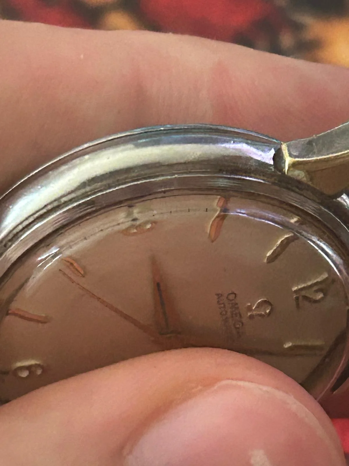

Hello. I would say the dial is earlier and was transplanted into a 14393 case.
This reference has a different calibre, most importantly with date… so there is some mix up here.
Importantly it also seems to be missing the bezel? That’s a difficult part to replace usually.

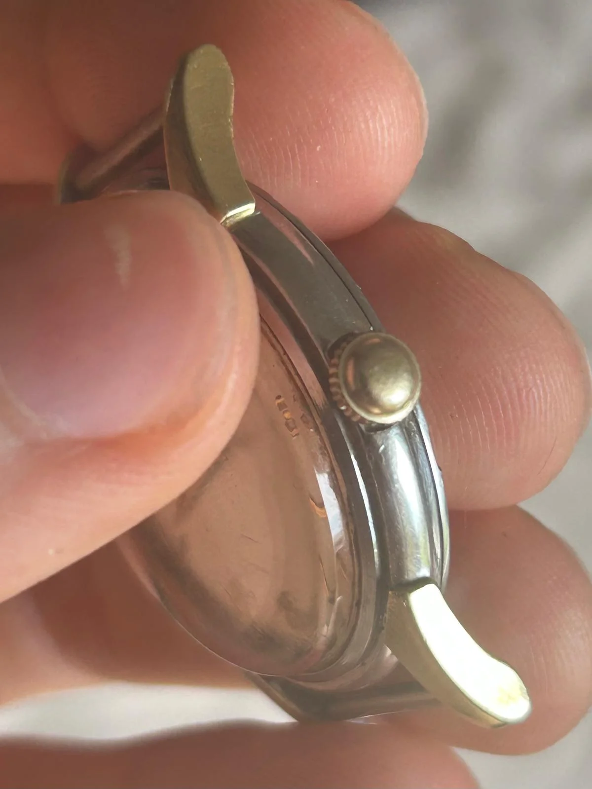

Could you please help me understand the specific issues?
  • What calibre should normally be in a 14393-9 SC case?
  • Is cal. 550 entirely wrong, or could it be related to a US/export configuration?
  • What indicates that the dial and hands are earlier/transplanted?

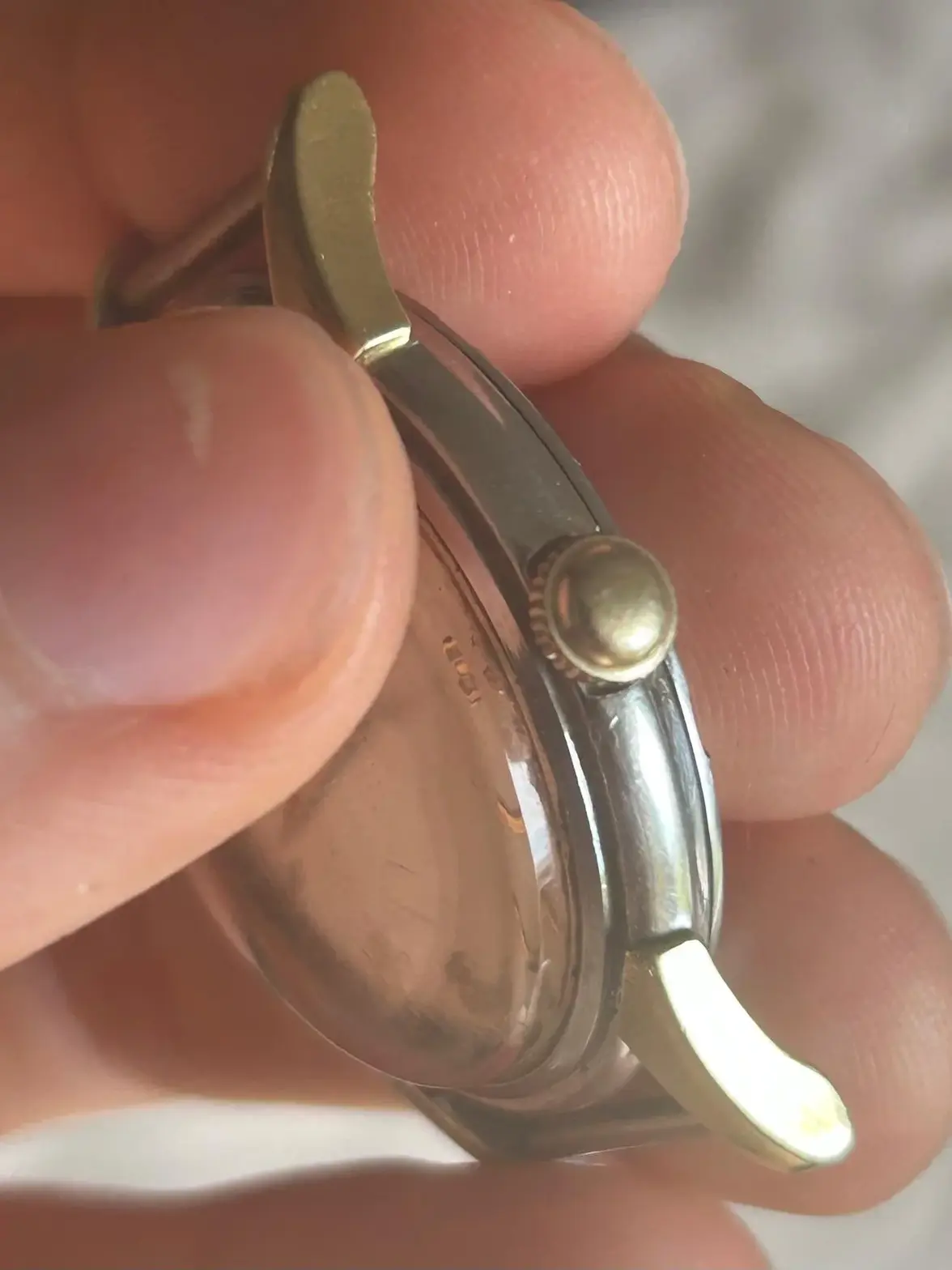

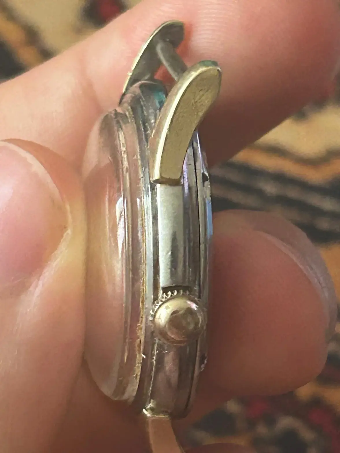

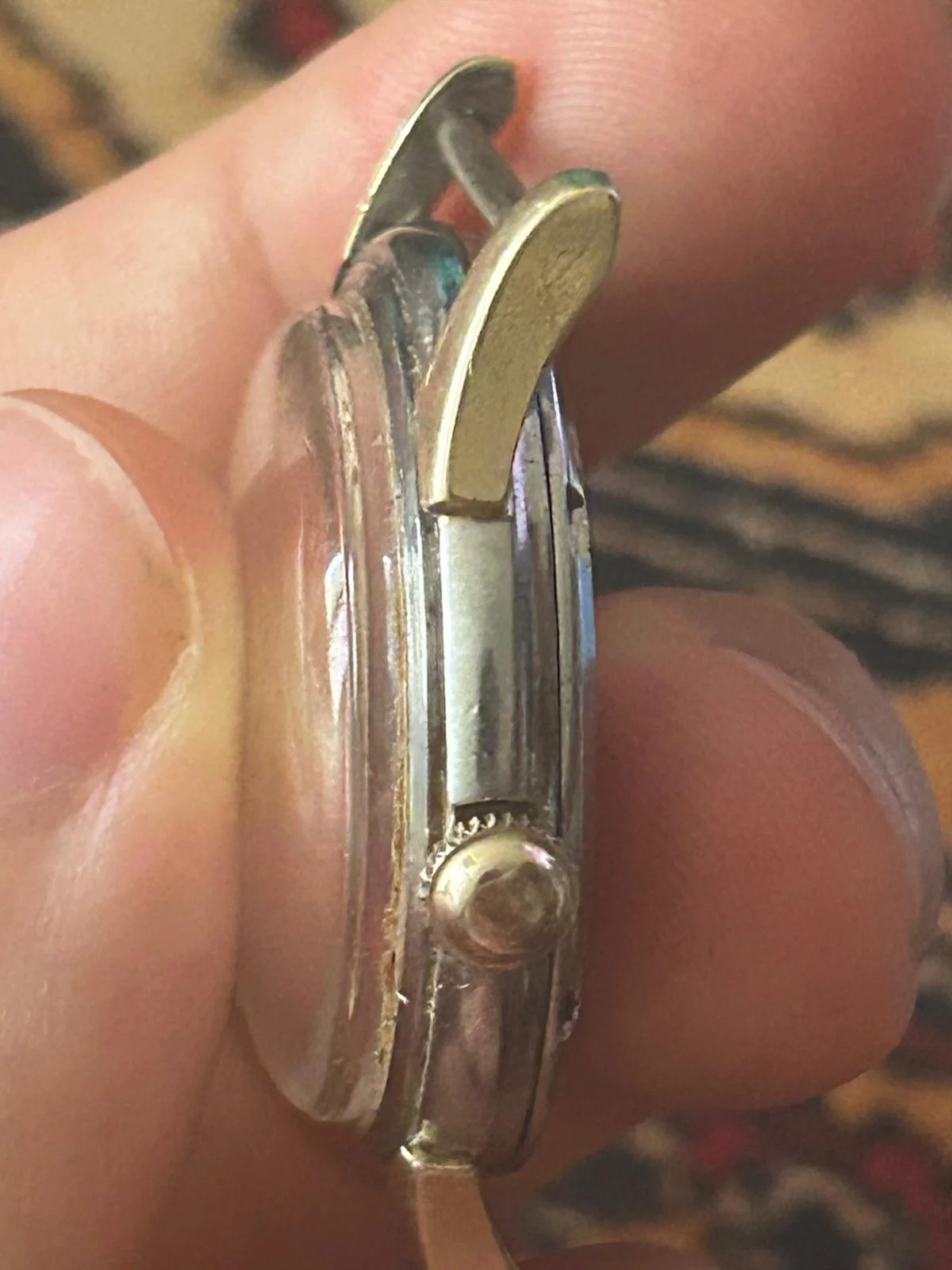

  • Regarding the front: does my side photo confirm that the correct bezel is missing, or could this be an incorrect oversized crystal?
  • What should the correct bezel/front assembly look like, and what part name should I search for?
There is a chance that old parts from a previous repair may still be in my family home where I found it, so I would like to know what to look for.
I am not trying to over-restore it - I mainly want to know whether it makes sense to service it as a wearable.
3,486
13,335
1. All 14393s have a cal 561.
2. It’s entirely wrong.
3. The dial has a configuration with the numbers and indices that doesn’t exist on 14393s. Most of all, it has no Constellation star so it never was a Constellation dial, not even a repainted one.
4. The bezel is missing. It was solid yellow gold and thus the same color as the lugs.
5. The bezel is simply a thin circle made out of gold that sits around the plexi so that it you look at the watch from the top you don’t see any steel.
If you do actually have the bezel somewhere that‘d be good but you’d still need the correct movement and dial.
With the exception of the bezel that’s not called unobtainium for no reason, all parts can be found with patience, money, and if you know what you’re looking for.
I mean this absolutely not as an offense, but the way you’re asking tells me you don’t know much about what you’re getting into and that’s a recipe to burn money, hence the warning.

As has been noted, it's a hodgepodge of parts from various watches. If you want to look at it as a glass-half-full, you have a reasonable starting point to restore two or three different watches. However, most experienced collectors would take the opposite perspective, and understand that they have a collection of parts that would be better used to restore other watches.
Of course, another option is just to wear it as-is, as an interesting curiosity. But I don't think I'd pay to have it serviced.
