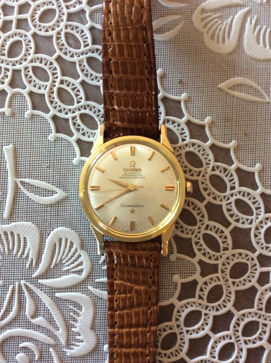

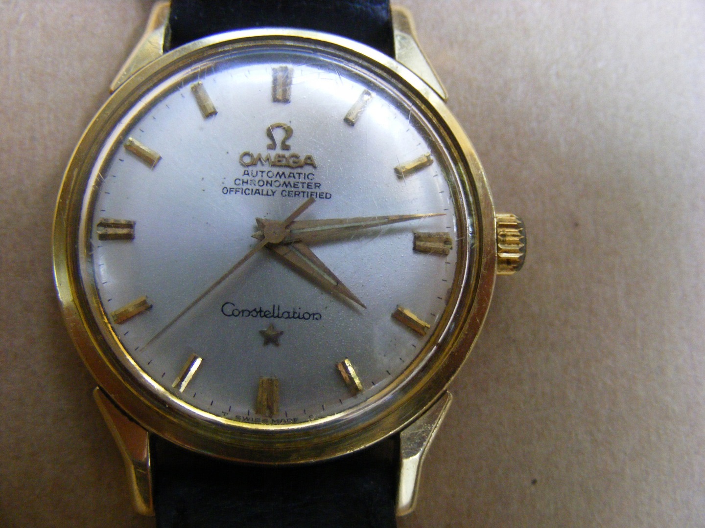

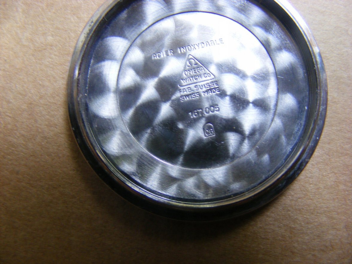

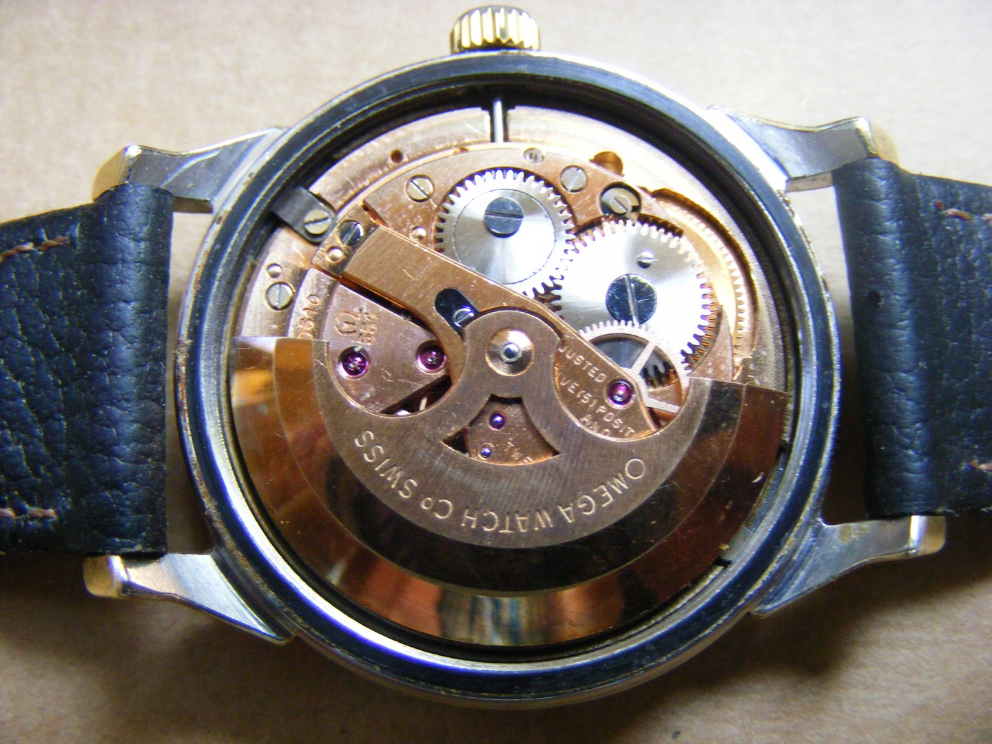

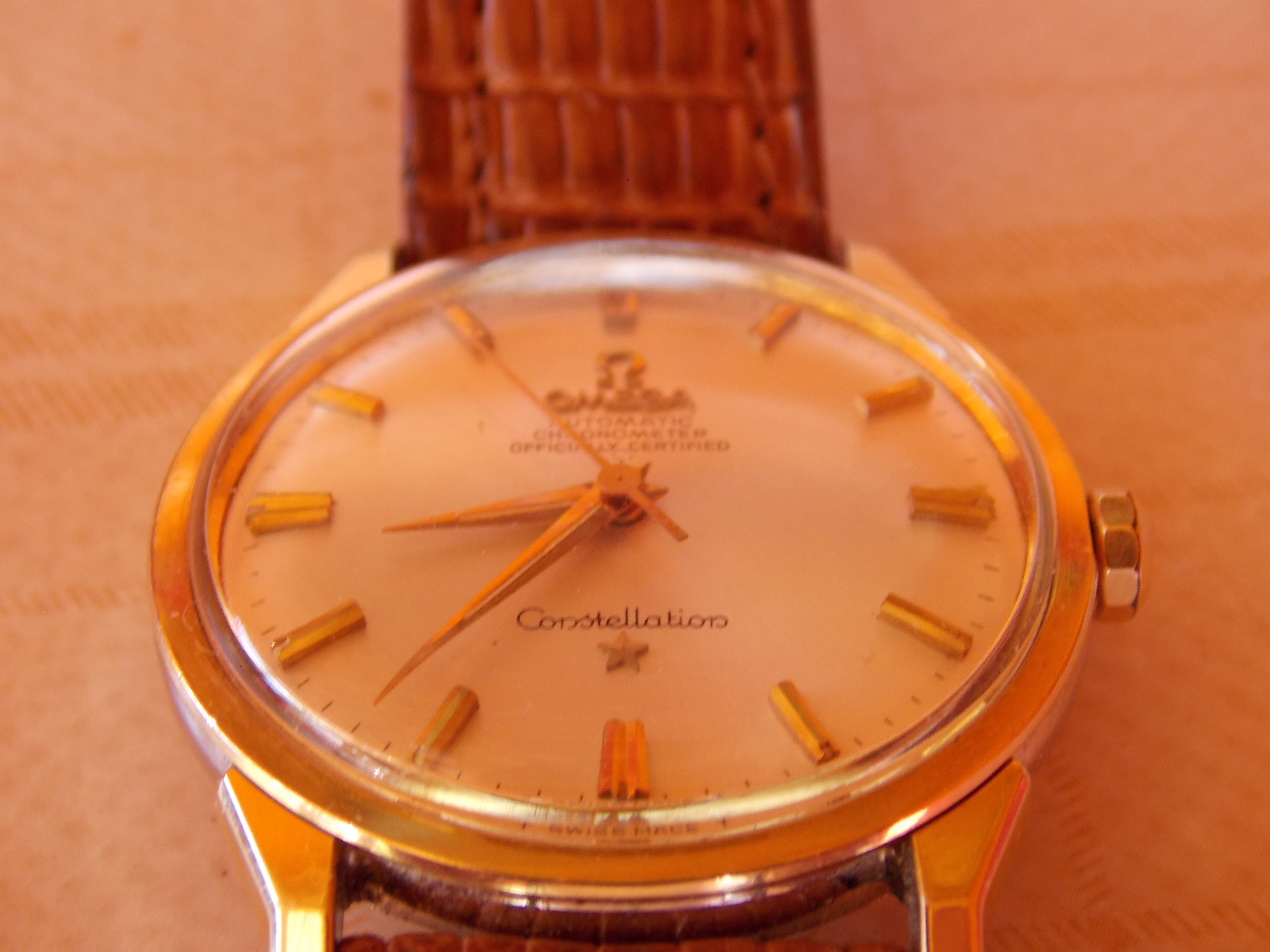

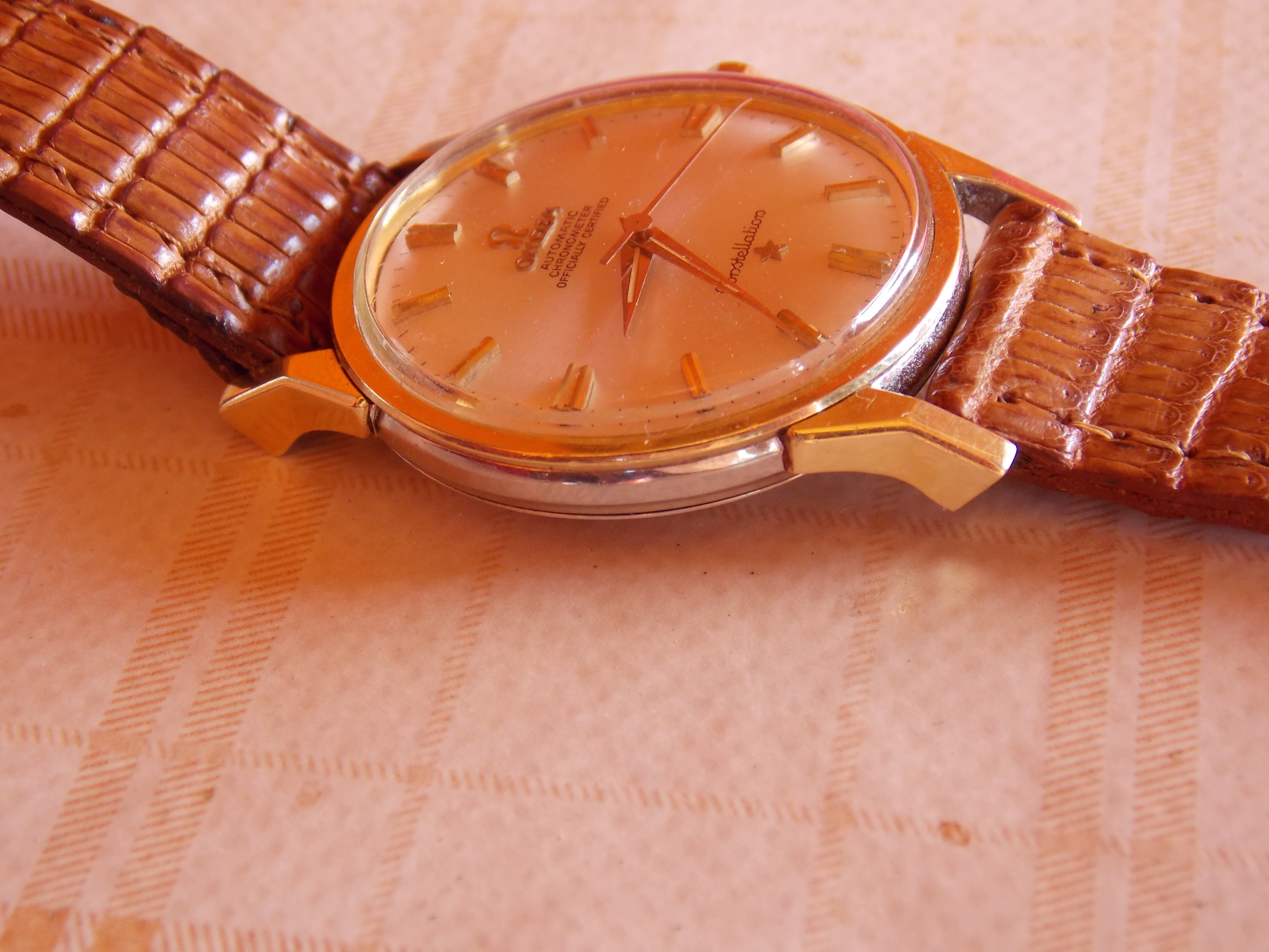

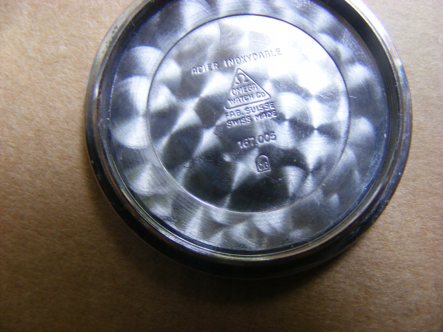

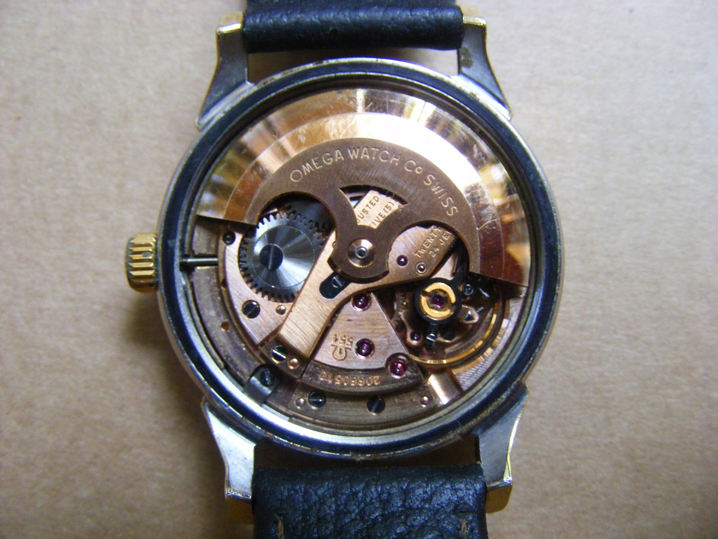

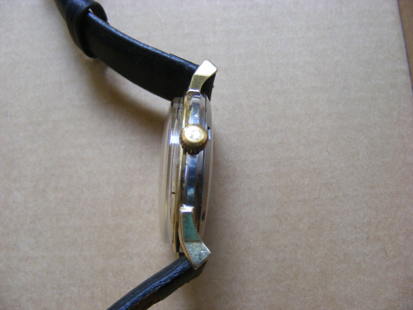

Hello there, considering second Constellation.
1. Serial, reference, case and movement adds up.
2. Crystal original and signed, but worn. I am skeptical, if it will be in good enough shape for daily use? Can it be replaced or polished?

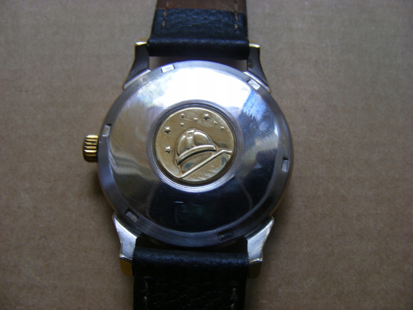

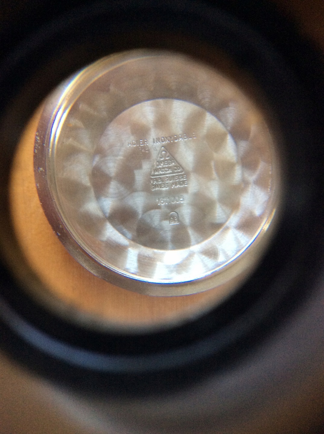

3. Caseback looks fine, but someone without proper tools tried to open it - visible scratches. BTW can you recommend some basic toolkit to open caseback like that? 😉
4. Case in good enough shape. I think it was polished, but the question is, was it over polished in your opinion?
5. Dial looks original and in overall I do like it’s honesty. What percentage of the MOY part is damaged and what part is due to the scratched crystal?
6. Crown looks original.

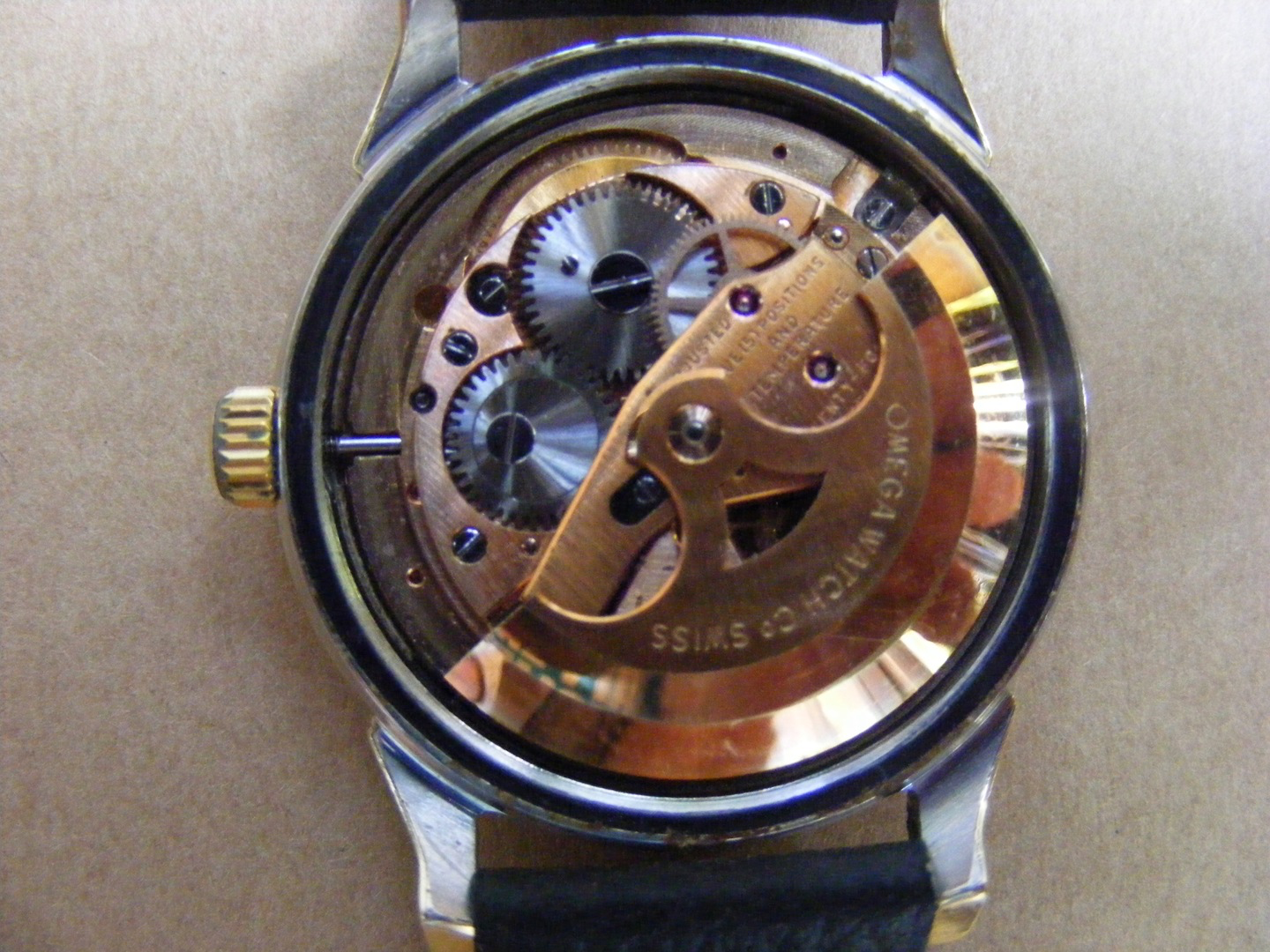

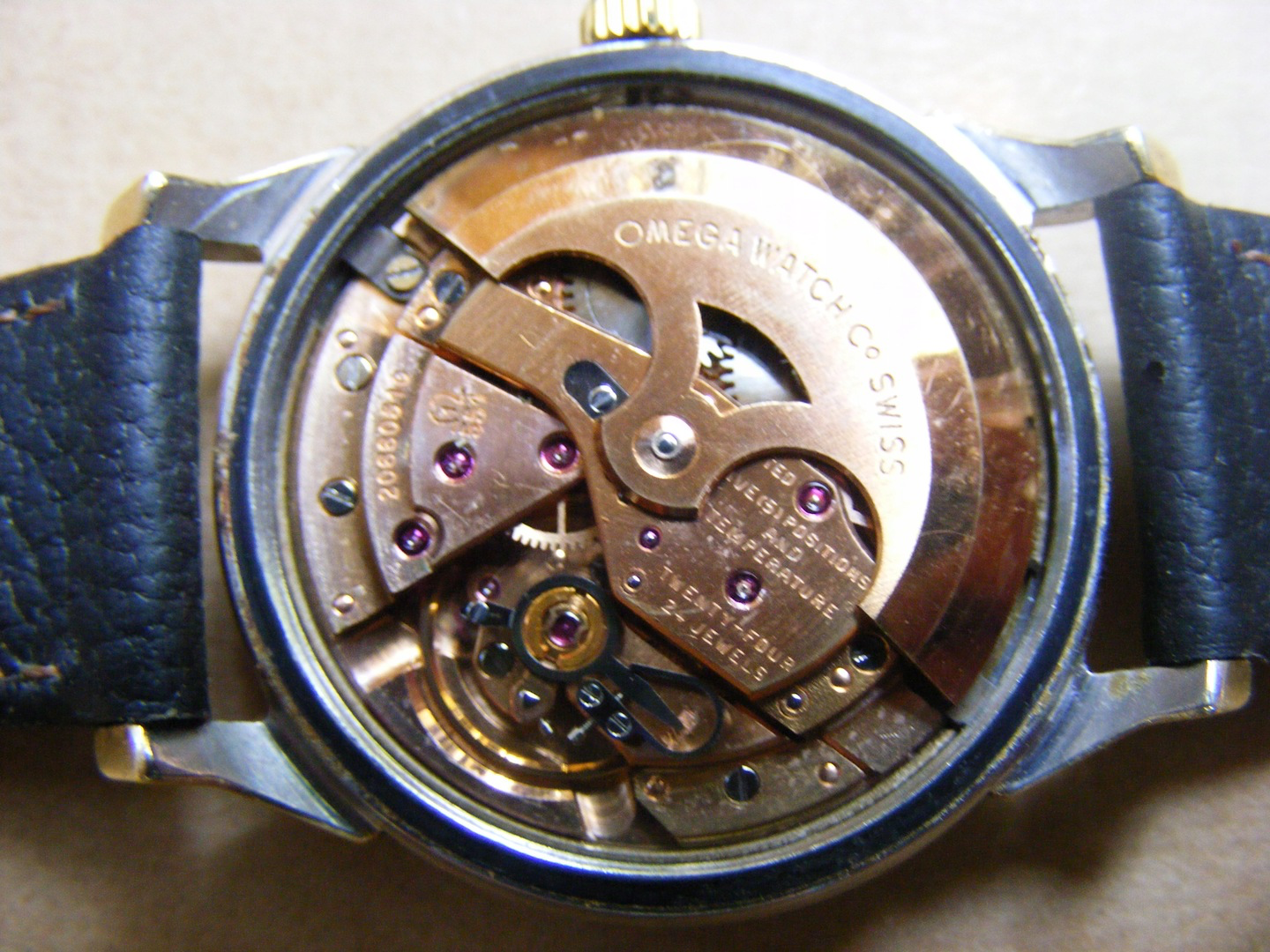

7. Movement looks original and healthy. Too optimistic about that?
As always any advice much appreciated. 😉 Including market value - I have number in my head, but don’t want to influence your judgement. 😉

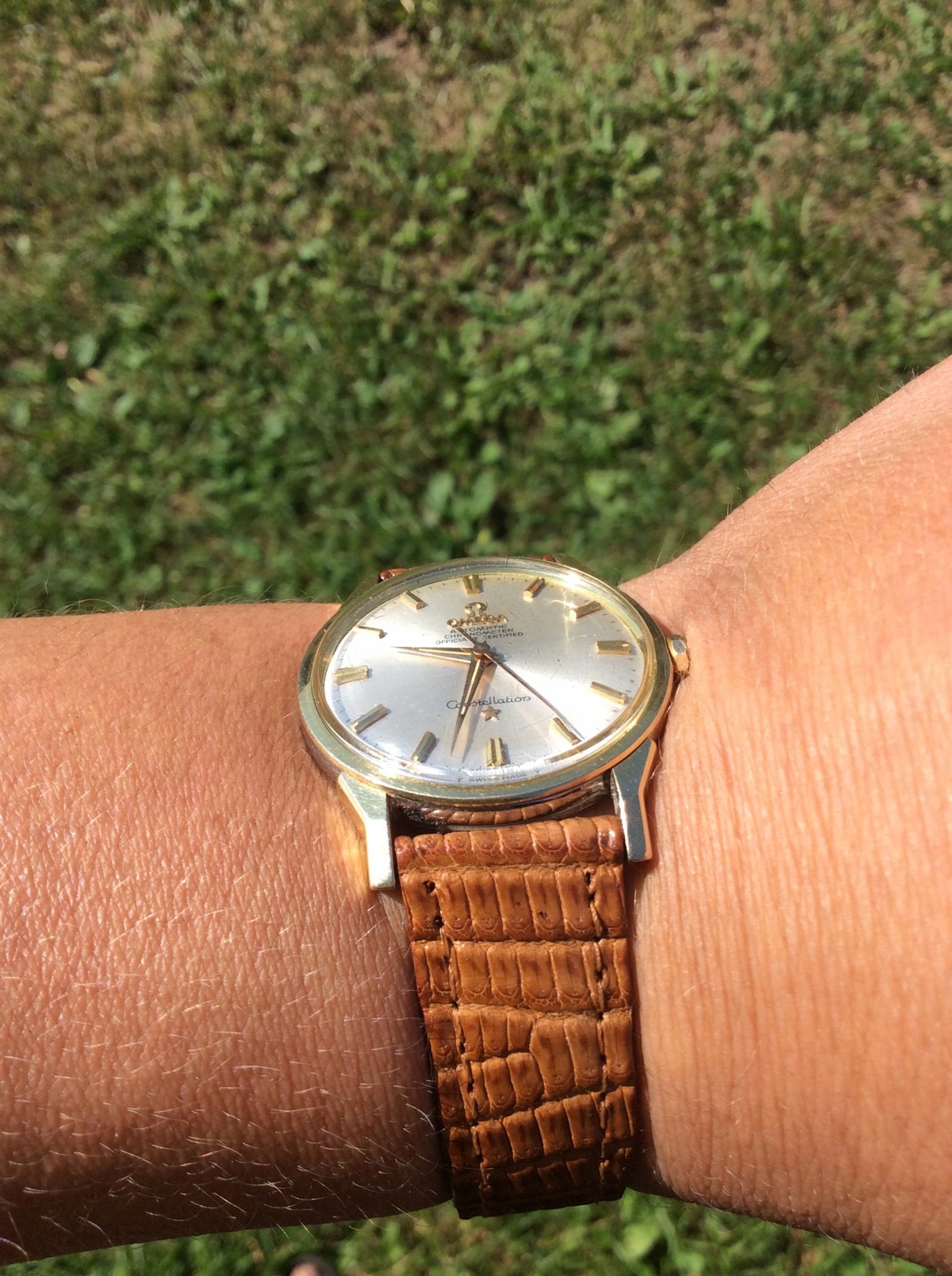

Just found another one... Does not look redialed. Your opinion based on the single photo in comparison to the first piece? 😉

Hi @Zdzislaw
First one has a quite well-polished case with the lugs losing their definition.
Spotting on the dial.
Early signs of rotor rub. (On movement)
Damaged replacement crown.
Second one - case looks better but the single fuzzy pic isn’t good enough to give an accurate opinion.
Hope that helps.

You do not need a case back wrench. There is nothing in there except pain and misery. Leave it to the professionals.

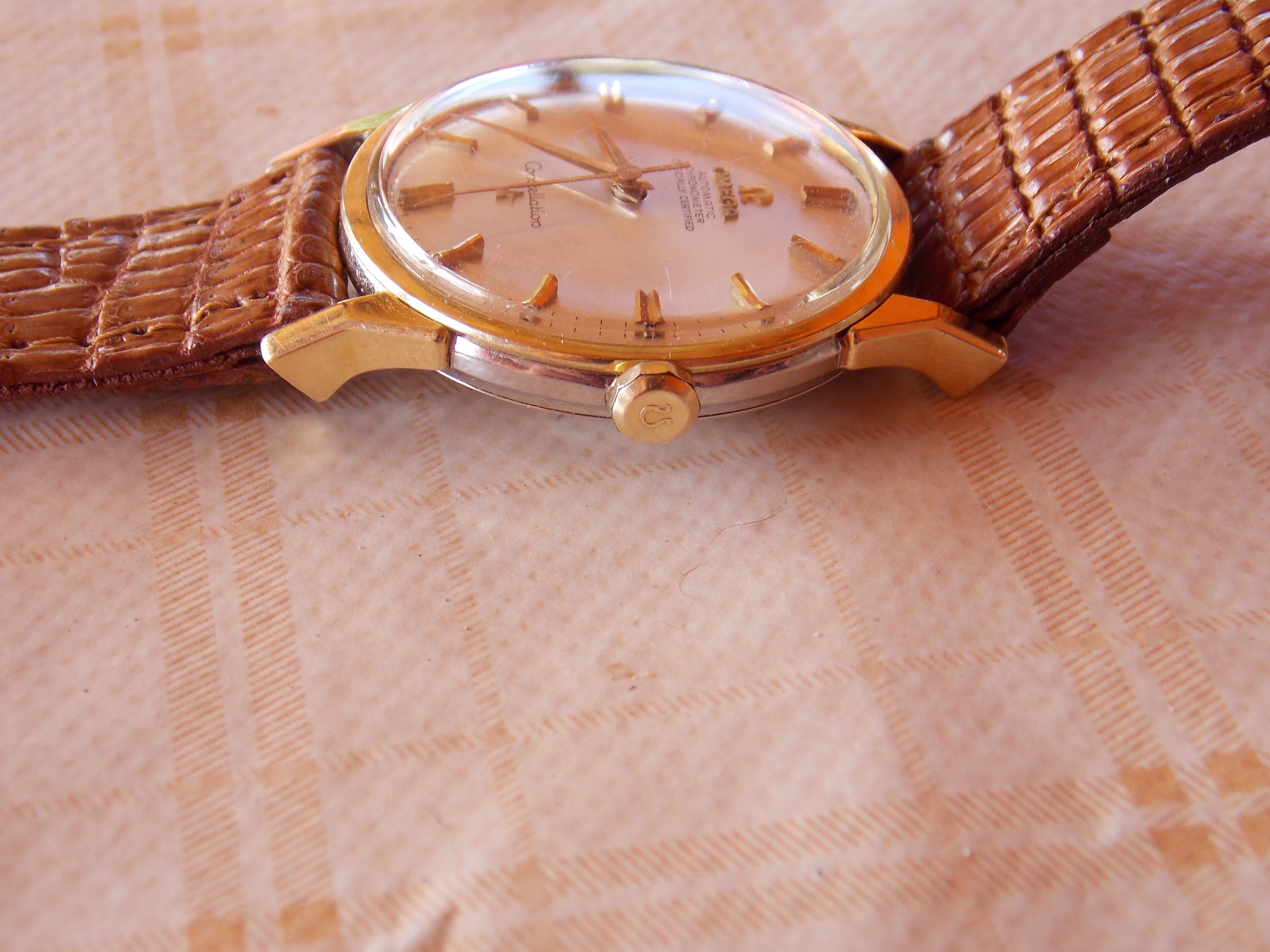

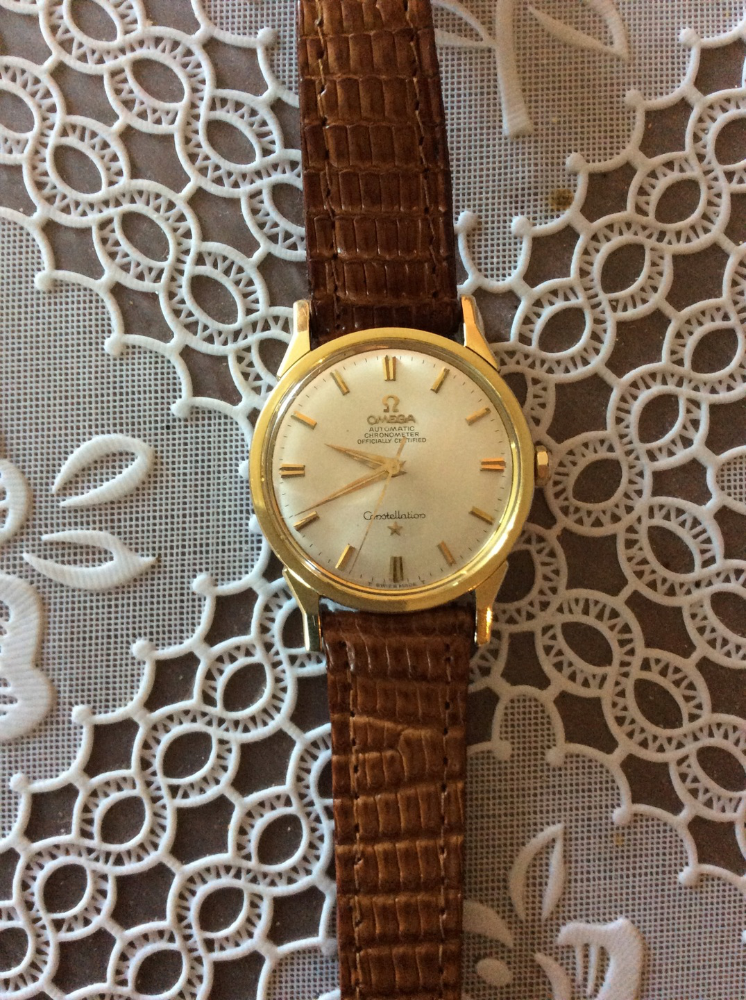

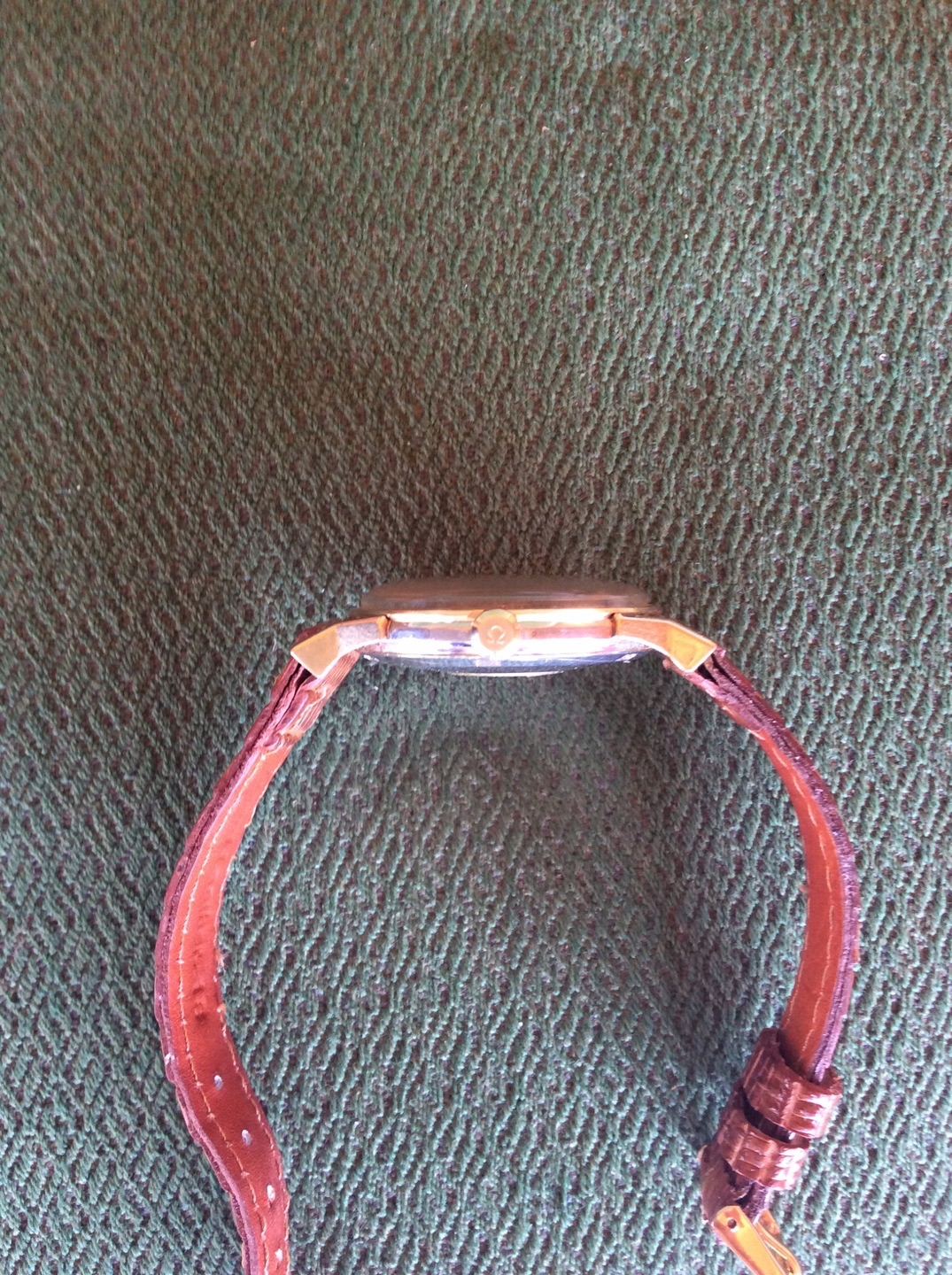

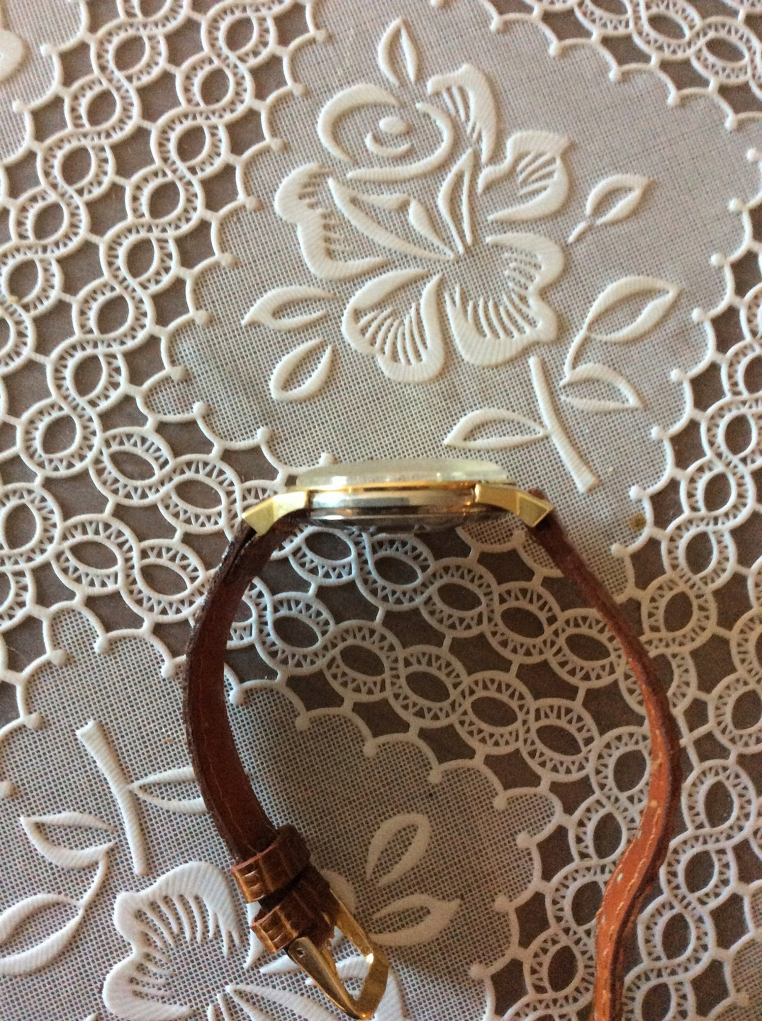

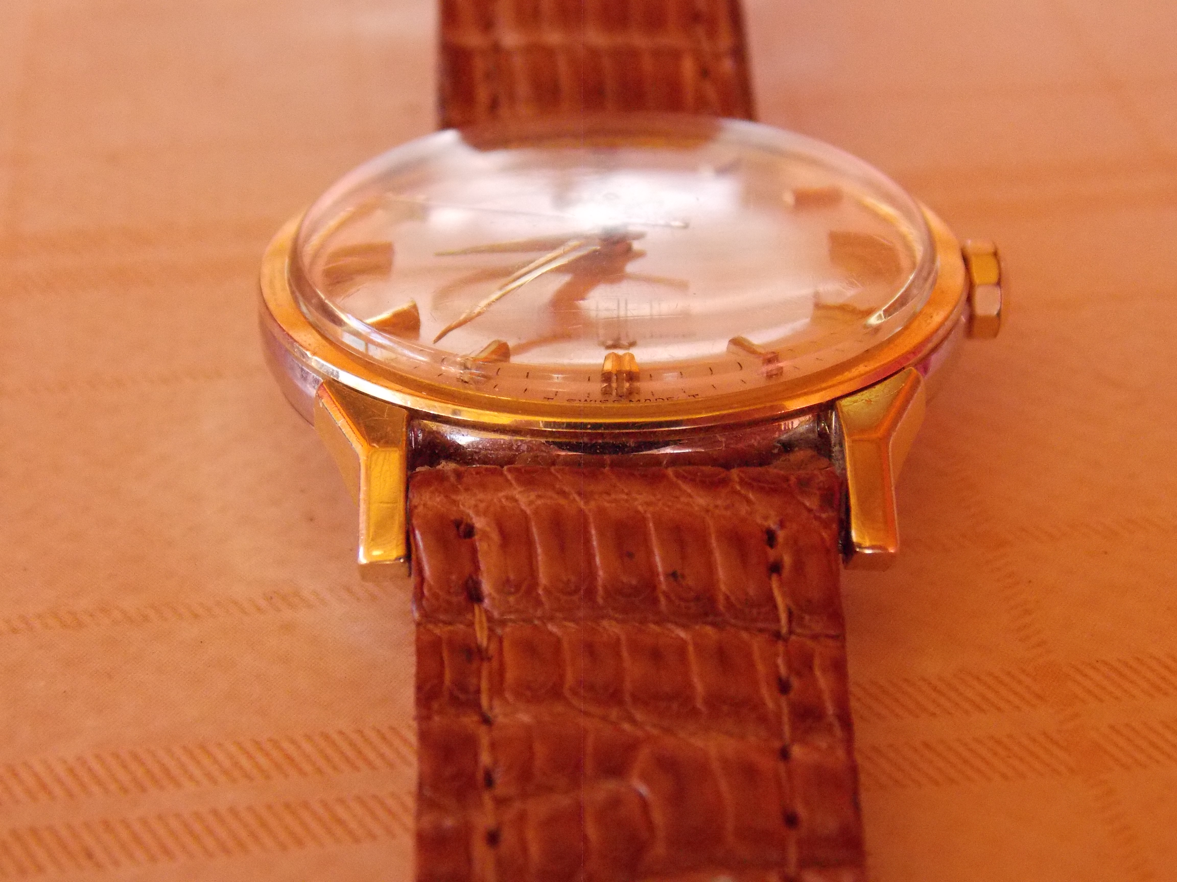

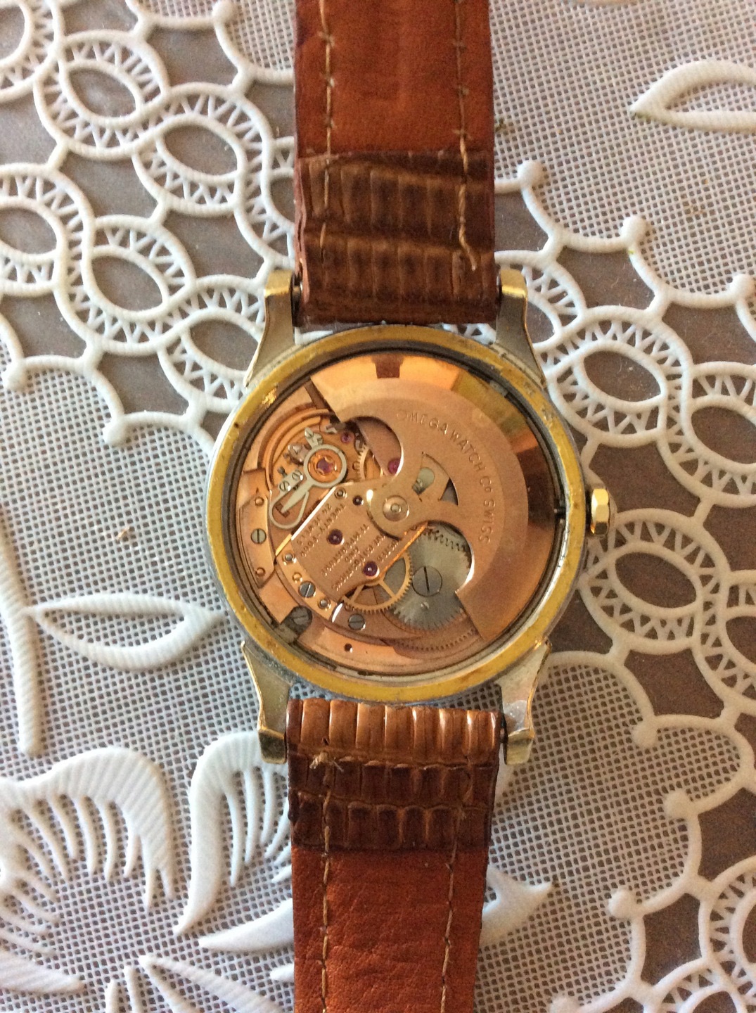

Thanks for prompt reply. 😉 More photos of the second piece below and again any feedback appreciated - especially price range.

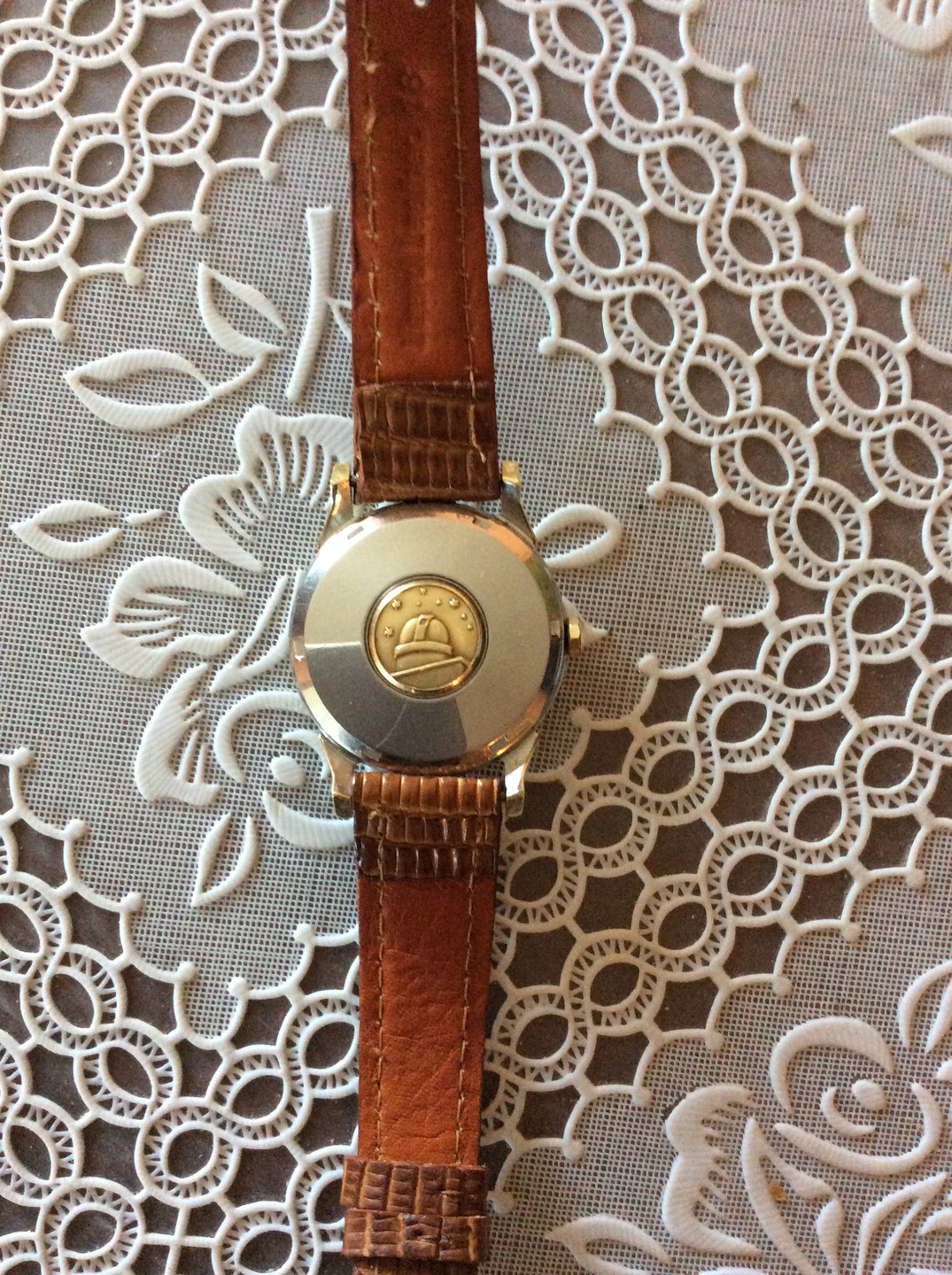

Some great images of the lace doily.......🙄
case doesn't look too bad (gold cap is never as sharp as gold or SS) but has seen some polishing -most likely with use.
medallion looks quite good
movt looks okay but again is showing signs of rotor rub on the movement - that is probably the original case gasket and it is in a bad way
You can't prevent things from falling inside.
such as bits of that gasket....
would need a decent image of the dial to comment properly but from what you can see from the wrist shot it doesn't look too bad at all.
you tell us how much the asking is and we'll tell you if it is reasonable.

Thank you very much. Currently asking price is 1200 USD, but I don’t think he will be able to sell it and I hope seller is opened to negotiations. Based on the pieces that I saw in much better condition I would say that reasonable price would be something like 700-900 USD, but looking forward to know your opinions. Thank you in advance.
Well, breaking it down.
It’s gold cap and a dome dial, so less desirable to some.
It’s slightly worn and in need of a service (I wouldn’t even run the watch after having exposed the movt to that gasket)
Allowing $300 for a service and deducting a sum for the wear, assuming the dial is ok, then your $700 wouldn’t be an unreasonable offer.

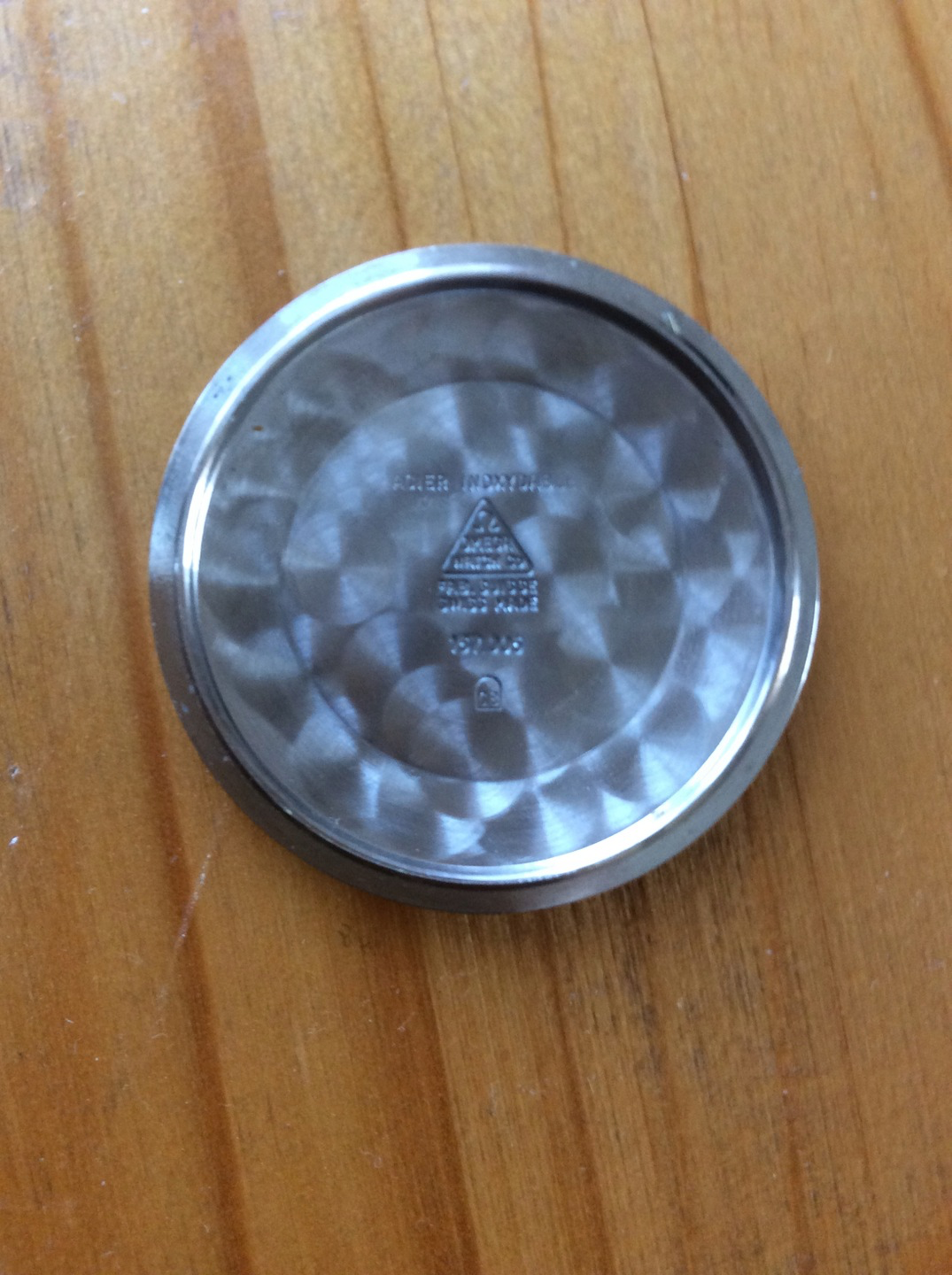

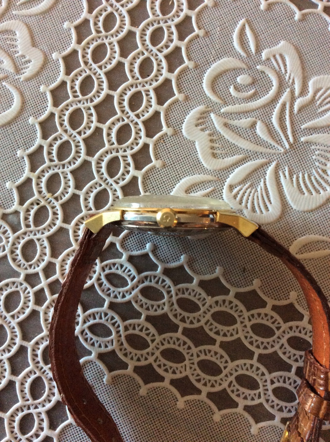

More photos in higher resolution below. Final offer I am ready to make is 850 USD. Please sense check me, if I am not willing to overpay simply because I like this piece. Thank you in advance.
6,835
10,503
Has the seller an aversion to straight on dial shots?
From what is shown:
Case is as expected, perhaps a little more worn on some lugs than others.
Bezel looks quite good.
Dial (from the oblique pics) looks correct.
Looks like original crown and crystal.
Just noticed from the previous pics , there is a scratch across the back and medallion - did they provide a better case back image?
I think with a bit of patience you could find a better condition gold cap dome dial dogleg for $850 (but when I think about it, there seems to be fewer GC doglegs appear on the forum than SS or gold) so if you really like the watch then it’s up to you if you want to put your money down.
