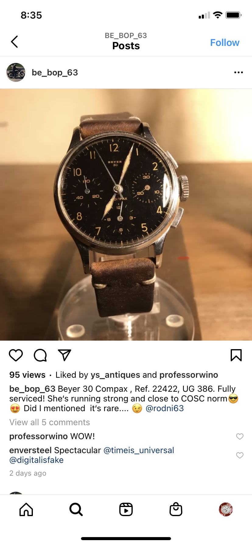

@Mark020 posted this in the ebay thread but I thought also useful to have it here.......I was actually just wondering the other day if we have any other brands running a cal 386 and showing either Compur 30 or Compax 30. I don't know enough about Beyer to evaluate this example.....
6,314
9,901
Obviously a reckognised name and long enough in the business to be there when the Compur 30's were new. Picture has not enough detail to say anything IMHO.

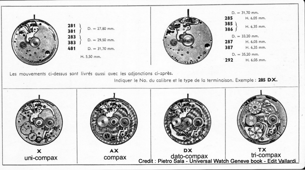

Technically speaking, the modified parts are: the minute recording wheel and its jumper (45 teeth vs. 30), the sliding gear (to fit with the different shape of the minute wheel's teeth), the chronograph runner (only the dart tooth - to fit with the different shape of the sliding gear's teeth ^^). The height does not change because of that. But as there are now parts on the dial side of the plate, a compax is thicker than a compur (+0.8mm based on UG document). And a tri-compax is even thicker (+1.6mm).
BTW the full image in which the diameter and height are listed is misleading regarding uni-compax / compax
X = compaX, not uni-compax
AX = Aero-compaX, not compax
DX = Dato-compaX
TX = Tri-compaX
Compur / Uni-compax use the base caliber

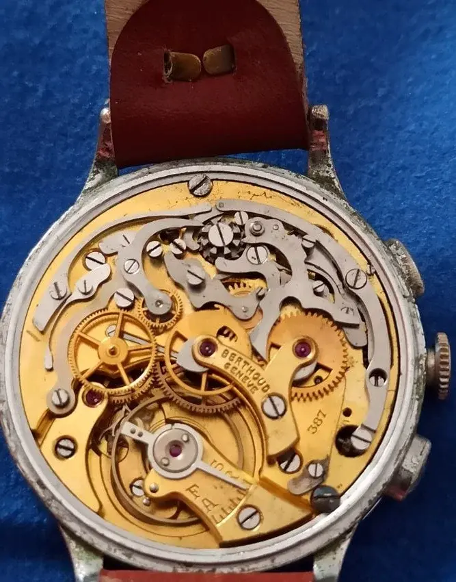

4/ calibers 381, 385 and 386 (and 387 - never seen that irl, but Sala has it) are also used (almost exclusively) in watches signed Uweco and Berthoud. These are not signed “30”.

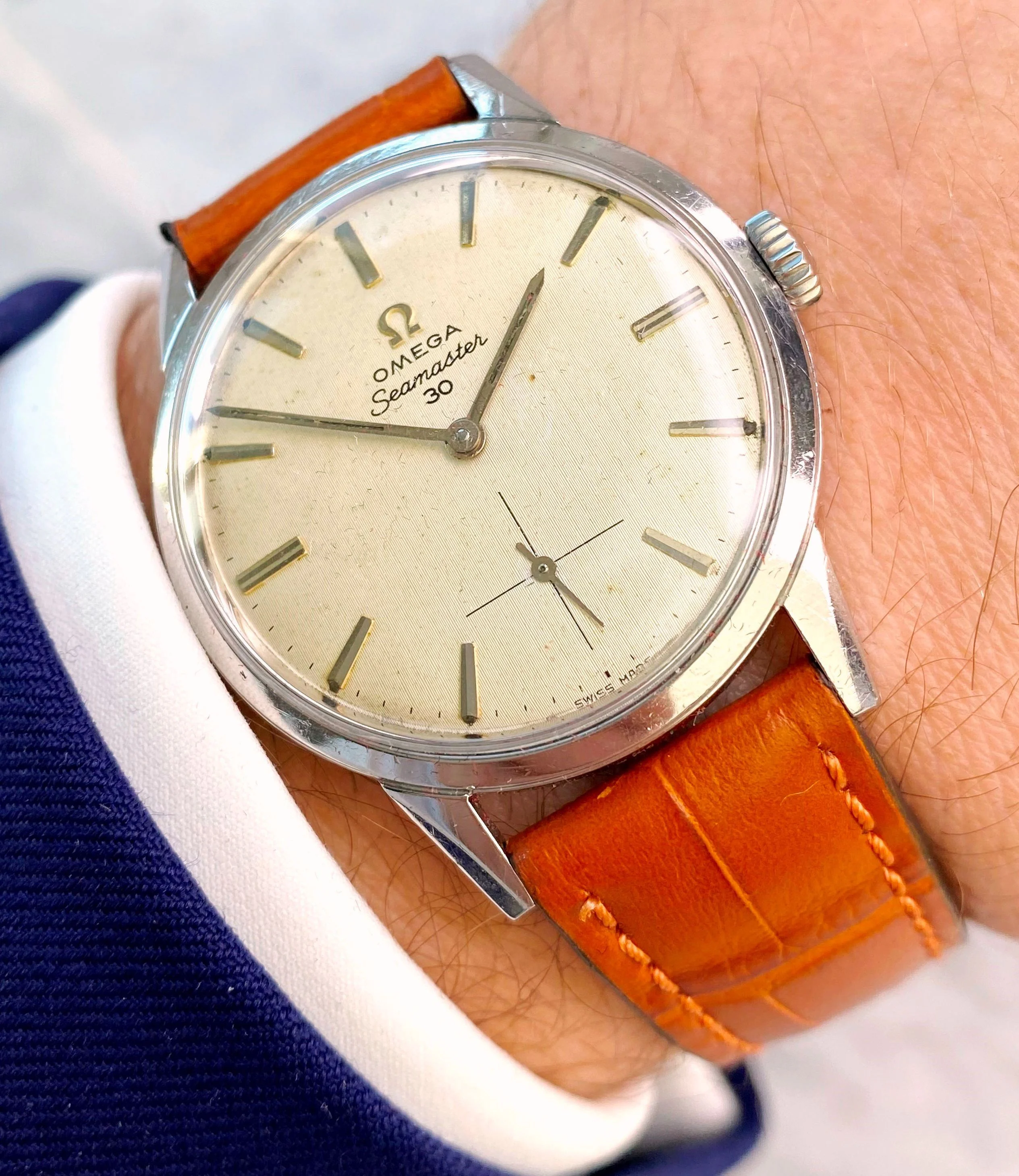

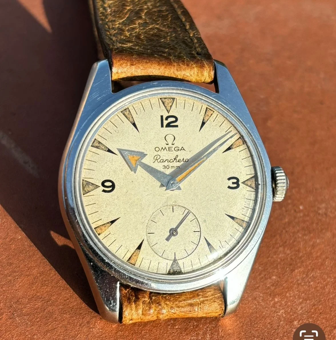

There are several Omega models with 30 (or 30mm) on the dial. (Based on the 30mm series of movements, starting with the 30, 30T1, T2 and then the 26X and 28X. The Omega 30 cal was released in 1939). I am not expert on these, this is just what I'm gathering online.
Could there be any relationship or trying to compete with the 30mm range of movements?
Offhand I'm not loving this theory because Omega themselves didn't put 30 on the dial until 1958, and most of the UG movements would have been over 30mm, so why only put the 30 on a small number of dials?
